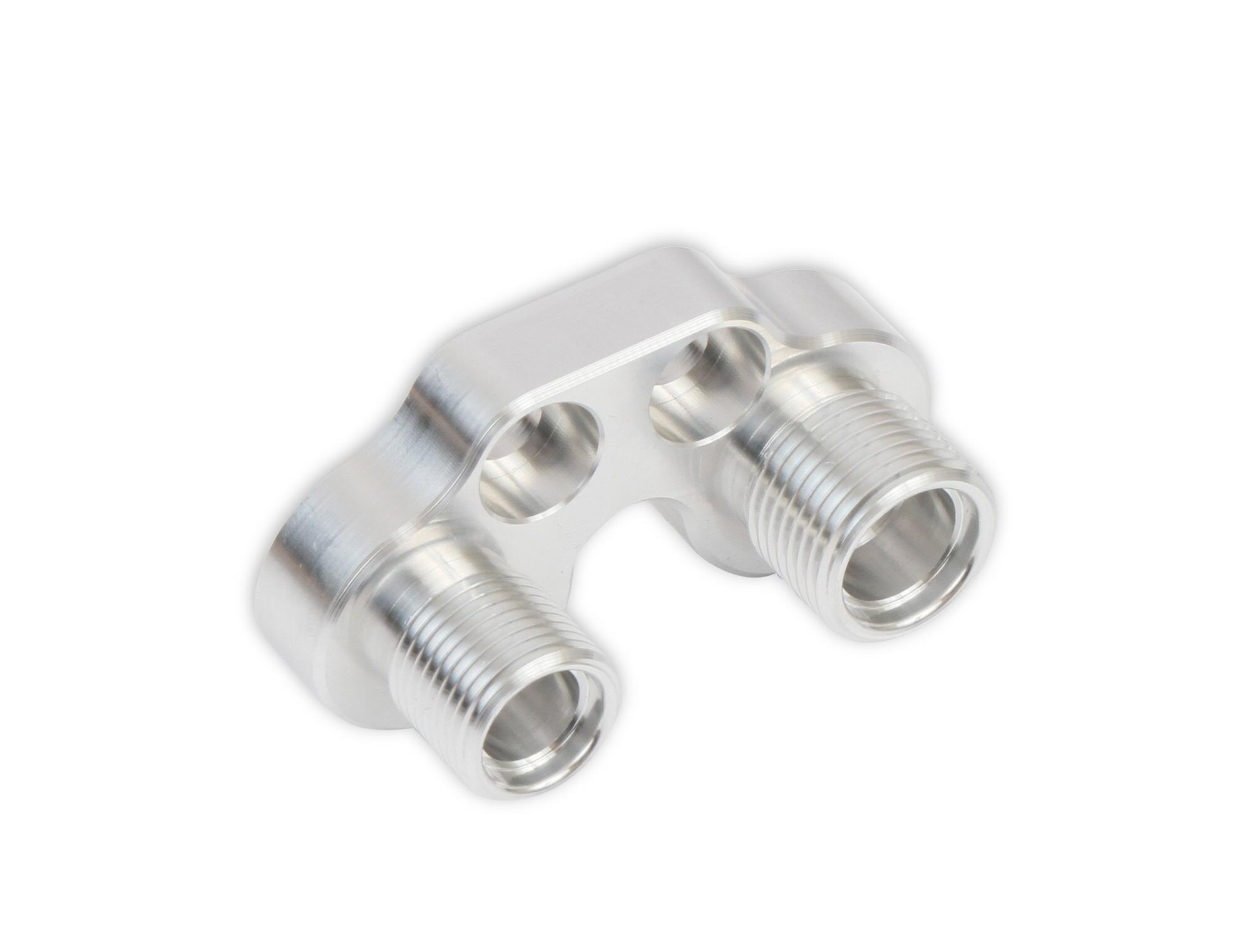

      but Holley also makes a kit to adapt those to 3/4-16 UNF and 7/8-14 UNF:

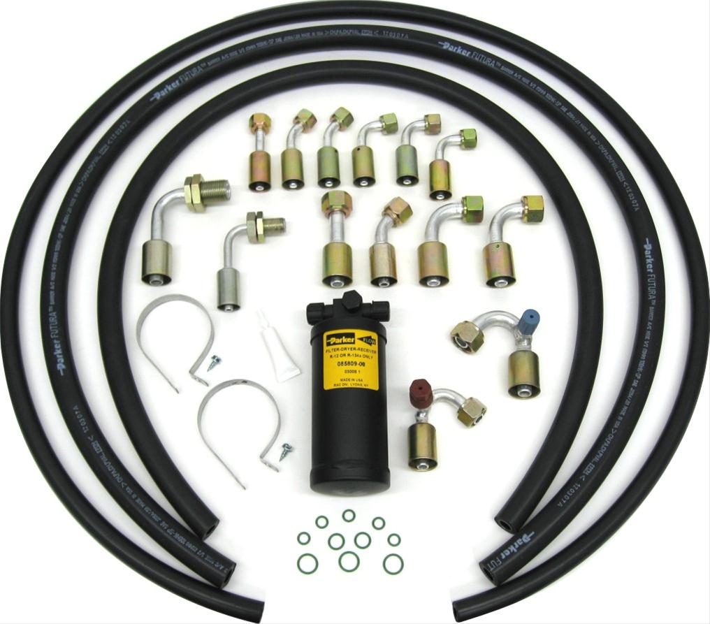

      The crimp-on ferrules VA sells - like these:
      - if I took the stock GM lines and cut the ends that didn't fit my needs off, could I have these sorts of fittings crimped onto the ends of the hose where I needed them? I'd cut one end off the hose from the condensor to evaporator, and then one in the hose from the drier to the compressor. The compressor/condensor hose would be net new since neither end would be GM anyway.
      Would this work? Is it a horrible idea (of course it is, but how horrible is it?) Is there a "good" way to finish the AC without tearing it all out and starting over?

      If the original GM hoses are standard size then yes you can crimp fittings onto that hose. Should be 6 hose and 10 or 12 hose. Check for labels on the hose. Or Google the hose dimensions and measure the diameter. The fittings are easy to buy.
      This seller is in Bedford and ships fast.
      https://www.ebay.com/sch/i.html?_trk...ssn=johnjoysyl
      I have a crimper if you want to bring the hoses by to crimp. Or some auto part stores will crimp.
