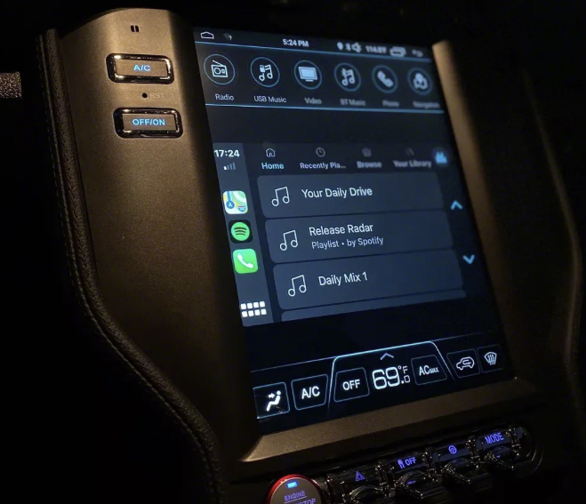

      Not seen a universal one but when I had a coyote mustang GT I was looking into something like this
      https://www.americanmuscle.com/musta...B&gclsrc=aw.ds
      Yo would have to adapt mustang interfaces for accessories
