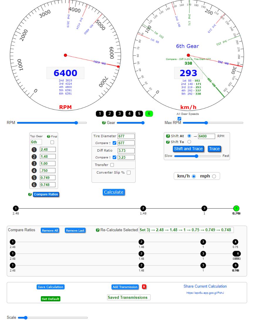

      Use this calculator, plug in your tire size, rear gear, and set one of the trans gears to 1.
      https://www.blocklayer.com/rpm-gear
      Then scroll to the bottom, looking at the gear set to 1, and you will see your driveshaft RPM to the highest speed you want to go. That'll let you know if you'll stay below your critical driveshaft RPM. I ran into this problem with stupid long A-body shafts, just about looped one with short 25" tires and 3.73s..

      Tried it but not sure what im looking for can you assist with image below?
      Strange has a handy chart, see below.

      What rear gear and rear tire size are you running?

      3.73 rp
      275 40 18 26.7" rw diameter
      Jul 2008
      508
      Look at line 4 (4th gear set to 1), at 11 mph it's spinning 500 rpm, 21mph 1000 rpm, etc. Think you'll be safe if you don't have plans to exceed 150mph.

      I See said the blind man, got it, much appreciated
