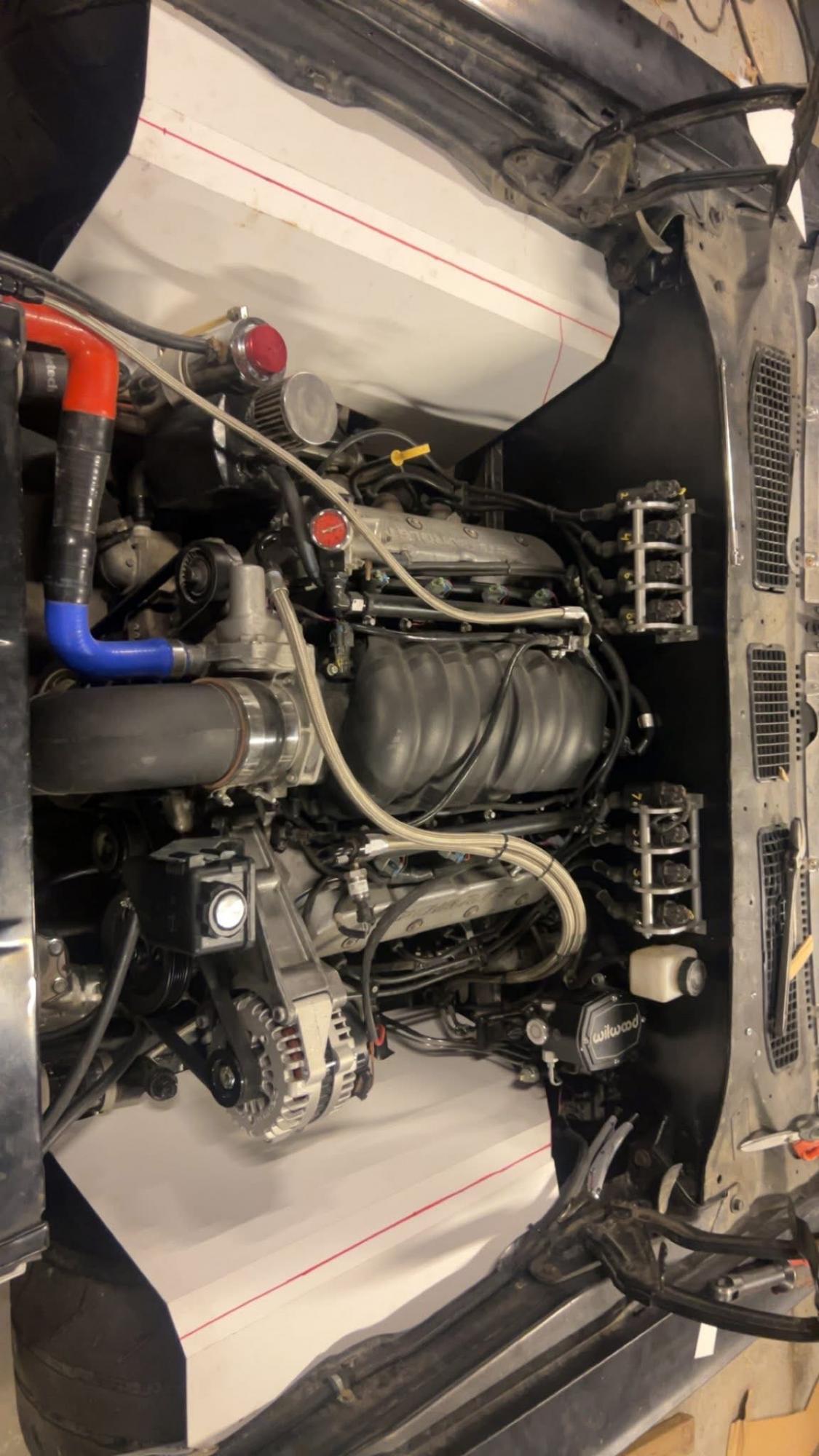

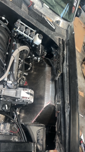

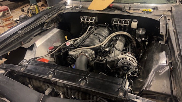

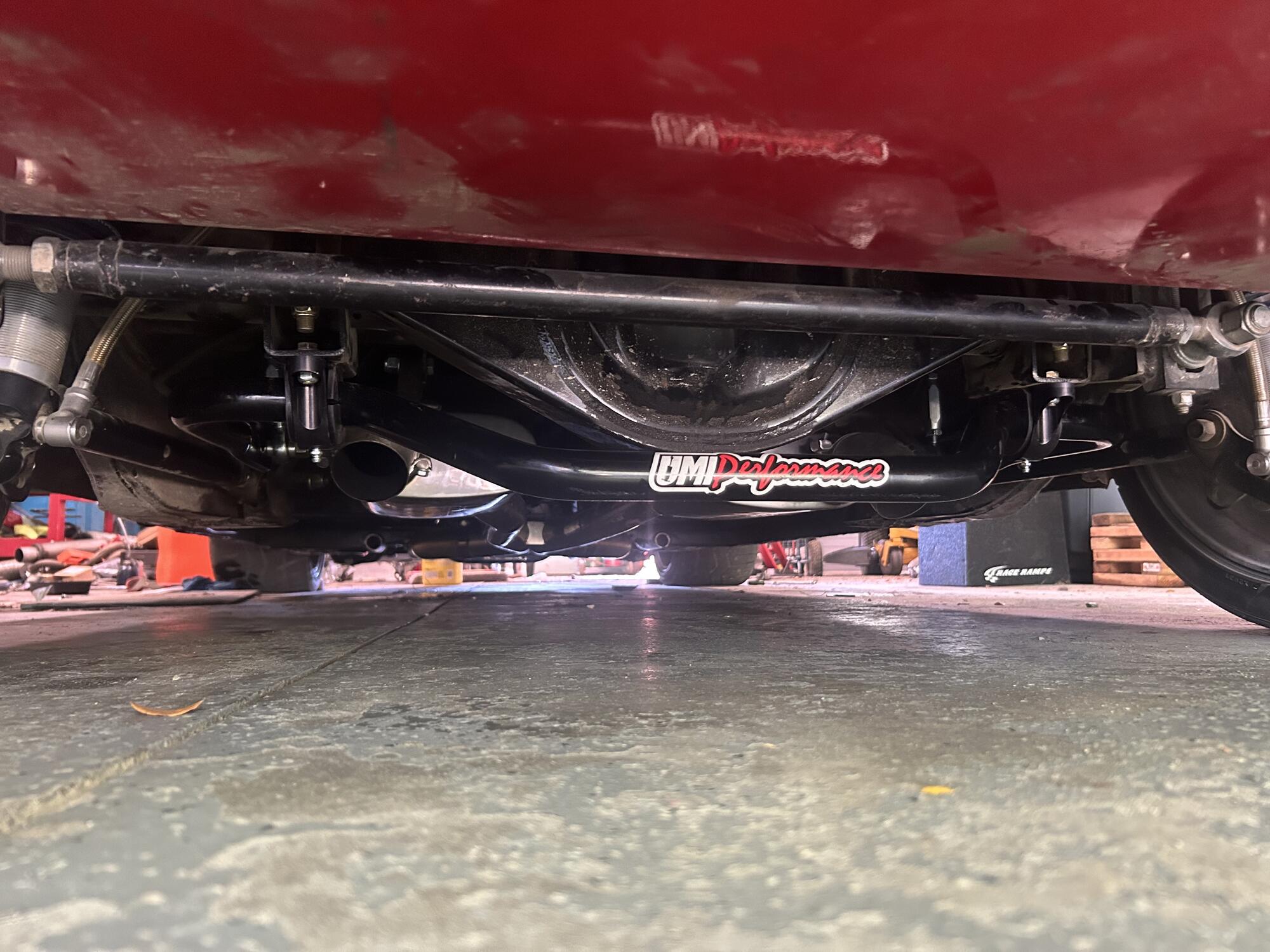

      Its been a LONG while since my last update, a little bit has changed on this car but a lot of work was done

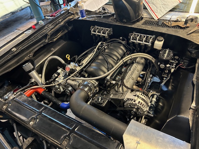

      -Eenie weenie LS1 is in storage and a new stroker LS3 is back in the car
      -Sweet Mfg 8:1 steering box
      -NEW TAHRS
      -Made some inner fenders.
      -Lithium battery
      Respectively and going down the list;

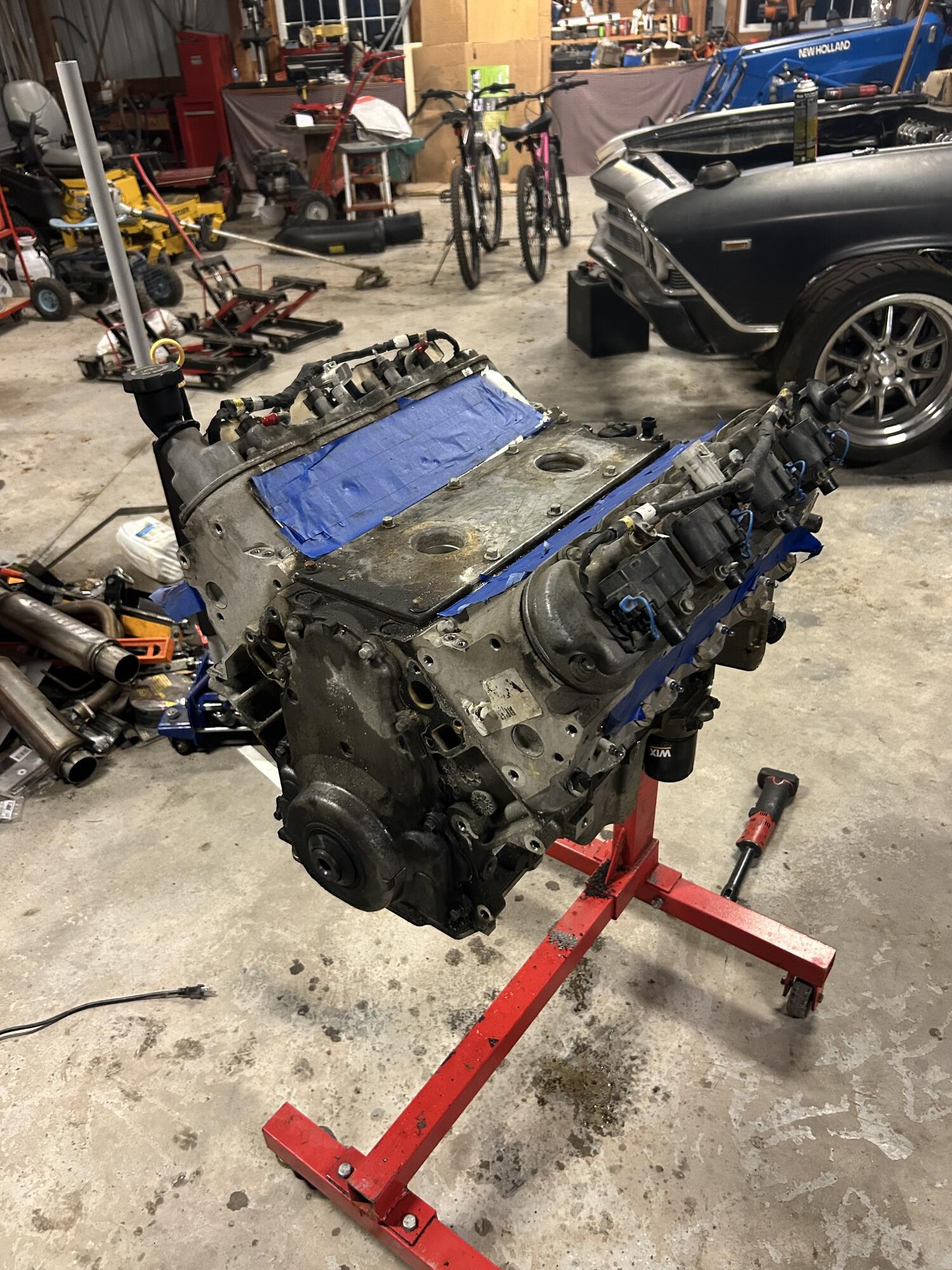

      -New stroker motor is the same specs as the prior stroker motor with a little more compression and a few less cubes (.040 on a aluminum 6.0 block scared me a bit but the builder had confidence in the wall thickness for an N/A application. This is a throwaway block and will not take more overbore in the event of catastrophe). It was a good humbling feeling to have an LS1 in the car and think that this engine is where the craze all started. But man, 400horsepower is gutless and woefully inadequate.
      New motor is a 410ci, ported LS3 heads, 13.5:1 compression, 235/[email protected] .620 lift cam (same cam I've run for 5 years), ported LS3 intake, E85, 1-7/8 headers, 650ish horse, and LS7 lifters because I'm salty to Morel lol
      I didn't build it so this means it will last!!!
      -The single greatest thing I've done on this car is the steering box. Most of the board people in my SCCA region are all spec Miata people and there's mainly small cars (at or below 2500lbs). The layouts are very tight and technical. This kind of sucks with a long wheelbase 3300lb 650hp boat and I found myself limiting how fast I go in some corners with the fear of rotating too much and spinning out without the capability to recover. I no longer have that fear with this steering box, lock to lock is 1-3/4 turns. Fast circle track guys use these boxes to turn the wheel right to go left, its doing exactly what it wants to do.
      October was the last event I attended and I had the fastest 1st lap time of the entire pool of 52 cars and I attribute most of that to the steering, and the rest of that to the tires. This was truly amazing to me.
      The downside to the steering box is the sensitivity on the street, this is in my view a race-only mod.
      -With Falken's RT660+ coming out, the legacy 660's were on blowout everywhere. Picked up a set for like $900. Absolutely awesome. With the car a bunch more balanced and me being able to push it harder, I was HUMBLED and hit HARD with knowledge bombs and direct experience with the significance of tire pressures, so that will be a between-lap maintenance item now on.

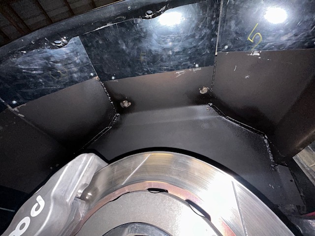

      -Made some inner fenders, I wanted to use aluminum but I don't know how to TIG weld quite yet, haven't figured out what my machine likes in terms of tungsten quite yet (its from the 80s).

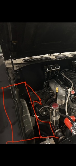

      Had a little vision, mocked up from bristol from hobby lobby, and just started building. IMO they're the nicest part of the car now and definitely some of my best work, I really like how they came out. Theres still a few things I want to do (contour to the frame and control arm) and close them up completely near the firewall. I also need to figure out an intake situation for the engine, there is a hole in the driver inner and the airbox I built years ago fits but I can save a few oz if I build another that doesn't require me to remove a bunch of stuff to clean the filter.
      I used anti-gravity batteries when I was into motorcycles, for some reason I had the idea to see what they made for cars. Low and behold they make a bunch! Circuit protection, built-in jump-start capability, and 30lbs weight loss? Count me in. For the location situation, I'm toying the idea of re-relocating the battery back up front to save weight on 20ft of 0ga battery cable.
      Now for winter projects, I think I'm going to pick up some corner scales and do plot some geometry and balancing measurements (CoG, pitch/dive center, squat/antisquat)
      I'm not concerned about weight, the car is basically exactly where I want it at 3250-3280, and I'm not concerned about the front, as far as I'm concerned its dialed in to my driving style and desire.
      -I haven't really got the 3-link exactly where I want it, and on-track there was a higher speed back-half where on throttle it felt very bumpy and I'm not sure why (felt like the axle was cycling up/down causing this, its not losing traction and its not like the shocks were stiff following the road surface). It did not do this when I had more squat dialed into into it, I think I want to try a different hole on the lower arms to give it a bit more squat.

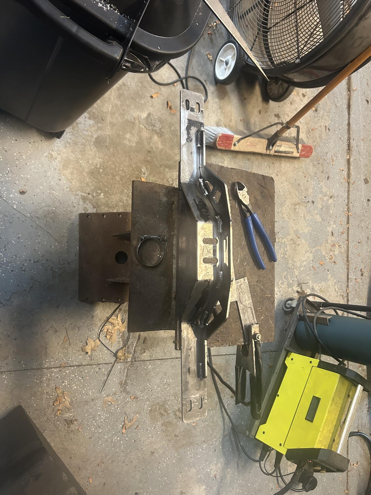

      And if this doesn't change the chatter, then I need to rethink my upper control arm mount and probably go into the anti-squat realm, which would be interesting because I need to cut a sheetmetal crossmember out of the body and build into the rear seat area. I'm completely out of adjustment as it sits right now
      -Carpet is on the list, interior is a shoe-in for a nice looking car so that would be cool.
      -I want to re-re-redo the trunk and start over with fuel tank mounting, and maybe go with a smaller cell for less fuel (less weight!!!). When I changed the 3 link from watts to PHB, I did that after the body was installed. The trunk consists of some aluminum installed with sheetmetal screws and a little bit of the stock trunk, it would be really nice to not have to deal with the sheetmetal screws vibrating. That is by far the worst sound this car's ever made.
      -Fuel cell baffling. I think hydramat and some baffling could allow me to run 3-4 gallons and not experience fuel starvation. We're grasping at straws here but 3200 even I think is a solid goal.
      -I want to route a catch can vent hose to the cowl area to mitigate fire risk.
      Photo dump soon to follow.

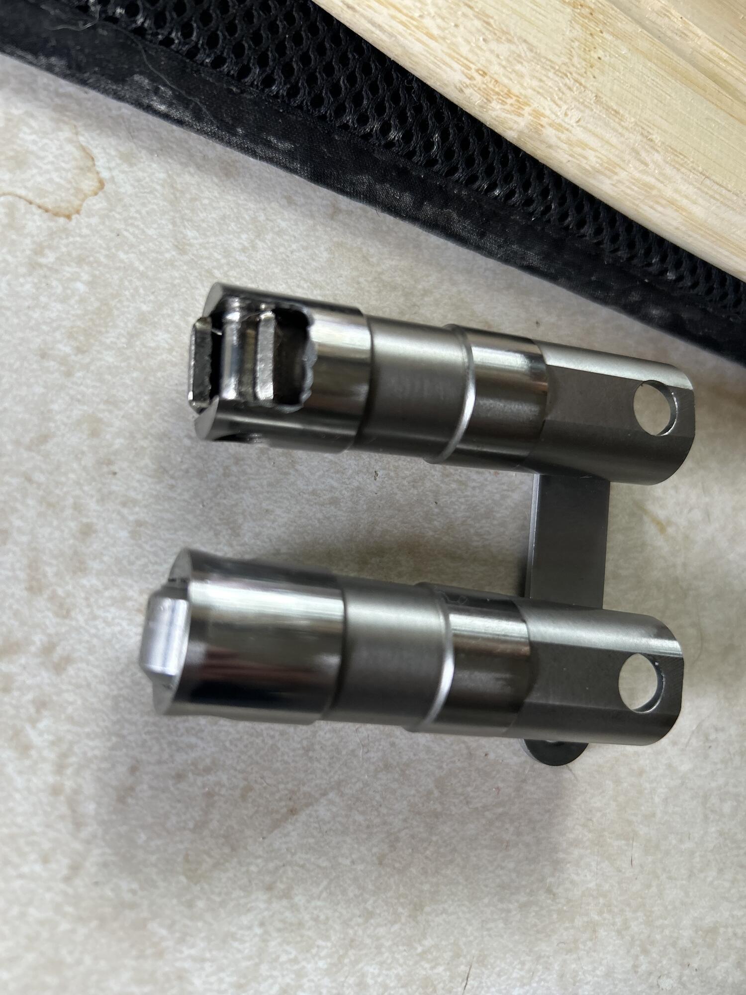

      On a different note, something in my spidey sense told me that a possible reason the stroker engine went goodbye last year was a result of the condensation inside the crankcase (from E85 and no PCV, just a catch can) rusting internal parts which dislodged, clogging the lifter up and the wheel to stop turning. Decided to put a GZ Vacuum pump on the thing to extract the moisture, and a cherry on top is giving me a bit more horsepower. Looks cool, installed simple, and the power increase is actually noticeable up top.

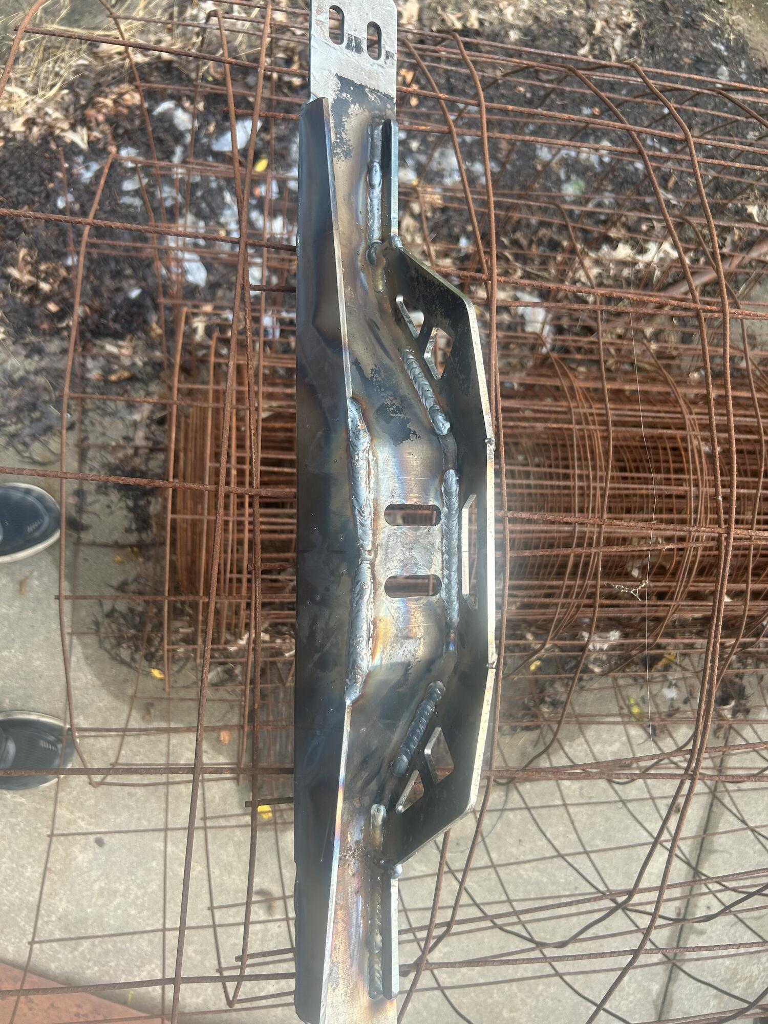

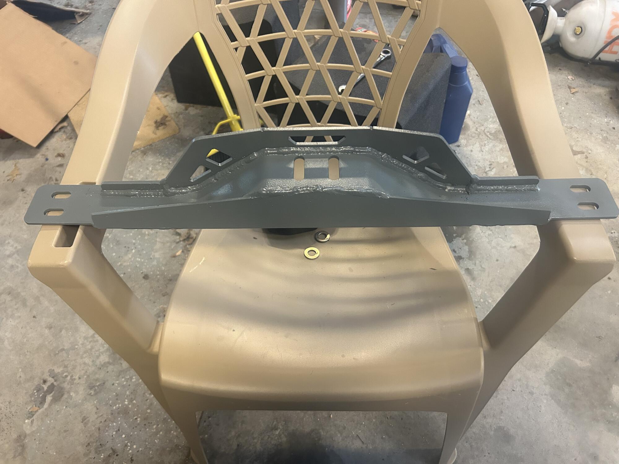

      Had to dig and find photos of the innder fender project (new phone and running out of google storage); those and a few finished product pics included.
