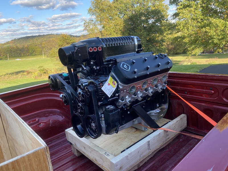

      Whipple sells an extension for more clearance.
      It's about 1.5" thick as seen in this photo.
