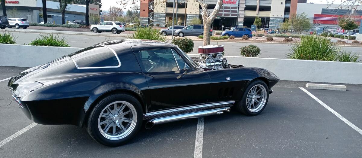

      Has anybody had any luck with the digital e curve distributor I am trying to get about 34 total degrees of timing with 20 of it with initial timing msd only has the 18 degree bushing and its for my supercharged 66 vette .Name:  66 vitamin shop 2.jpg

      I actually went through this when I put a new engine in my Superformance cobra. I found a guy that machines bushings so you can do what you want. It still had hesitation right at throttle tip in so I ended up just locking the distributor out at 32 degrees. Seems to be better and doesn’t have trouble starting. I still have the bushings if you want to try them.

      That is one awesome looking vette: great tire and wheel combination!
