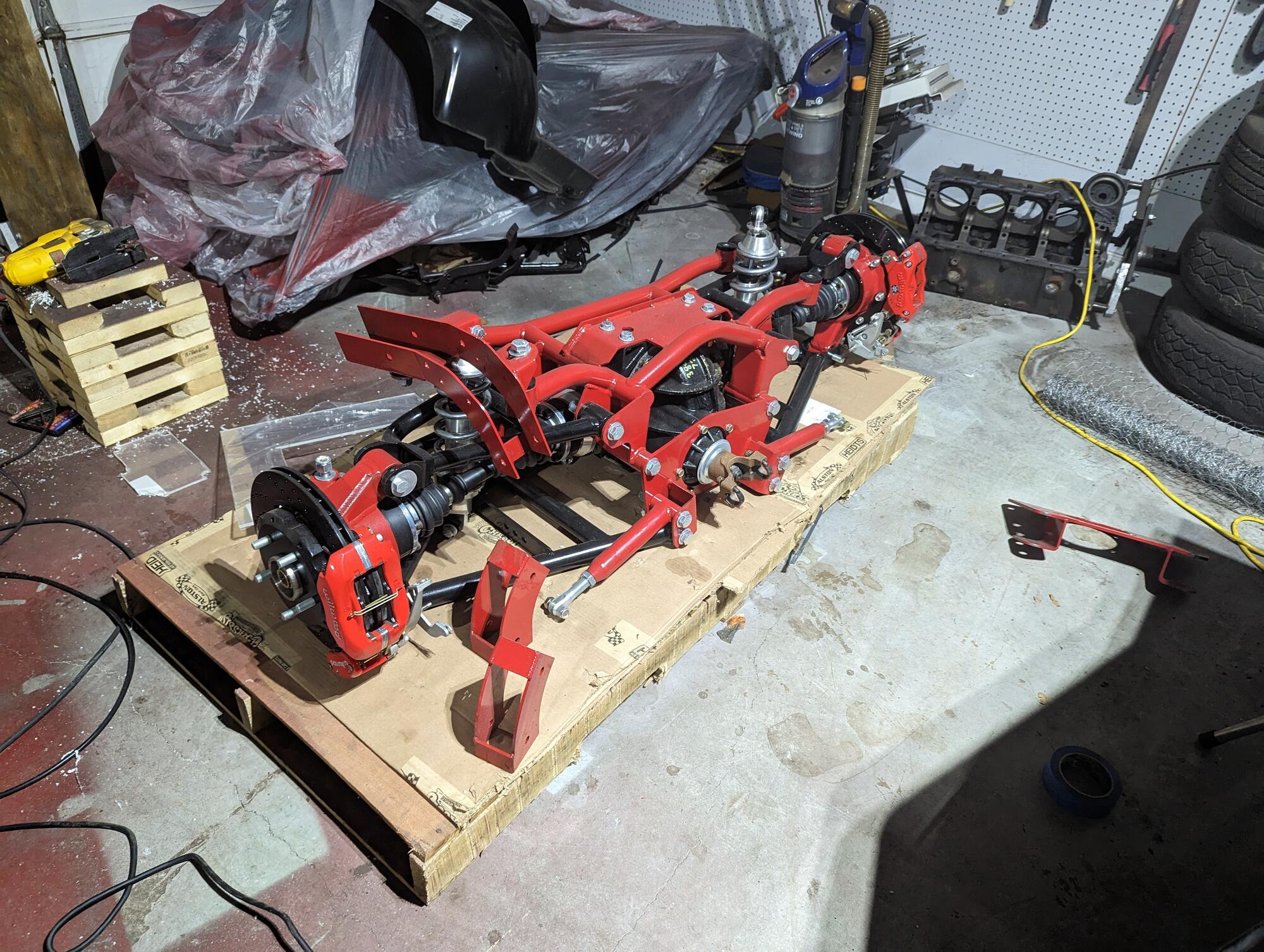

      Thanks! I did end up going with the Heidts IRS but I have the newer gen 2. The IRS is currently dry assembled on a pallet waiting for me to get my car off the rotisserie. As for front end I went with a Speedway Unser edition front subframe that should be shipping in a couple weeks. I should probably start a build threads. Haha

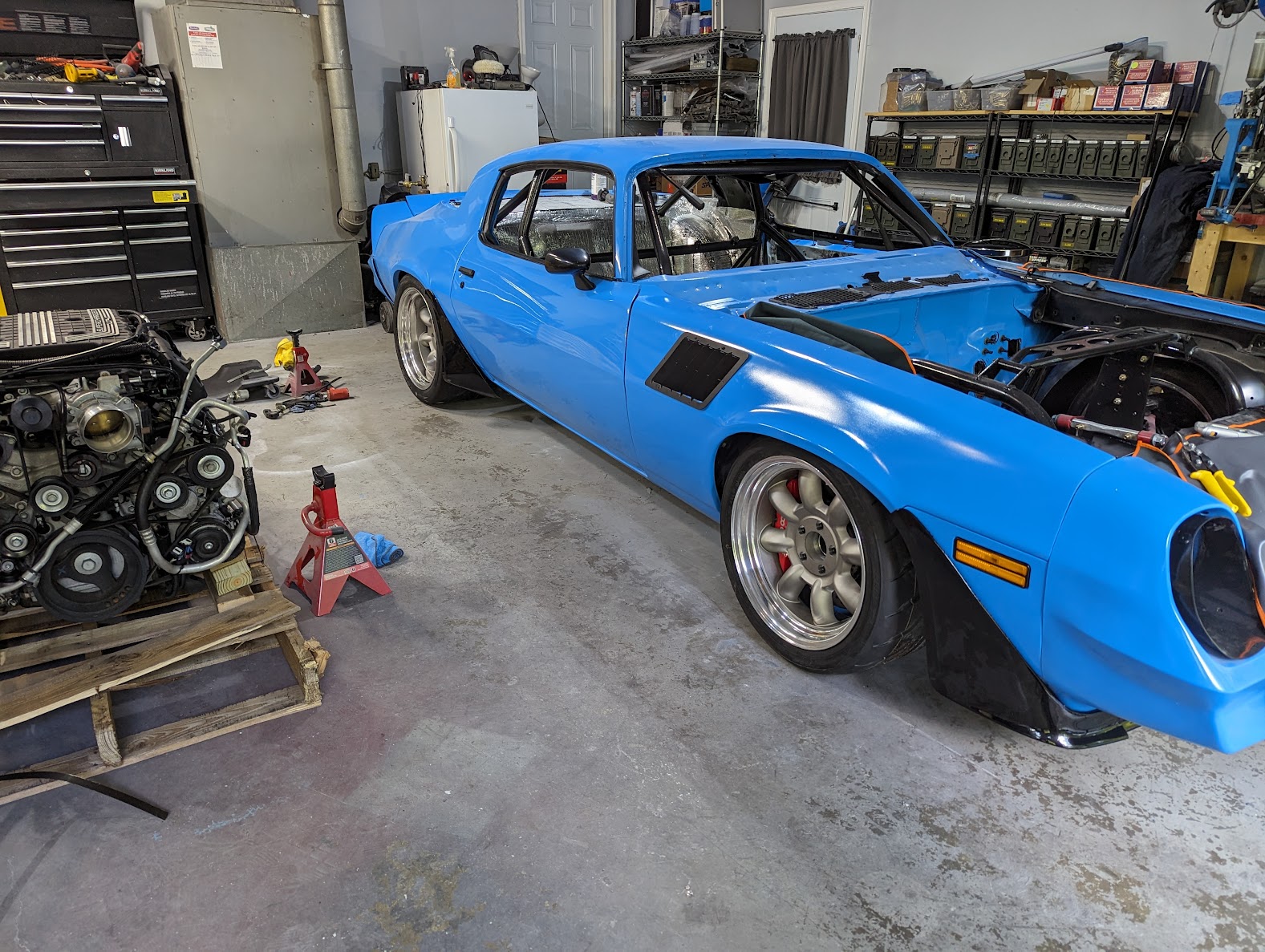

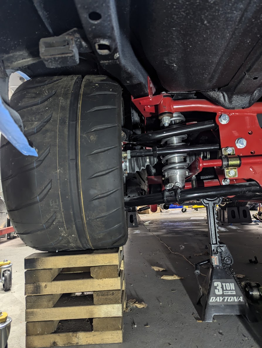

      Sorry for the Necropost but I totally forgot I made this thread. I managed to stuff 335's in the rear wheel welsl with room to spare. I'm a bit disappointed that Speedway says 275's are the widest that you can run for front tires on their Unser Edition subframes. I went with their suggest max of 275s on 18x10s and there's so much room. Toyo says 10" minimum wheel for a 305 so I'll eventually pick up a set of front tires

      As for the exhaust routing theres no room. I'm just going to do an axle dump. Here is some pics of the IRS fully installed. (except for the driver coilover which I need to flip because the adjustment knobs nearly kiss the lower A-arms and for some reason I didn't mark that side when I torqued everything down.)

      Heidts isn't exactly great at providing instructions or pictures. The assembly instructions used old pictures and I had to sort of trial and error assemble the rear. Name:  PXL_20230211_011008652_exported_969_1676077826507.jpg
