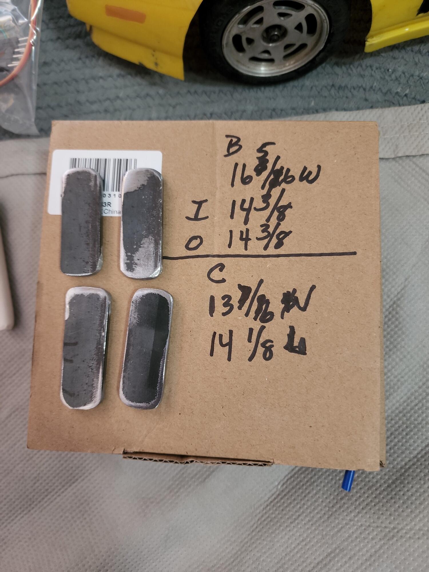

      Pieces I made to intall the E90 seats.
      1/2 by 2.25" pieces of plate steel 3/16 thick. Drilled 2 each 5/16 holes 1.5"'s apart in each plate. (2 sets) Also cut 3/4" rod 1" long, drilled 5/16 hole in the middle to support the rear mounting brackes, 4 each. Used 5/16 X 1.5" long bolts to mount seats to floor board.
      Installed seats. All power options will work but the MEMORY for operator 1 or 2 (needs can system extras). Did not use heated seats or airbags.
