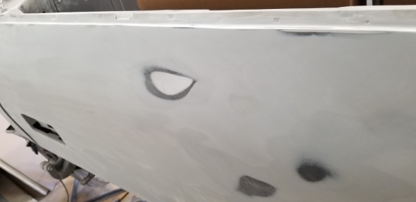

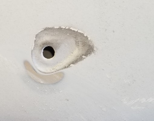

      Both door handles (suspect this is just me sanding too aggressively in that area)
Size:  43.1 KBName:  20220605_111930.jpg

      I think most of those you will be ok but I would do one more round on that hood.
