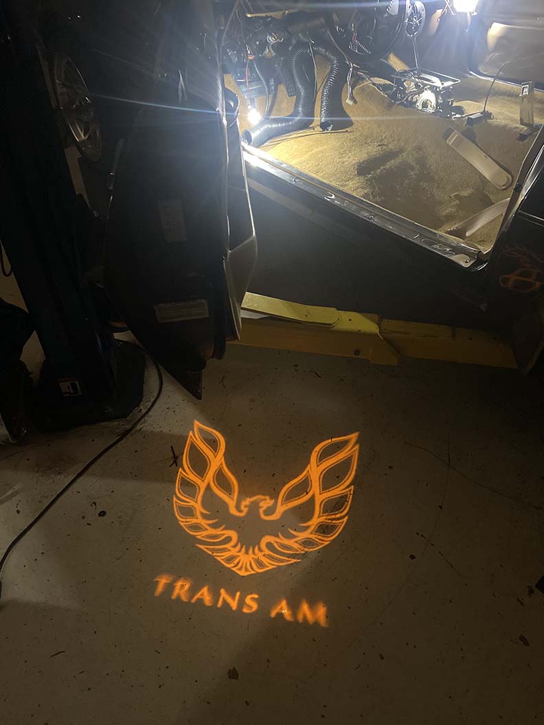

      Forgot a pic of the projector lights. The logo will be much smaller once the car is at ride height.

      any pictures of installation of these?
      also where did you source these from?

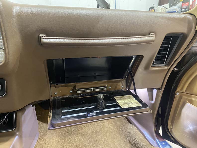

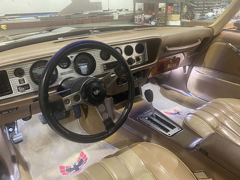

      Update time! So I think I mentioned before that my Dad is really into woodworking. He has designed and built 2 different wood glove box overlays for the 2 C10's I built for my other kids. The first was "Estelle", the blue C10 for Twin no. 2. The second was "April", my son's C10 and since Twin no. 1 named the brown TA "ROXY", Dad came up with this custom glove box overlay. The wood is Cambodian burl wood and the name ROXY is inlaid in mother of pearl. To get over the inward sloping glove box on the TA, Dad came up with the center piece thats angled to show the name. Came out pretty cool I think. Once all the sheet metal was installed, I was free to install the Hotchkis subframe connectors while the car was sitting on its own 4 wheels with full running weight. Connectors were bolted to the front subframe and welded to the rears with rosette welds where the bolts would normally go. This did wonders for chassis rigidity. Now when I pick it up on the lift it doesnt turn into a wet noodle like it used to. Once the connectors were in, I was able to install the lokar parking brake cables with a small plate thats welded to the connector as I didnt want to attach it to the floor. Also just managed to squeeze in the windshield washer reservoir in the front fender outboard of the battery. It can still be filled with a funnel and the detroit speed washer pump does the job well.
      Evan Q.

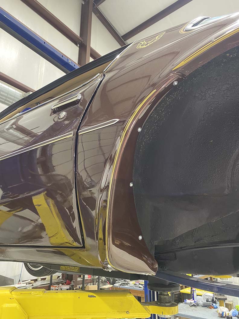

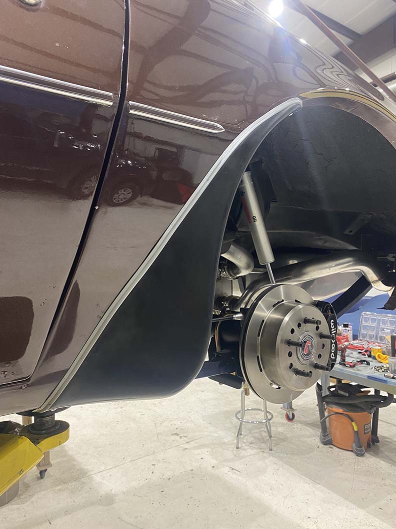

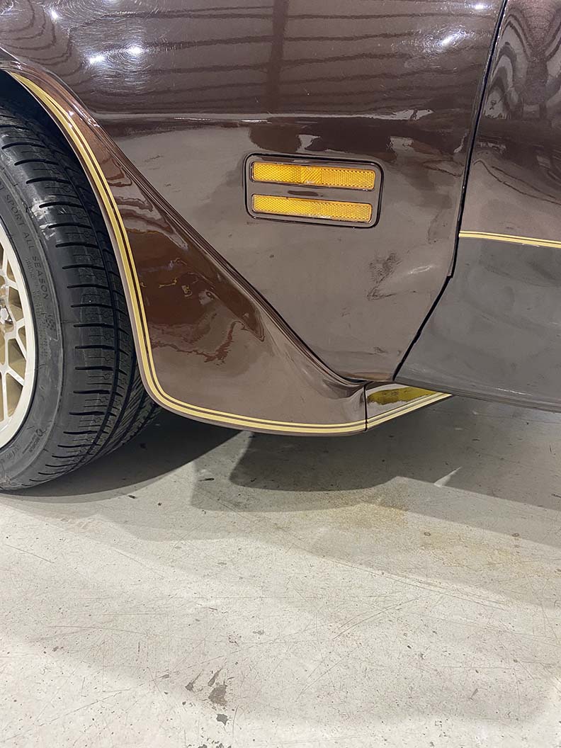

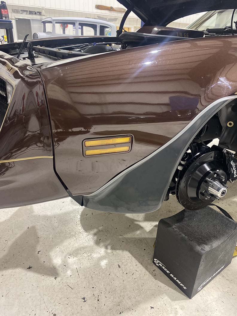

      Next up were the wheel flares. I ended up using the plastic front flares and a new plastic chin spoiler along with urethane rears as they were the only ones in stock. The plastic ones only needed a quick scuff and were ready for adhesion promoter and primer followed by some freshly color matched brentwood brown. Turns out the car has had one repaint and the color wasnt quite factory so Its a good thing I took one of the old flares to the paint shop to get it matched. The rear urethane flares were another matter. They needed quite a bit of pinhole filling to get smooth but turned out nice. The edge welting that goes between the flare and body was also treated to fresh brown then I put new gold pinstriping on the flares and finished it up with 2 coats of 2002 clear. they look SOOOOO much better than the cracked and pitted originals.
      Evan Q.Name:  68608606454__E4F21DB4-08C2-4022-A070-684ECBAB76DF.jpg

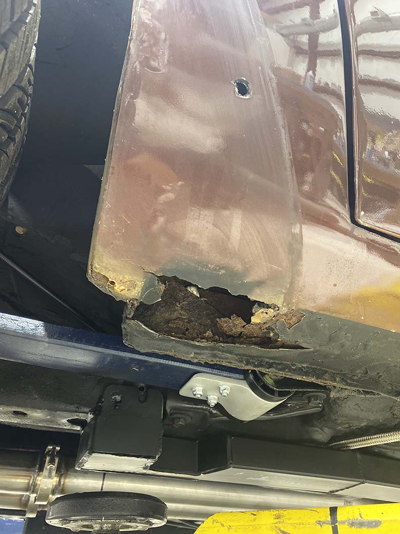

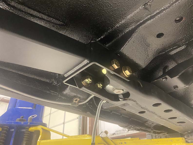

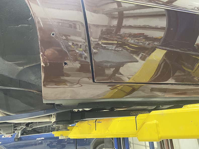

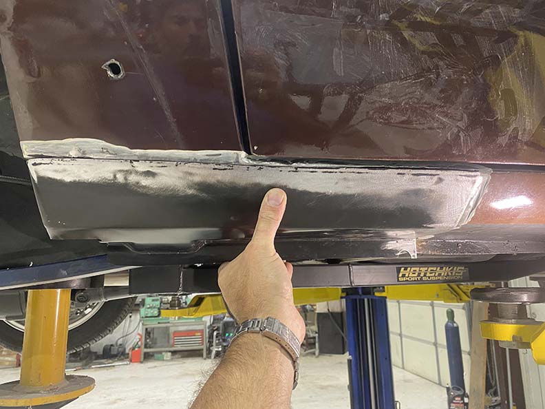

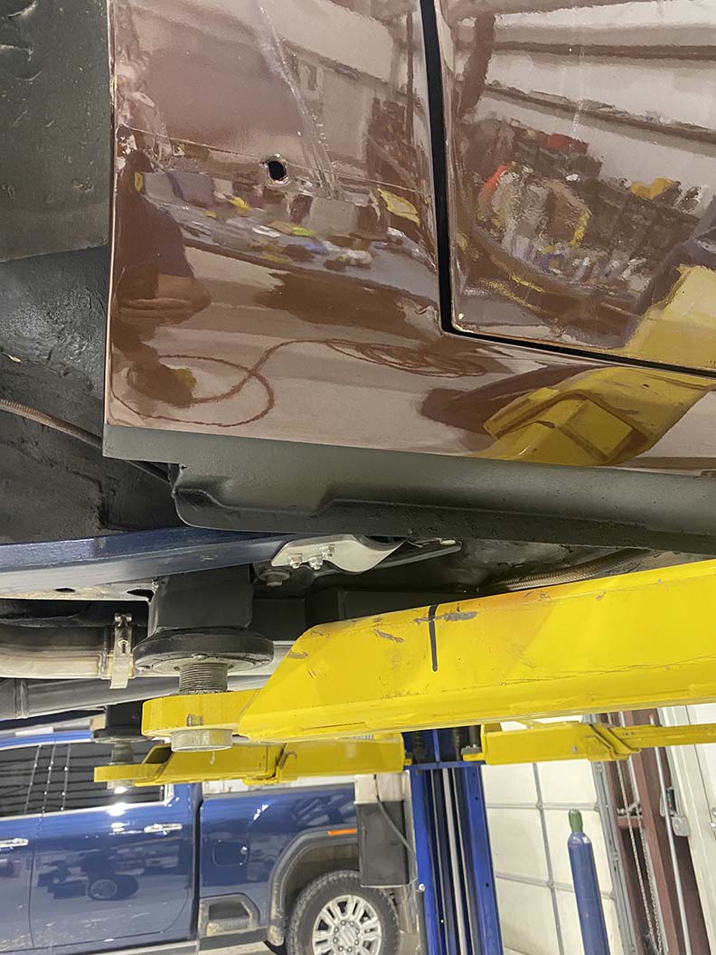

      So when I removed the original wheel flares, I was met with a nice little surprise in the form of a giant rust hole in the pass side rear rocker. The wheel flare had been covering it and I kinda knew it was there but didnt know the extent. Turns out the pass rocker was one giant mouse nest. pulled out a big whopping pile of nest from the inside. Well, nothing for it but fix it up! I didnt have enough time to do a full rocker replacement so just settled for a half rocker re-do. I had to cut out a much larger hole to get decent metal to weld to at the front. Turns out this rocker had been patched before so I had to put a patch on a patch so to speak. The inner rocker was basically gone at the rear so I made a plate to extend down to form the pinch weld area that was missing. Not enough room to fully weld around the perimeter so did rosette welds on the join to the inner rocker that was still there. Once all the interior part was welded up, I sprayed a bunch of rust converter and then etch primed the whole interior. I cut out the rear of a replacement rocker and made a patch panel for the exterior part. TIG welded in the patch panel, did a bit o body work at the welds and painted and primed it up. Pretty much invisible once the wheel flare is put back on.
      Evan Q.

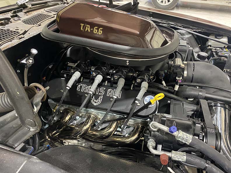

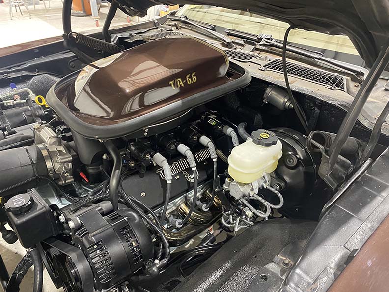

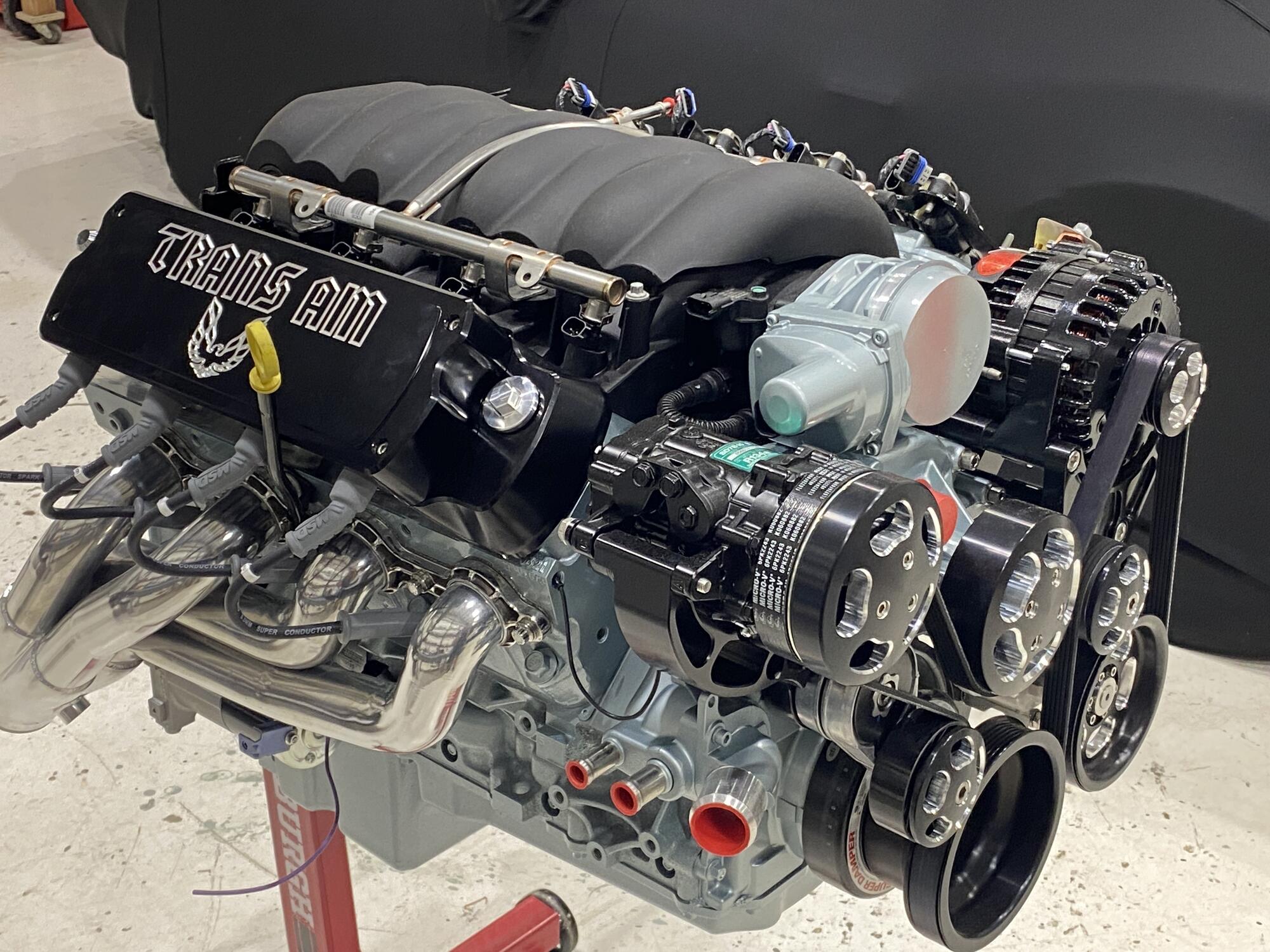

      Then all that was left before road test was mounting the shaker scoop to the top of the engine. I used the top part of the air cleaner base mounted to brackets which were bolted to the LS intake manifold. The shaker scoop just mounts to the air cleaner base with the giant ring clamp just like the original.

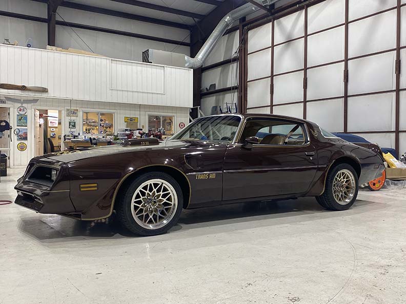

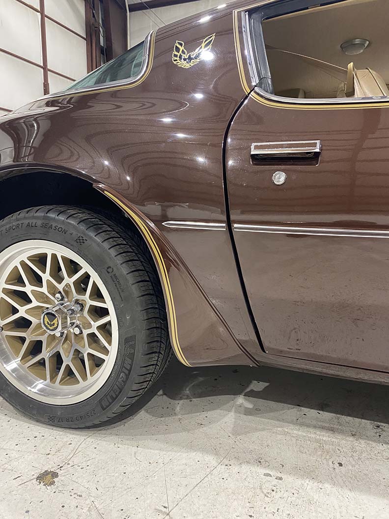

      So here's the finished product. Came out pretty nice I think. Ill probably have to strip it down and do a full repaint sometime in the future, but I think my daughter ought to enjoy driving it for a bit before it heads back to paint prison. Hoping to get some pics of all 3 vehicles together soon.

      The lights came from lumentrendz.com
      They are mounted on the interior bottom surface of the door close to where the lower window track attaches to the bottom. Dont bother using the little hole saw that comes with them, its junk.

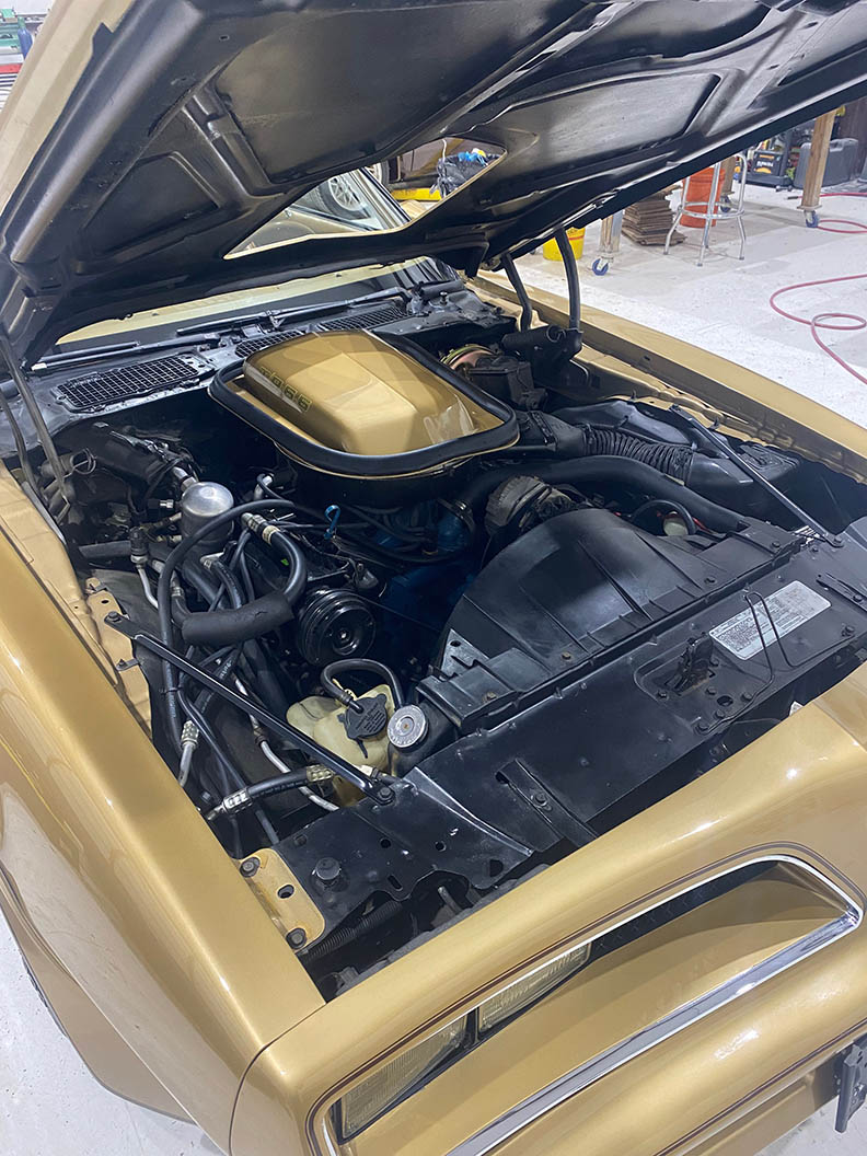

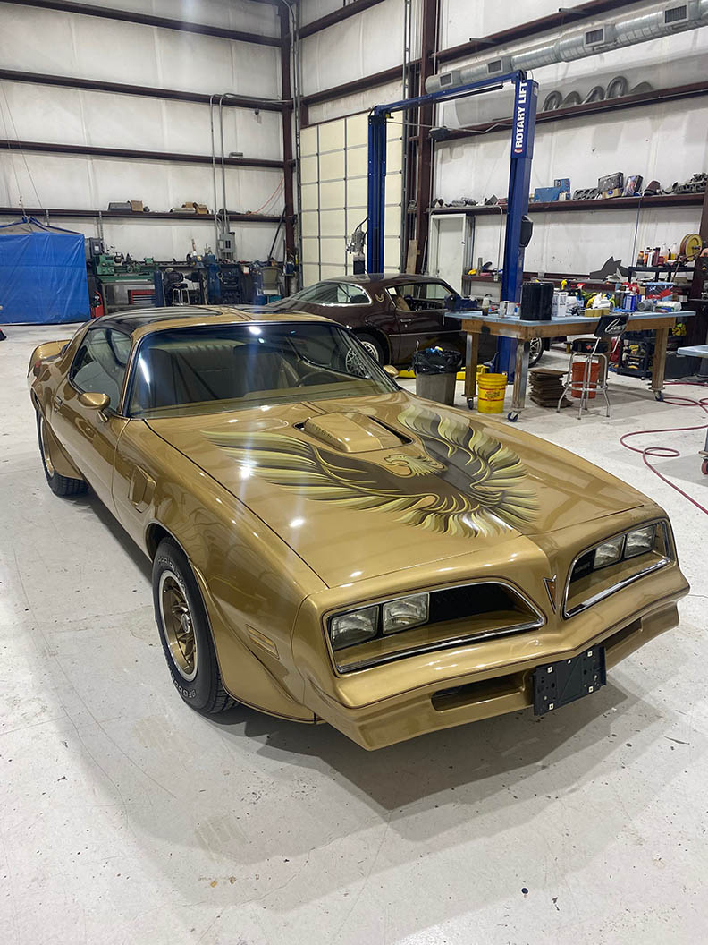

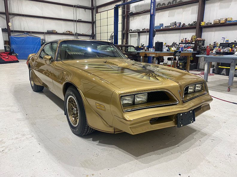

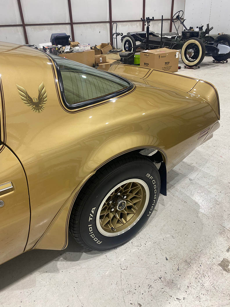

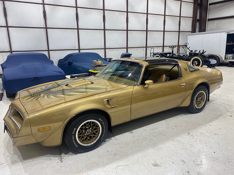

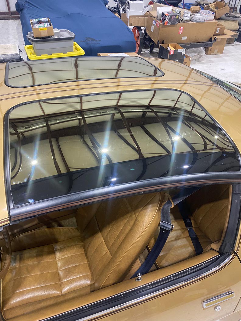

      After finishing Roxy for my daughter, I started watching the values of these 77-78 TA's climb outta sight. Always loved the look of the Solar gold paint so I went hunting for a real Y88 Trans Am. Finally found one in Georgia. Nice Y88 in fantastic shape. 4 speed car so its one of 1670 built in '78. Im kinda thinking it might provide a home for my Roadster shop spec chassis as it should fit. Would be kinda cool to cruise a Y88 with an LT4 in it....................
      Evan Q.Name:  IMG_6480.jpg

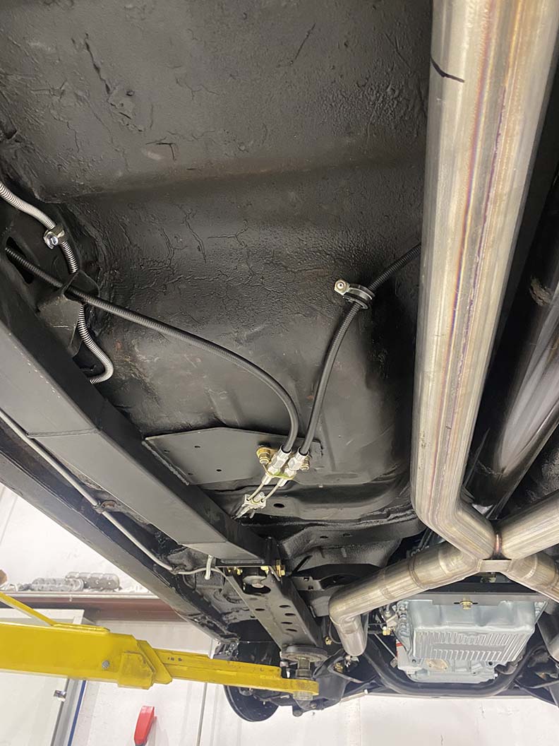

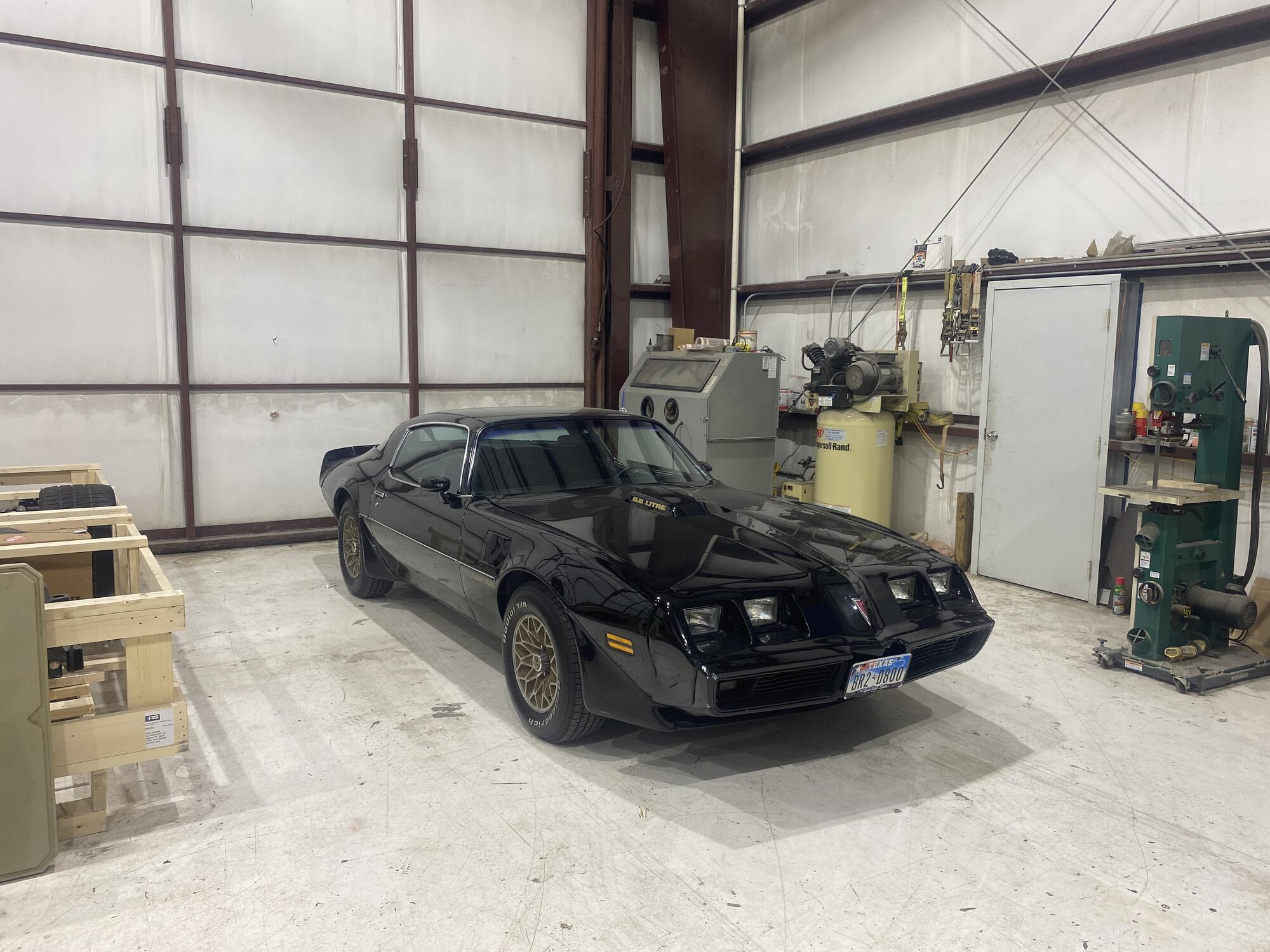

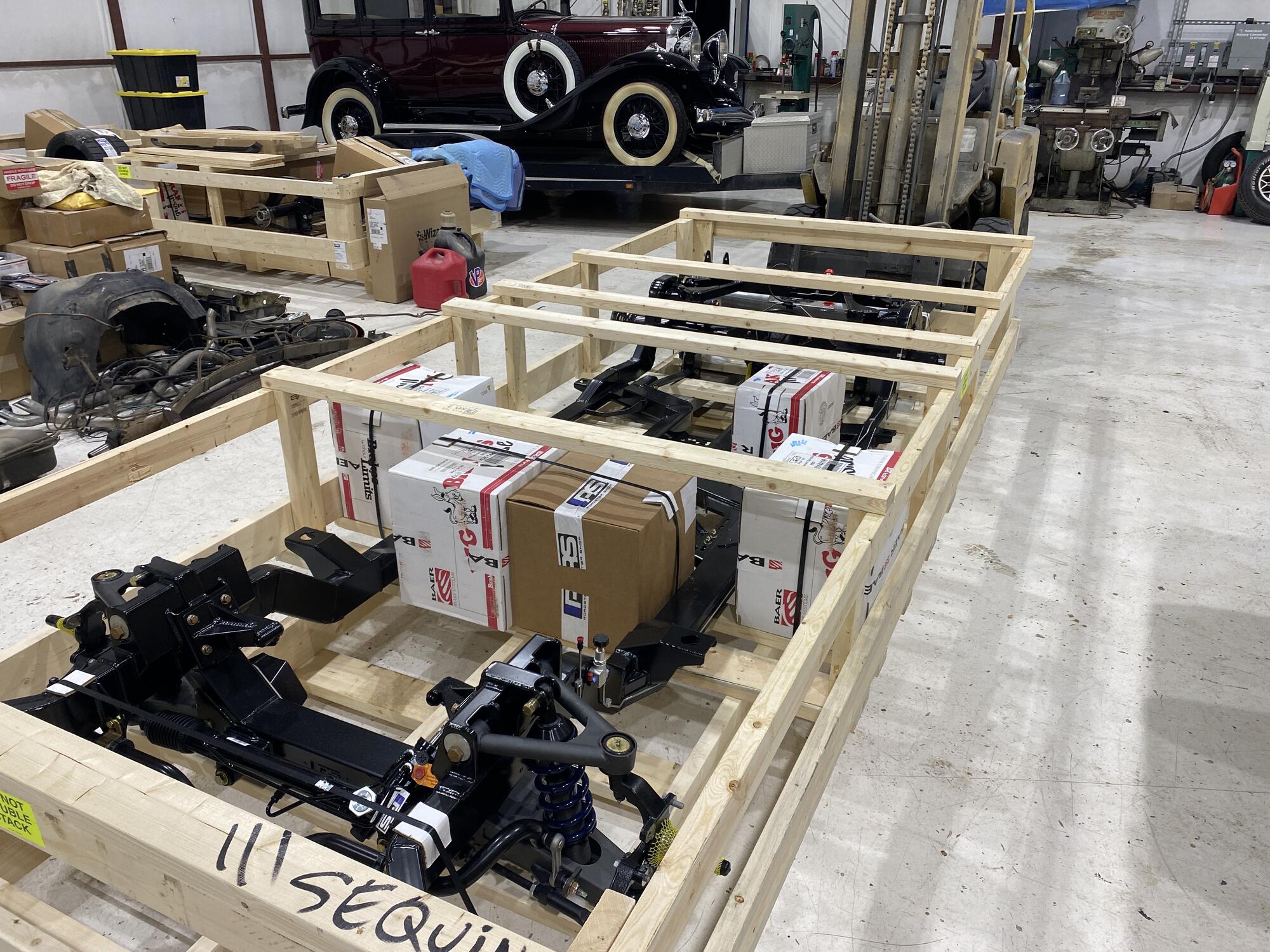

      So I was about to start on the Gold TA back in Sept of '23 when a good friend approached me and said he had just bought a '79 TA and was looking to do some modifications to it. So the Gold TA got put on hold AGAIN! The black TA project quickly snowballed(as they all do) into an Roadstershop frame swap and LS3/T-56. and full restoration of everything else. On top of that, 2 months into the build, He asked me to paint it once I had done all the mods to the underneath. And me like a big dummy agreed to paint a BLACK car. I think the only color worse from a bodywork standpoint is silver. The car was pretty straight, had the same rust hole in the passenger rocker under the fender flare and had good floors. He informed me that the car was to be named "Roofus" in honor of his favorite dog that had passed. The build was pretty straightforward so I wont post all the build pics, just the relevant ones. The black car also got a set of flush mount front and rear glass from Fesler. Roofus was completed in March of this year so Im finally free to start on my Gold TA. Here are a few pics of the transformation of Roofus.
      Evan Q.Name:  IMG_8040.jpg
