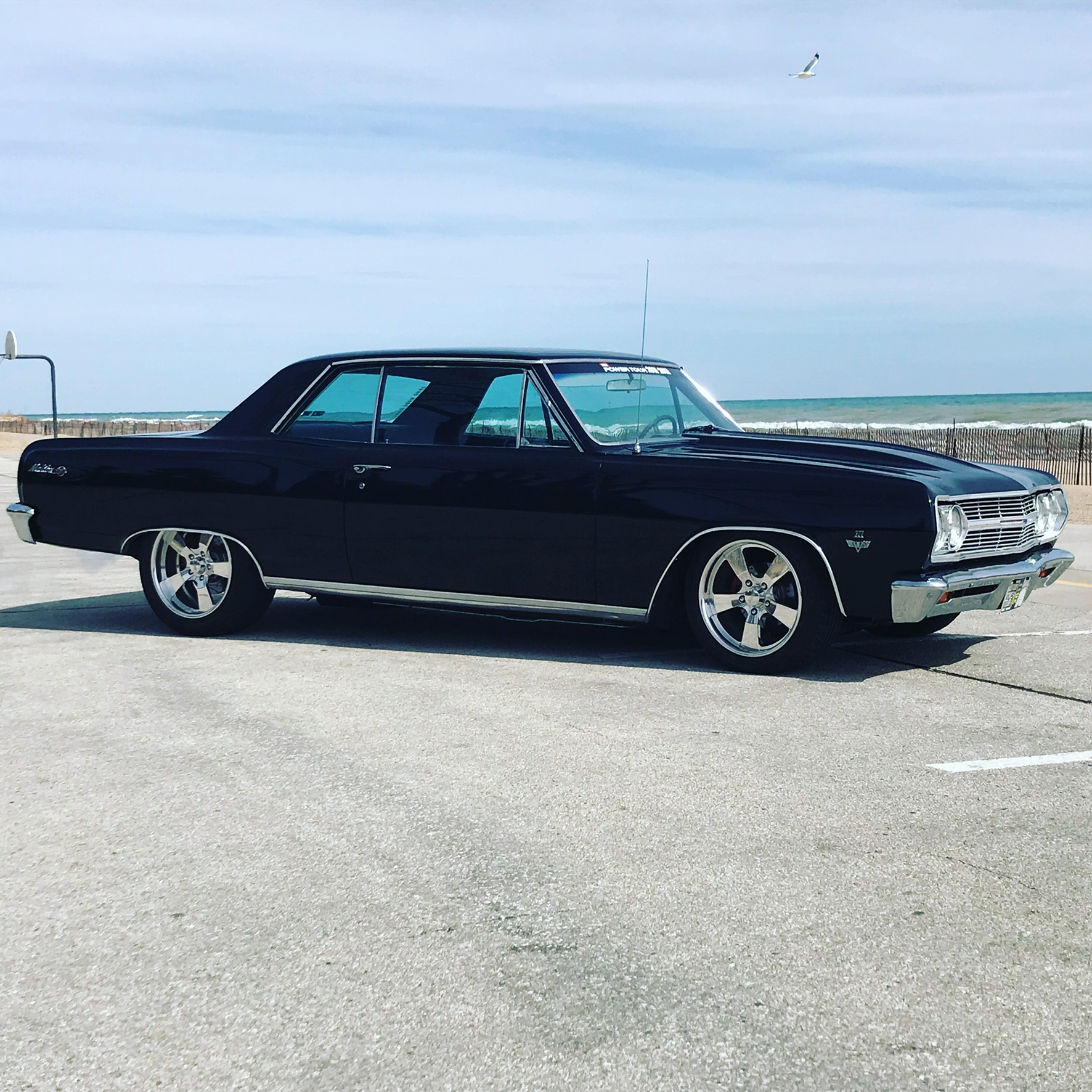

      Hi all!
      I’ve owned my 65 for over 20 years. It has gone thru many incarnations. Started with a stock 327/powerglide. Stock suspension.
      In the early 2000’s I upgraded the suspension and brakes to std GM 11” discs front and rear, lowered spindles. Ran that configuration for a few yrs. next was a transmission upgrade to a 700R4. Around 2010 I put in a LS3 with a T56, ac, new interior. Been running this way since. Done many power tour trips, it’s a fun car, but now it’s time to get on the newer suspension \brake bandwagon. I’m in possession of complete C6 brakes and am thinking of installing these. Looking for suspension advice. Been leaning toward ABC or Speedtech with the AFX spindles.
      Thanks!
      Chris

      Welcome to the site and great looking car Chris!

      I'm running stock style coils (moog 6200) with KYB gas a just shocks. Car feels like a stock ride until you start to go into a turn, the sway bar catches and the car stays flat. The improved camber curve keeps it planted and it handles great. I would suggest going with a little higher spring rate (stock is 290lb) as my car will start to rub if I get some healthy guys or a bunch of kids going for a ride. Looks like we're about the same ride height, I've got 2" drop spindles and also cut the springs, but they're starting to settle a little more than I wanted.
