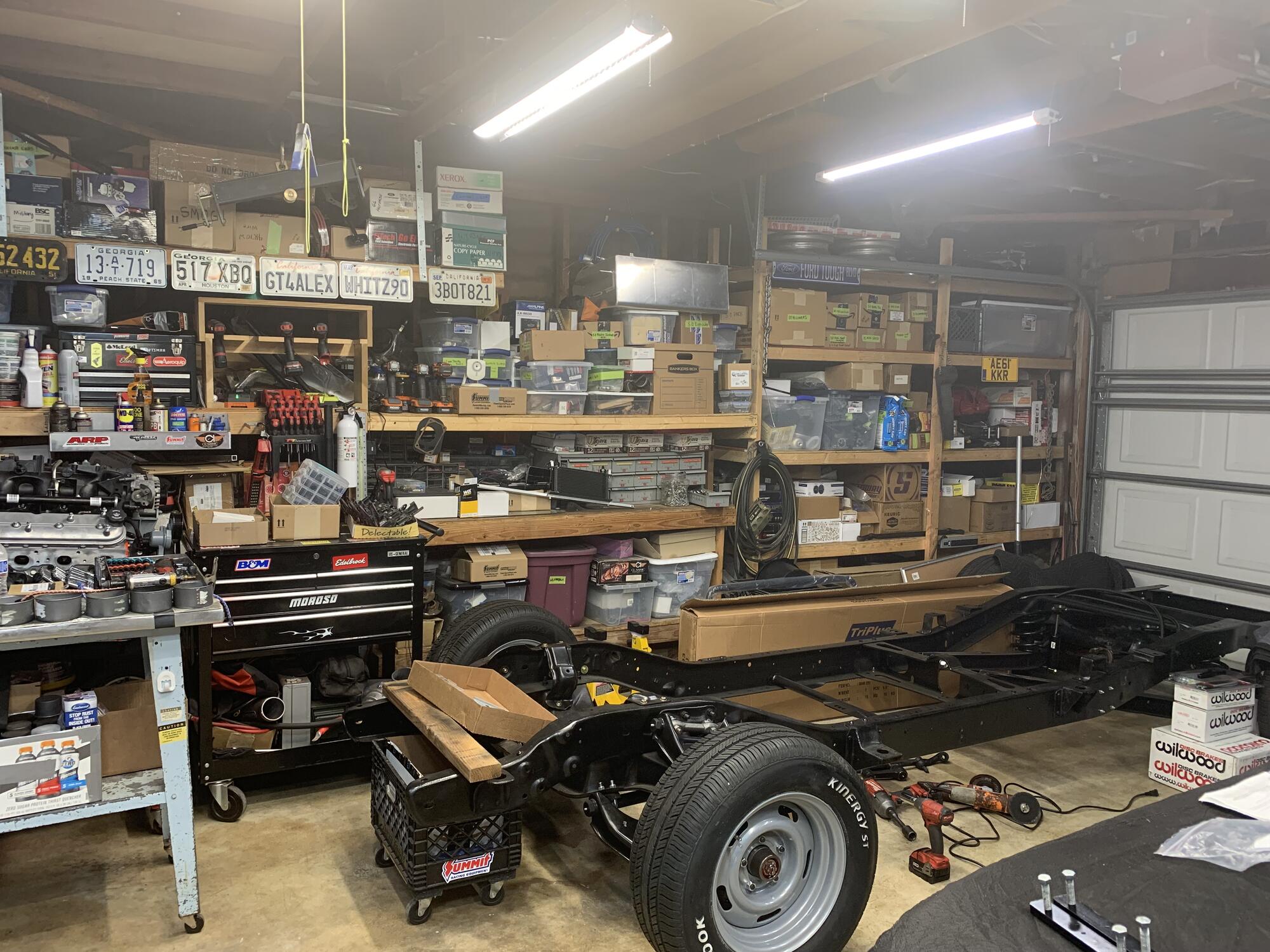

      Hi I am working on my 69 C10. I am going with a shop truck/ autocross style. The truck is purely for fun. I have coilovers front and rear. Want to know what size rims will fit without drama.... 20s wheel specs? etc

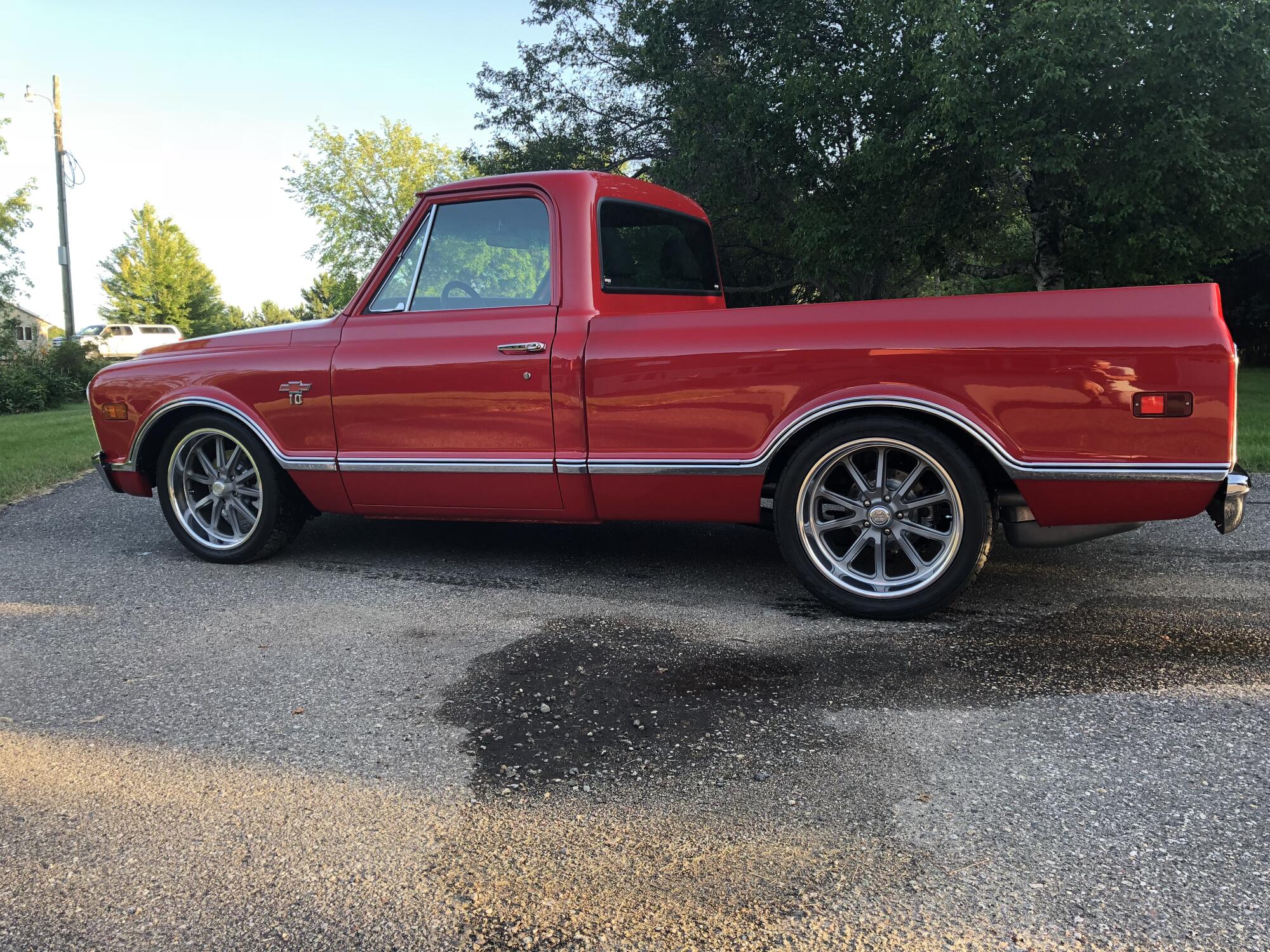

      I used US Mags Ramblers. 9x20 rear and 8x20 front. 285/40 in the rear and 255/40 in the front.

      I have American Racing VN205 20x8 in front 20x10 in back
