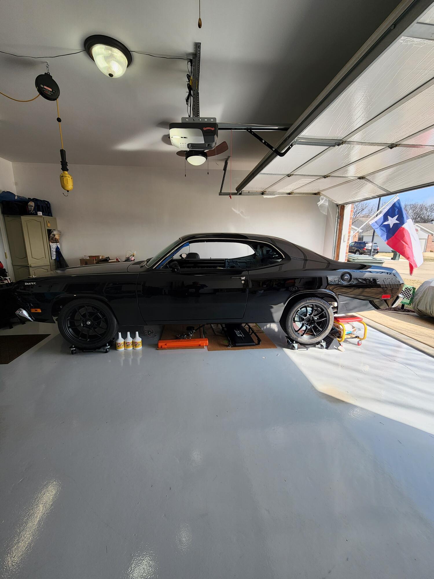

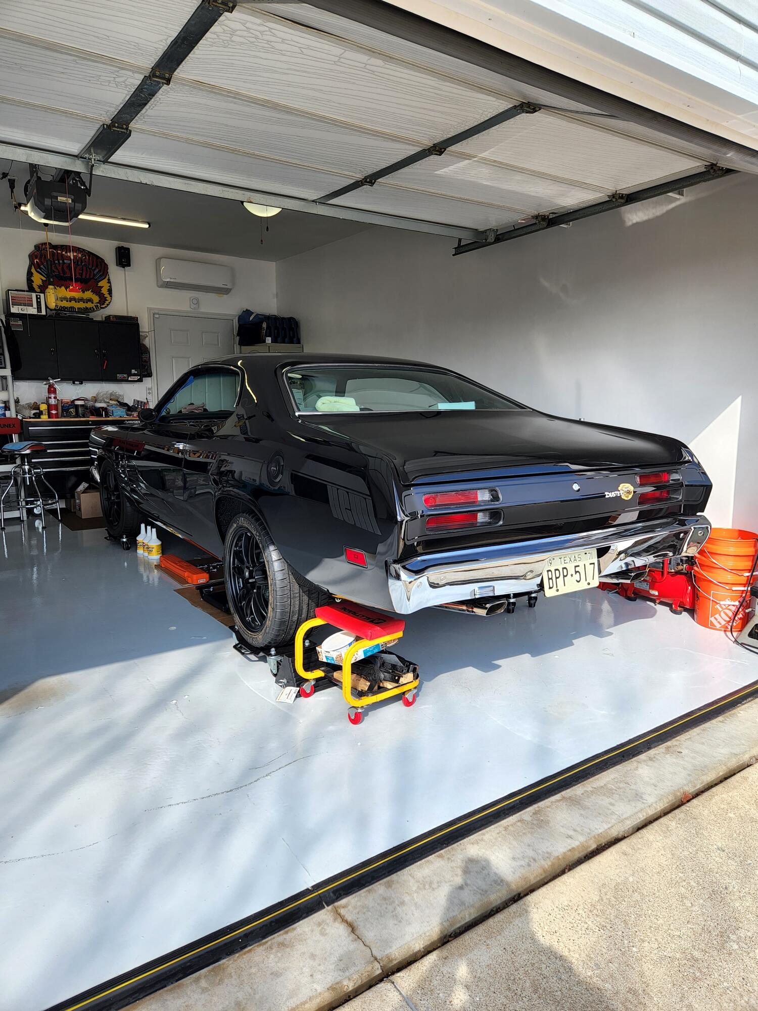

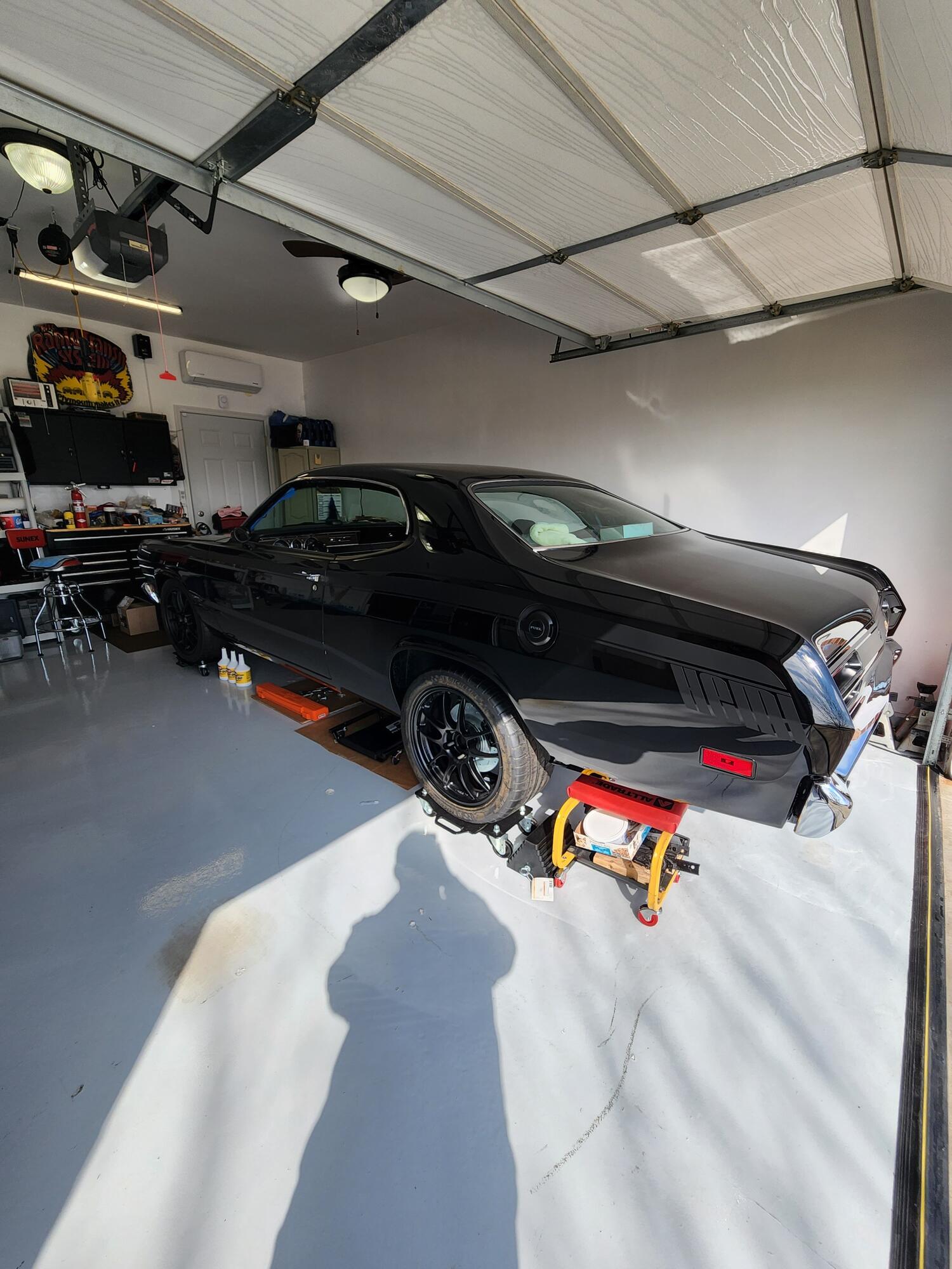

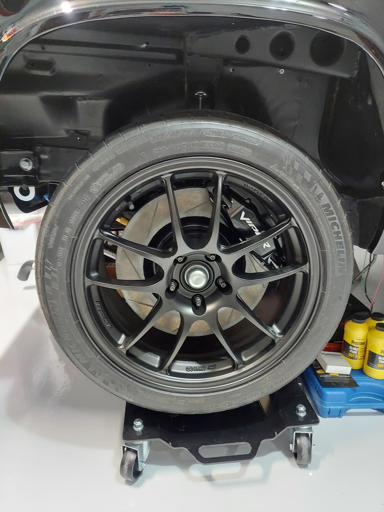

      Hi all,
      I'm nearing completion of my 1971 Duster with a 6.1 HEMI, Passion 5-speed, Borgeson power steering, Hydroboost disc brakes, big torsion bars & leaf springs with A/C, setup as a fun driver, autocross, road race, drag race car that looks good. It's designed to cruse all day on 93 octane at 74MPH @ 2500RPM, run around 118MPH at the dragstrip, handle well with Michelin 255/40s and 285/35s. I can't wait to get it finished as it's been a few years in the building!
      Brian
Size:  408.6 KBName:  20220308_100001.jpg
Size:  256.1 KBName:  20220308_095950.jpg
Size:  260.4 KBName:  20220308_095912.jpg
Size:  290.3 KBName:  20211208_122932[1].jpg
Size:  329.6 KBName:  20220117_182339[1].jpg
Size:  334.9 KBName:  20220117_182414[1].jpg

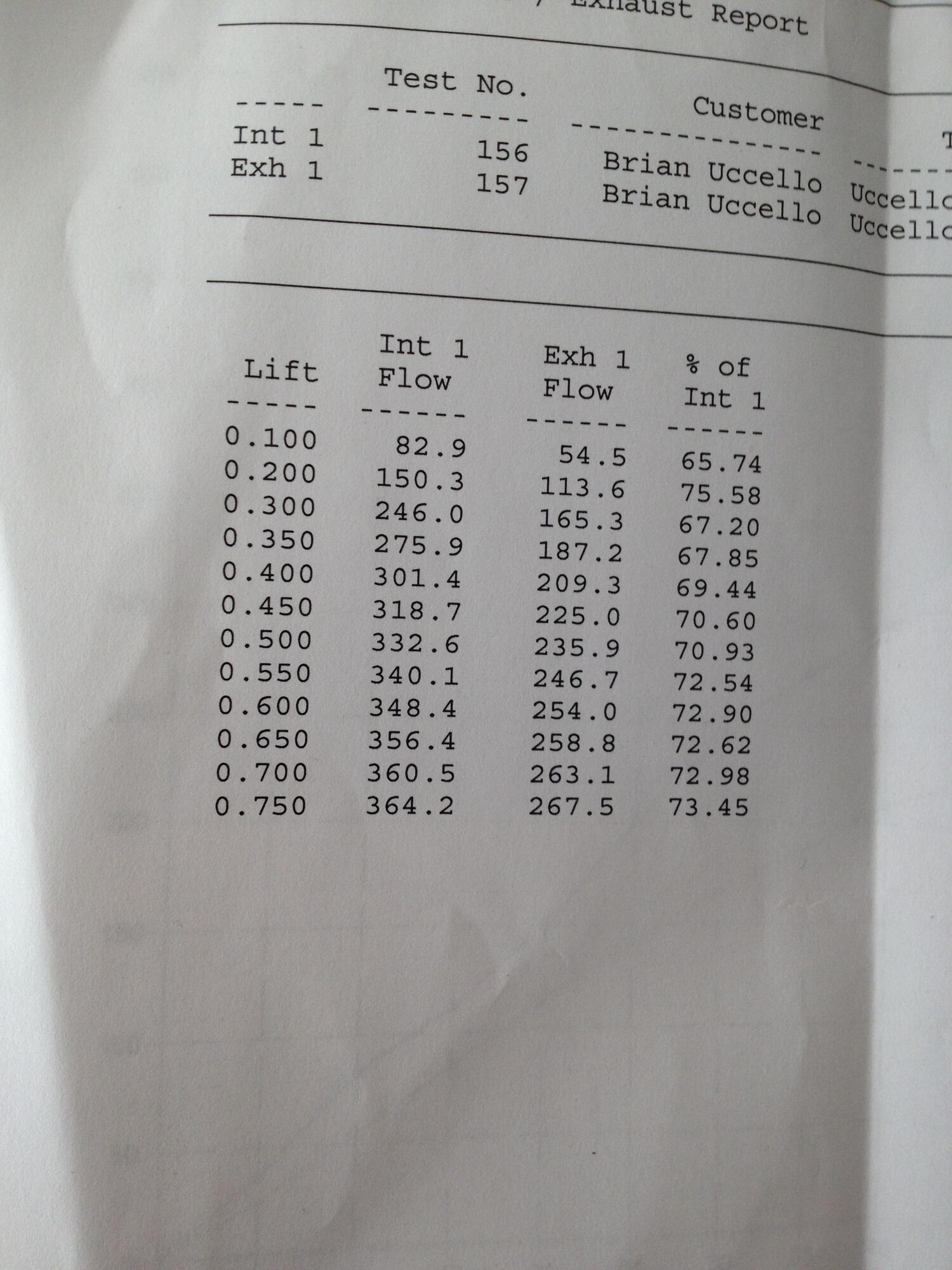

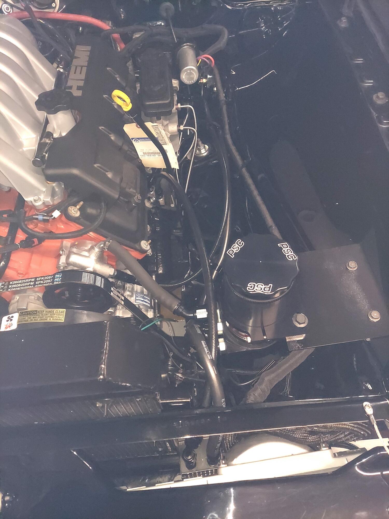

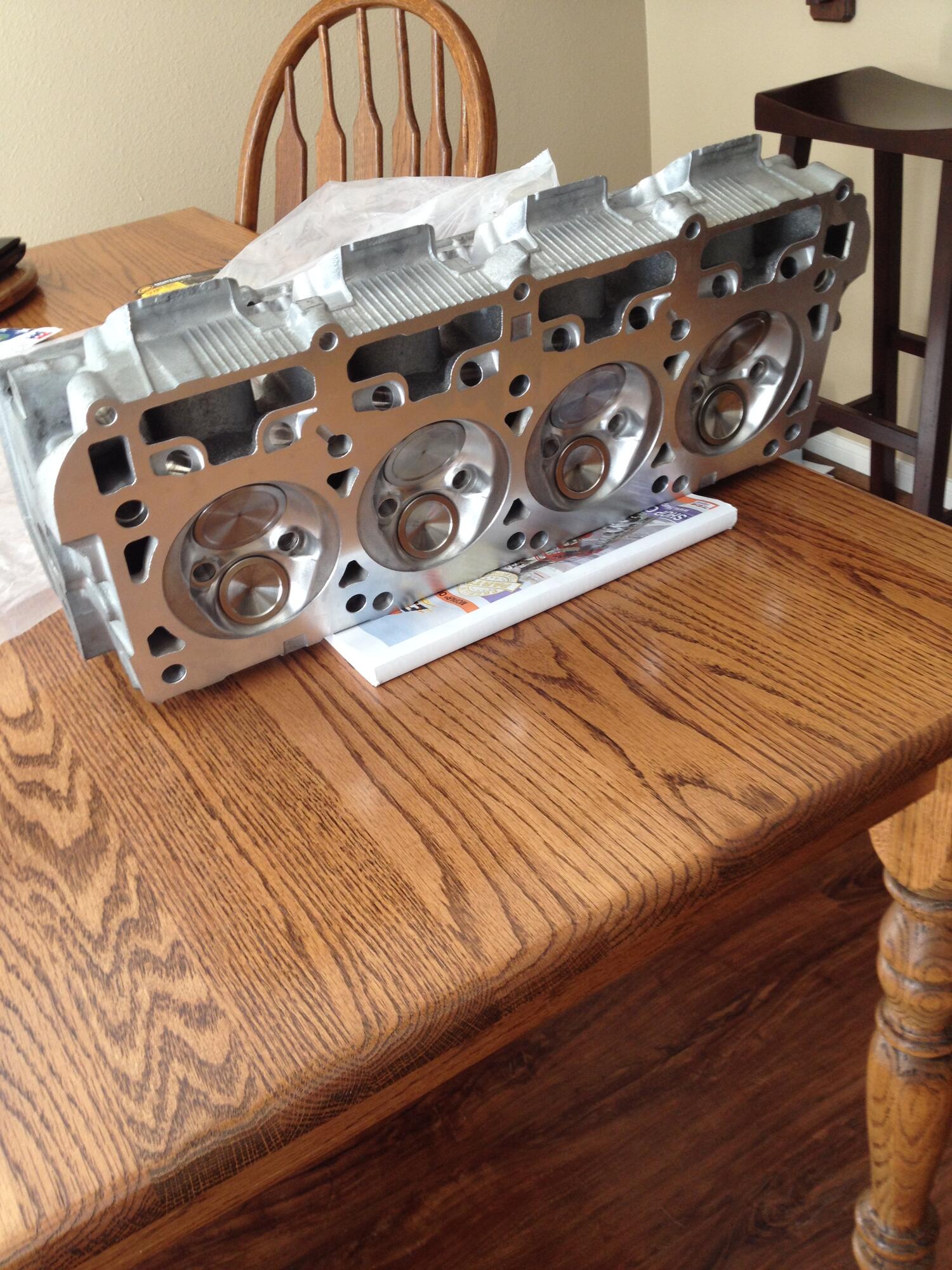

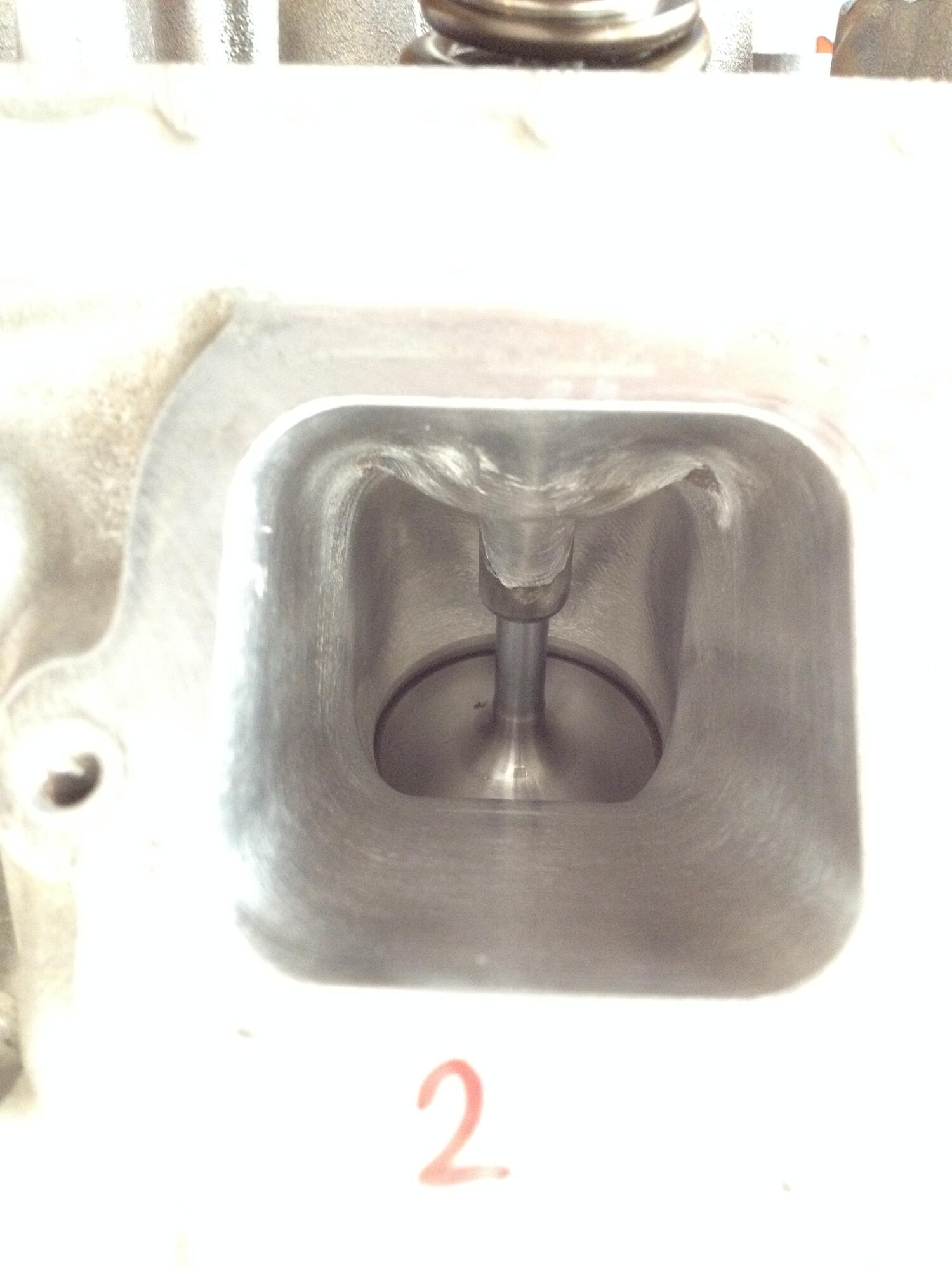

      stock cam and what ecu ?
      Mar 2022
      STL
      3
      Quote Originally Posted by oldschoolmuscle View Post

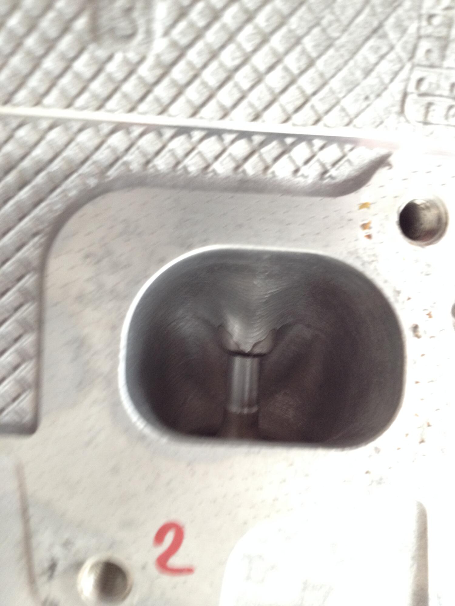

      Modified Frank Racing (Houston) 525HP recipe build
      Rebuilt 6.1 with ring gaps opened
      Camshaft: Frank Racing SCUUD (.219/.223) (.571/.574)
      EFI Source GEN III Hemi Gold Box
      tti headers & Pypes 2.5" X-pipe with Turbo mufflers
      85mm cable driven throttle body
      CNC ported heads
      The Duster should weigh 800LBS less than a modern Challenger!
Size:  156.2 KBName:  IMG_0558.jpg
Size:  186.7 KBName:  IMG_0557.jpg
Size:  397.2 KBName:  IMG_0559.jpg
