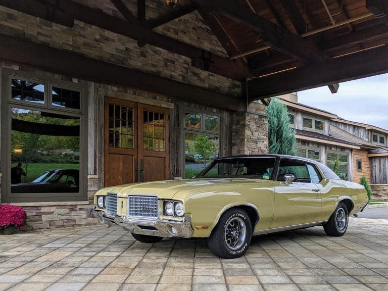

      well here we are. Installing with the rubber spacer on the bottom of the spring probably added 3 hours to the job, very frustrating. Im roughly half inch lower than ideal? Not sure if it can be driven as it sits.
      BMR upper and lower A-arms, G-comp 2" drop tall spindle, Hotchkis 1" lowering springs, GM 3789664 3/8" spacer, bilstein shocks, year one 17x9 with 275/40r17 square.
      Im afraid stock height spring might bring me too high. Ideal solution would be coilovers but its just not in the budget right now. Front look too low?

      i guess it depends on what look your going for. There's definitely more gap from the wheel to fender in back than the front, I don't think it looks bad, but if your going for a level approach then one of the sides needs to change. Have you considered taller springs and removing a partial coil to get the stance you want?

      The front looks too low; you'll be rubbing the front fenders on every turn. Comparing the front fender clearance to the what you have in the rear, I think the stock height spring is what you'll need. If it's too high you can always remove the 3/8" spring spacer for fine tuning. Also, you need to remember that that the car will settle over time as the springs have some weight on them. What might look too high immediately after install might settle down to the perfect height after driving it some.

      I agree that rear needs to go down or front up, doesnt look good as it sits. Stock height spring is probably the way to go. I have clearance lock to lock but any turning/body roll could create havoc.

      UMI stock height springs are here. Pulled one front spring to compare with the Hotchkis I have. UMI spring is 1 inch taller than my 1" drop springs, and has about 20 more lb/in rate than what was in there. Trying to decide if I should install with the 3/8 spacers or not. I am thinking no, that way I will be 2" drop front and rear. Considering old springs are roughly 15 years old at this point.
      I really dont want to install and then have to adjust either way.

      Thankfully i decided to not go with the spacers. Hope the front settles a bit.
      Umi stock height springs with 2 inch lowering tall spindles, bmr upper and lower arms in front. Bmr 2" drop springs rear.
      Unfortunately couldnt drive it yesterday because no fuel pressure. Need to solve that new issue.

      Looks good! the car will settle with a few miles of drive time...
