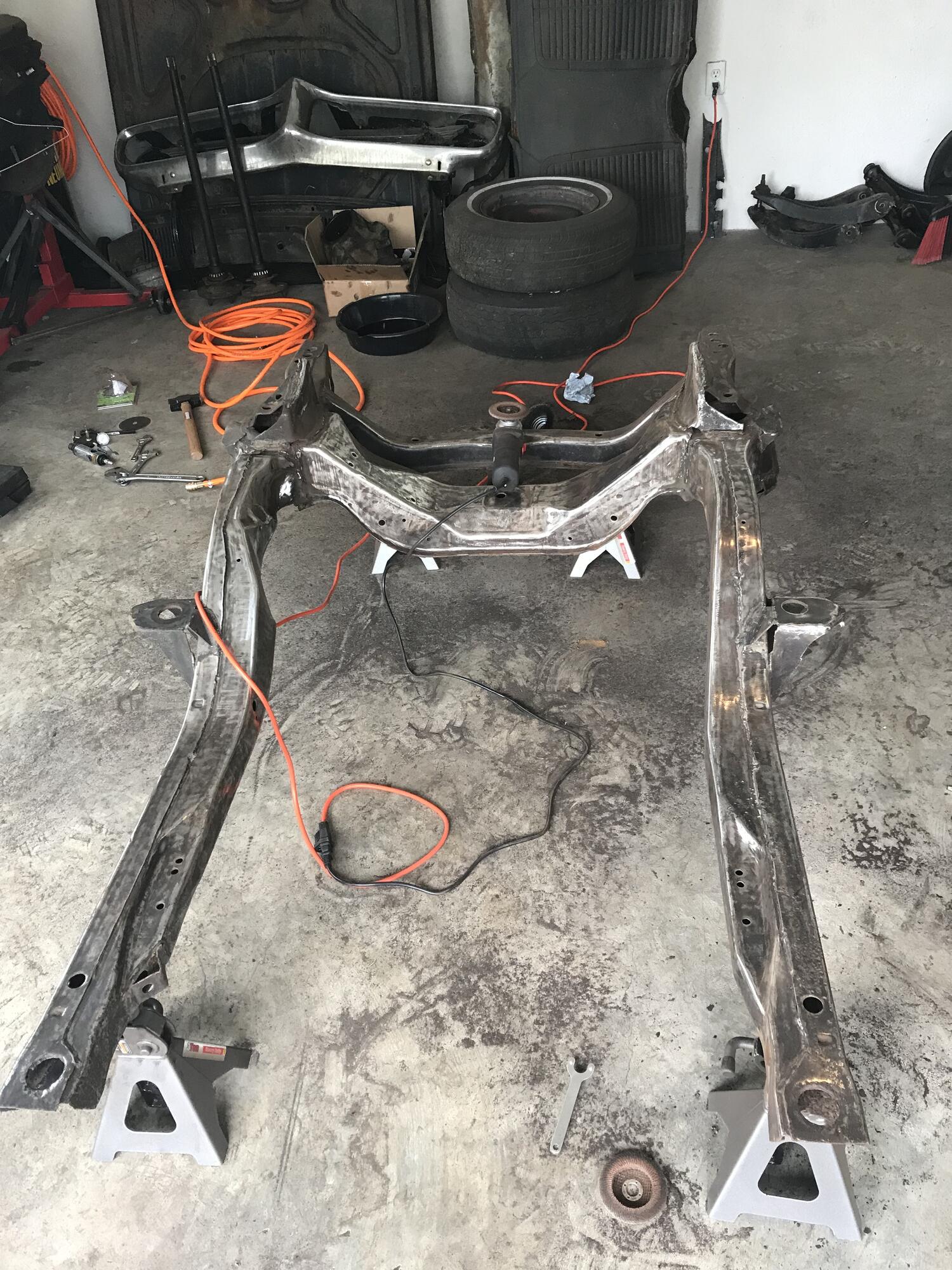

      I grew up with turbo cars. My first car was a 1991 Shelby Dodge Daytona turbo which is where the addiction began. I was stationed in Japan from 2003 to 2005 and man what a time to be there. I owned a 1990 Nissan Skyline GTS-4 that I tuned quite a bit. The car scene over there was just nuts at the time. I got to build and race just about every one of the 90's to early 2000's Japanese sports cars, great times!! When I returned from overseas, I picked up a 1998 Firebird Formula with an LS1 and 6 Speed manual. That is where my obsession with LS motors started. I ended up selling that when I got stationed overseas again. I was overseas for the next 8 years. During that time, I started scheming my next build. I knew I wanted a turbo LS with a 6 speed manual in a classic car. I knew I wanted a Pontiac but that was about it. I looked at a few different cars including a 67 Lemans which I loved but it was too long to fit in my garage!! The guy who had the Lemans had a crusty Firebird as well and as bad as it was... I fell in love. Thats where this journey began. I was a machinist and welder for aircraft in the USAF (aircraft metals technology) for 18 years, so I decided to do everything myself. It's been a heck of an undertaking.. just about 4 years in the works at this point. She was very, very, very rough..

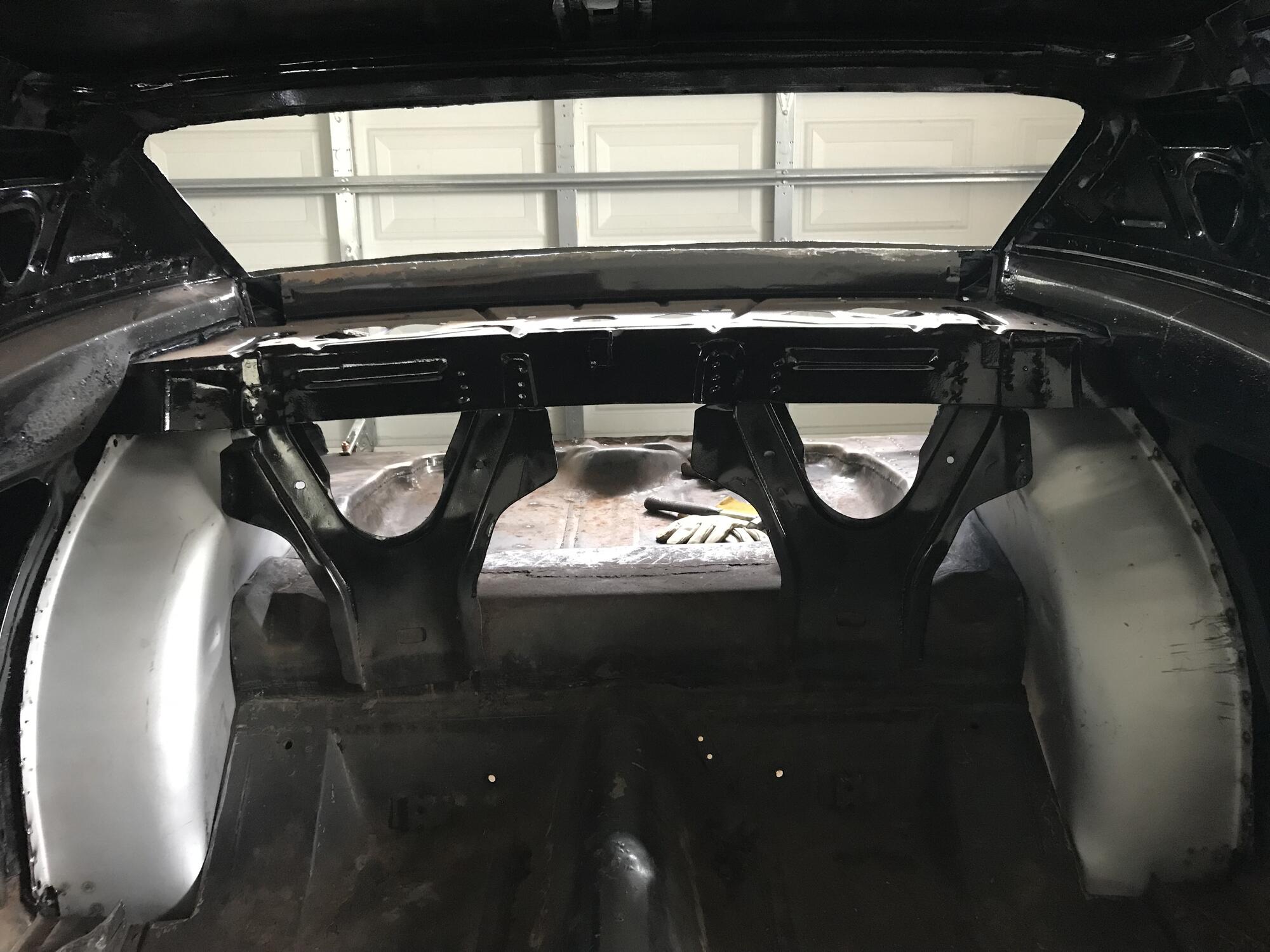

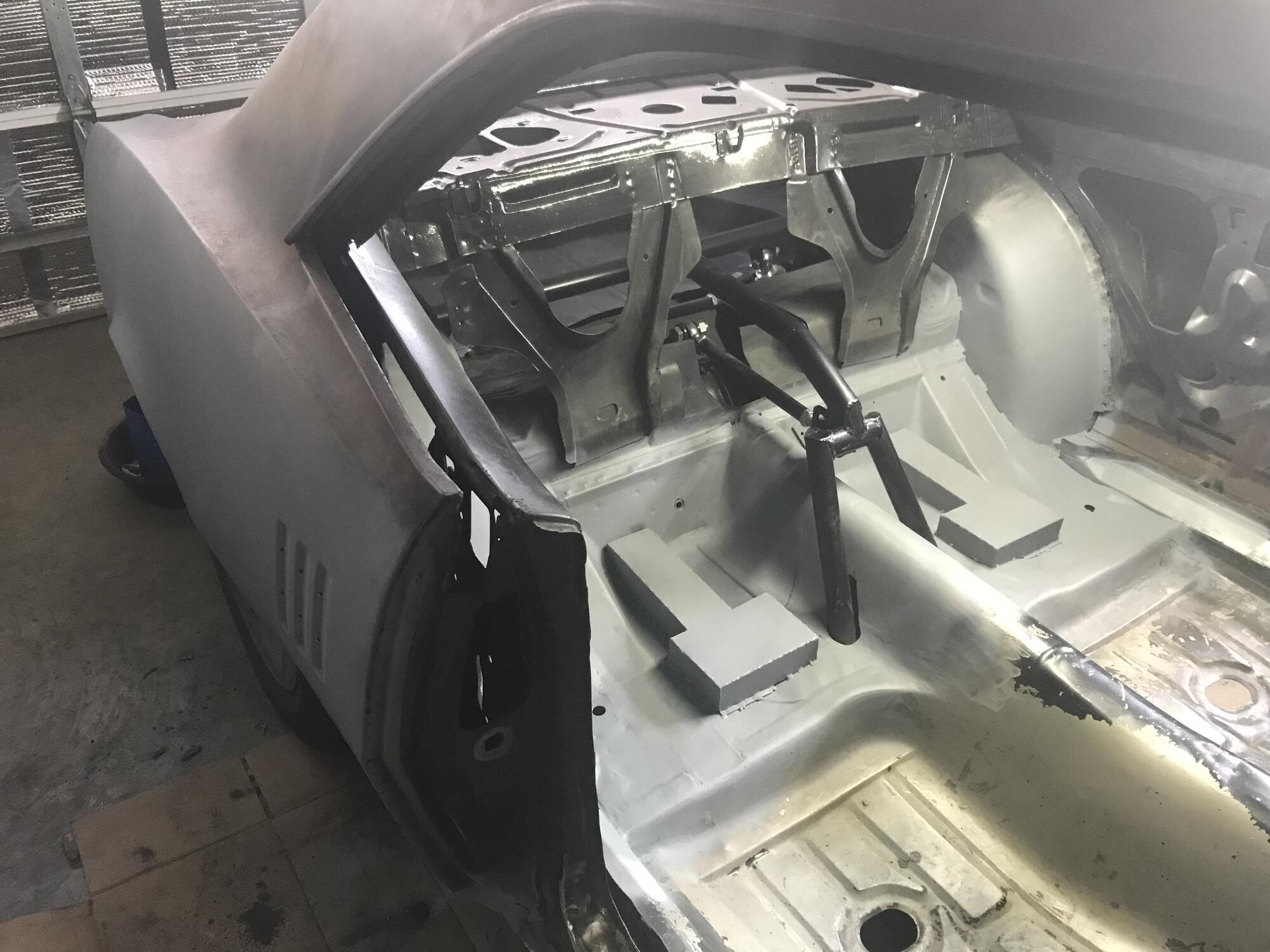

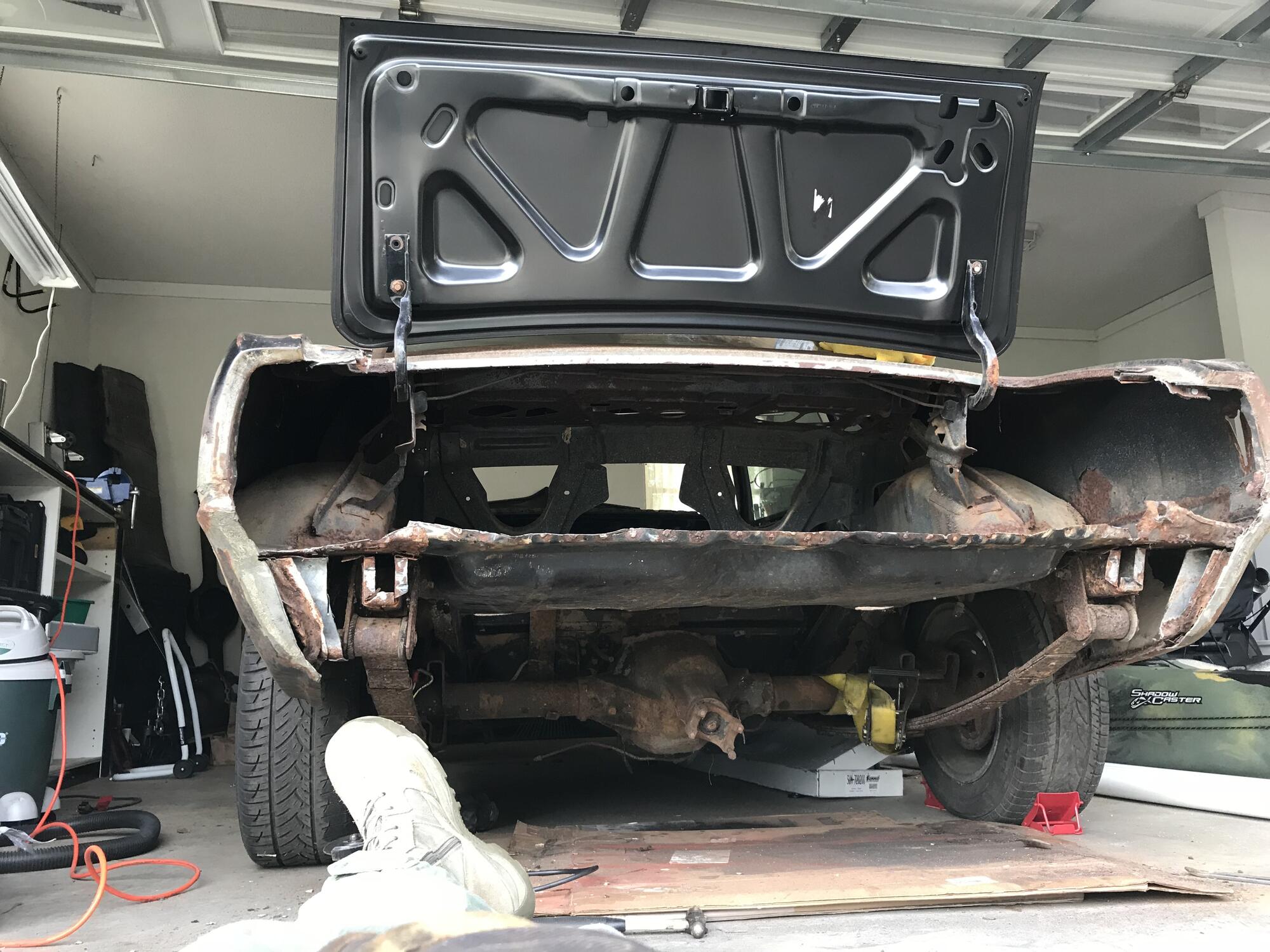

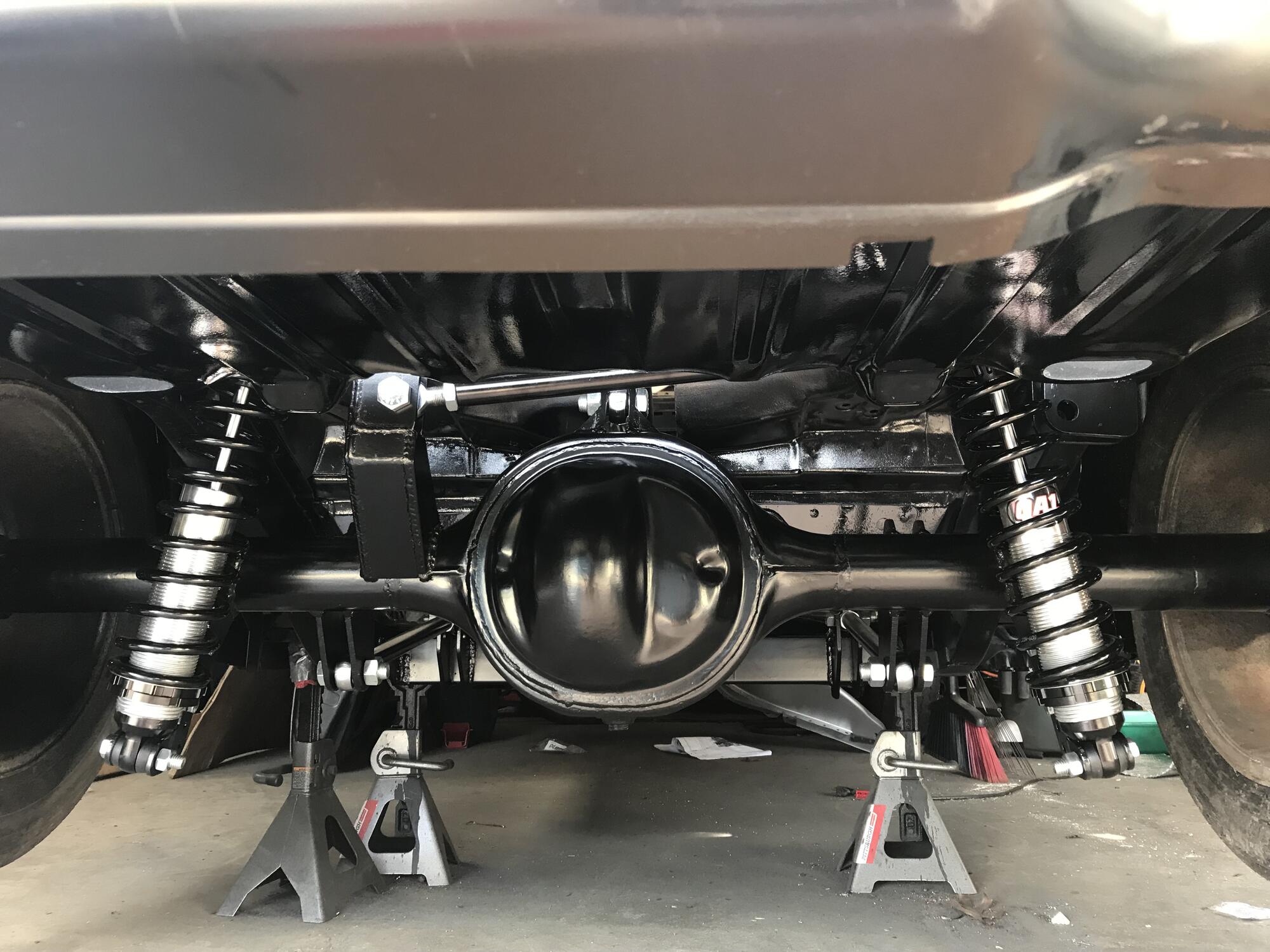

      Here I'm getting the mini tubs installed and fabbing a three linked ford 9"
      Wish I had access to a tube bender to have made things cleaner but sticking with the DIY approach, I made it happen with and angle grinder and a welder. Not pretty but very solid.Name:  IMG_0420.jpg

      Nice build. The three link looks interesting.

      Hey that's a great way to setup a 3 link man! At the time I thought I wanted to keep my backseat(I don't anymore) and it would have been way easier to go your route. Its kinda hard to tell how many holes the fameside mount has, but are you targeting a range of antisquat?. Between that and the panhard, that thing is going to be amwazing!
