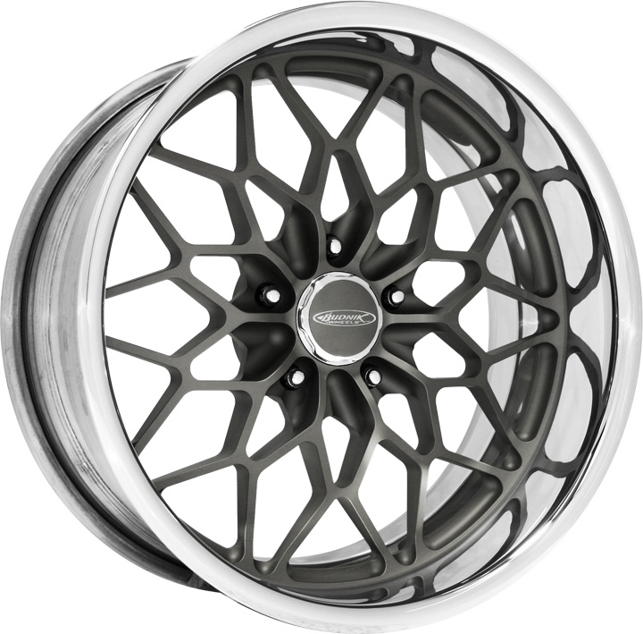

      Hi looking to rent a wheel measurement tool.
      Really wanting the Budnik Matrix for my bird.
      At these prices and custom to order wheels can’t afford to make a mistake.

      Sorry can’t help you with the tool, but those wheels are going to look SWEET on your bird!
      Feb 2006
      Phoenix, AZ
      215
      Those wheels are going to look so much better than the current ones.
      I would not change anything else on the exterior appearance though. What a beautiful car!

      the trouble with using one of those tools is that it only gives you a static view and with minimal suspension loading, it also completely ignores suspension travel and will give you a false sense of accuracy.
      What size tire are you wanting to install?
      What size is the wheel and it's back spacing?
      What suspension do you have?

      Quote Originally Posted by 79T/Aman View Post
      Understood, I would attempt to cycle the suspension too.
      I am thinking 20 x 10 or 11 if possible in rear, should be ~6” BS
      19 x9 front.
      Basically big as possible all around.
      Suspension is mostly stock, just lowering springs.
