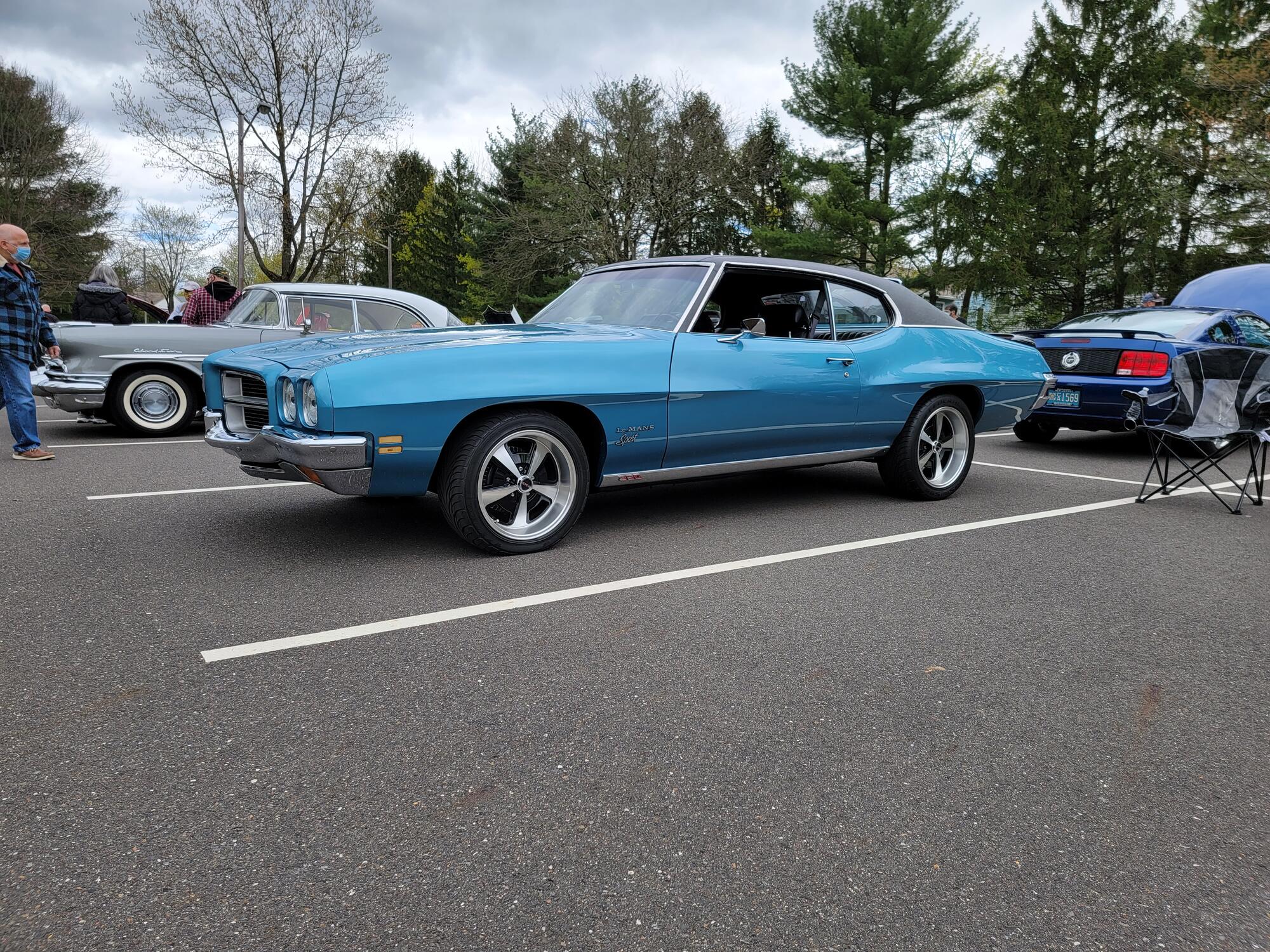

      Looking to upgrade my wheels to 18x8 with 4.5" BS front with a 245/45/18 tire and 18x9 with 5" BS with a 295/45/18 tire. Suspension is pretty much stock. Does anyone think I'll have any issues with this set up?
      This is my current set up, fronts 17x8 with 4.5" BS with 235/45/17. Rears 18x9 with 5" BS with 275/40/18.

      I've heard people run your current 275/40 18x9s rear setup on the front with 6-8mm offset (~5.25 backspace). Have you tried doing a temporary swap to check the fit? Same height as the 245/45R18 and over an inch more rubber. For the rear, since it's 1/2" per side difference from now, measure the clearance and it should give you a pretty good idea.
      I didn't think about that, but it's a good idea. Thanks!!

      Welcome! If it works out, something to consider would be running the same combo all around so you can rotate tires.
