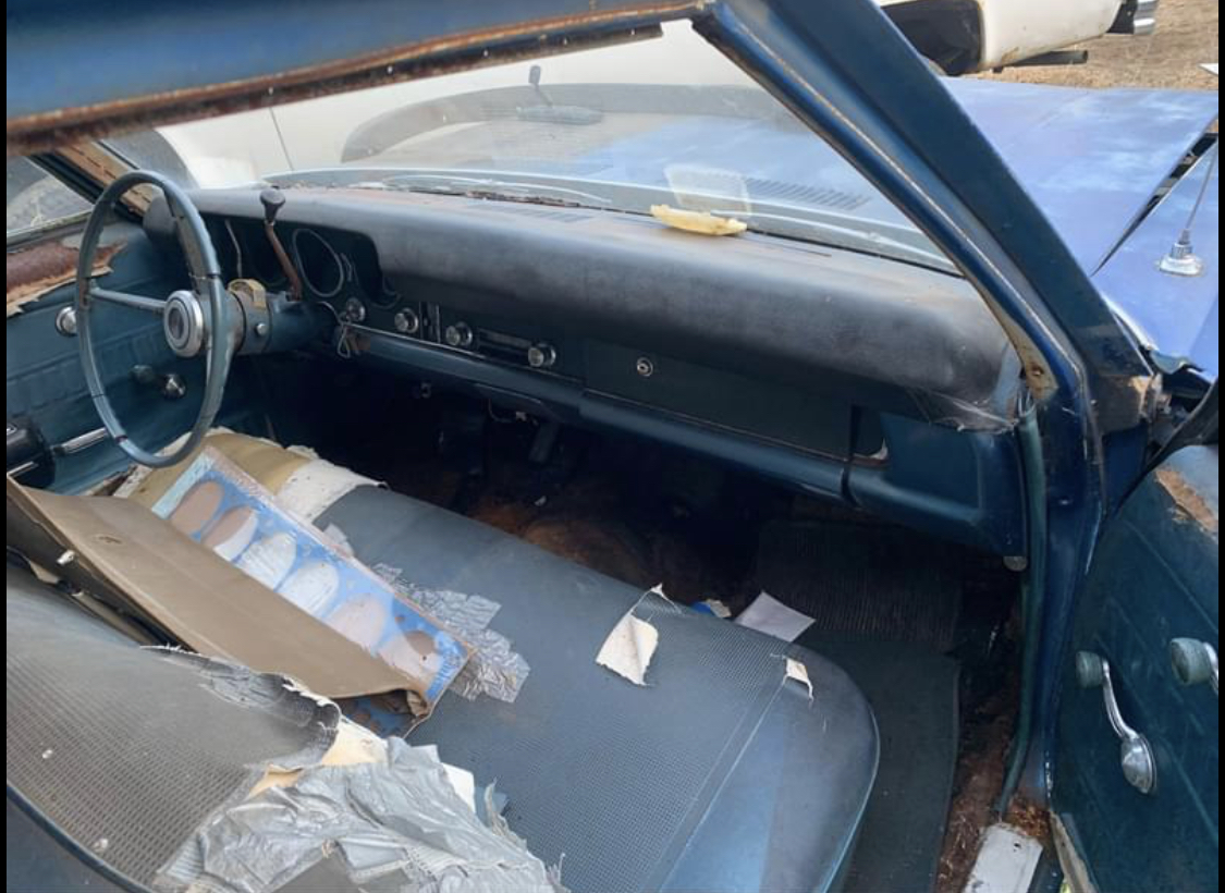

      Here's a few for-sale shots:
Size:  901.3 KBName:  IMG_3017.JPEG
Size:  680.7 KBName:  IMG_3015.JPEG

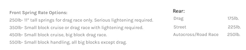

      Coil Over Spring Rate Questions
      I'm looking into a UMI suspension package for the 250 straight-6 '68 Wagon and wondering about spring rates. UMI reccomends the following:
      Name:  Spring rates.jpg
      The 250 L6 is around 440 lbs, small block around 535 lbs. And I may put a 292 L6 in it in the future, which are about the same as a small block. I may also add a/c to it - wich would obviously add weight.
      Considering the L6 wagon is 3,409 lbs and a small block 2dr coupe is 3,170 lbs what do you think would be appropriate spring rates? It's being built to be a daily driver and will be expected to carry stuff in the back on occasion, I want it to handle as well as possible without being too harsh.
      Thoughts?
      P.S. It's been over 3.5 years since my last post - I'm still in the conceptual/procurement phase of the project. In the mean-time I've built a shop and crashed my '72 Chevy pickup. So, the pickup is now in the garage. When it's fixed (and long list of long-delayed upgrades done) I'll get the wagon in and start in on it.
      2,624
      To handle well you need to address the factory geometry shortcomings of camber gain, bumpsteer, and available static caster adjustment. This usually means taller ball joints or taller spindle, adjustable tie rods, and aftermarket control arms with built-in added positive caster. Their Stage 4 kit seems to cover nearly all, except the bumpsteer. If you're not going to track the car, then it's probably fine without the bumpsteer correction.
      Of those spring choices, I'd do 450 front/250 rear to balance the wagon's extra rear weight. Limit the rear drop to 1" so you have decent suspension travel. Double adjustable shocks, so you can tune the firmness vs ride. If you plan on any towing or adding serious weight in the back, consider some airbags that fit in the rear coils and can be aired up as needed. Also, don't forget to take advantage of the rear adjustable sway bar in the kit, so you can dial in the understeer/oversteer balance.
      Some 26.7-27" tall tires all around will give a little extra road clearance and fill in the wheel gaps to make it look lower, while keeping a decent ride on 18s. If you can fit a 275/40R18 all around that'd be a great setup so you can still rotate the tires. Otherwise, if you need to go smaller on the front, do a 255/45R18 / 285/40R18 stagger (should fit with the correct backspace).

      Quote Originally Posted by 68Formula View Post
      We're on the same page. I'm planning to use the UMI Corner Max setup with the taller spindles and bump-steer kit, along with the Pro-Touring rear suspension kit with all the frame stiffeners, sway bars to match - along with the double adjustable coilovers. Thanks for your input on spring rates, much appreciated.
