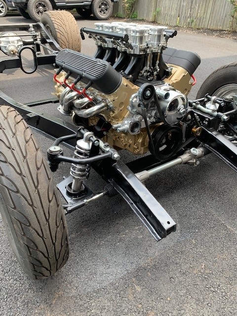

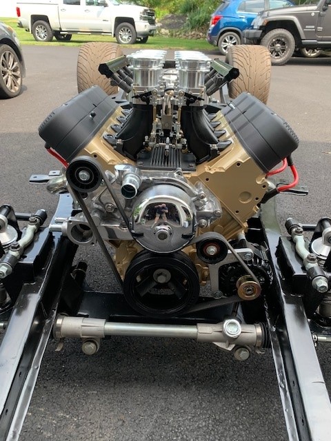

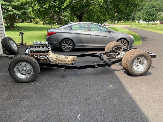

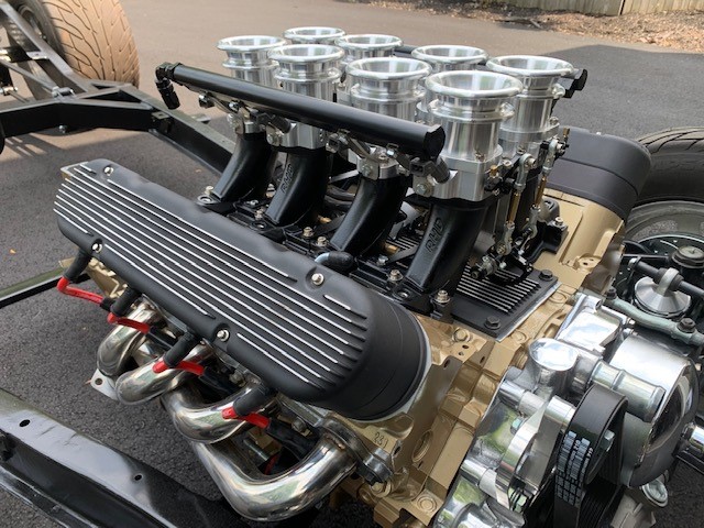

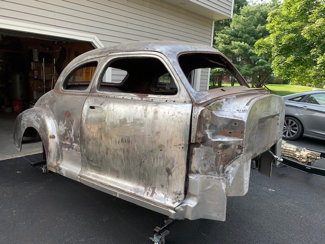

      Big fan of the sight and a lot of great information on here. I had a 66 Mustang Twin Turbo on here a few years ago so I hope this build is forum appropriate. Used the 1947 frame, added a mustang 2 front and cut off the rear, added 2x4 rectangle and added the 4 bar for the narrowed 9". It's a 98 5.7 with a T56 and the Direct Port is from Racehead Engineering in Australia. Working on the body now. Widened the stock wheel wells 5". Shaved drip rails and Kindig handles.
