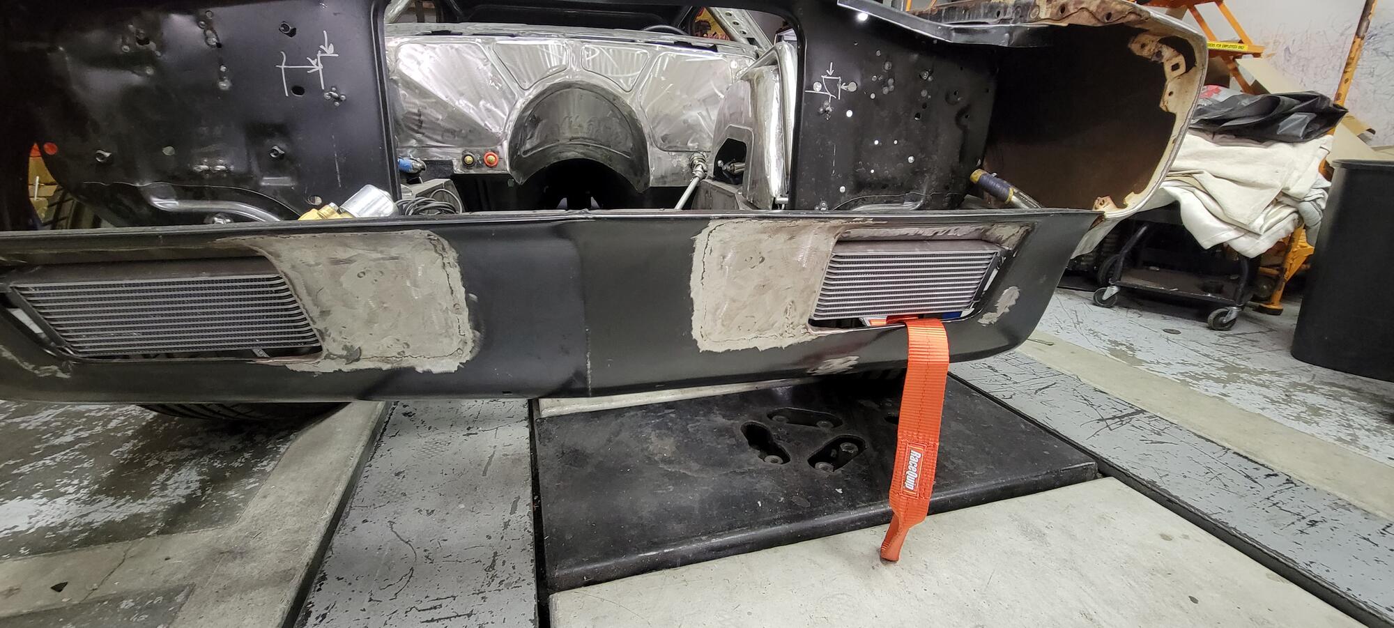

      I used a racequip tow strap. It's just mounted to a simple 3/8 L bracket. I plan on just tucking it away when not in use with a simple hair tie.

      Good idea, but don't think you will like the results if you have to get towed? Think about how your car sits, envision a rollback or someone with a winch / trailer hitch pulling on that strap. If they're not at 100% correct angle the entire time you're hooked up, you're going to lose a cooler, bend the roll pan / crack paint, etc. The right angle bracket is also in danger of bending. Imagine being pulled, some slack goes into the line, then tow vehicle starts to accelerate, slack gets taken up and there's a large load on that bracket. Since you have the bolt attachment so far away from the frame, it's increased it's ability to put torque on that 90 degree angle, no bueno mi amigo.

      The strap is for a flat tow at the track not flat bed. Underneath on my frame is 2 eyelets for flat bed towing. At the rear I also have a Racequip strap for flat tow and 2 eyelete tie downs at the axle.
      It's hard to see in my picture but there's room between my cooler and roll pan. The strap is mounted lower then the cooler which puts it at an upward angle up and away from the cooler and roll pan. I'm using a grade 8 bolt and lock nut that are only tightened to a point to allow the strap to pivot freely.
      He never specified flat tow or flat bed tow truck tow.

      So yes I am only looking to make something for towing off the track. That said they commonly use a tow strap to a recovery truck. Therefore there can be a less than perfect angle for the initial tow back onto the track and there is a very tight turn on the pit out road.
      I like the strap idea but would want to make sure it is solid enough from the frame connection to the strap connection point.
      Having a removable solid eye or ring of some kind projecting out is fine too.
      I appreciate all the ideas. I know lots of people have done them so hoping to see some more.
      OK, to be transparent. I did have a mechanical at the track which required me to get towed (with no hook). Luckily I do not have a spoiler on the front (Yet). That allowed us to loop the lower subframe brace in the center. This worked fine but I need a better setup.
