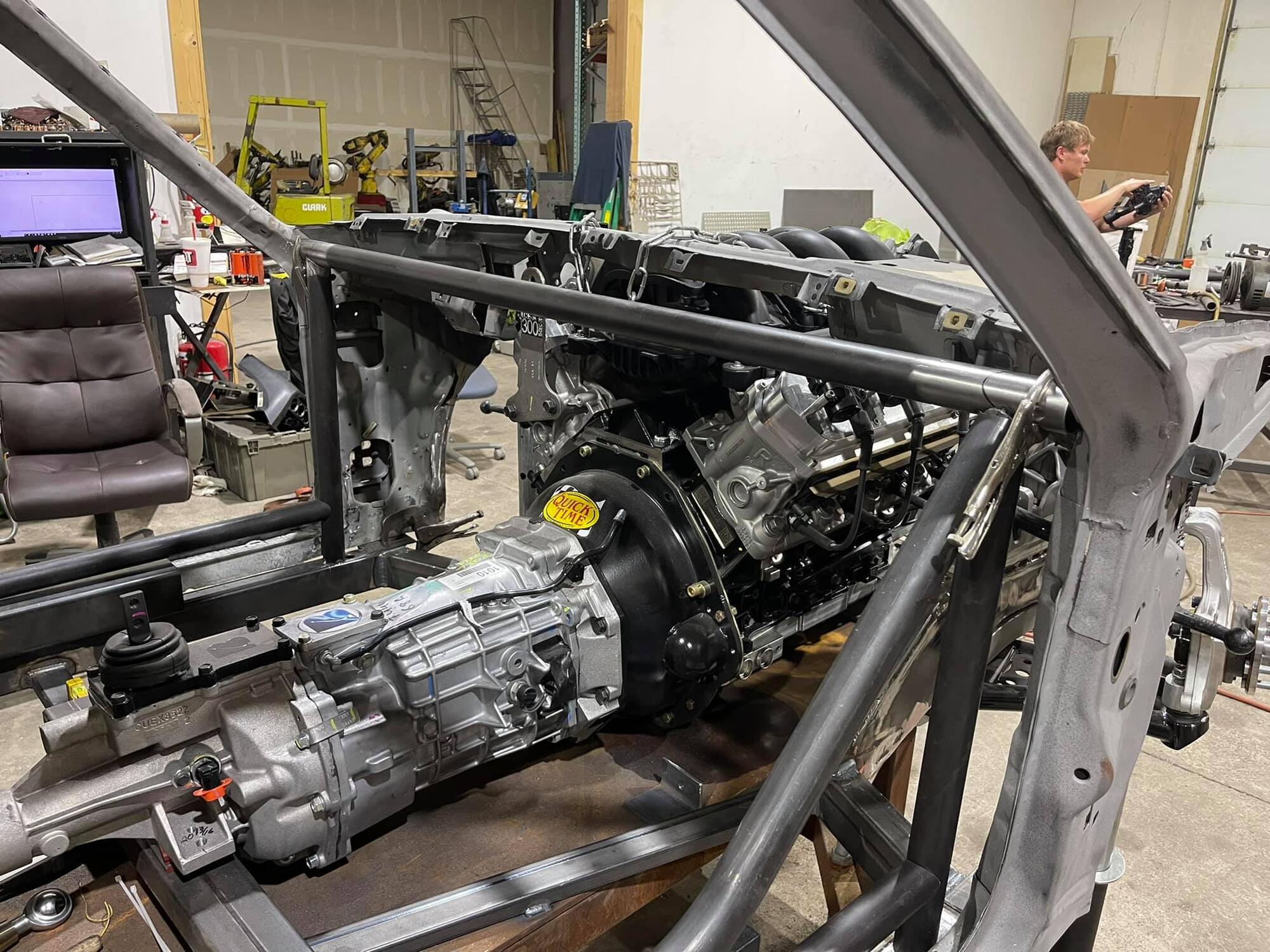

      We had it running yesterday on an ECU Masters BLACK unit. Sequential fuel, but wasted spark as the ecu only has 6 coil drivers.
      Strangle enough the crank reluctor is a 60-2, while the cam is a 4 tooth (two long, two short). Fortunately we found the ECU Masters had a cam and crank profile already available that worked.
      The only issue is the throttle body does not output a variable voltage signal. It transmits a SENT digital signal, which we’ve found not many support. So I’m printing an adapter to put an LS3 throttle body on it for initial testing.

      The motor going in the Foxbody has the Indy Power Products front drive kit and oil pan. It replaces the OE oil pump, which is located in the pan, to behind the front cover.
      This allows the pan to be extremely shallow, and negates the need to control the variable pump.

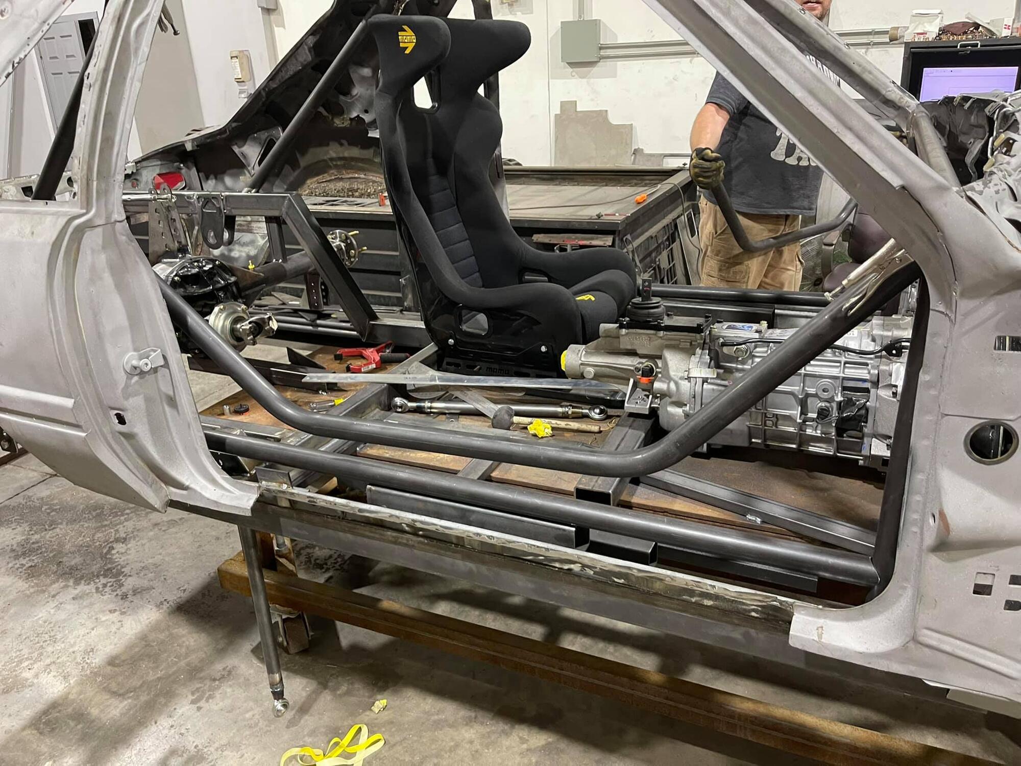

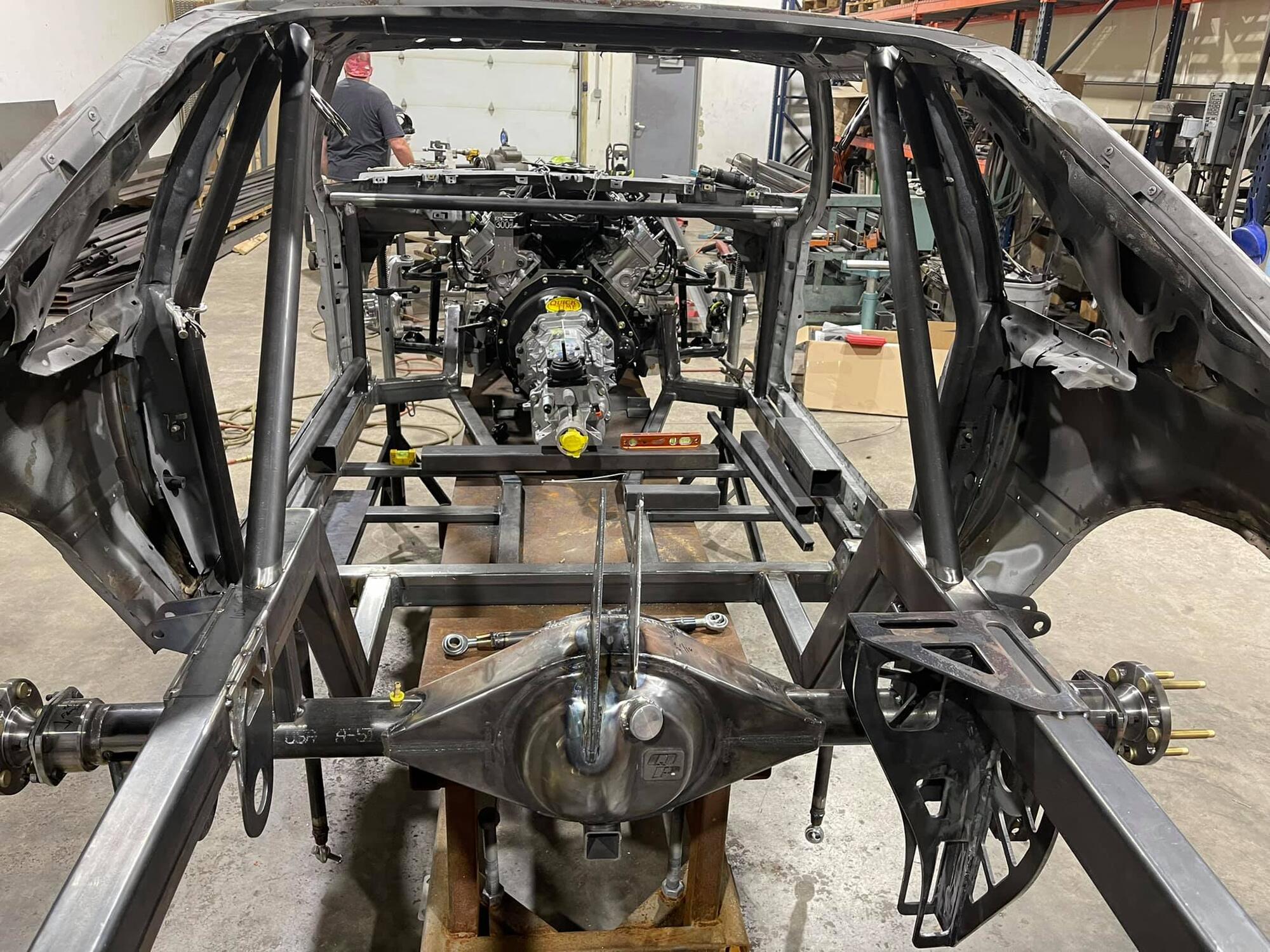

      We're back and 9 weeks away from the SEMA Show.
      We've got a buttload of work to get done on the Foxzilla before we get to pain.

      Wow, you guys aren't messing around! This should be a beast!

      Impressive build!
      Interesting how you have used the front rails from the older car to get the DSE front suspension in there. Very cool!

      That is one thing that is a bit interesting with the DSE kit, is we had to blend in the front frame rails to make it work.
