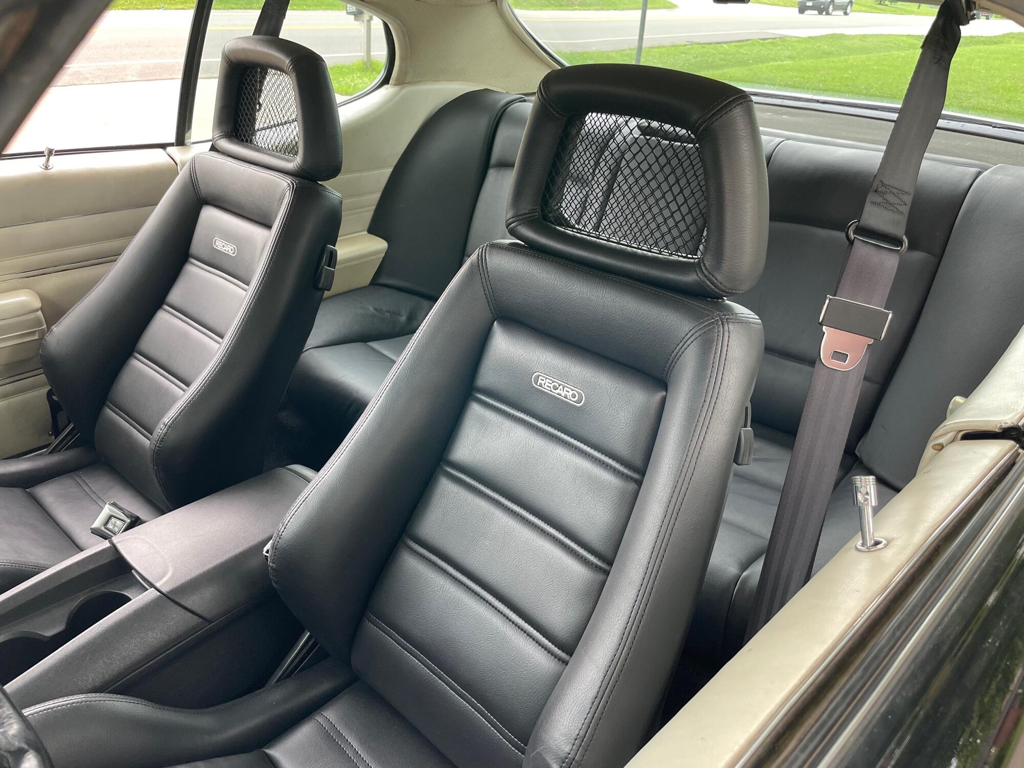

      I just put recaro ls seats in my 71 Lemans and couldnt be happier. I used wedge mounts and sliders and the seating position is perfect. I also bought a set of wedge adapters and sliders to put my recaros in the 73 Bird but am still working on other portions so have not test fit them yetName:  IMG_0270.jpg
