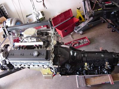

      I would rathe have an understressed, overbuilt unit like the 4L80E than an overstressed, overbuilt unit like the 200R4. I guess it depends on whether you expect to rebuild the tranny every season or two, or expect it to last for 60K miles without any major service. Remember the big block is putting out the torque all the time, whereas you need to be jumping on the V6 turbo to get their ungodly torque numbers. The rest of the time they are driving around like a normal V6.
      As far as the TH400 and GV Overdrive, at that price level you are easily on a par with a built 4L80E with controller, and you are getting a way more flexible and programmable package. My total, without a good 80E core to send back to Hughes, was $4800. A $500 core would have given me back about $400 (Hughes charges $1000 for a core charge) after shipping them the core.
      There's even an E-trans-brake available for the 80E now, through Rossler.
      Here's a pic:
