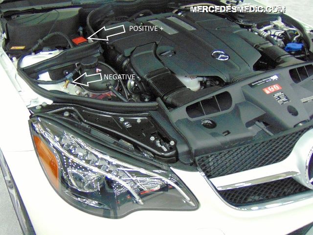

      Another trick is to mount a jump post under the hood- near the starter- Starter gets full juice and easy to get to.
      Richard
