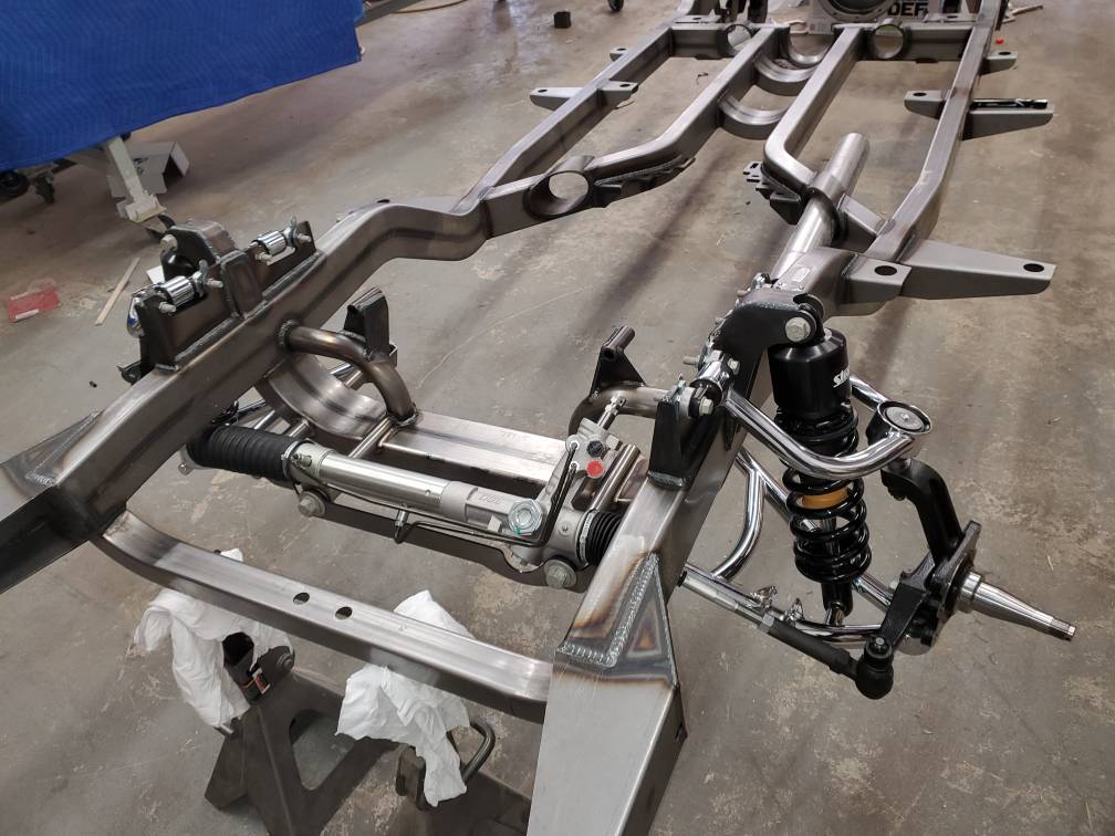

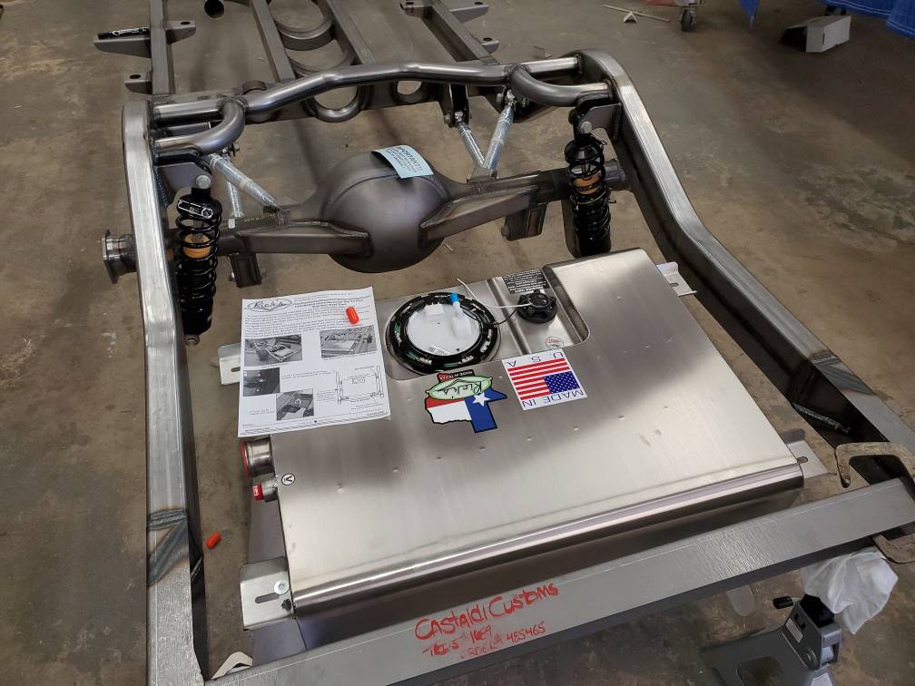

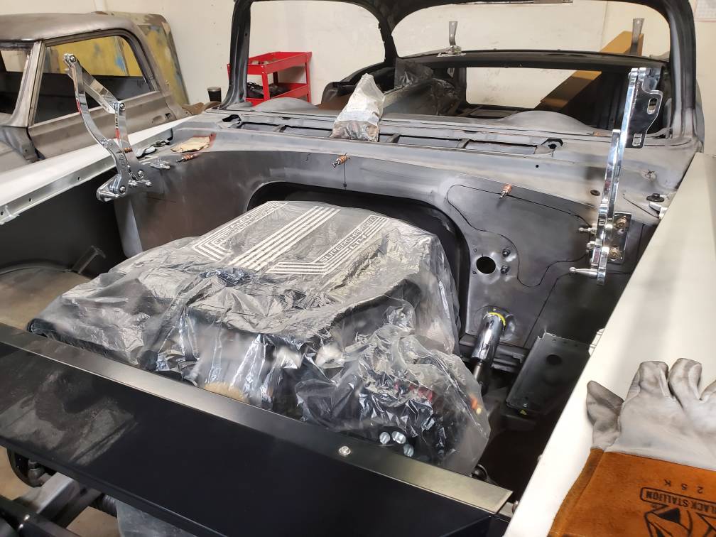

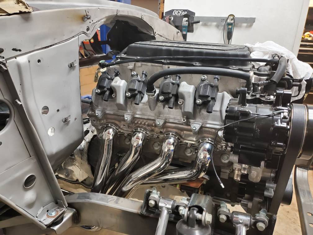

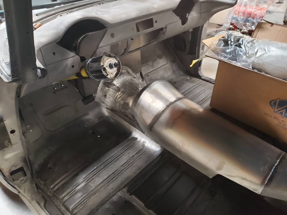

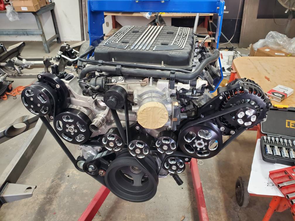

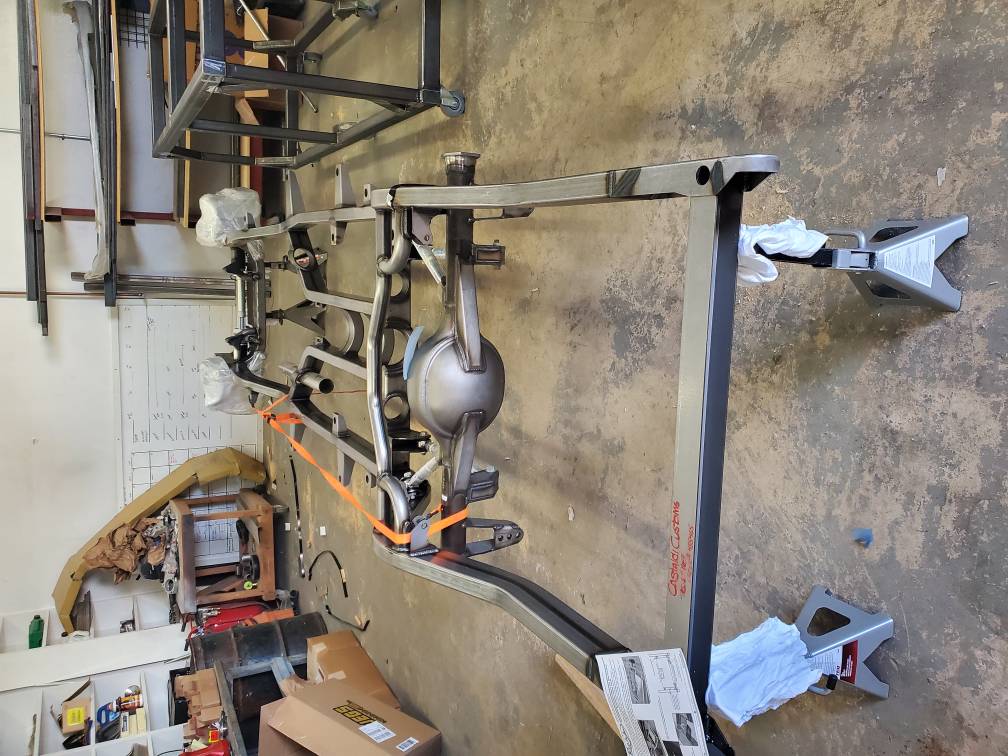

      So, this is my third project, 56 Bel Air, that I have built. My 67 Camaro was a nice driver, my 55 Chevy truck came out really nice, and hoping to take everything I've learned and put it into this build. Using a 2018 ZL1 LT4 and 10 spd, Morrison chassis, 9" rear, wilwood 14" 6 piston fronts and 12.5 4 piston rears. Body was rougher than it looked so replacing some panels. Mini tubs already done. Firewall and trans tunnel next along with custom inner fendersName:  Screenshot_20201028-121400_Facebook.jpeg

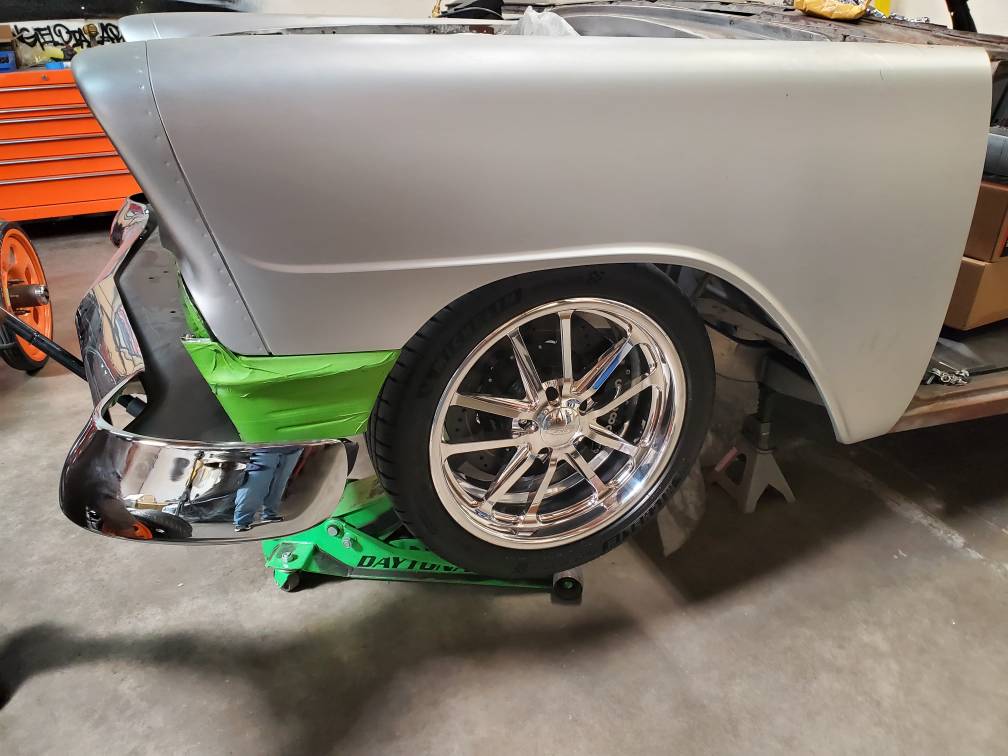

      Thanks guys! Getting a little more doneName:  20210419_151408.jpeg

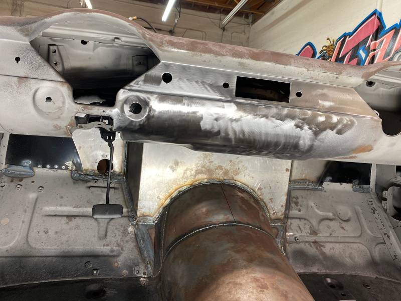

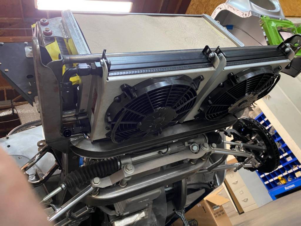

      Mar 2015
      Phoenix, AZ
      111

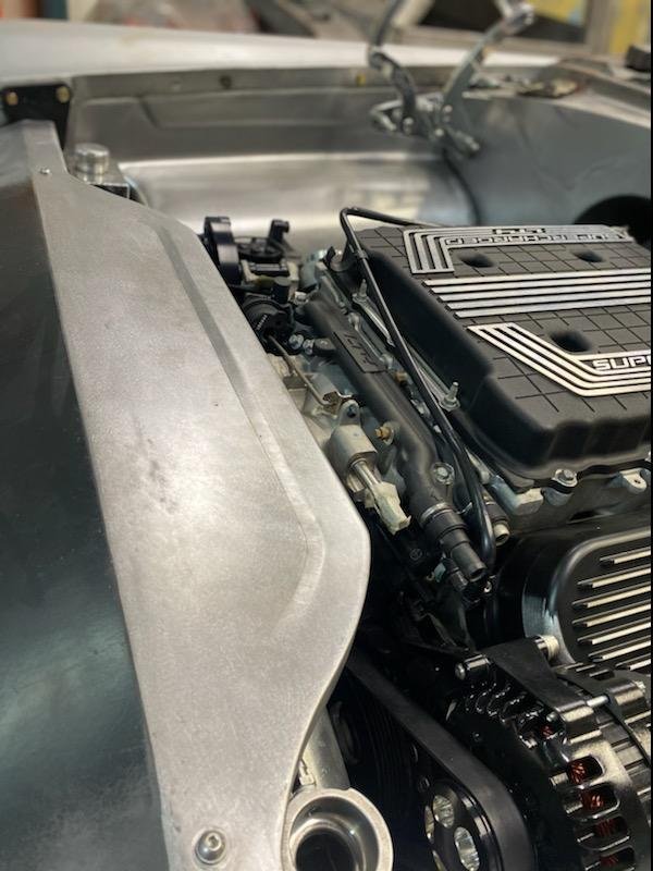

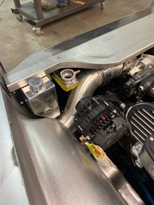

      Getting the firewall and tunnel started. Also figuring out the intercooler mounting and inner fenders Name:  20210429_094724.jpeg

      Really nice work. Love the intercooler brackets.

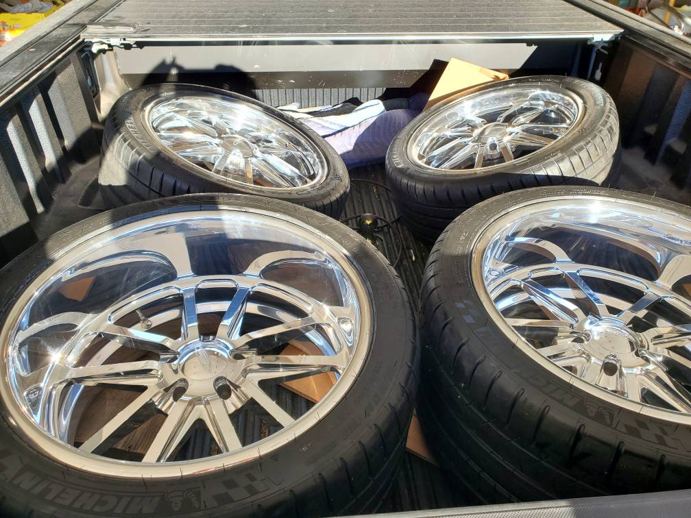

      Wheels arrived and had tires mountedName:  20210921_170526.jpeg

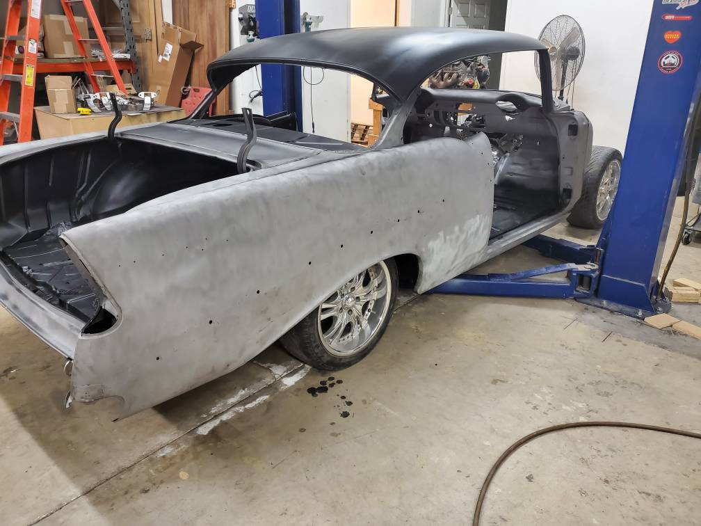

      Thanks...just about ready to send to paintName:  IMG_3340.jpeg
