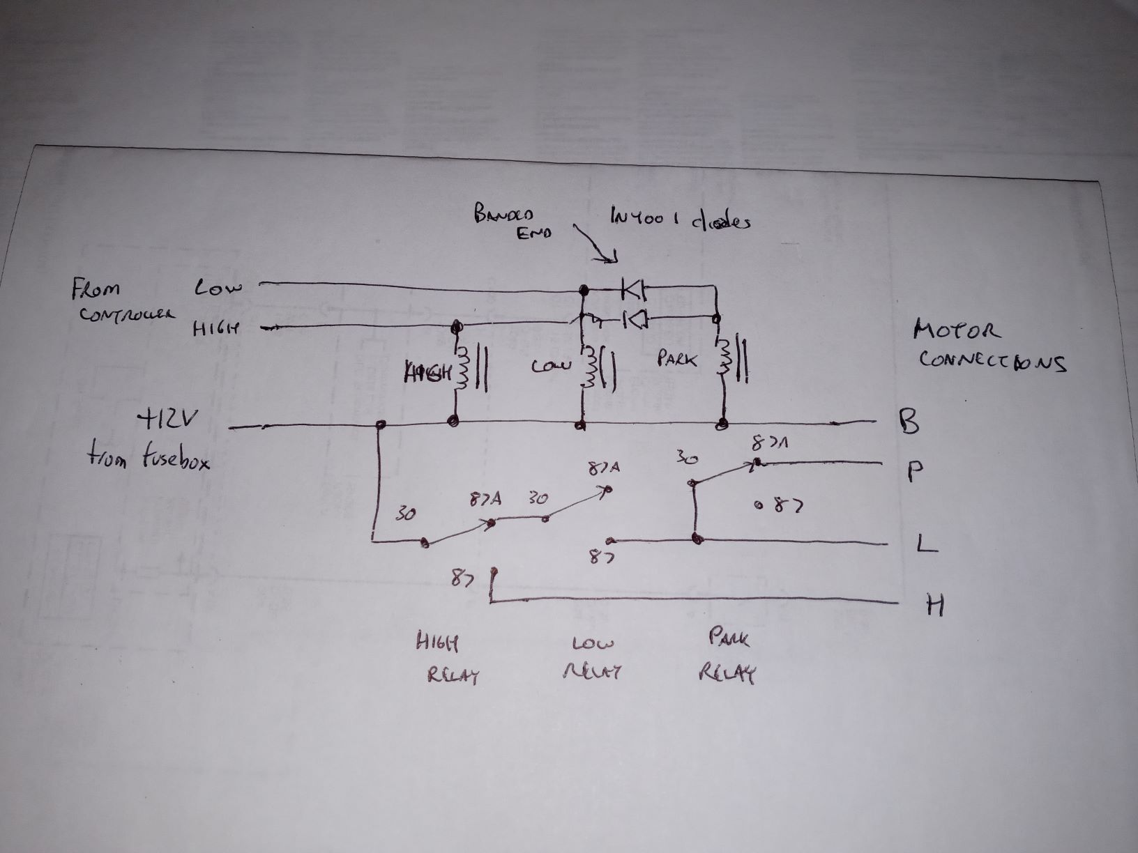

      Did some research on the rotary wiper switch supplied. It's from Cole Hersee/Littelfuse. Part # 75228-03 or 04 I believe, for dynamic parking motors. The Raingear motor is a dynamic parking type. The datasheet shows the switch positions and terminal continuity for each position. I double checked on a switch on hand, matches datasheet information. I devised a circuit using 3 SPDT relays and 2 1N400x series diodes.Name:  wiper motor sml.jpg
      Operation is:
      Off or Park, with no outputs active on controller, PARK relay is not enabled. Motor terminals P and L are connected. (rotary switch, P-L)
      High, High output active on controller, HIGH relay is enabled. Motor terminals B and H are connected. Also PARK relay is enabled, Motor terminals P and L are disconnected. (rotary switch, B-H)
      Low, Low output active on controller, LOW relay is enabled. Motor terminals B and L are connected. Also PARK relay is enabled as in High. (rotary switch, B-L)
      I'm using the 87A terminal of the HIGH relay to supply power to the 30 terminal of the LOW relay.
      You had stated an additional relay to turn off low to allow high operation. Don't forget the motor ground.
      Hope this helps.
