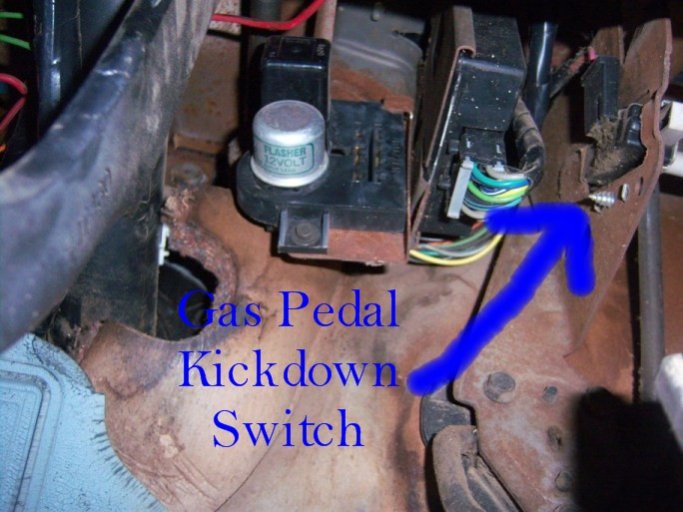

      Also, I need to work up a throttle linkage with a kick down switch for the TH400 (was apparently never there).

      The 400 kick down switch would mount on the gas pedal under the dash. Your 1985 C 10 should have provision to mount it.

      That's new to me and different from what I've been seeing. I was planning to use a switch up with the carb linkage.
      Found it online with minimal searching. Amazing how knowing what something's called makes it easy to locate.
      Quote Originally Posted by Timmah View Post
