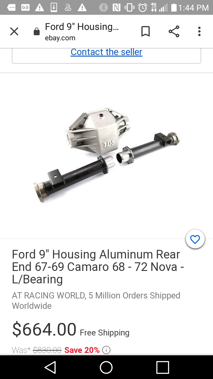

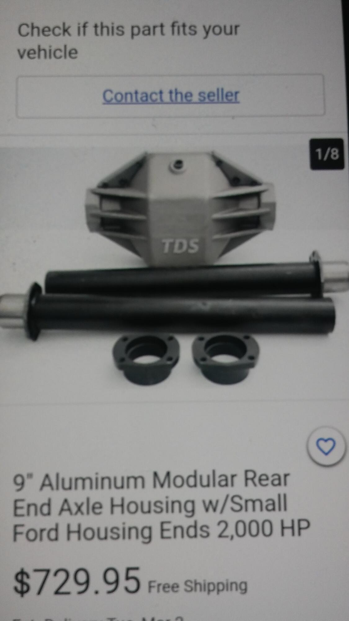

      Yes, the one with the bolt on tubes. There is several different designs for the the aluminum center on ebay. The tds version has steel brackets bolted to the top of the aluminum center so you can weld link brackets to it.Name:  Screenshot_2021-02-20-13-44-57.png

      What advantage do you believe you will achieve with the bolt on axle tubes? The deal uses a cast aluminum diff housing (will it be any lighter than a braced stamped steel housing? )
      No, I have no experience with this housing, and I do not think I will as I'm not seeing a real advantage to the increased complexity

      The only advantage I see is it looks cool at a reasonable price. Would look good on a 3 window coupe or street rod where all suspension is exposed. Just my opinion. Would I trust it as much as a fab 9, no. But is probably plenty stout enough for a 400-500 hp cruiser
