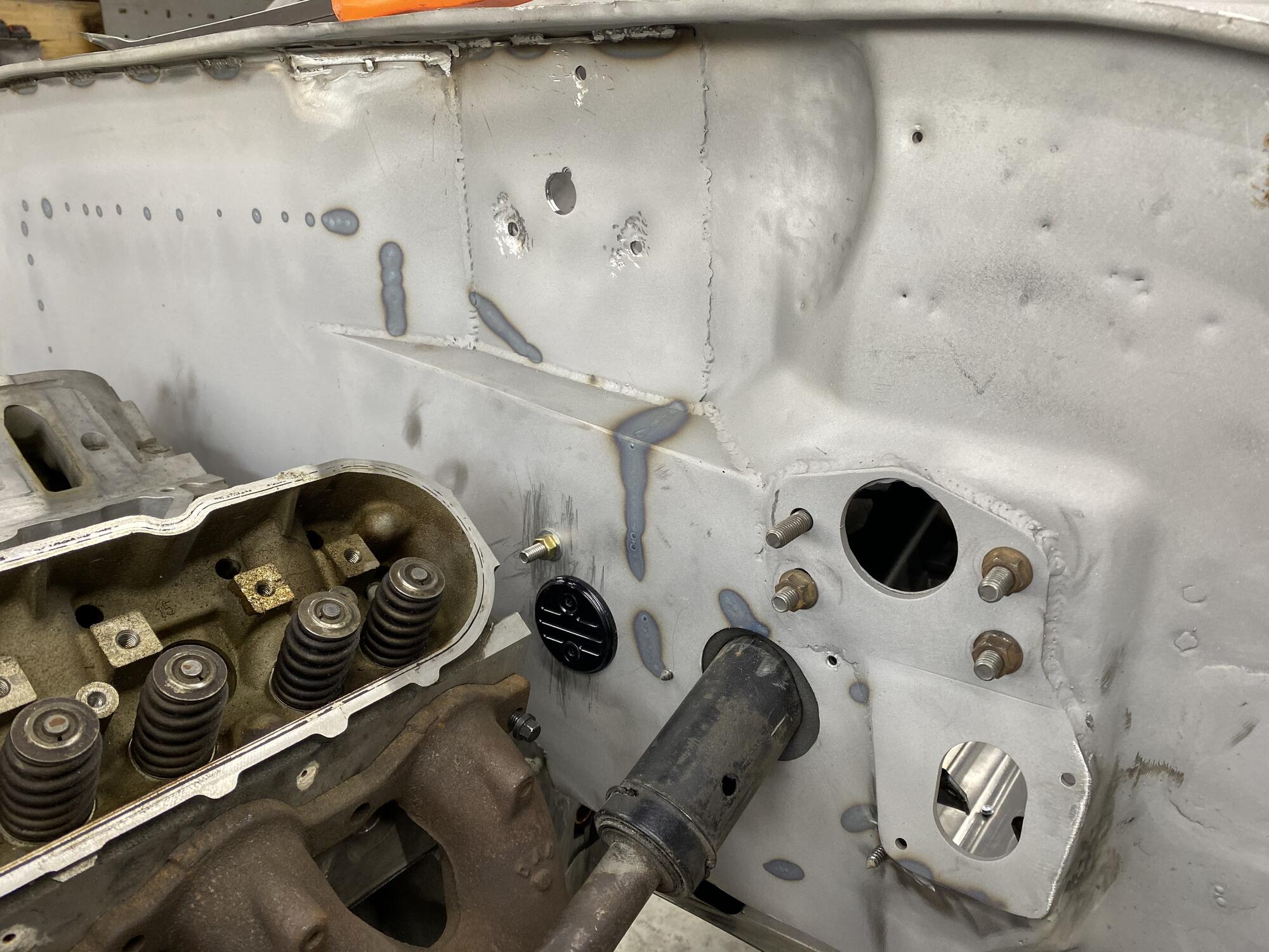

      Some updates this morning to the smugglers box!Name:  82EF503F-8FCB-4104-8F92-BF3EB68B4603.jpg

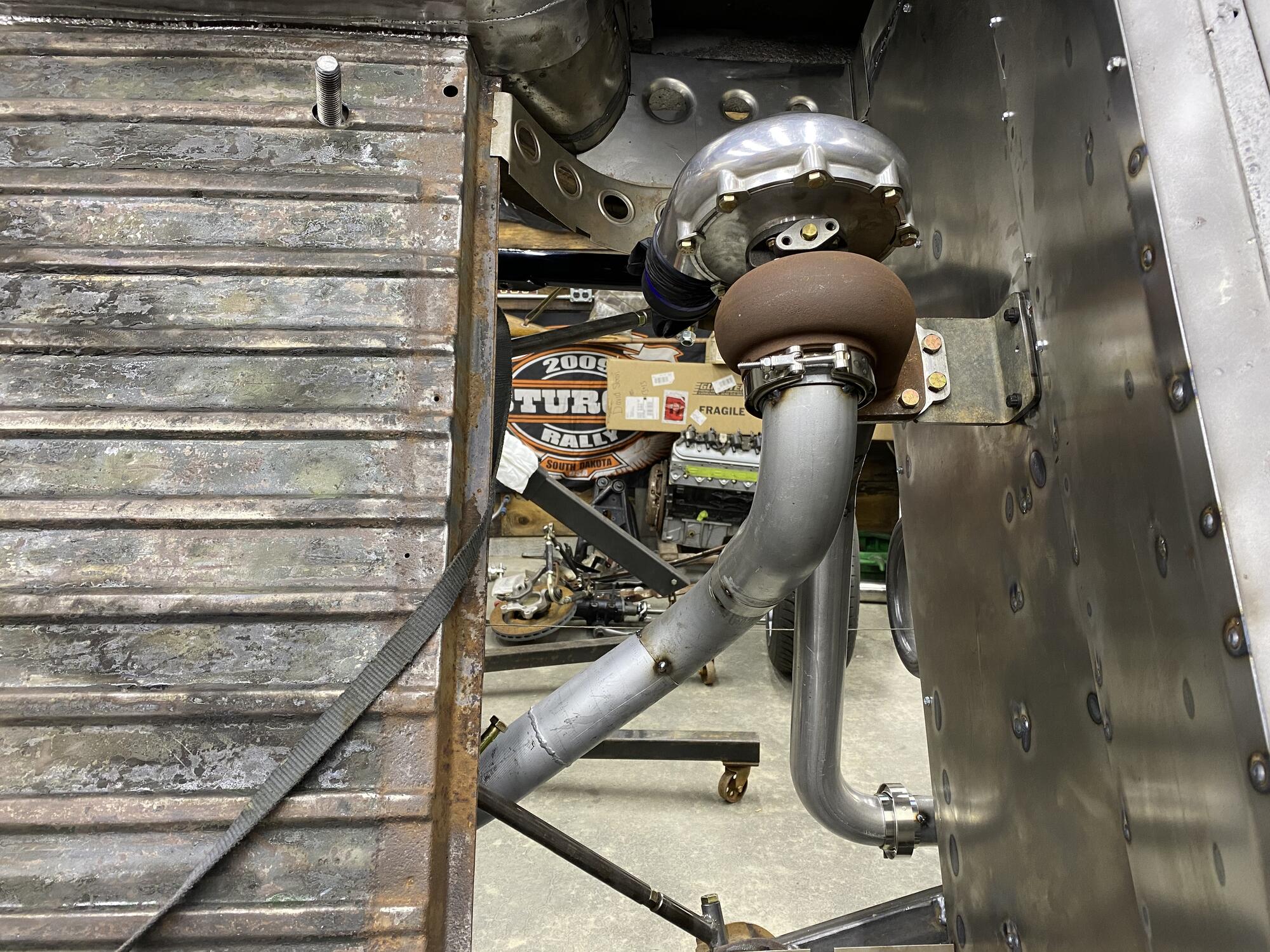

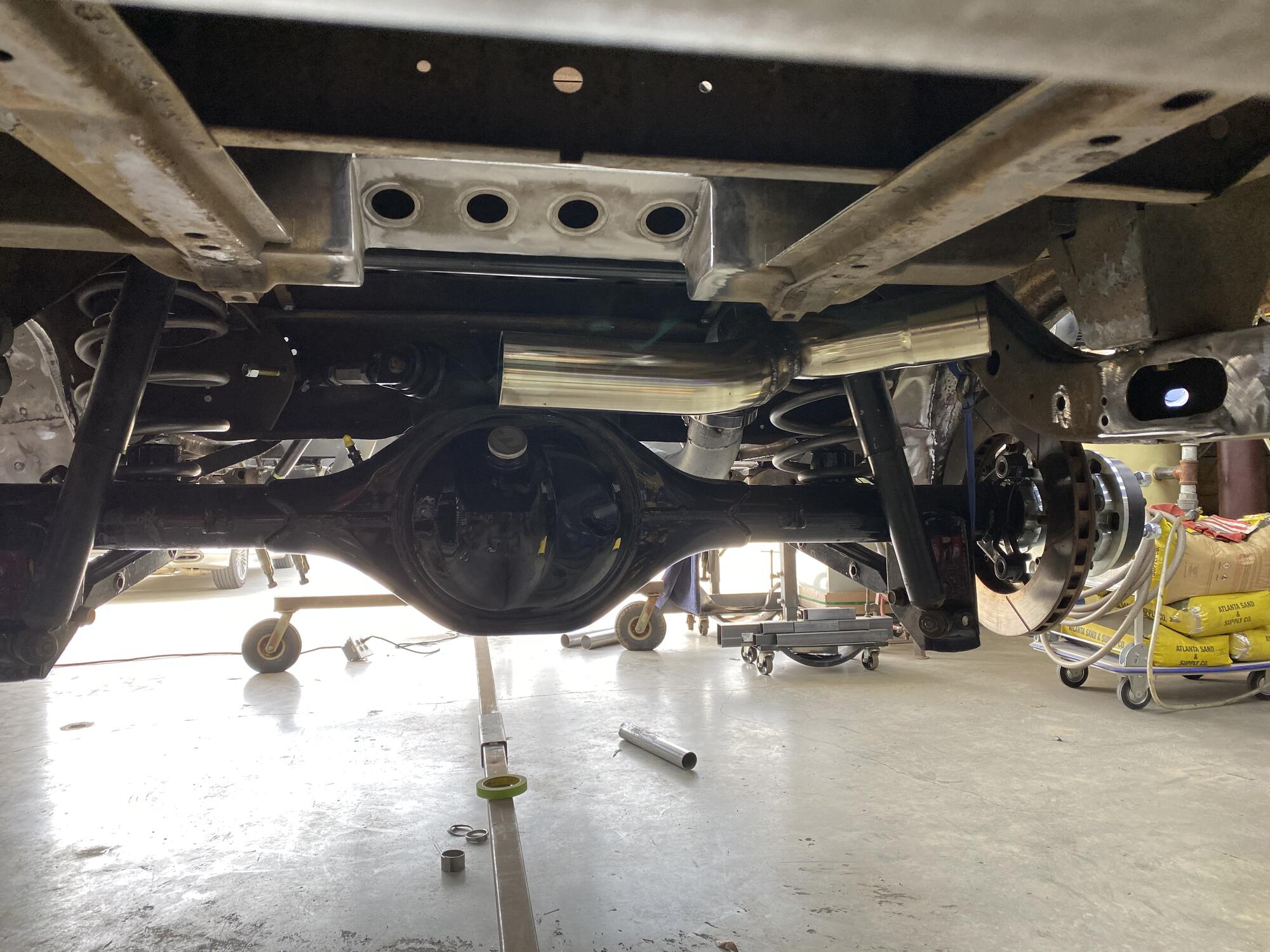

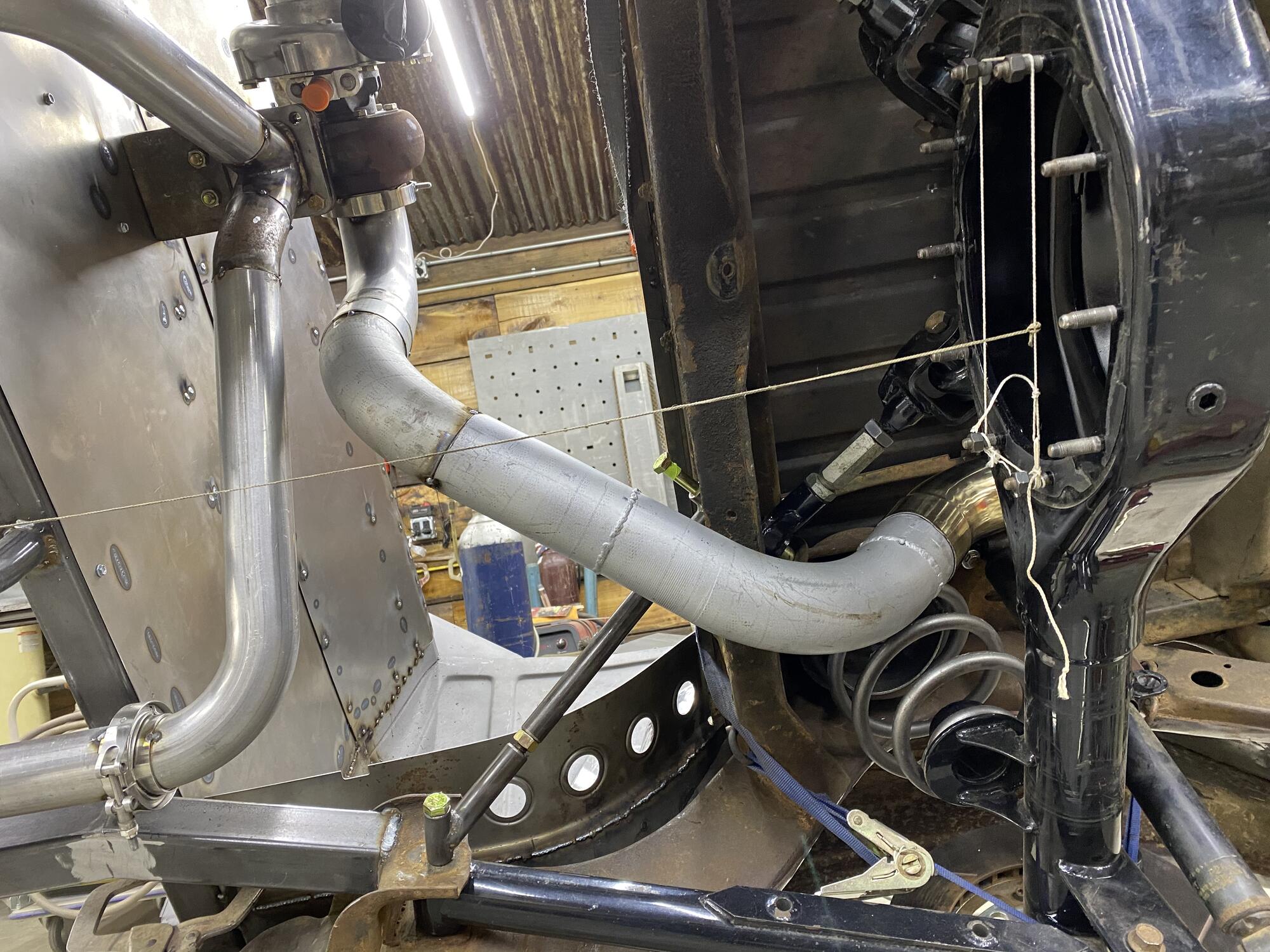

      Worked on the exhaust from the turbo to the rear today. Trying to build it with some left over parts and a used 3” exhaust from a 2000 Camaro. Name:  1B885B2E-564E-4325-B12A-2A5DA919F222.jpg

      Very cool update with the rear mount turbo. Should be lots of fun making turbo noises.

      Any thoughts of using the top of a truck box to cover the turbo for a stealthy look?

      Yes sir.
      The plan is to build a wall between the smugglers box and the bed , then i'm going to build a cover over the bed so it will not be seen.

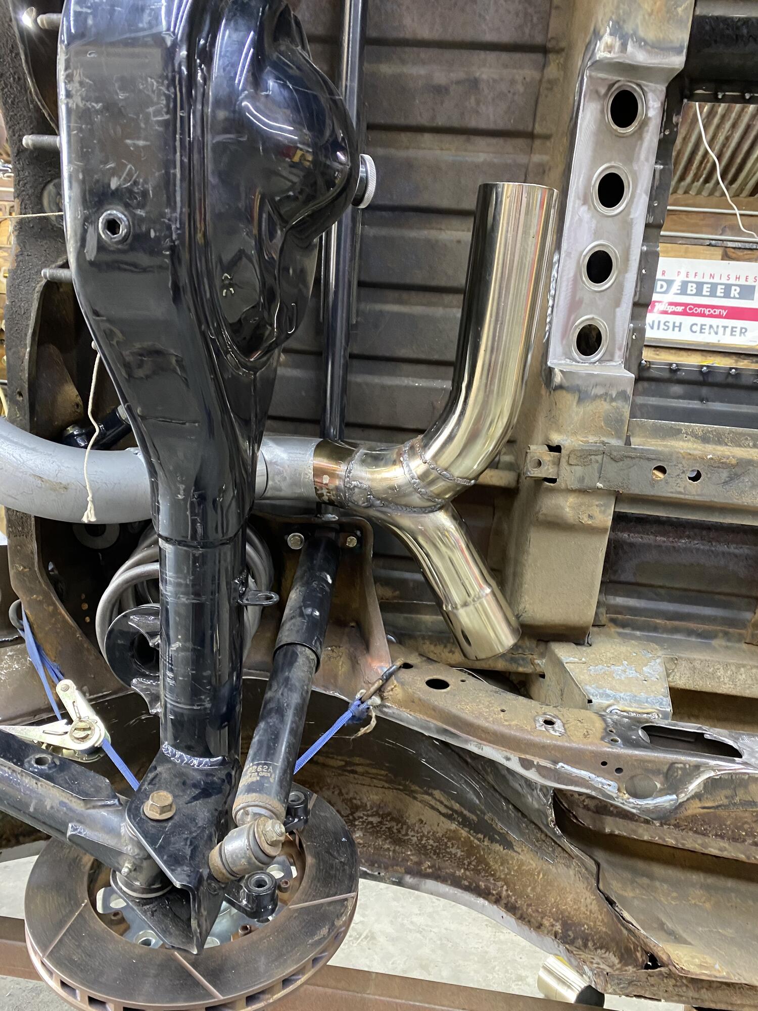

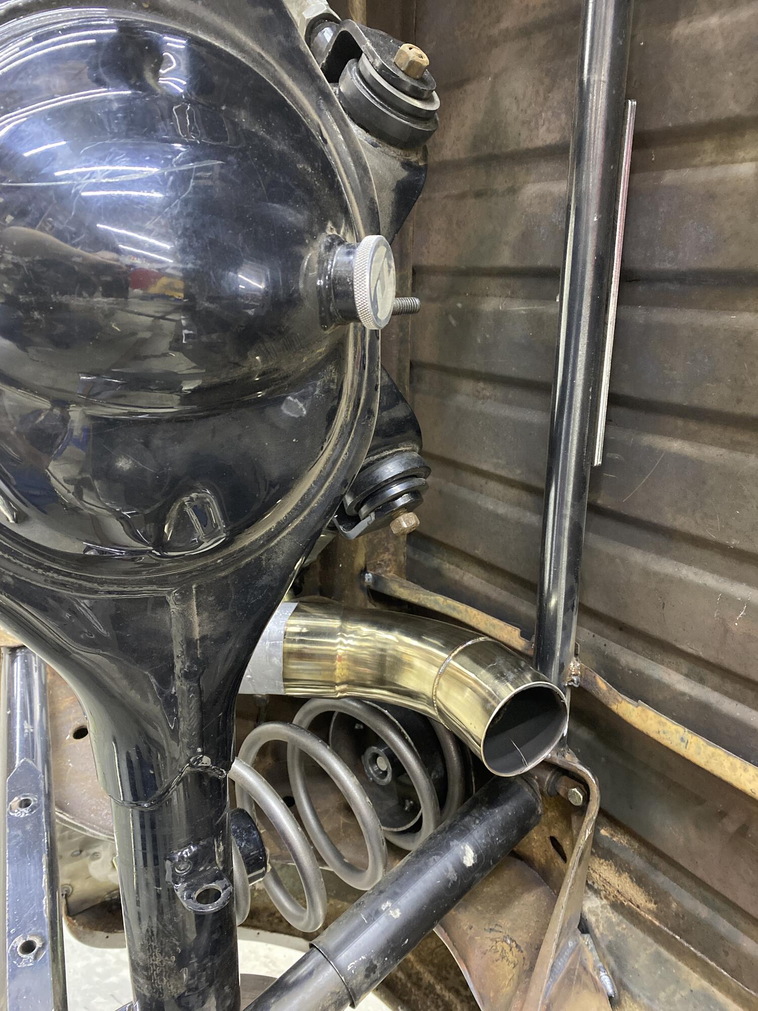

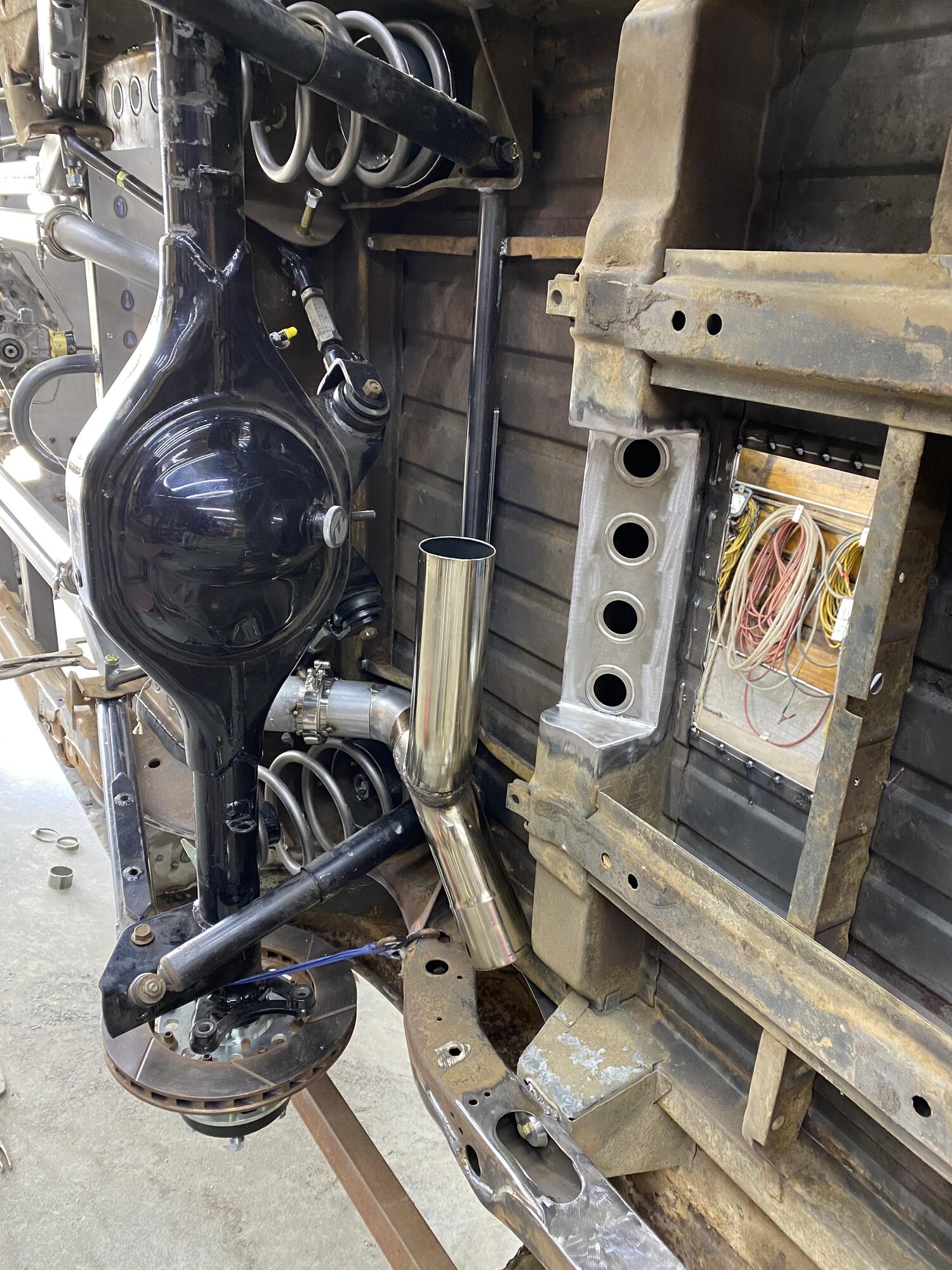

      2,722
      Little more progress on the exhaust. Lol the struggle is real! Can you say built not bought/ recycling at it’s best. Trying to build this y section bought kicked my but. I had a old exhaust system from a 4th gen Camaro and some leftover 3” tubing from my Camaro build. This is what I got so far.Name:  60C35367-20A0-47A6-BDBA-FFE3E1020871.jpg
Size:  469.1 KBName:  EC15D370-72E7-4466-B699-3B65D6610869.jpg
Size:  342.6 KBName:  1B32DB2C-A192-41AA-AA41-52A74A64DF08.jpg

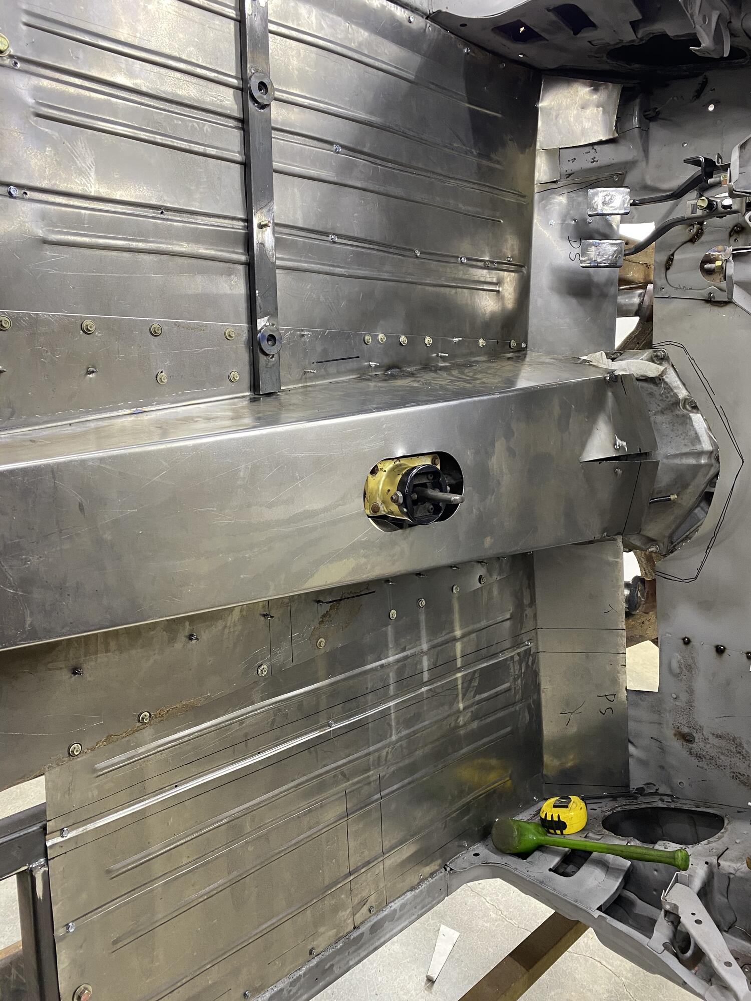

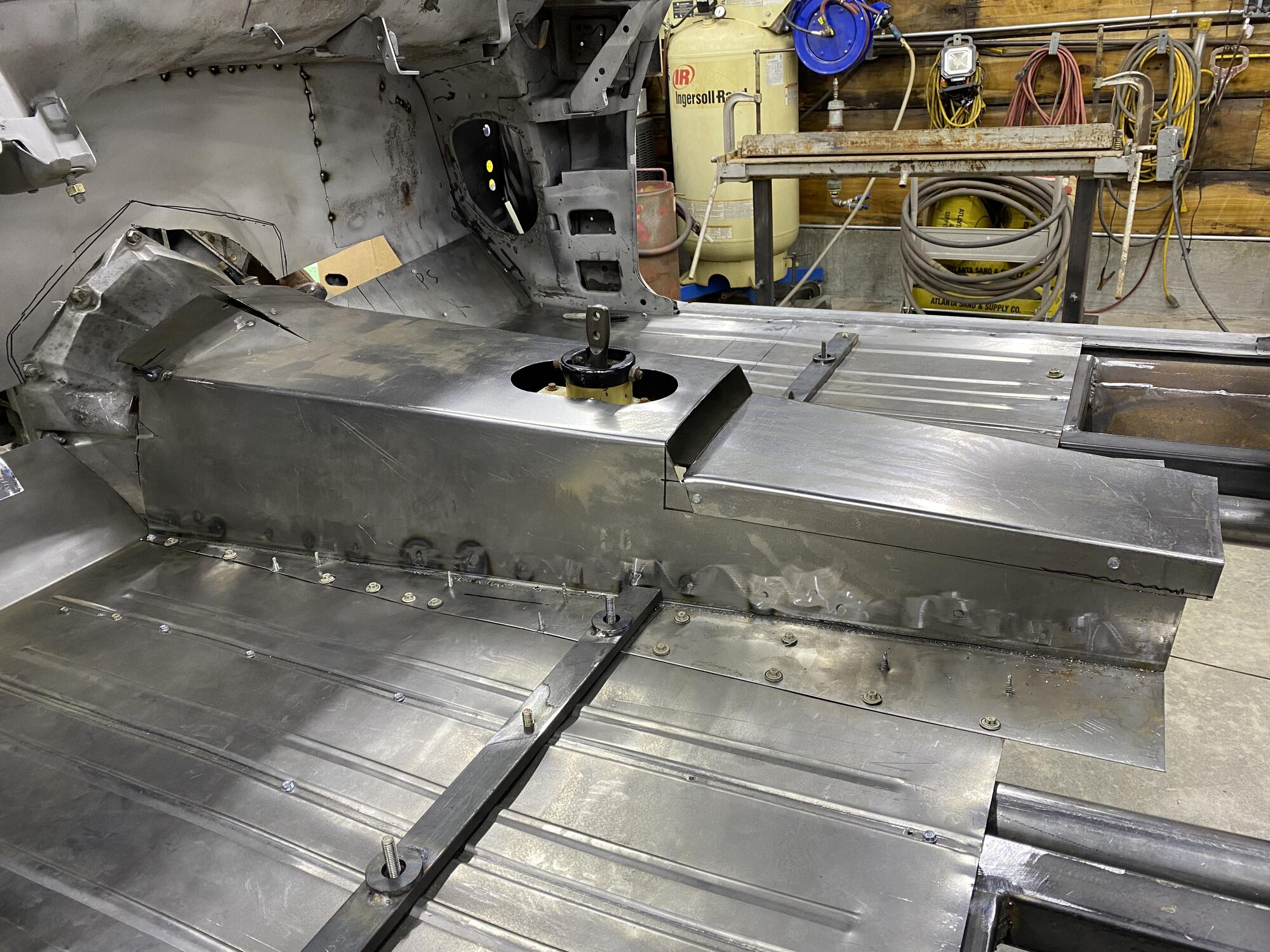

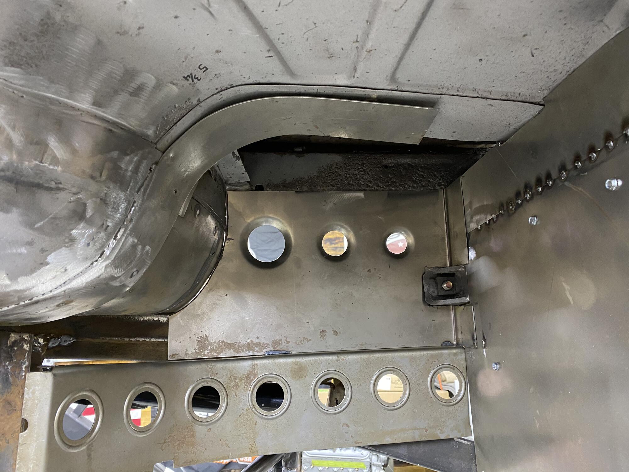

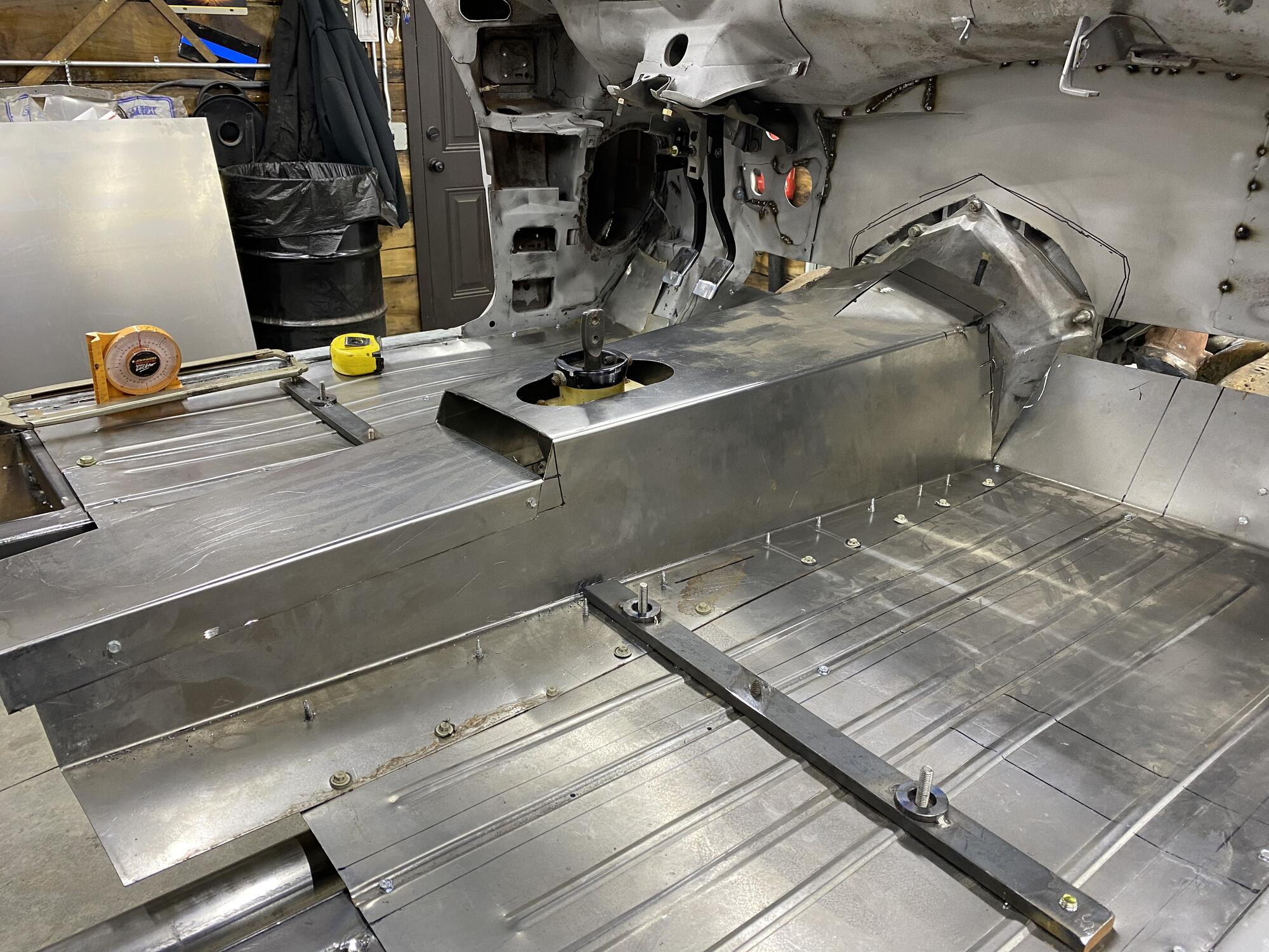

      So I have gone as far as I can until the 2.5” and 3” stainless tubing come in. I decided to work on the floor and tunnel today. Most everything is screwed together so I can remove when the tubing comes in to finish the turbo cold side.Name:  65086C43-F8FD-4F91-A5F2-7E77845631F0.jpg

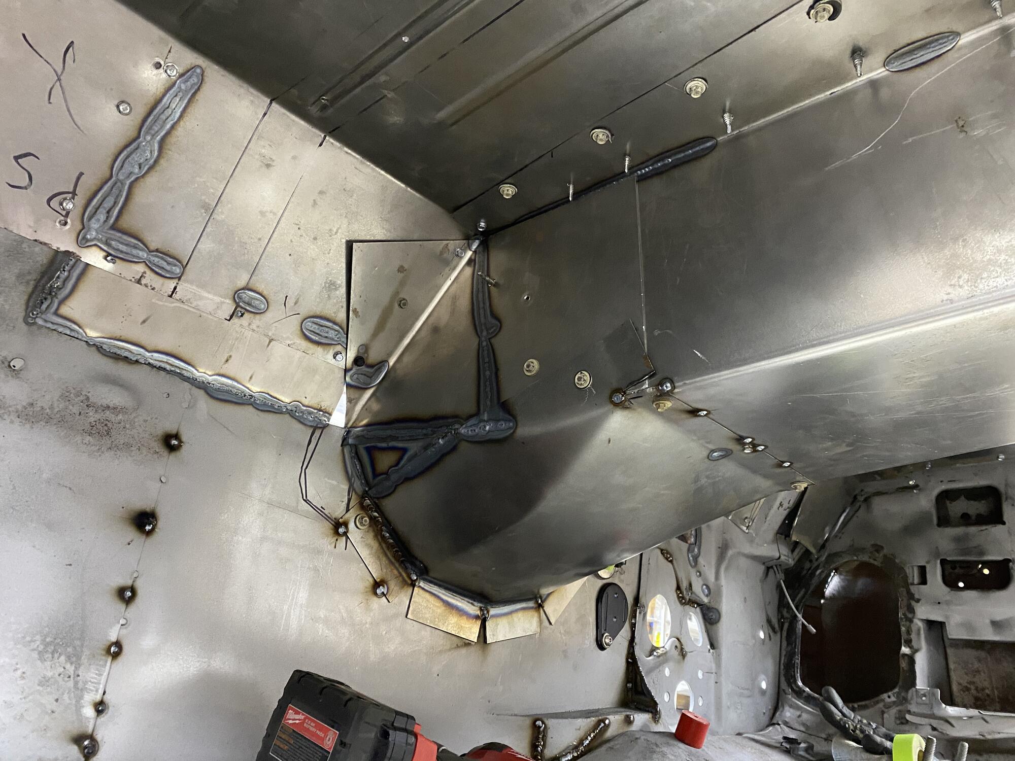

      One more picture for today! Work on the tunnel step down.Name:  8067FFDA-4968-4EB4-84CD-FDF929275B43.jpg

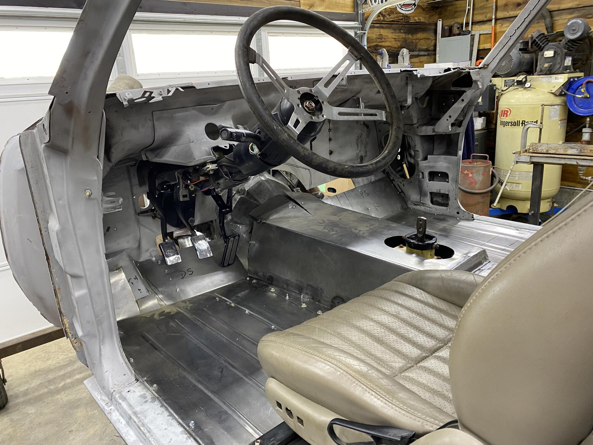

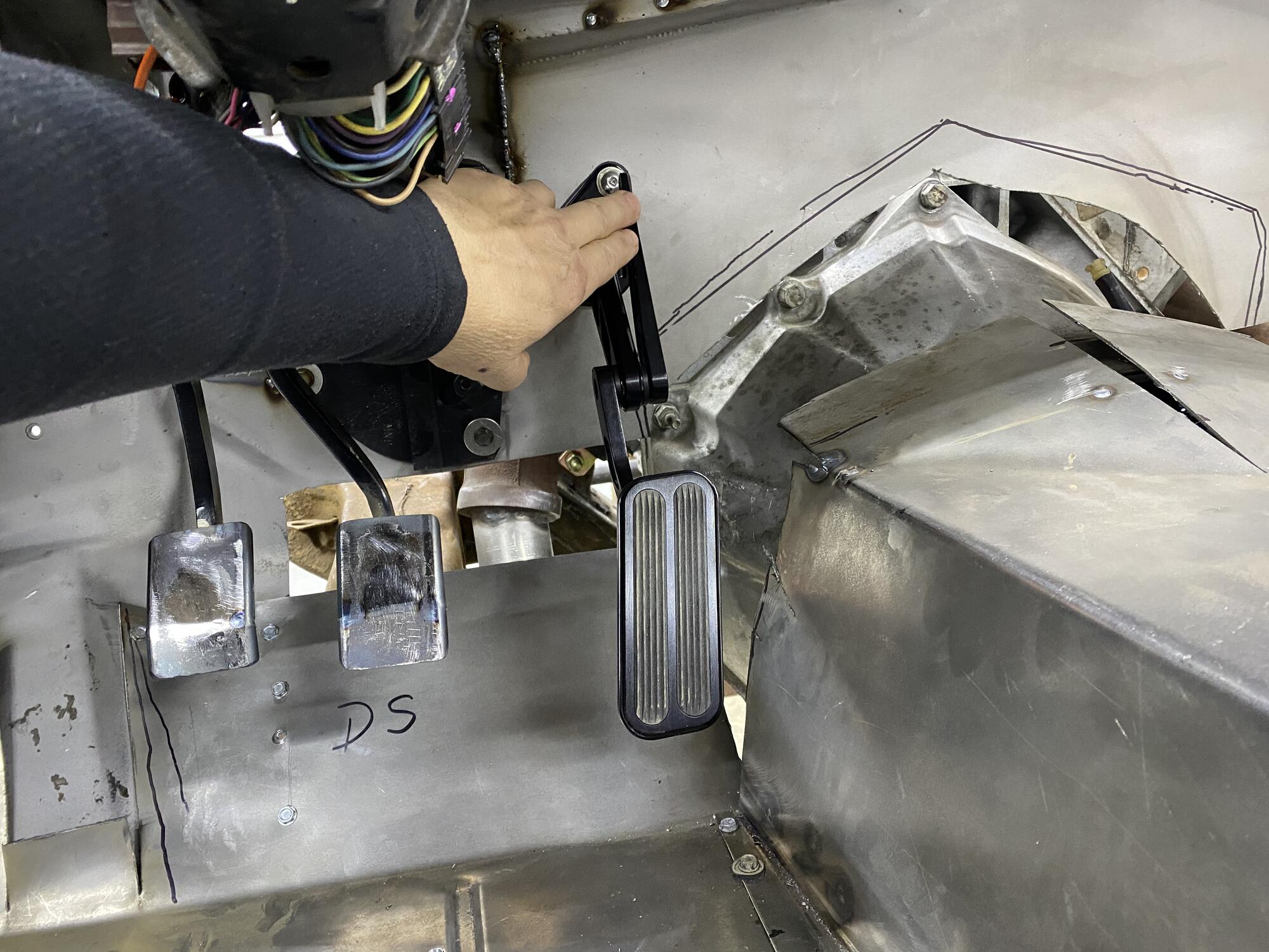

      Getting the gas pedal location figured out, I needed to mock up the seat and steering column again to make sure it all feels good together.Name:  1959E3FA-1395-4932-A1F0-56F0DD7E92FC.jpg

      David Sloan

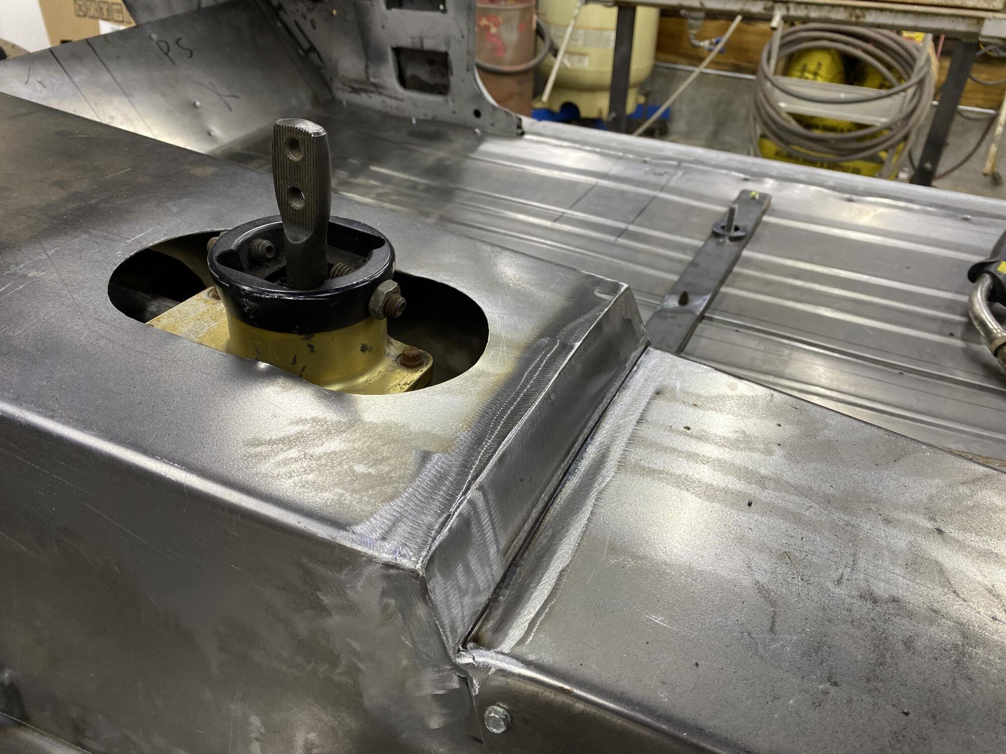

      Aug 2002
      Waleska Ga.
      2,722

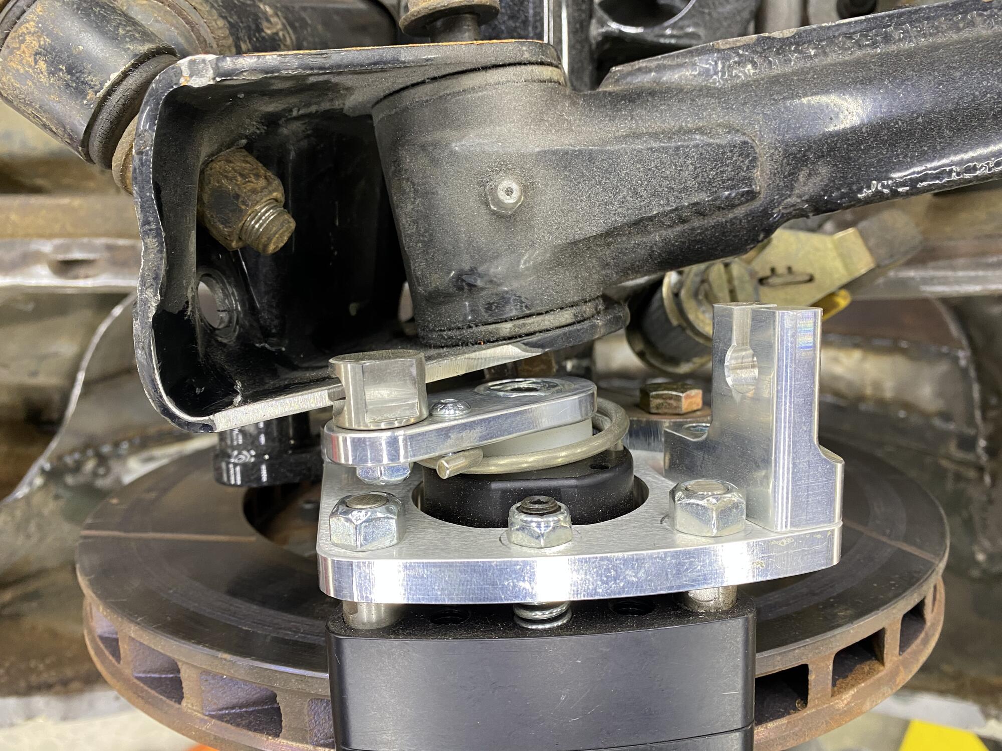

      2,722

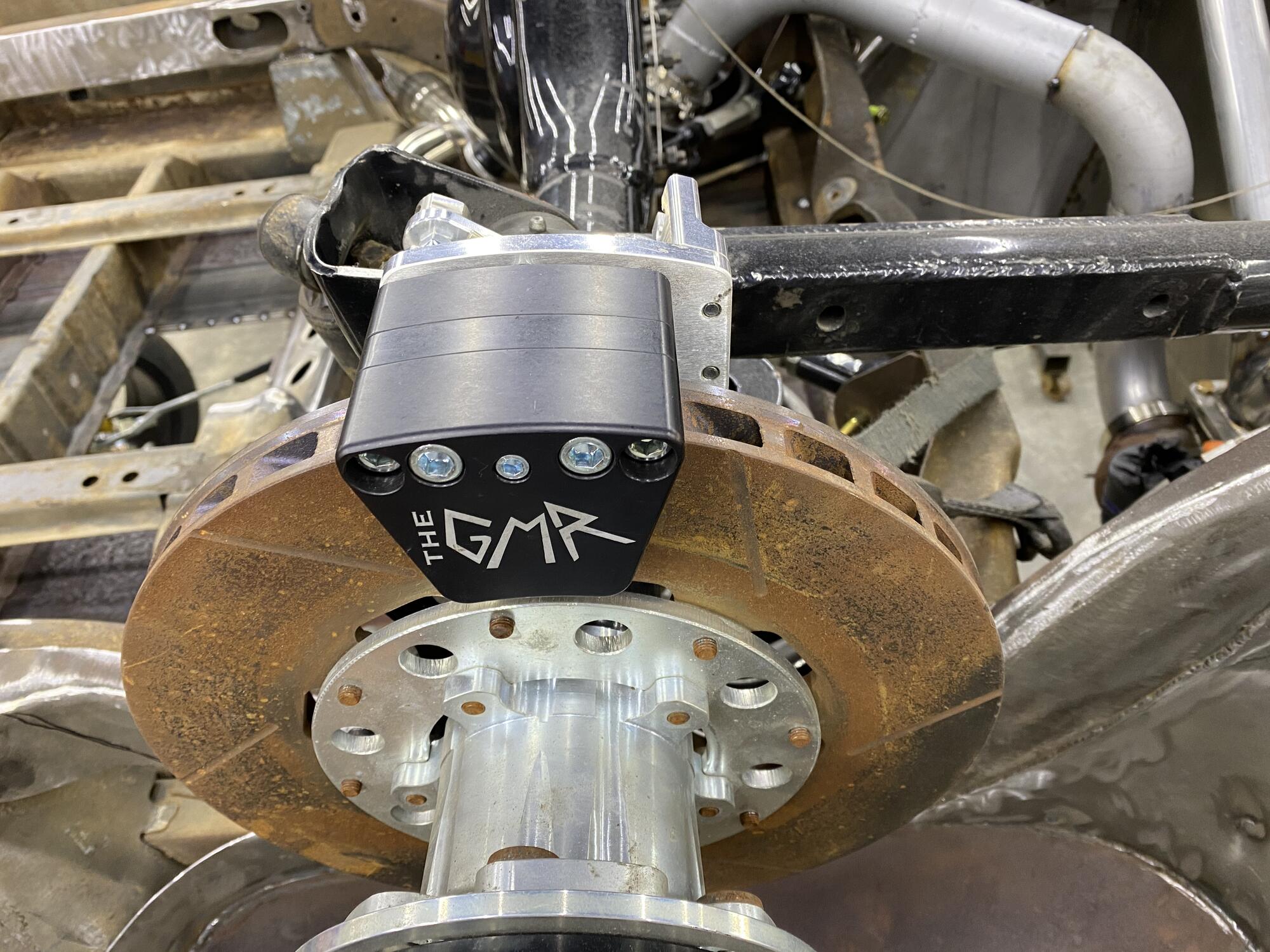

      So this morning before I got started on the floors and tunnel I did a quick mock up of the parking brake calipers. I marked the Rearend housing so I can clean the old powder coat off to weld the mounting brackets the next time I pull the rear end.Name:  AA90B112-F7AA-4708-969B-A8DD9CA362EA.jpg
Size:  394.4 KBName:  9C3B1829-99C1-4574-998A-F7C1D40C7744.jpg
