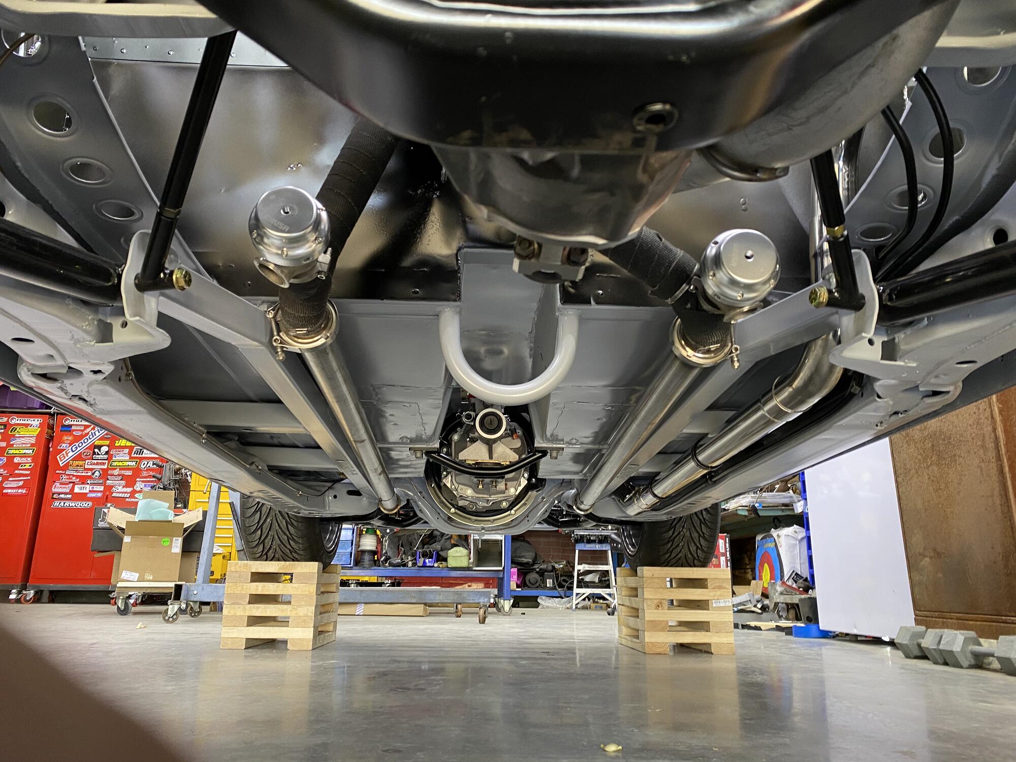

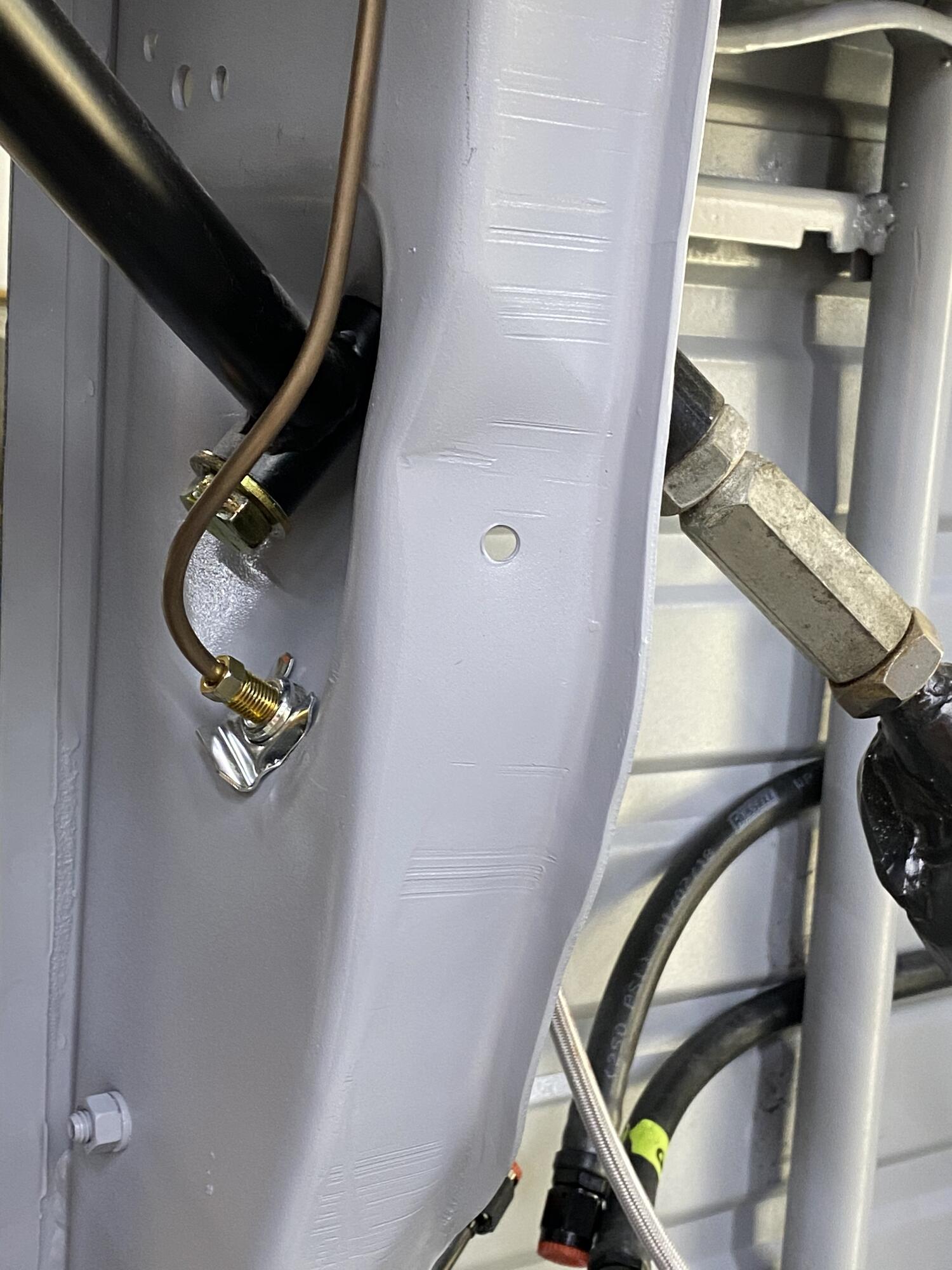

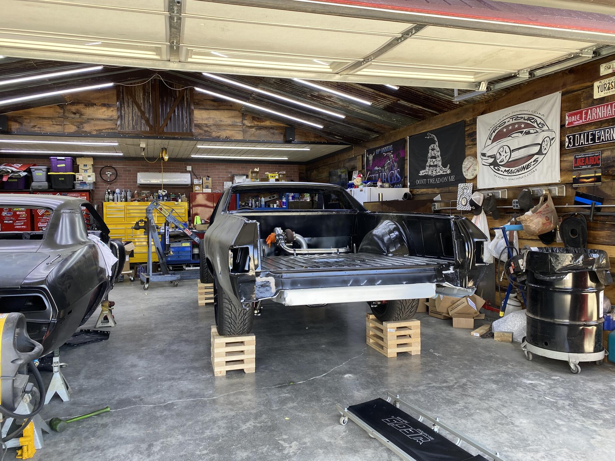

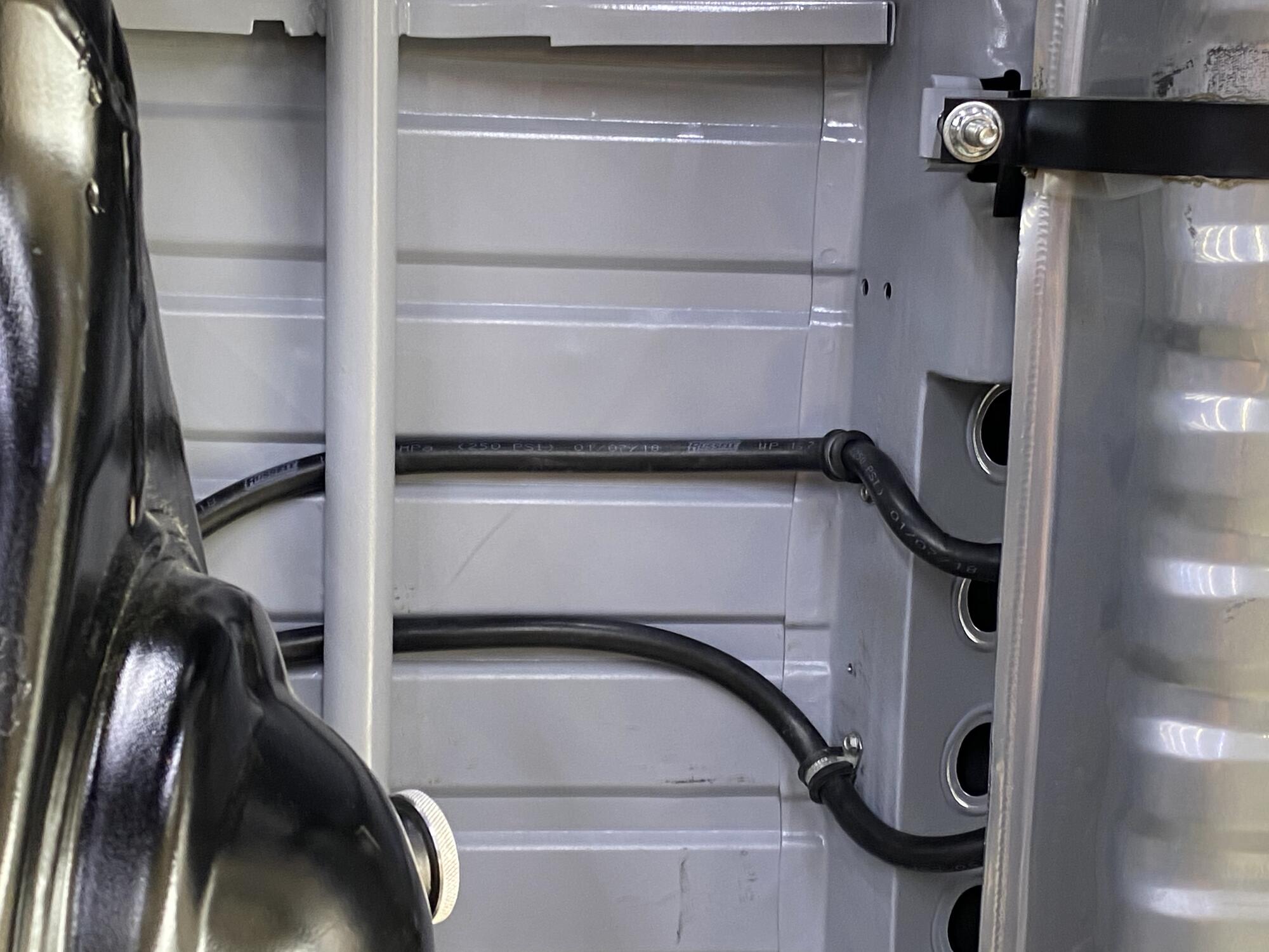

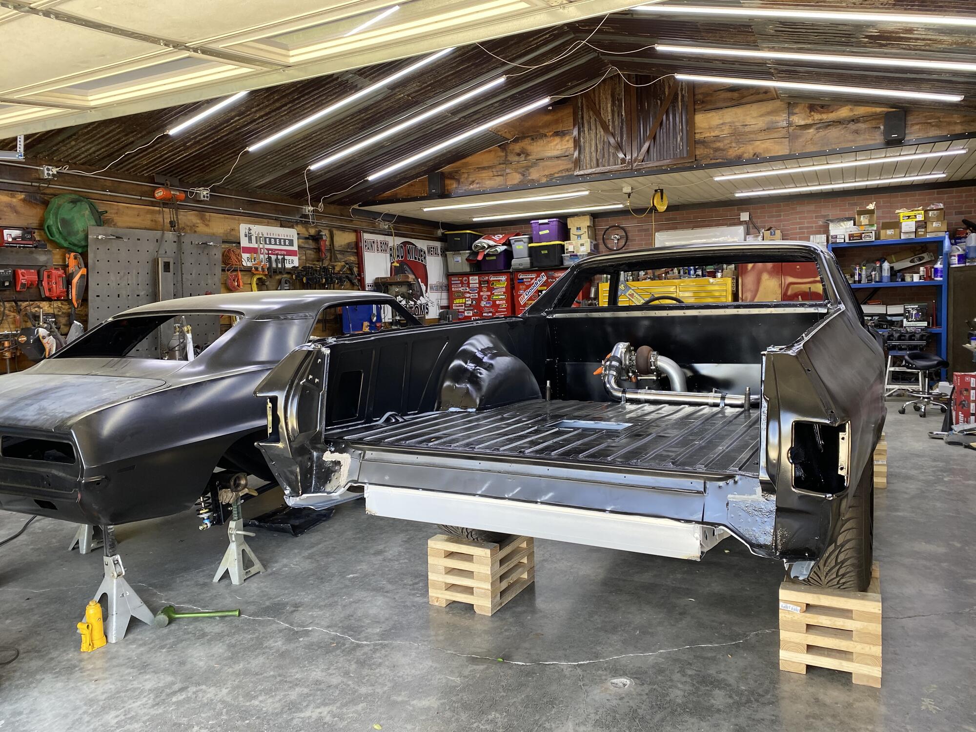

      69 Elcamino time.��

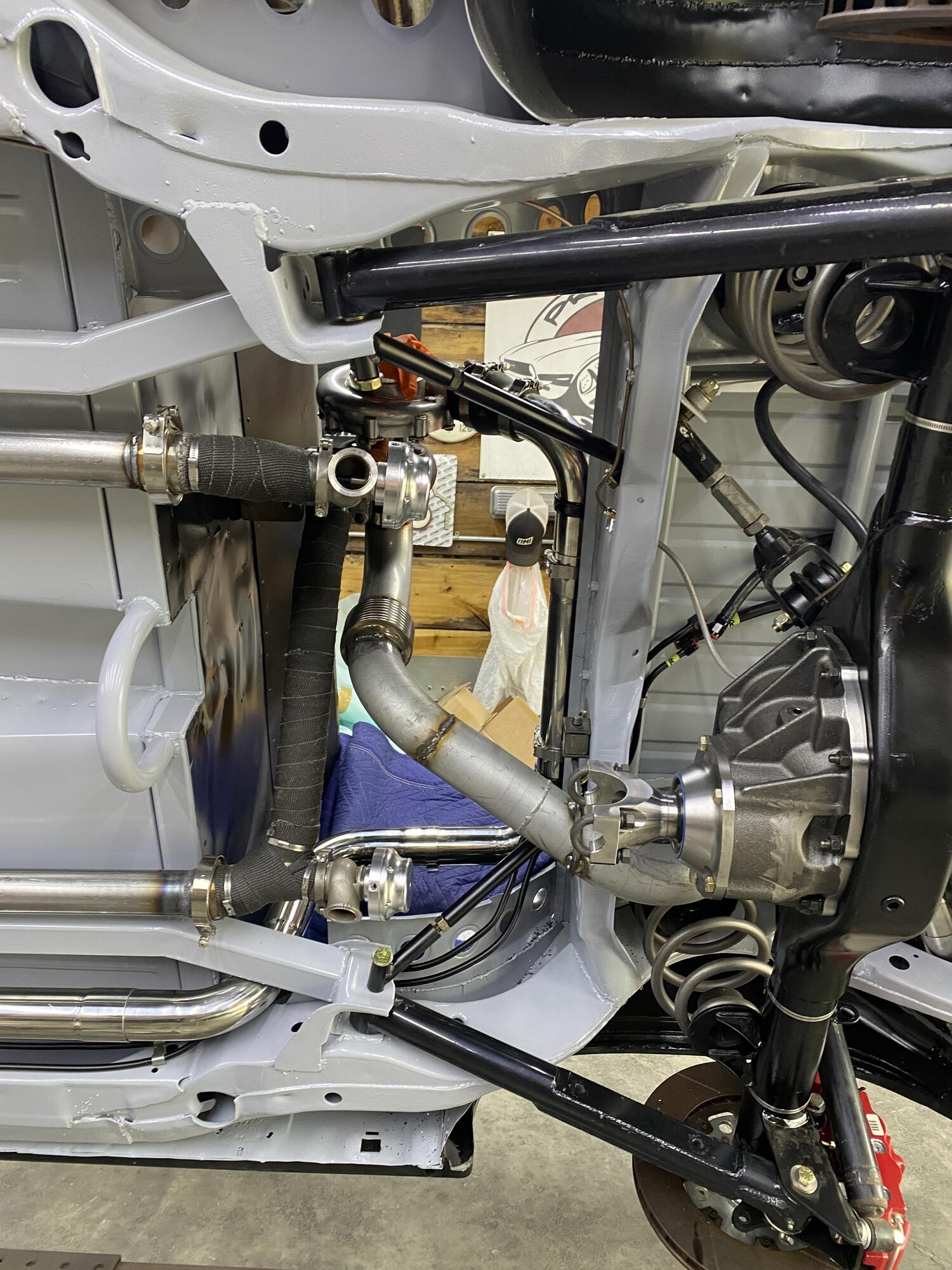

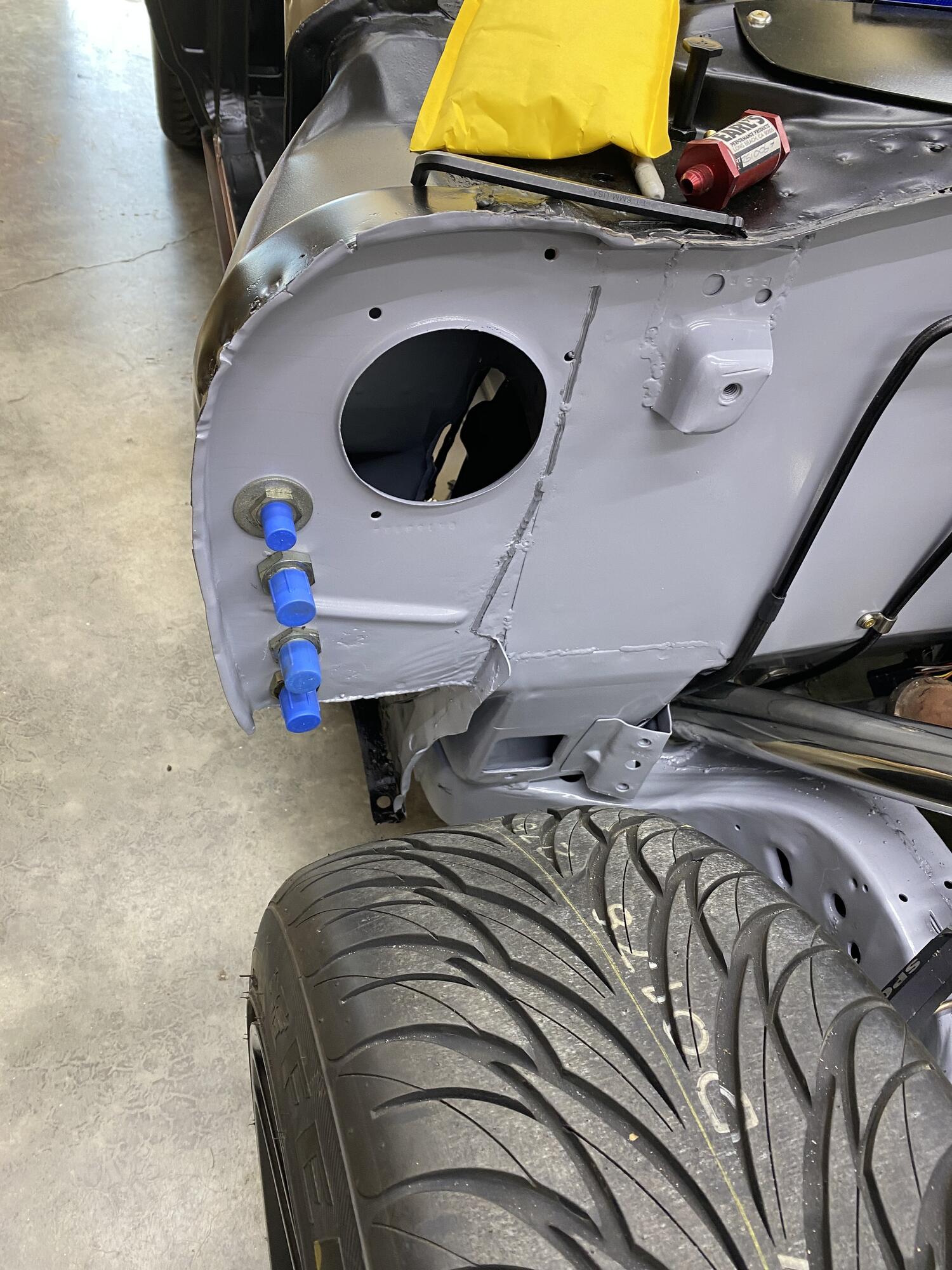

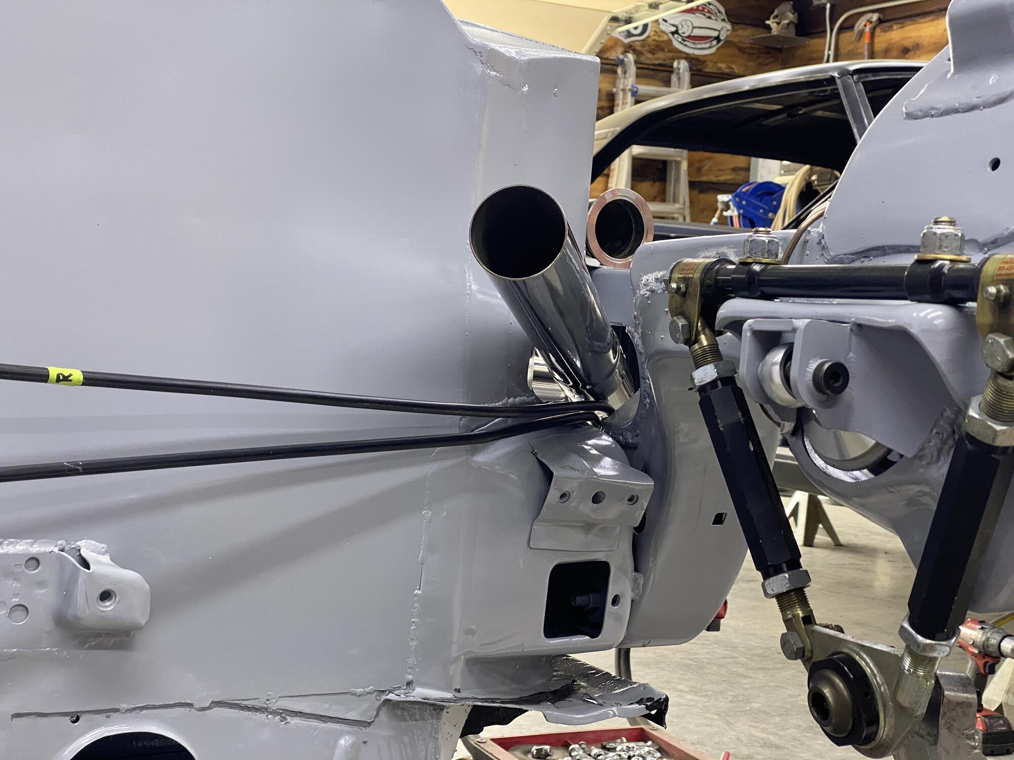

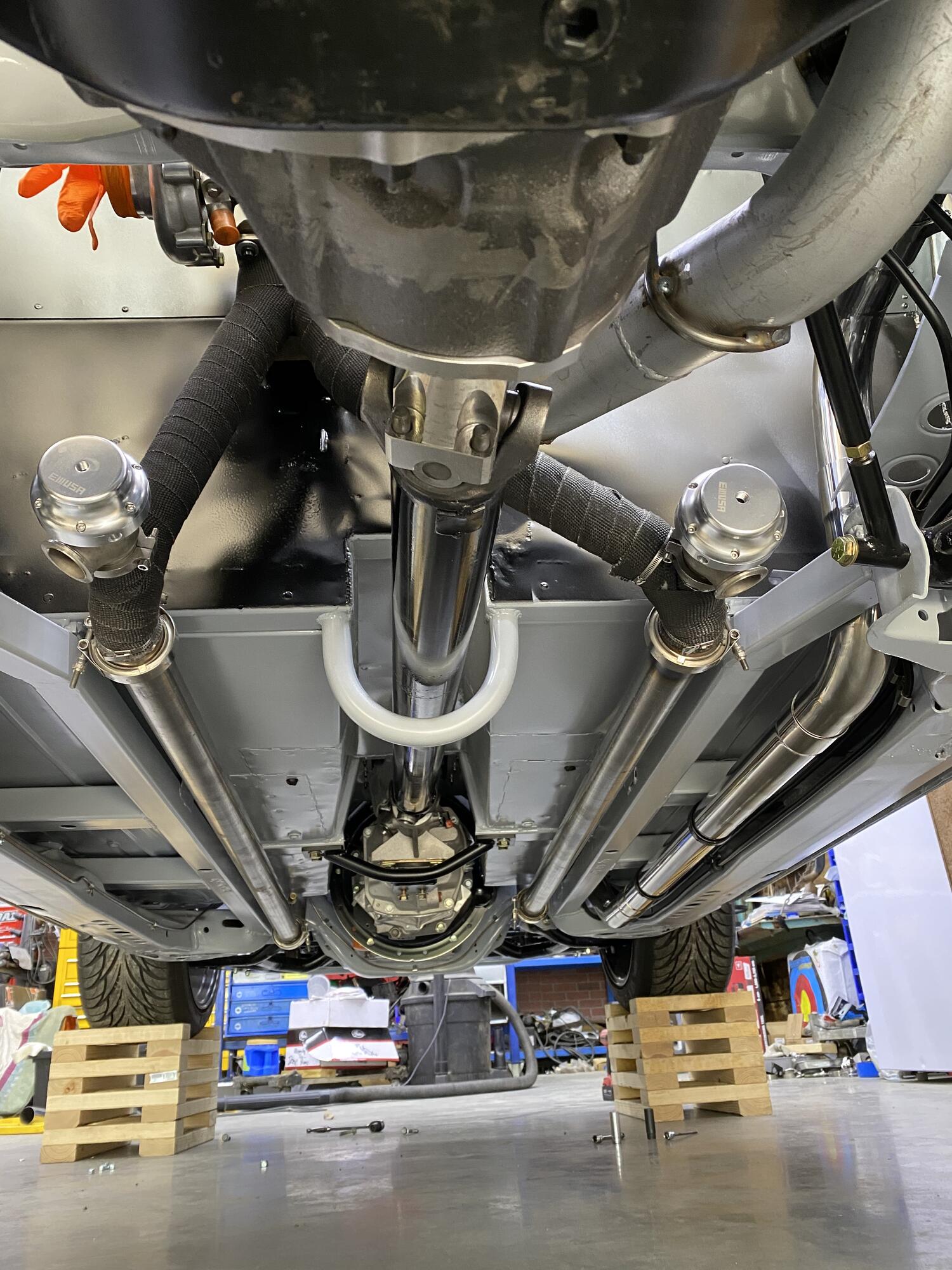

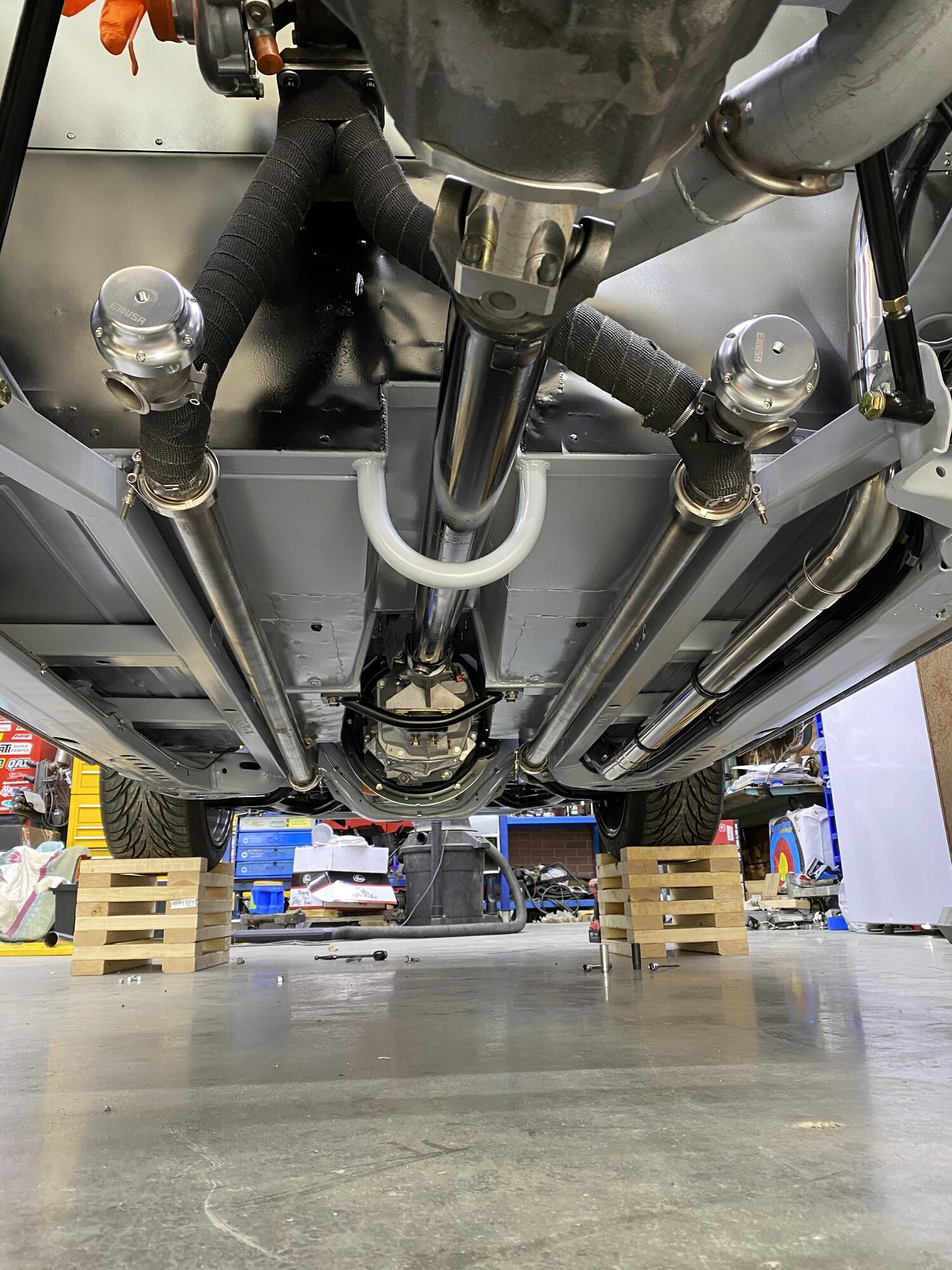

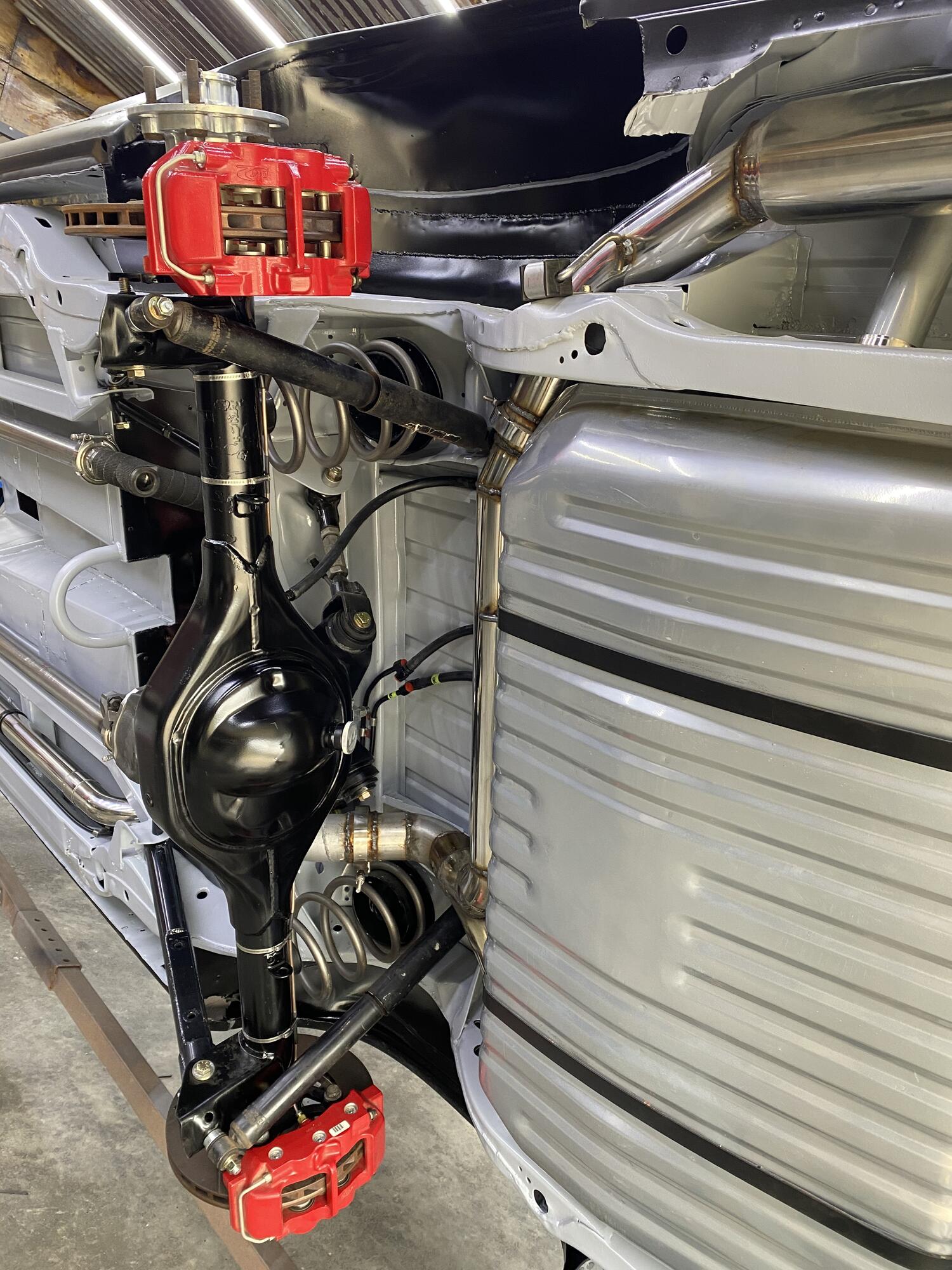

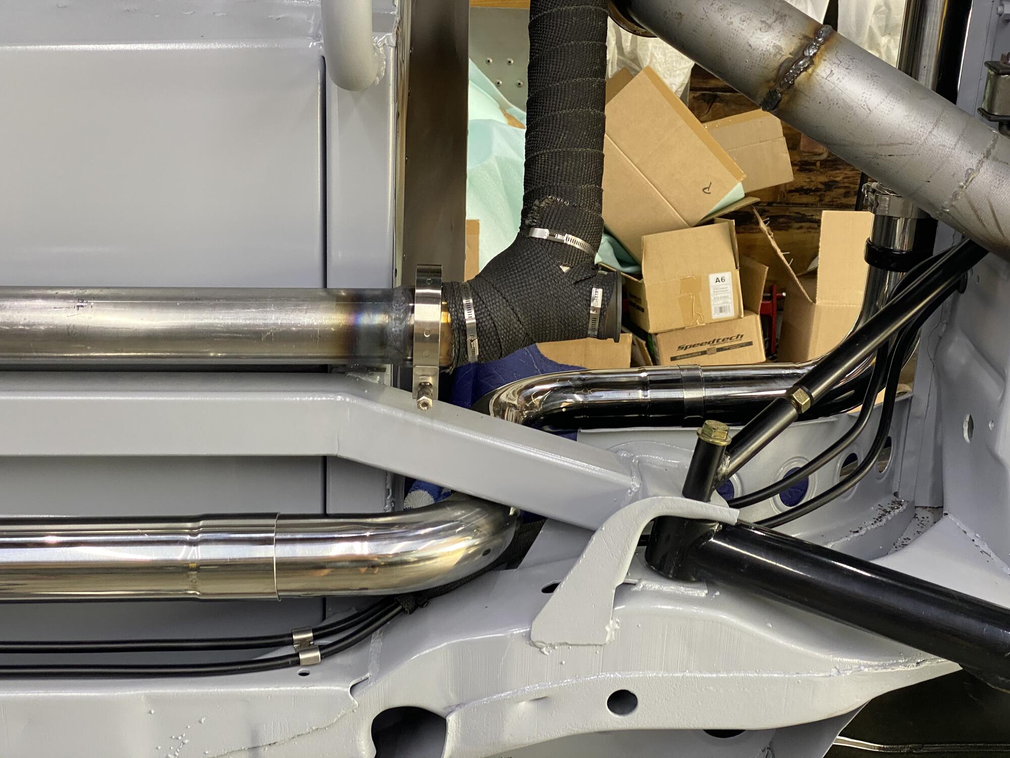

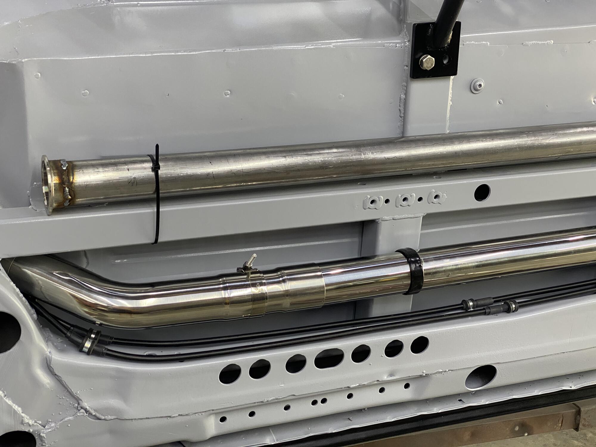

      New fuel lines ran ,started installing exhaust and cold side
      Its so much easier to do on the rotisserie. Waste gates installed.

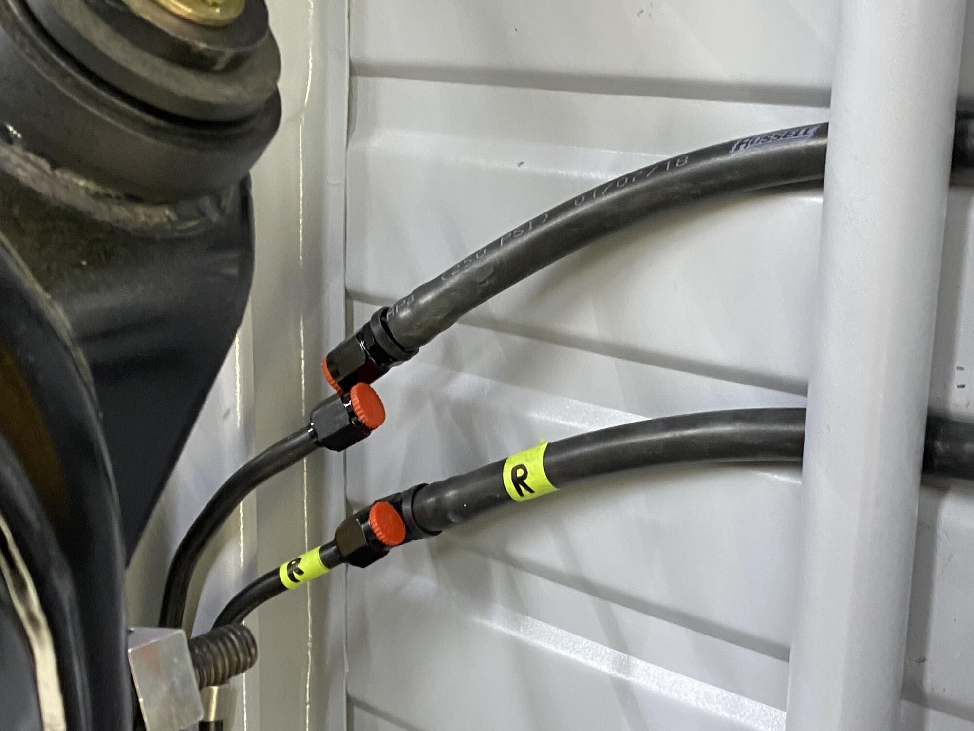

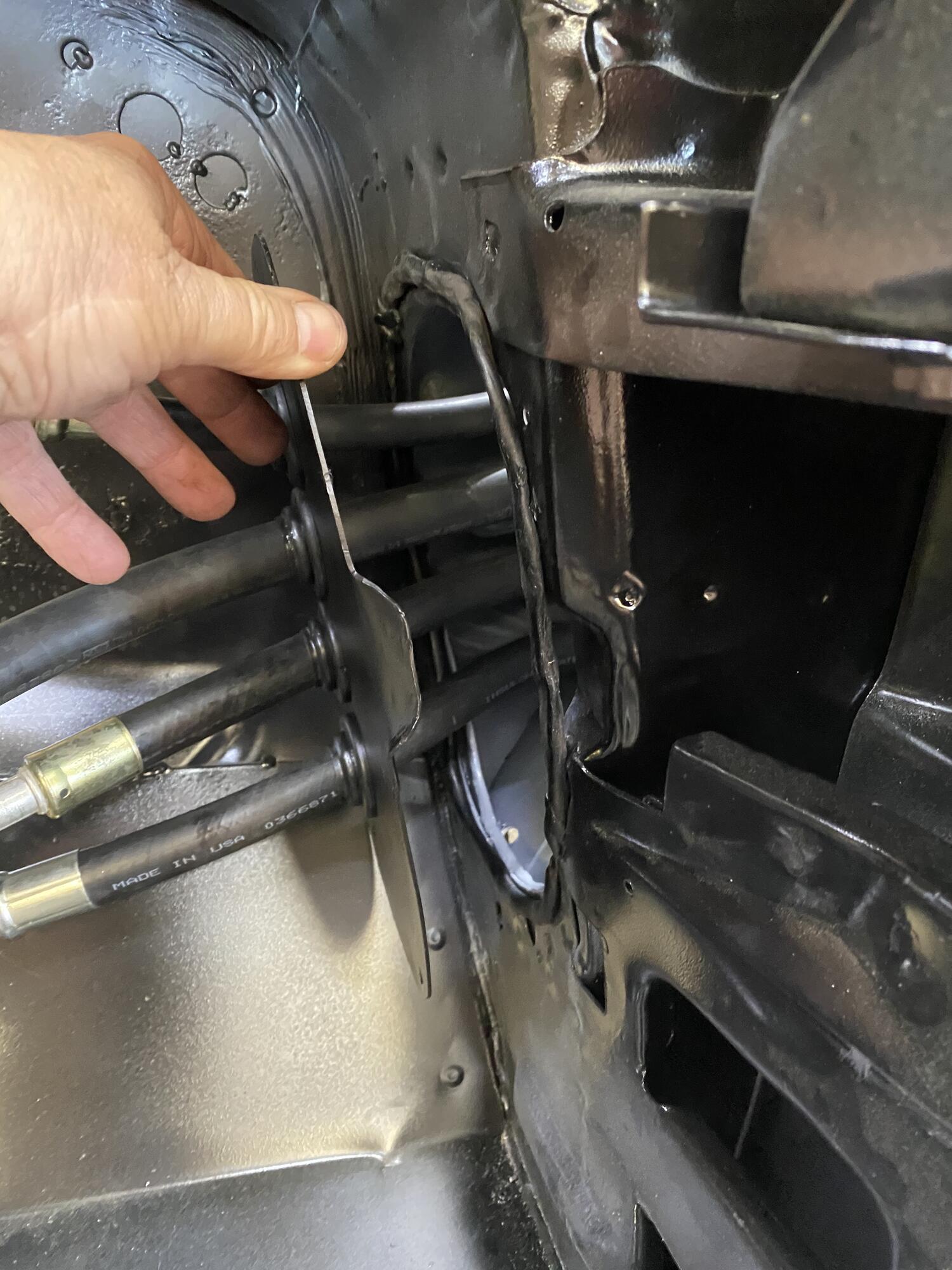

      Brake lines to the rear end completed.Name:  45B2E0F6-6DE2-4021-A774-8D5656D3809C.jpg

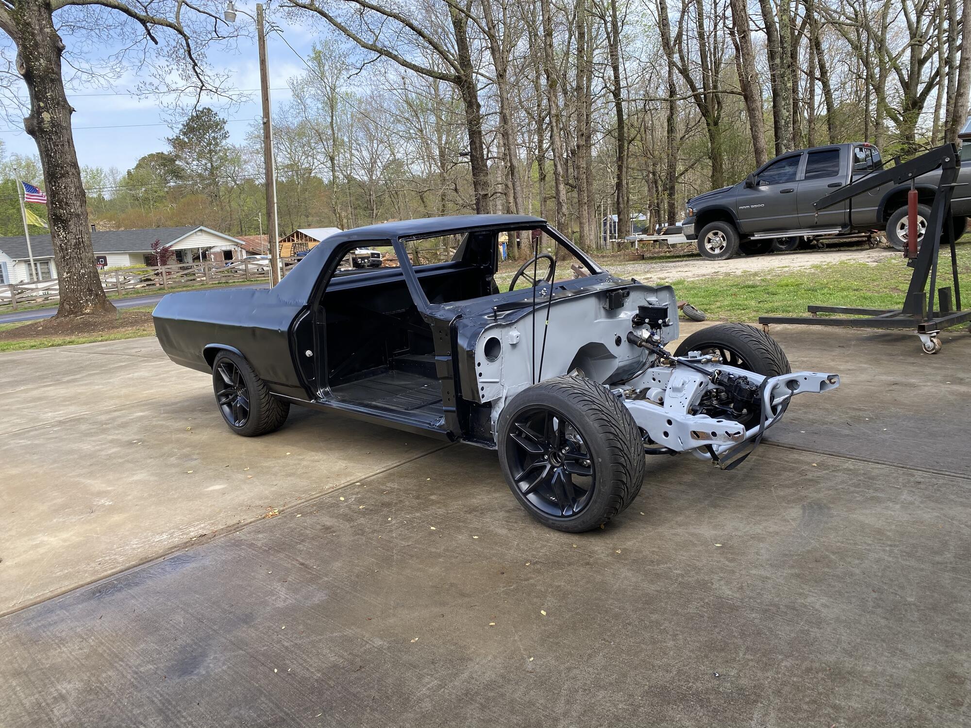

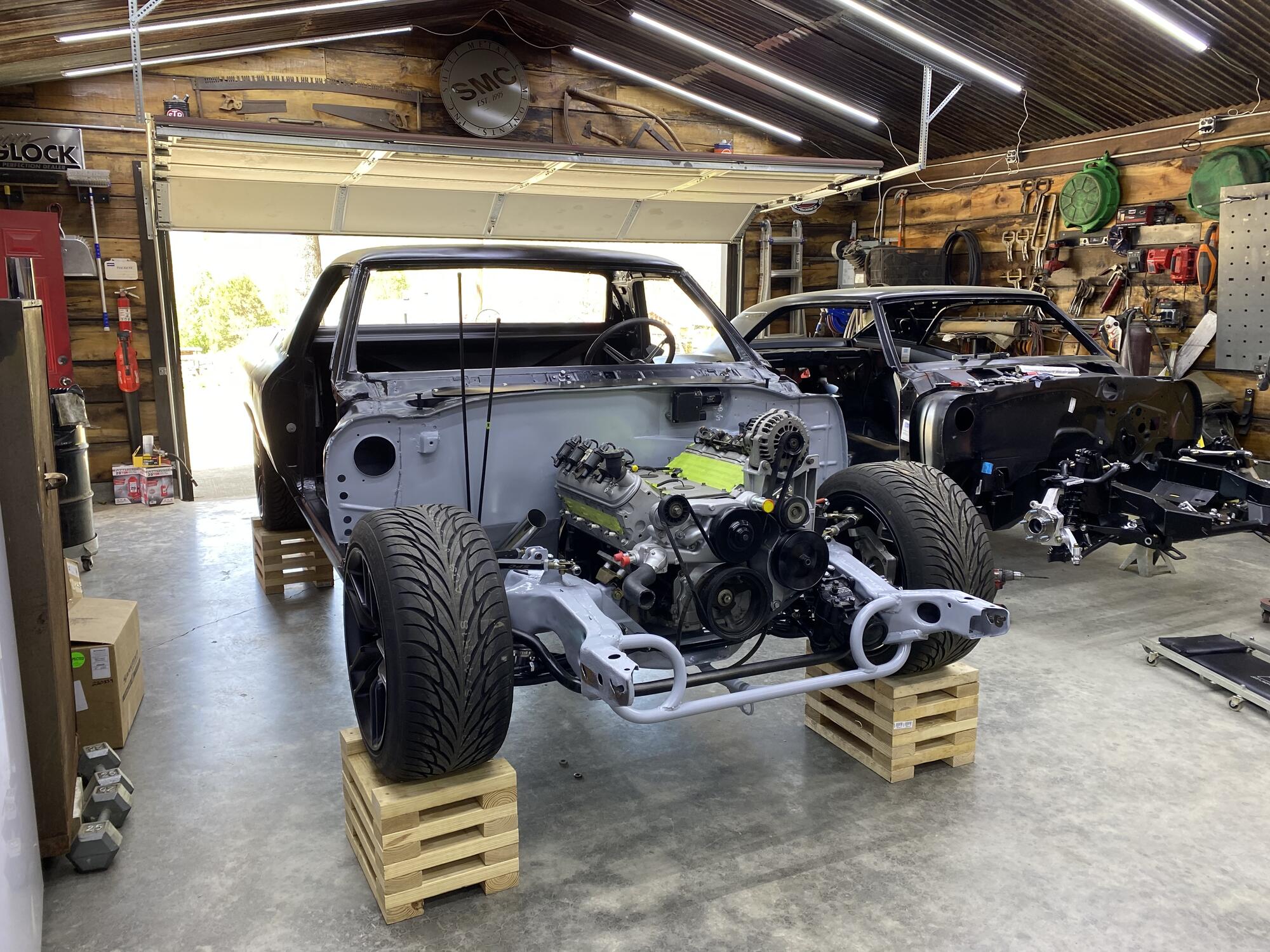

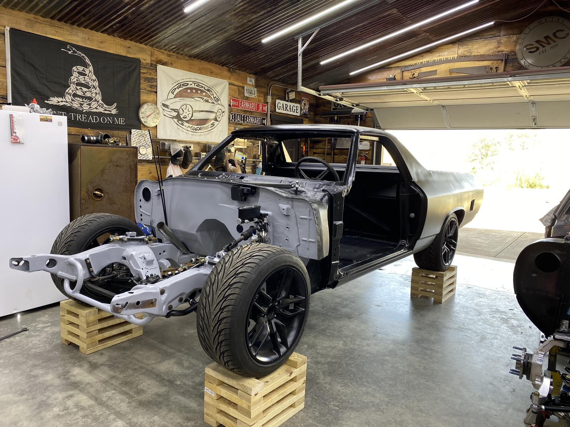

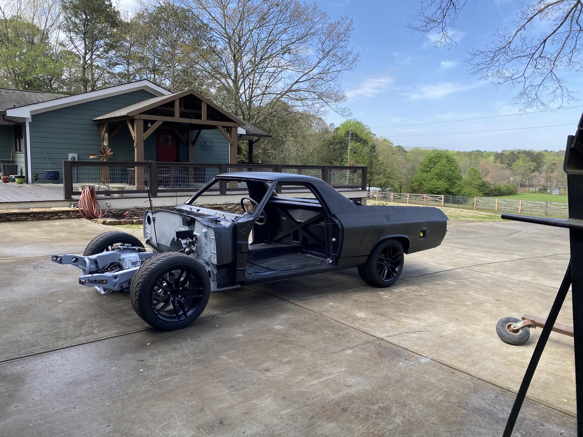

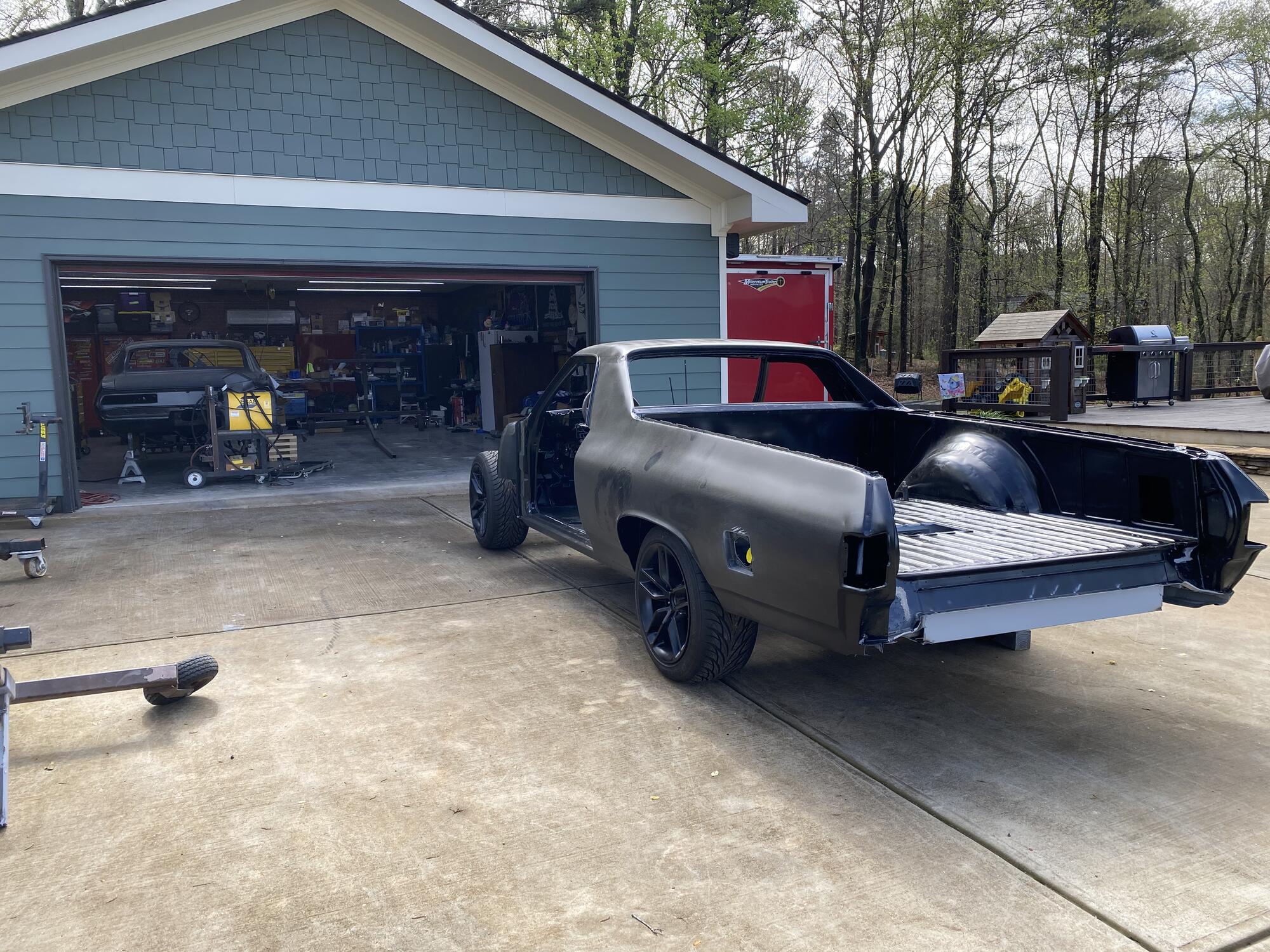

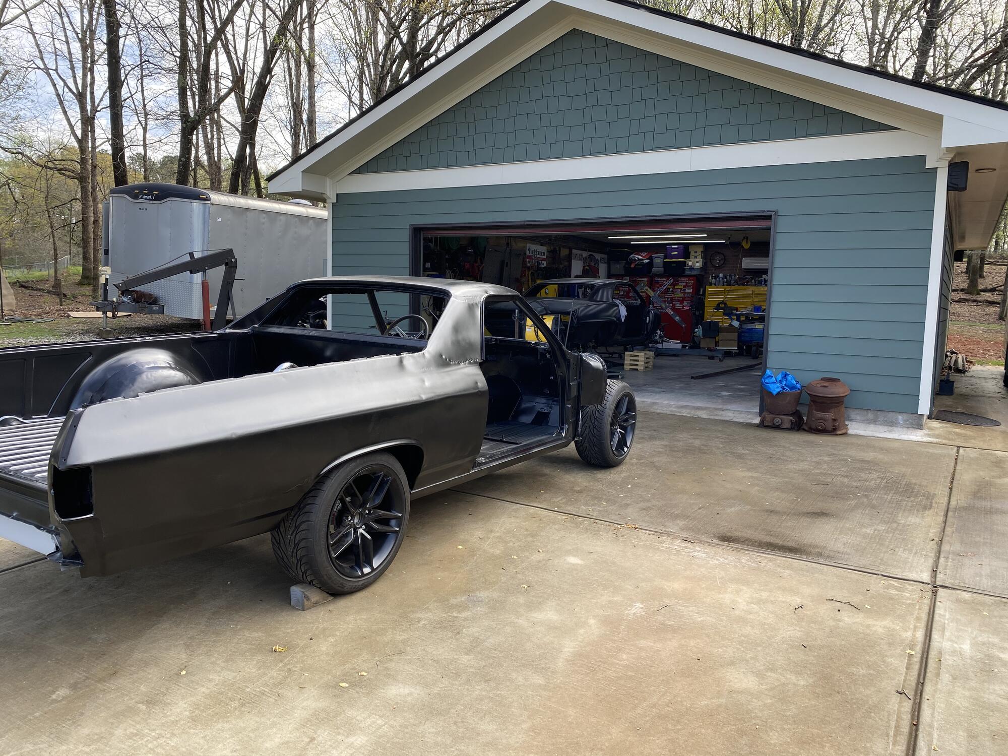

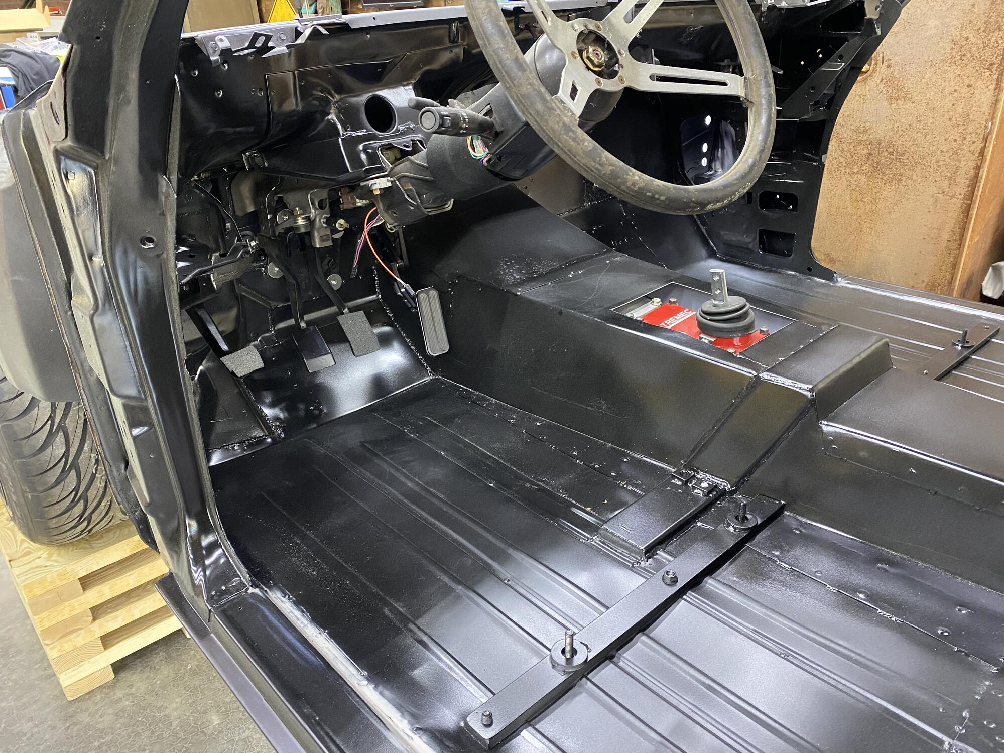

      Elcamino on its own wheels
      Off the rotisserie ��Name:  8104E649-6C34-440D-9219-425812C7CB2C.jpg
Size:  564.1 KBName:  E6D22489-1036-490C-BF55-4EDFCD29AB33.jpg
Size:  677.3 KBName:  799B0B82-10E0-47E9-90AA-01E59DC8AA74.jpg
Size:  573.7 KBName:  47ED96D3-A160-49CE-A7F0-FFAF86348D67.jpg

    7. #207
      Sep 2013
      sw Kansas
      1,646
      A project on wheels is always better unless you have one of the forklifts with 8' forks. It's good to see green in the trees in the background. We may live through another winter.

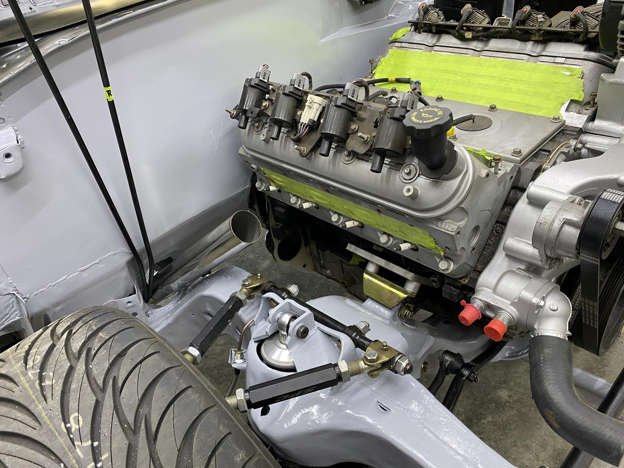

      Motor and transmission installed, so happy to be at this point.

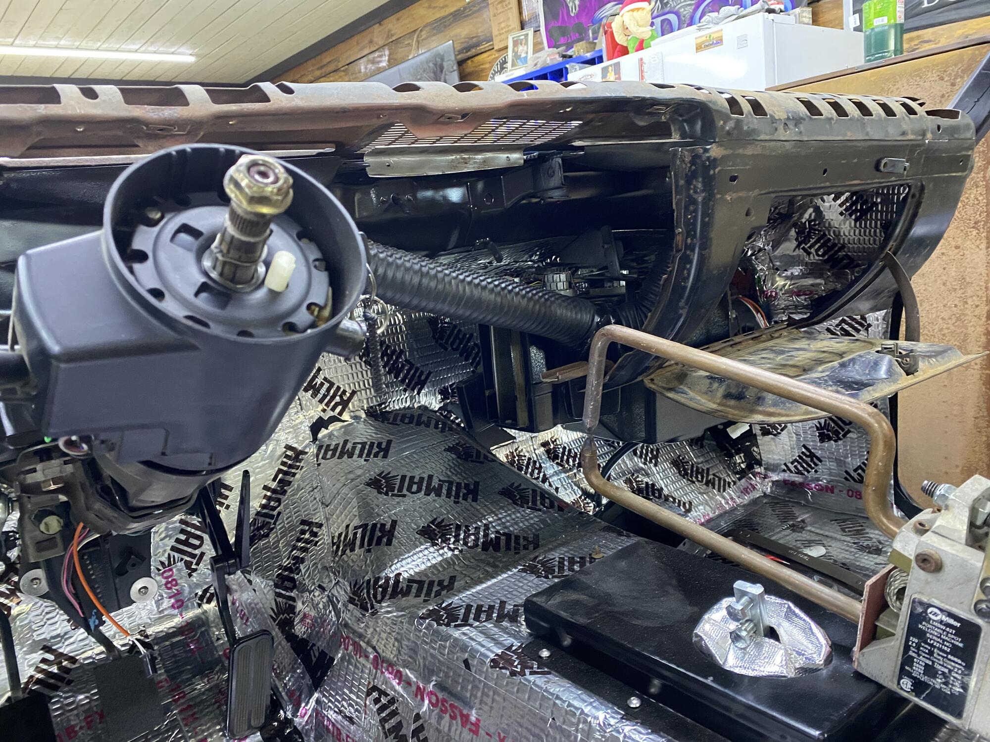

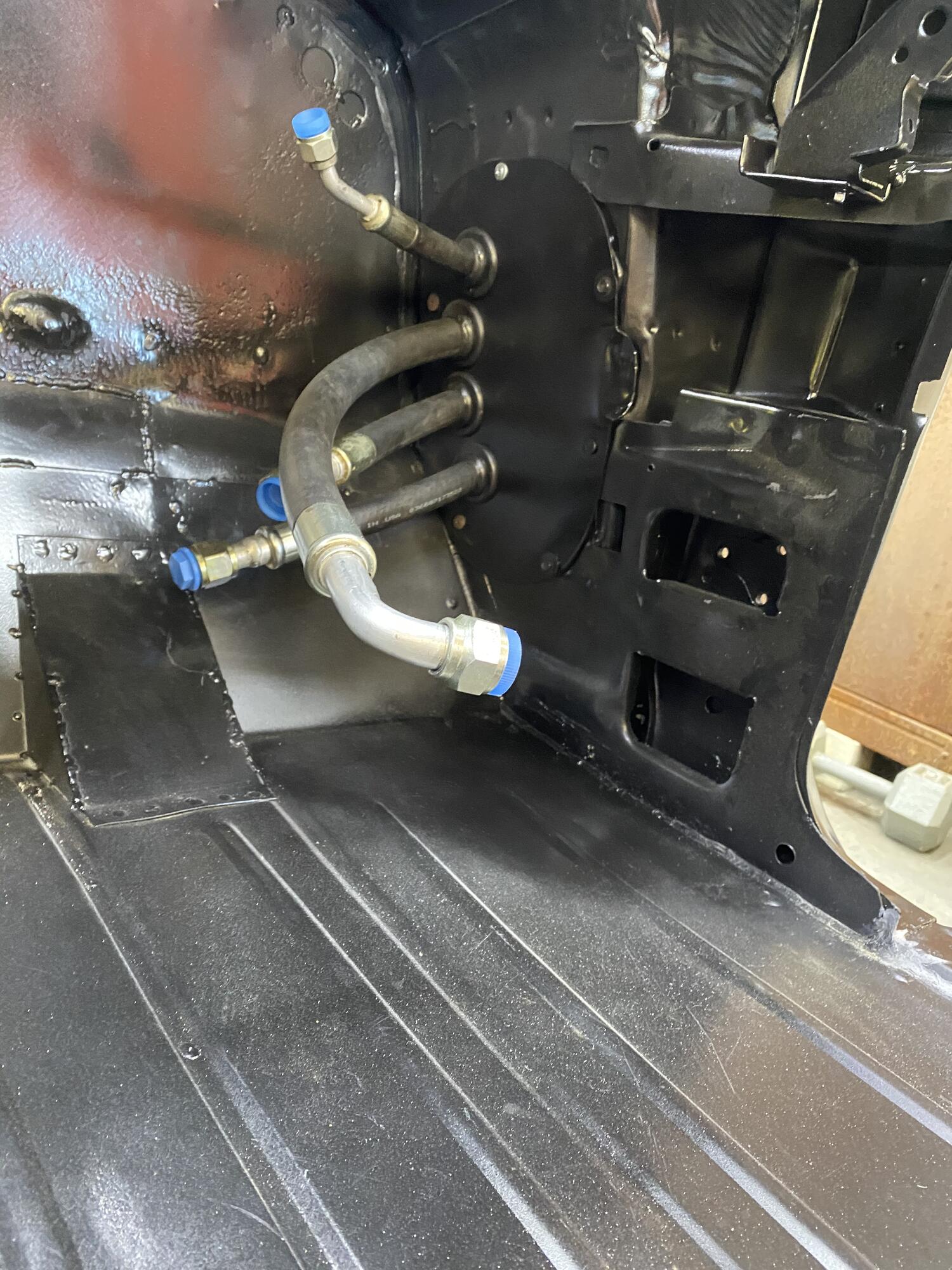

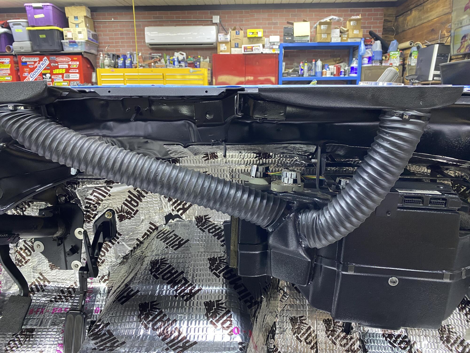

      Today’s work 69 Elcamino project
      Installing the vintage air lines and the close out panelsName:  C54A15B1-86B9-4DF7-8D10-68B7BDE12C8A.jpg

    10. #210
      Apr 2001
      The City of Fountains
      15,978
      Looking good!
      I am a little confused as to how the wastegates are plumbed and why they are so far back in the exhaust system.

      Aug 2002
      Waleska Ga.
      2,711
      Quote Originally Posted by andrewb70 View Post
      Looking good!
      Andrew
      based on information I could find, the waste gates are best at a 90% before the turbo. So when the throttle pedal is let off the gas’s coming from the motor will hit the gates in a straight line to vent off excess gas’s.
      this turbo thing is an experiment for me to see if I can make it work.
      im prepared to make changes to the system in the event it doesn’t work out or I just don’t like how it works.😊
      thank you sir!

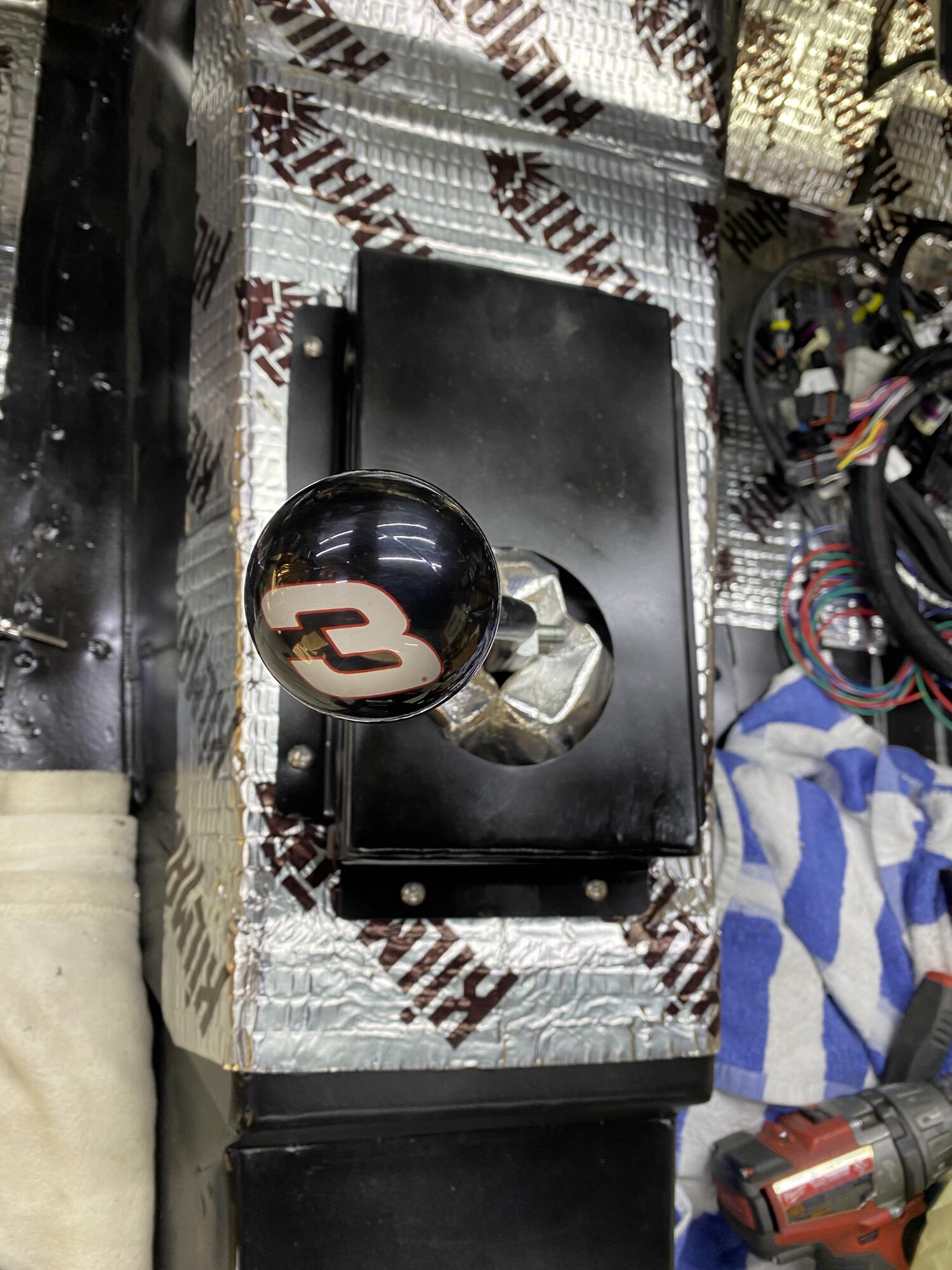

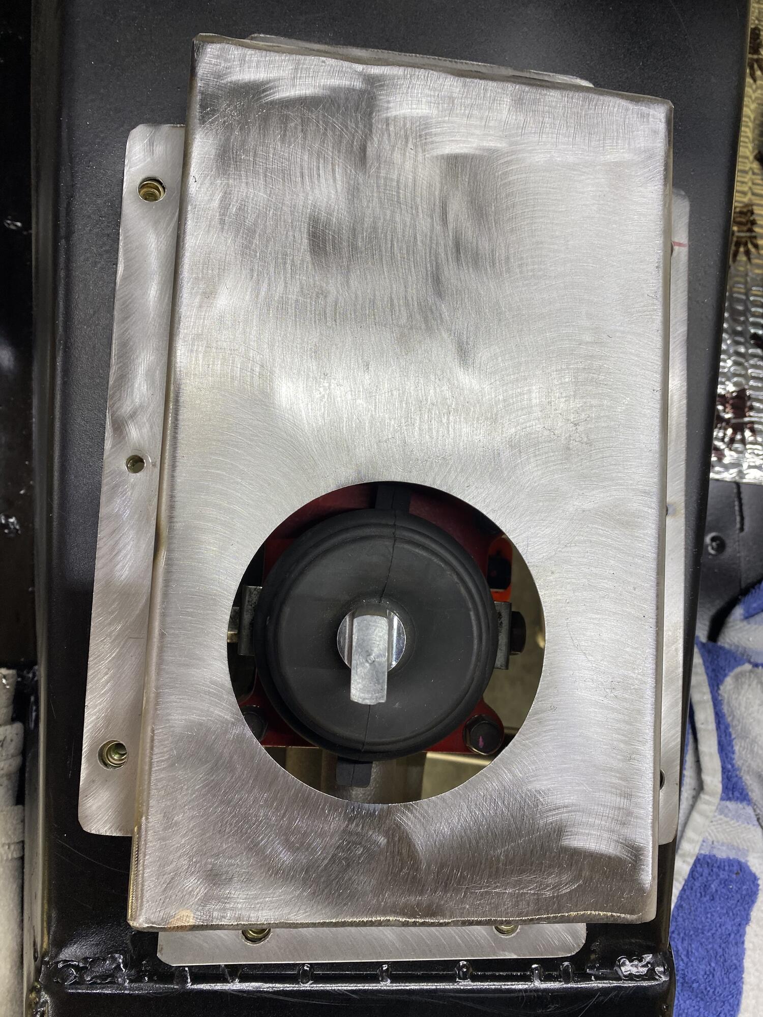

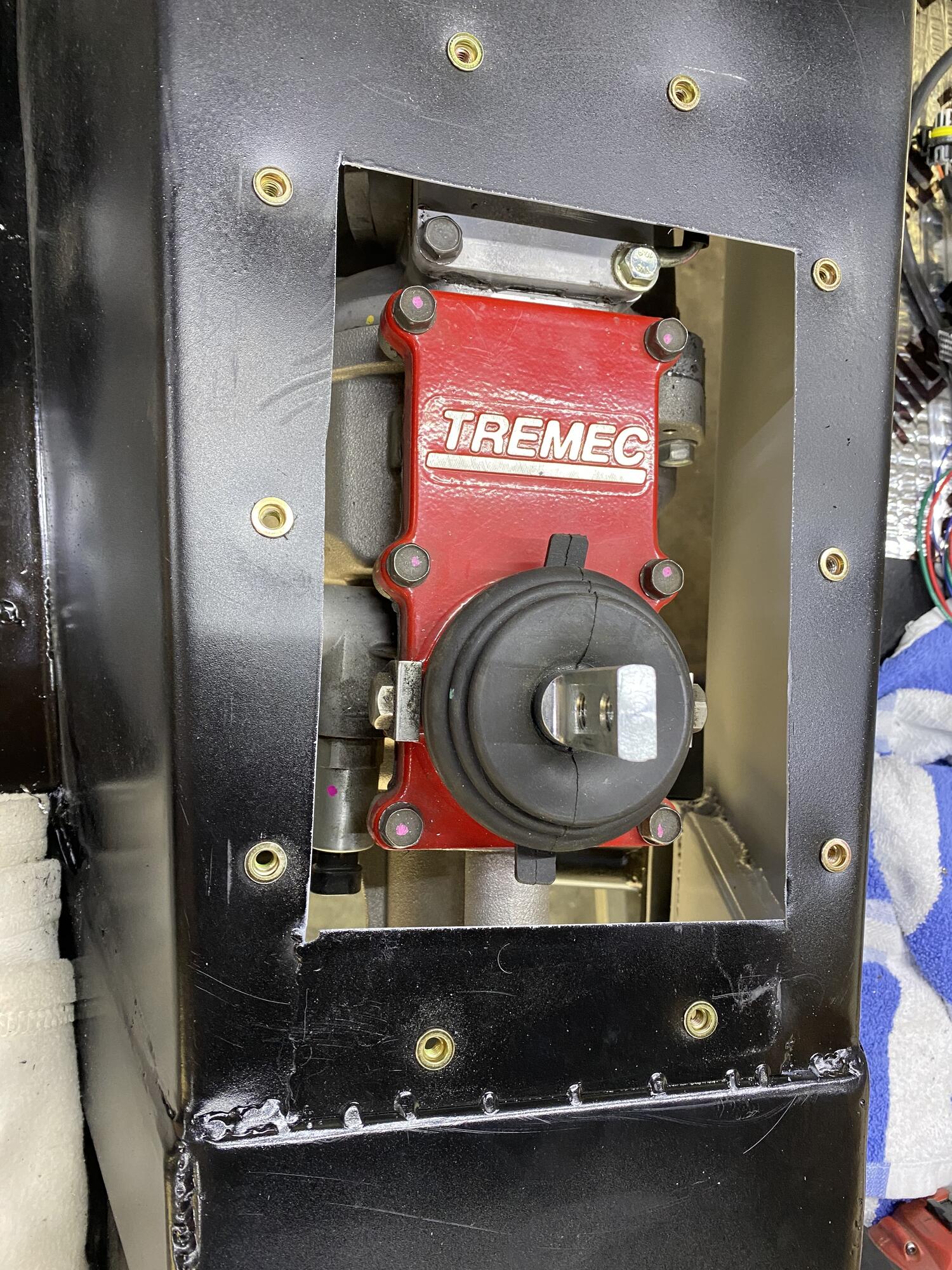

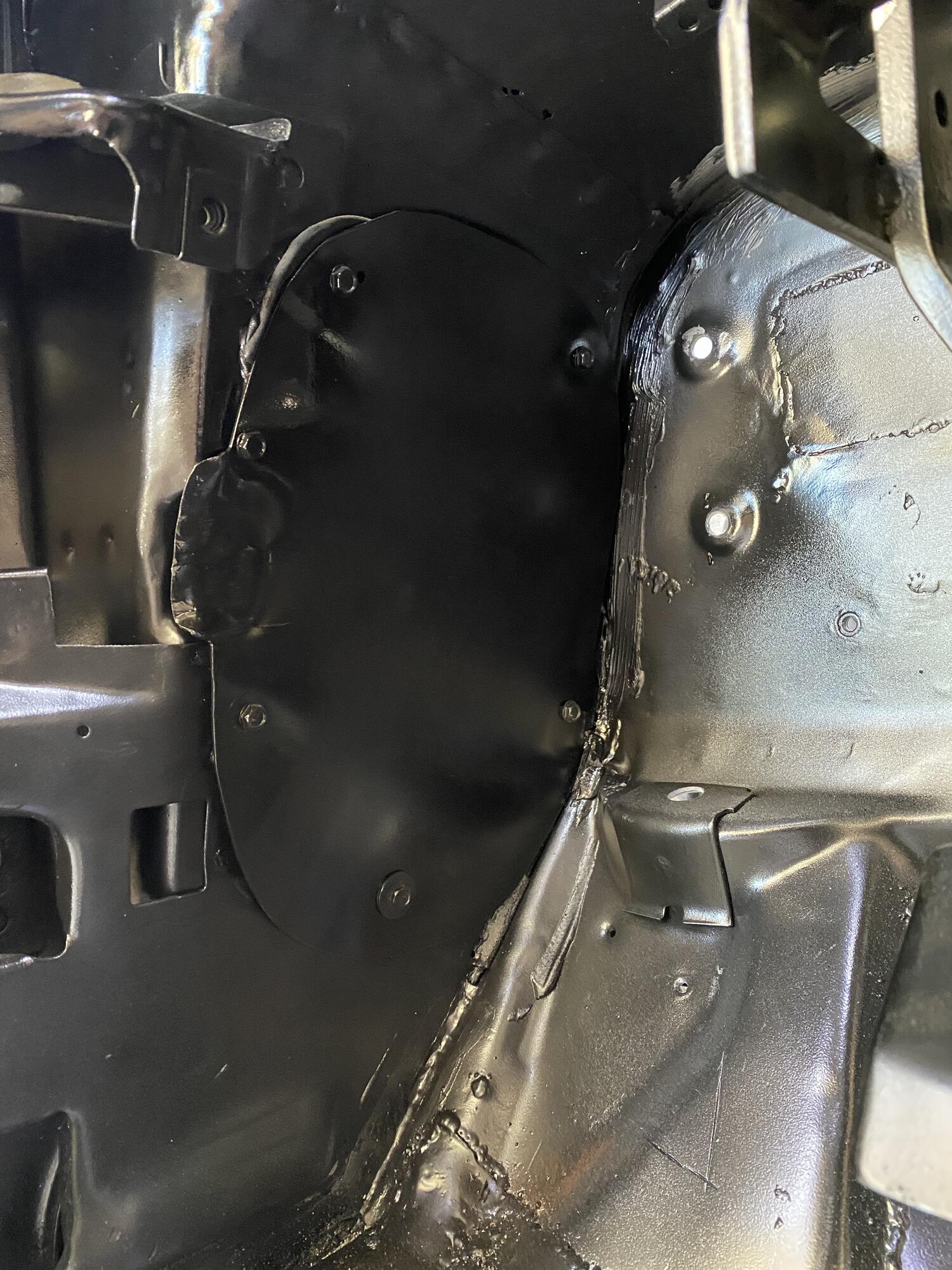

      Since I was doing metal work on the 69 Camaro this morning and I had put 6 hours on it.
      Took a brake to rest then back to the garage to work on the Eldog.
      I needed to make the cover for the shifter hole in the 69 Elcamino couple hours later this is what I got.Name:  22E2C001-5B76-4E83-A51E-6D46C3F20C0F.jpg

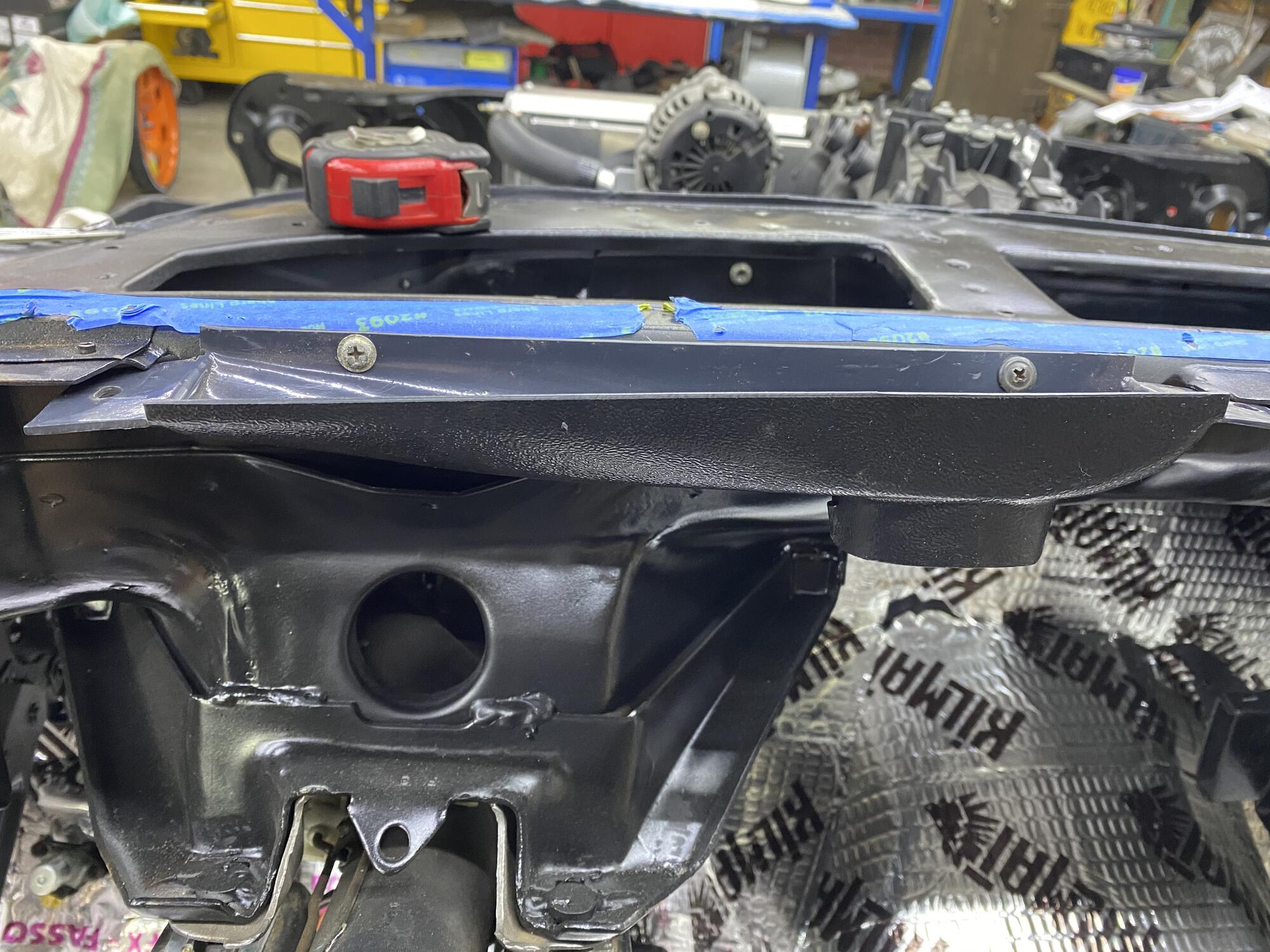

    13. #213
      Aug 2002
      Waleska Ga.
      2,711

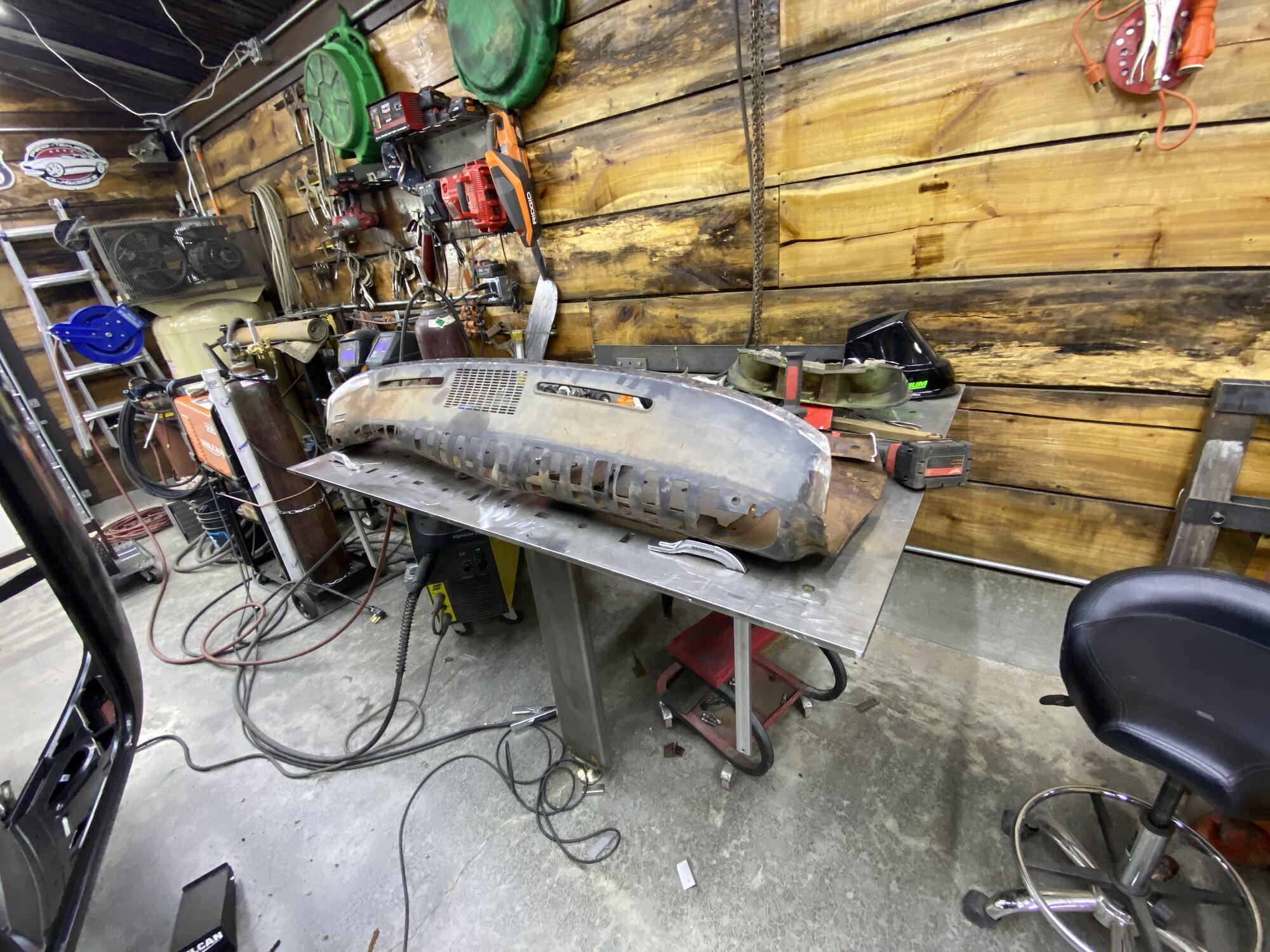

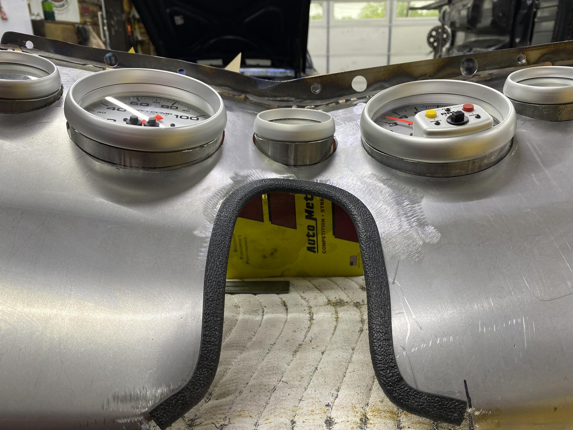

      1969 Elcamino project

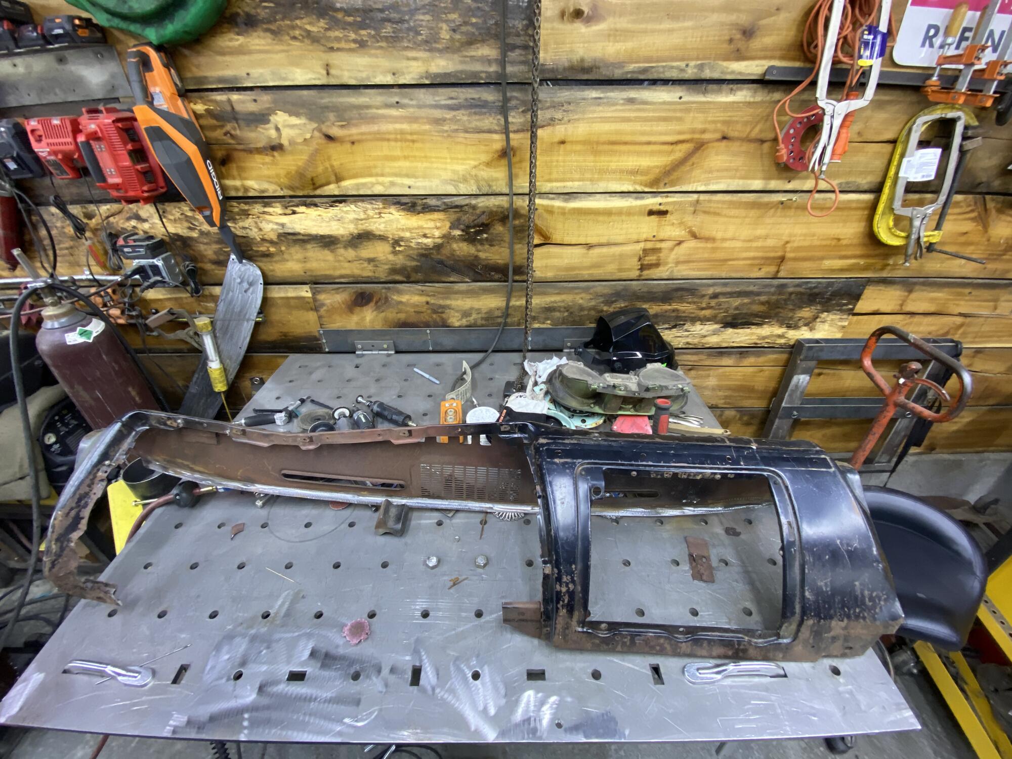

      Picked up the drive shaft Friday and some other parts needed for this car and the 69 Camaro build.

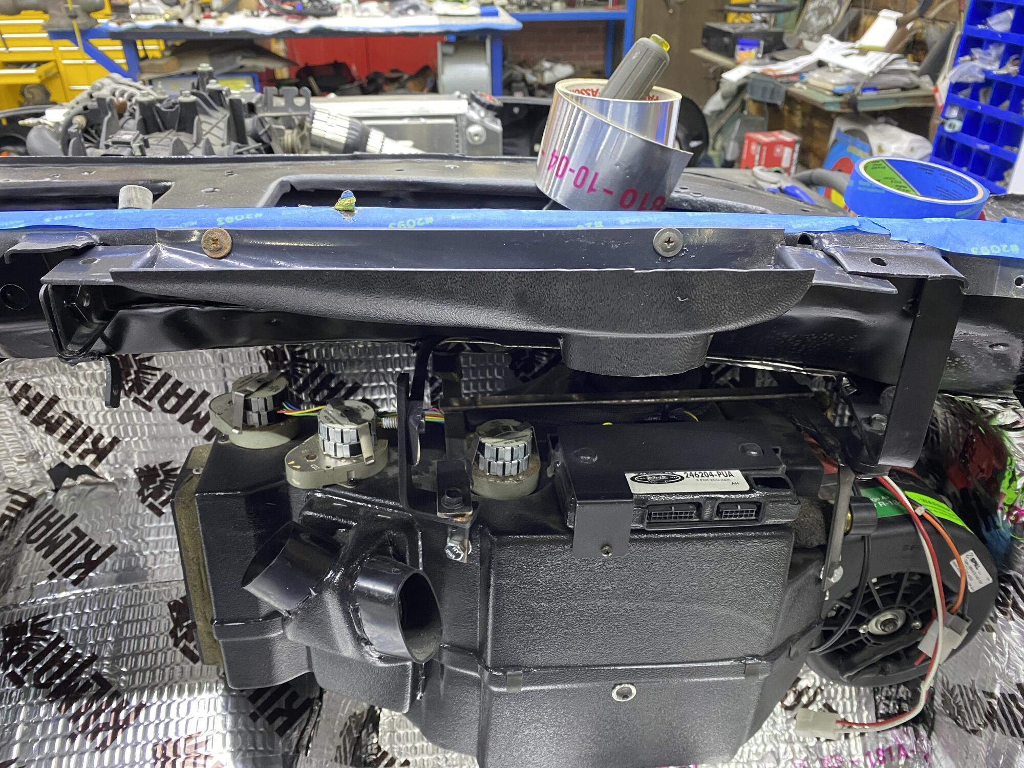

      I decided that I wanted the metal dash to be removable so that’s what I’ve done. Cut all the welded pieces off then cut and trimmed until it fit.
      Next up I will try to build a new gauge cluster out of metal.
      I want to make a mount for the Holley dash display to mount in. The last picture is the display unit.Name:  0046341A-7853-486E-A8B9-8C68CCFD3C48.jpg

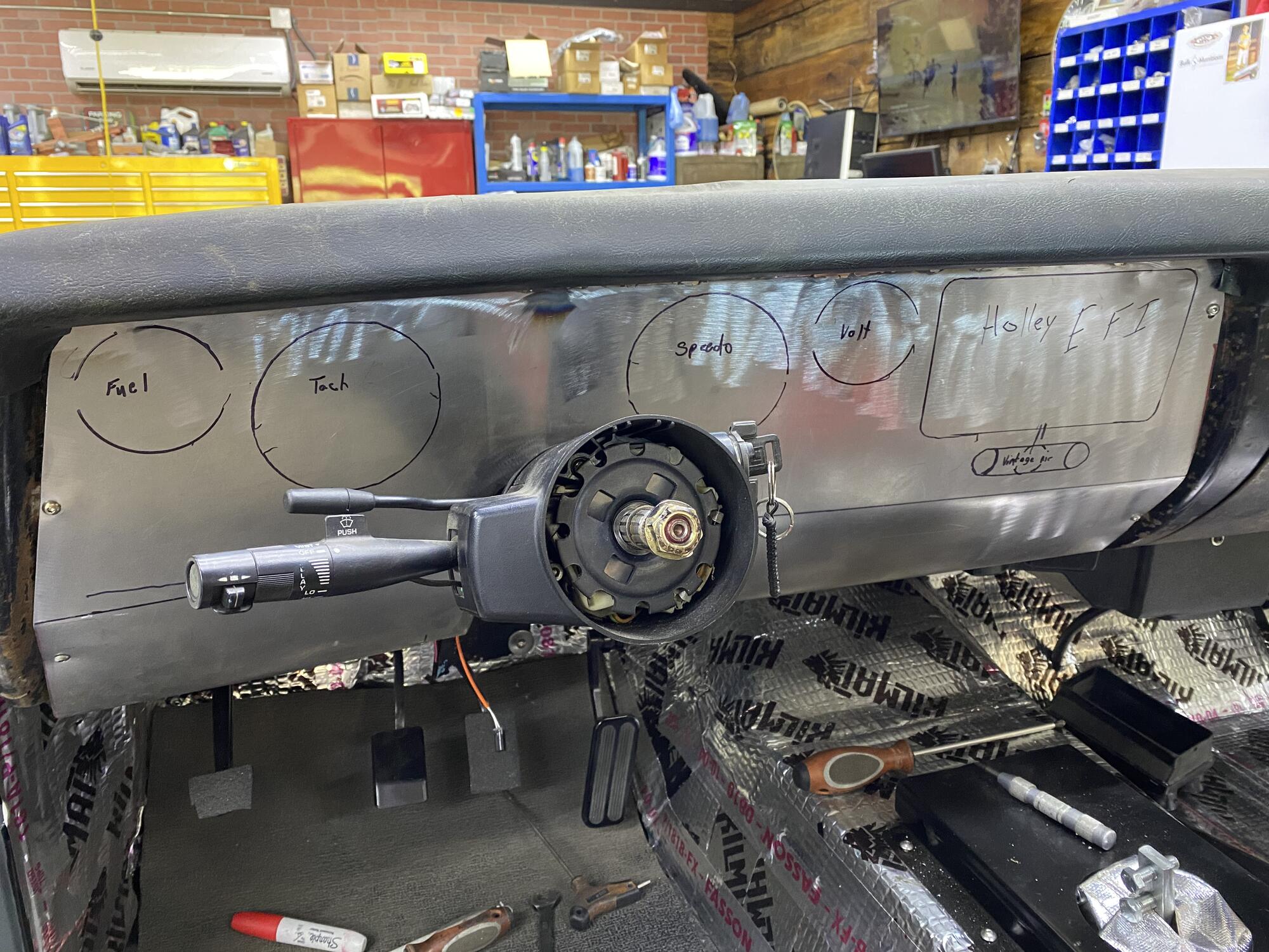

      Figuring out the layout for everything going in the dash!

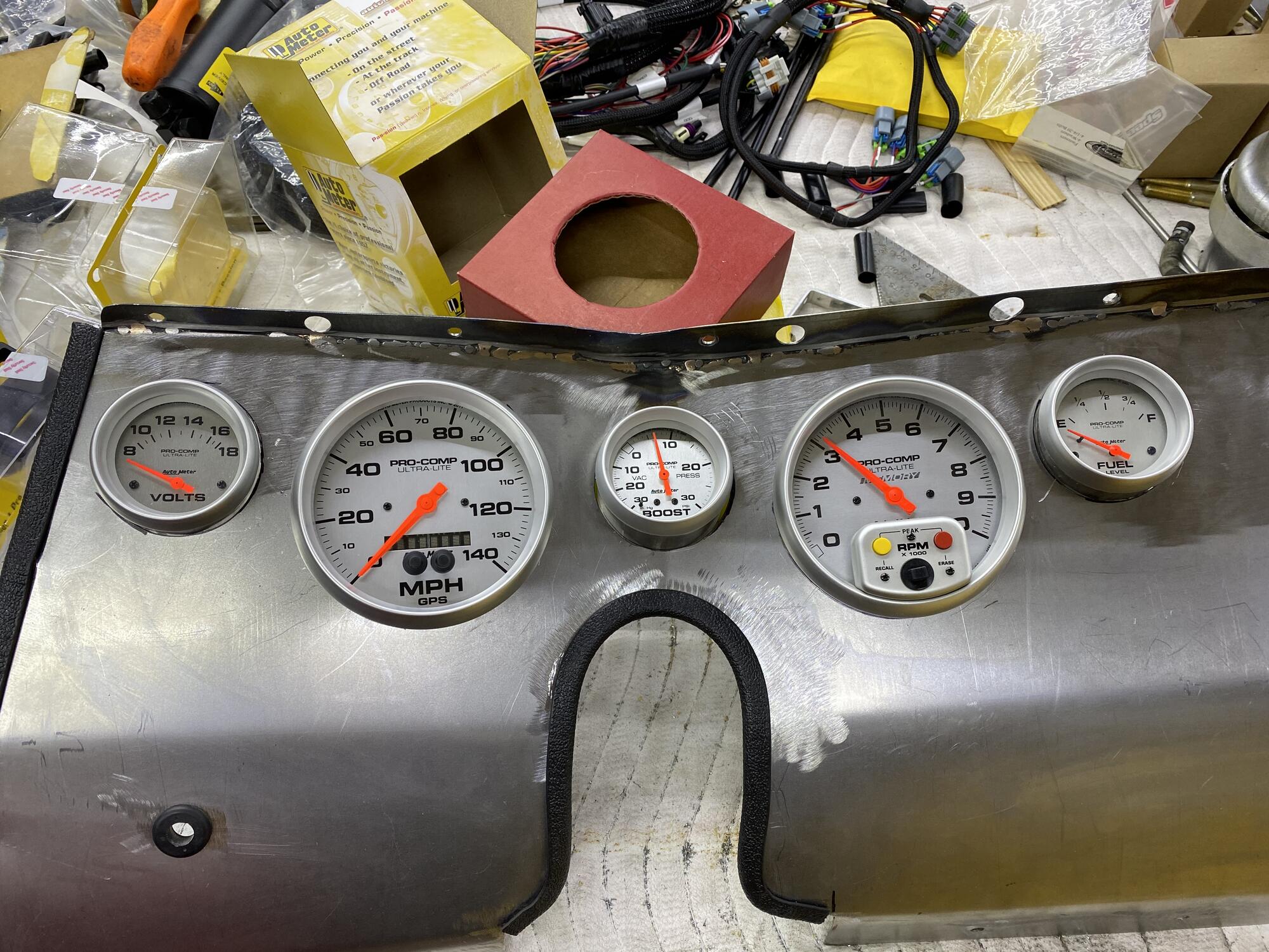

    17. #217
      Aug 2002
      Waleska Ga.
      2,711

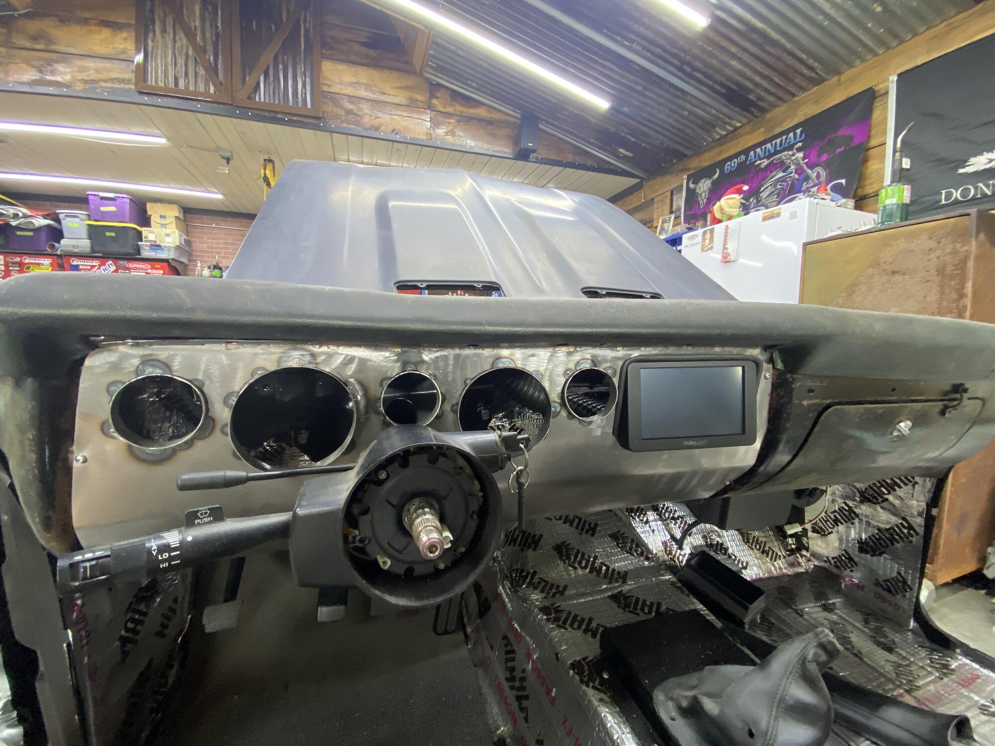

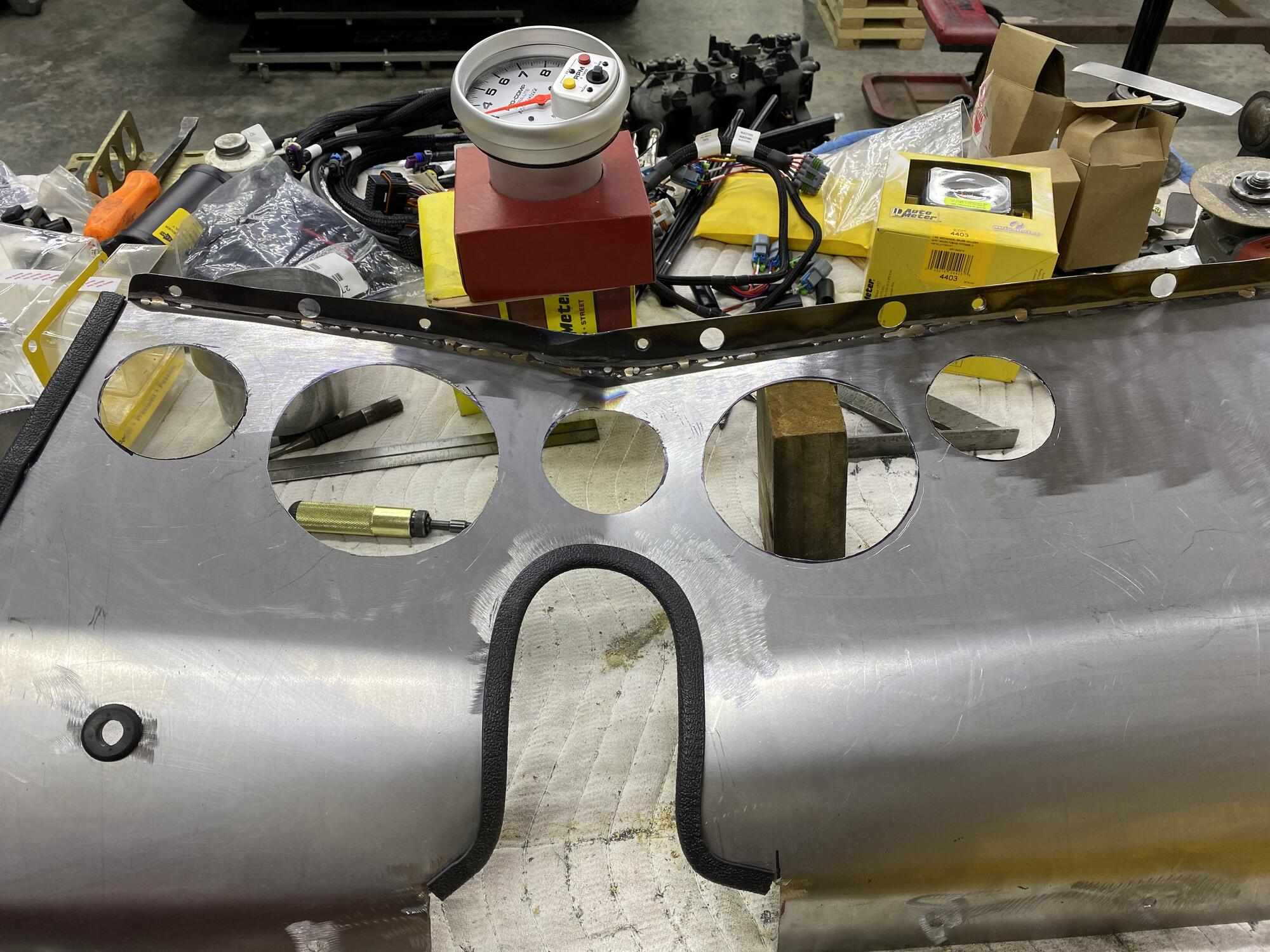

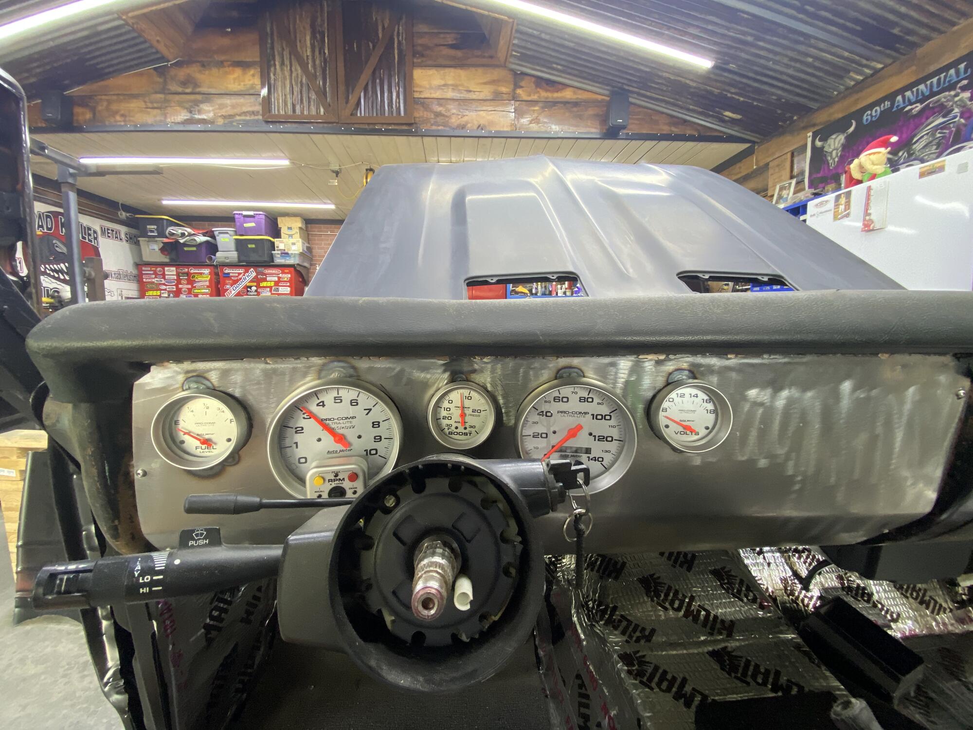

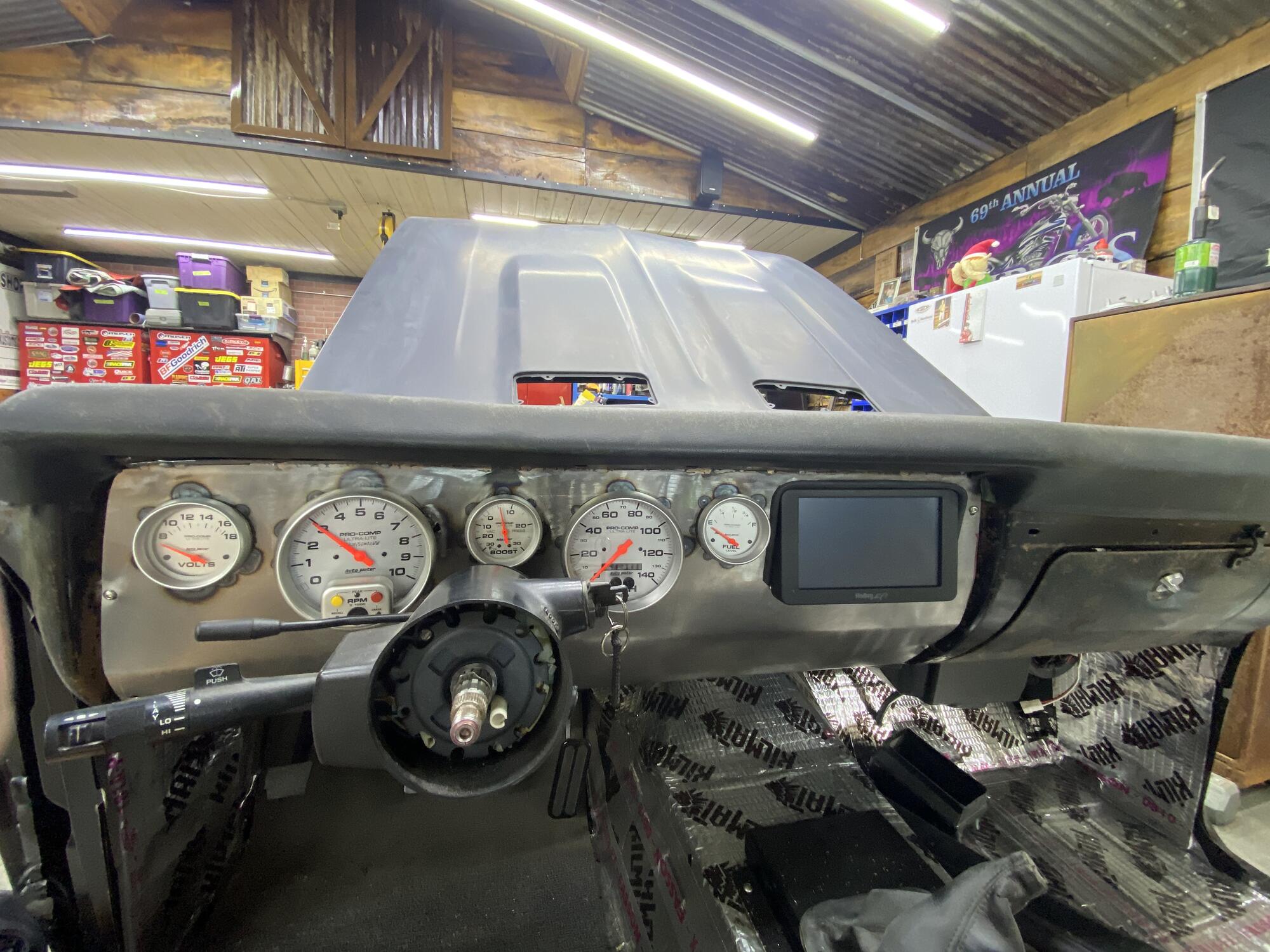

      Today’s work,Dash holes rough cut for the gauges . I got to hammer and dolly it back straight now. I have a love/hate relationship with hole saws.��Name:  1F502836-2953-4057-A4CB-325956C42F41.jpg
Size:  412.2 KBName:  894A1FE0-112C-4379-8F3A-552F7CC607B1.jpg
Size:  380.0 KBName:  FC514591-1954-4E1F-8405-F157FFA0AB36.jpg
      Gauge layout and some pie cuts to get the gauges at the right angle.

    18. #218
      Aug 2002
      Waleska Ga.
      2,711
      More fitting and tack welding today.
      Got the Holley efi display mounted, A/C controls nextName:  045D4E0D-A9CD-4D60-B655-E7D2720D0F0A.jpg
Size:  349.7 KBName:  901989FD-5917-48ED-91CA-CC2E746FC61A.jpg
Size:  358.4 KBName:  1F17662E-AB2F-430C-A55D-77B9C2D43E05.jpg
