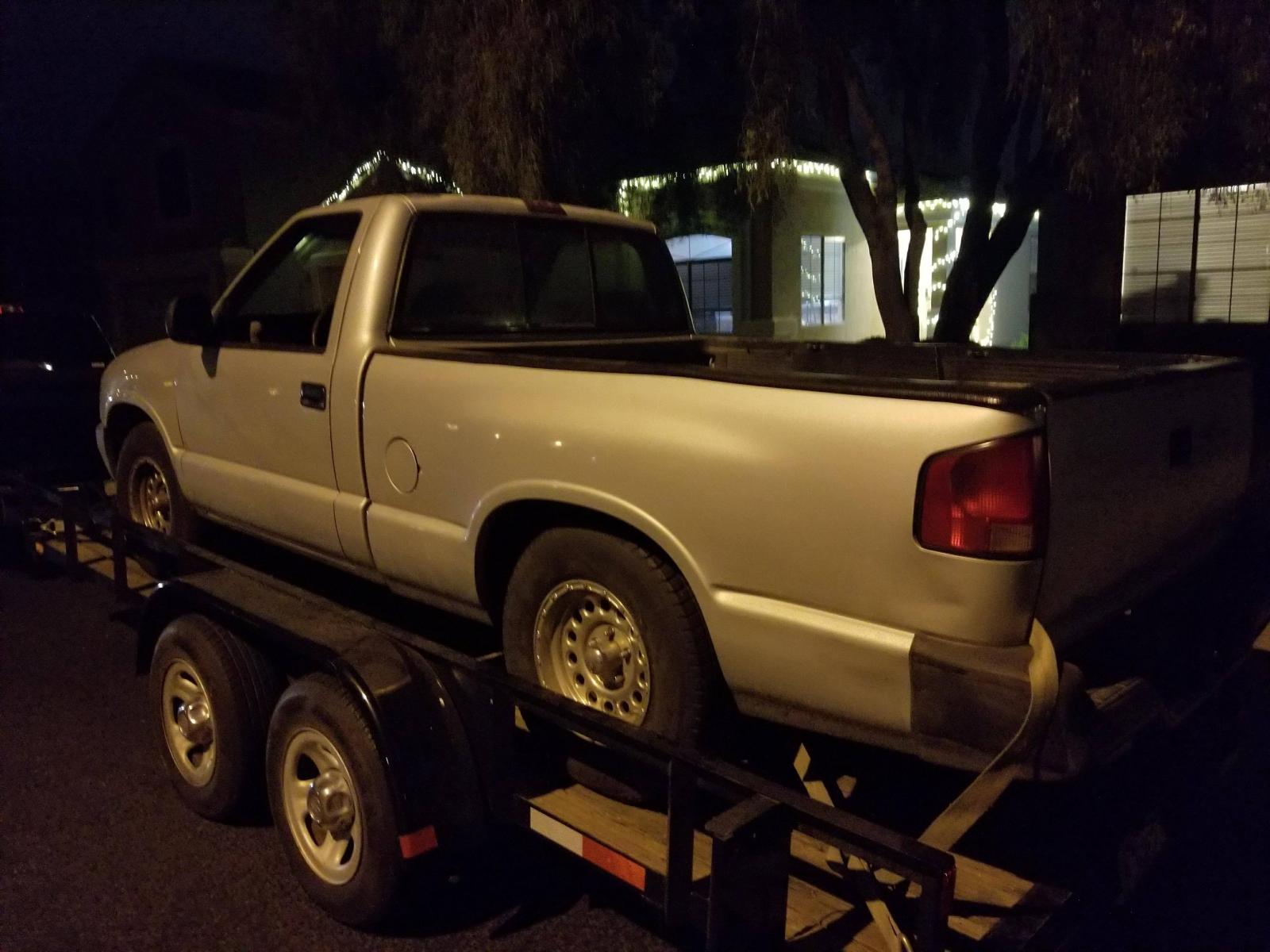

      So now I had a beat 4 door 2001 blazer.
      Second part of this story is a friend says some guy on craigslist or facebook ads has a hombre they want to trade. I show him the blazer, tell him of its faults, but he is happy since the truck is too small. I reiterate the blazer is a pos, and still he says he is fine with it.
      I load the blazer on the trailer, and head over and we swap titles. The guy didn’t tell me the axle in the hombre was toast, and a replacement junk yard piece was in the bed. This was fine by me, but I told him all about the blazer, and didn’t get that vital info back from him.
      Anyways, I start and drive the hombre on the trailer, tie her all down and head home. The next day I check out the truck in the sunlight. The body was nearly perfect. A few dings here and there. Interior was what you’d expect for a nearly 25 year old throw away truck. The previous owner’s mom was driving the truck back and forth to work with cold AC. When the rear axle went out, she upgraded and the hombre just sat as an eye sore.

      The night I towed Alice home..

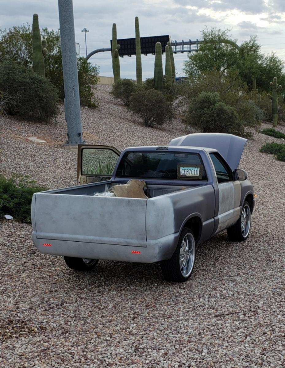

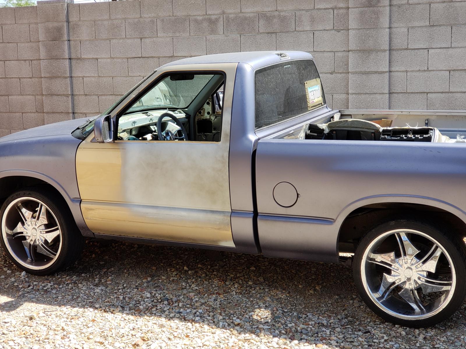

      Next, I couldn’t stand a weird multiple colored little ugly truck, just made it uglier. So a few hours of work, and a bunch of left over basecoat I poured into a gallon can, it turned into this look. It stayed looking like this for around 6 or 8 months while driving back and forth to my place of employment.Name:  2.jpg

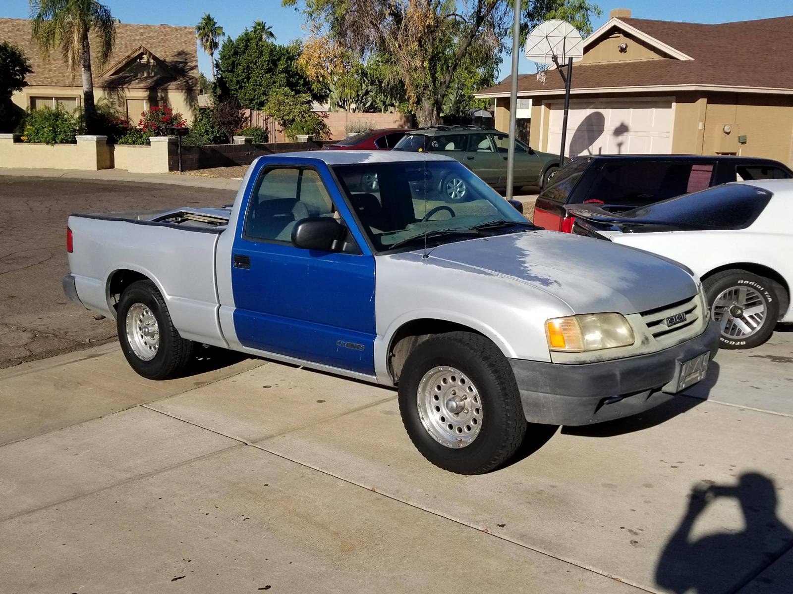

      This picture is sort of funny to me. A guy was on the S10 forums or facebook, I don’t remember which, had rust and needed a cross member from the rear frame section of an early S10 in order to pass Canadian motor vehicle inspection to register his truck. For multiple hours, possibly even a few days, I don’t exactly remember, everyone told him to just weld in a 2x3 cross member and it’d be fine, after multiple attempts of telling people he can’t do that, he needs a real factory piece of a truck, I said, f*ck it. You paypal me $200 USD right now, I’ll stay late at work, pull my bed and cut my cross member off, and mail it to you the next day. So, needless to say, I held my word, and sent him a rust free piece of my Alice to the land of the Maple Leaf..Name:  5.jpg

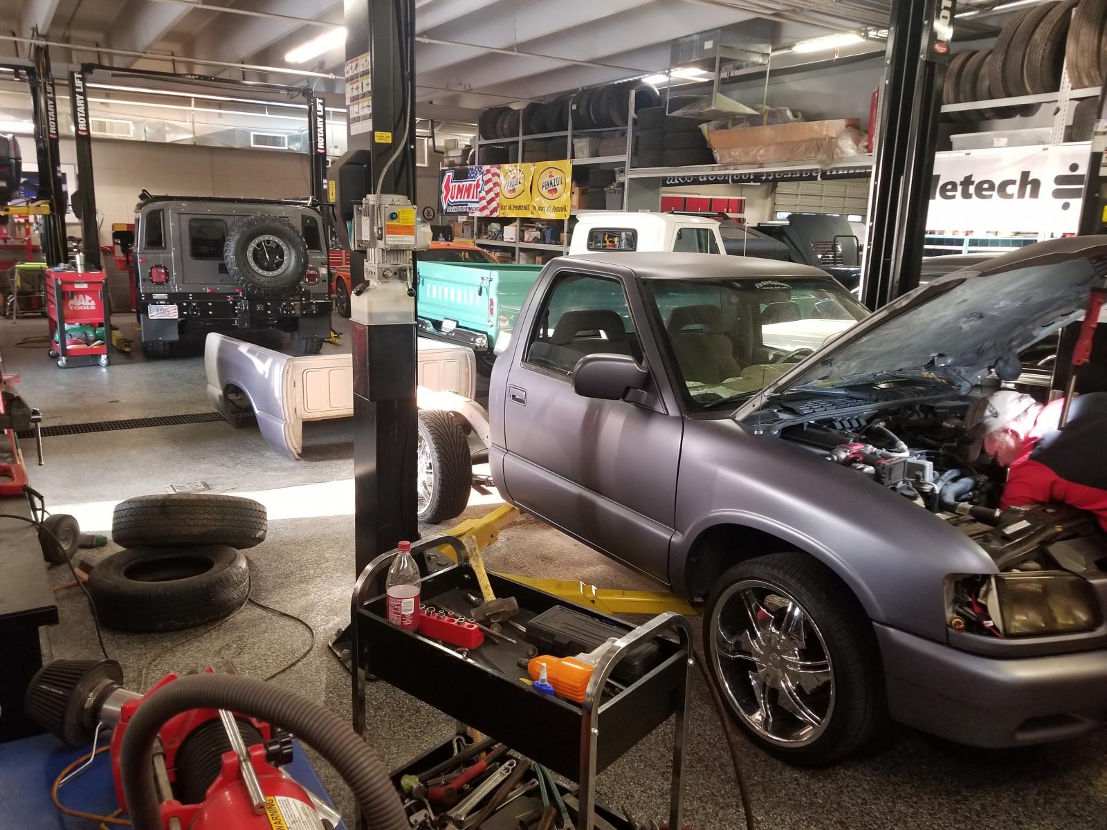

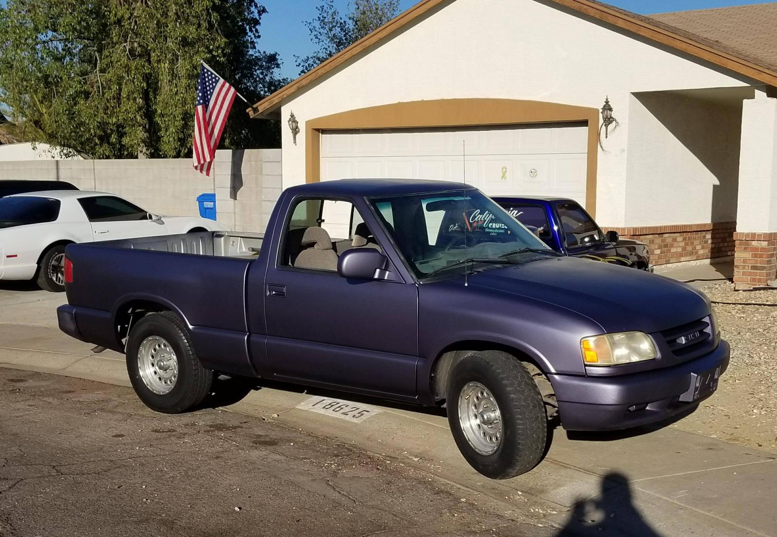

      So after that, the truck was towed to my place and sat in the back of the shop for about 4 to 5 months. I needed to decide what to do with a $1500 truck with a dead engine. I could pull the head and go through all that jazz, but in the end I really didn’t want to spend a few hundred dollars on an anemic 83hp 2.2 4 banger.
      I’ve already shaved the doors, shaved the taillights added a roll pan, built a custom tailgate skin, added a custom audio system with a well-built behind the seat custom subwoofer box and amp rack. Long story short, I’m well into a fun build, just need to decide on a good course of action. I surely wasn’t planning on dumping a bunch of money into this truck….or so I thought.

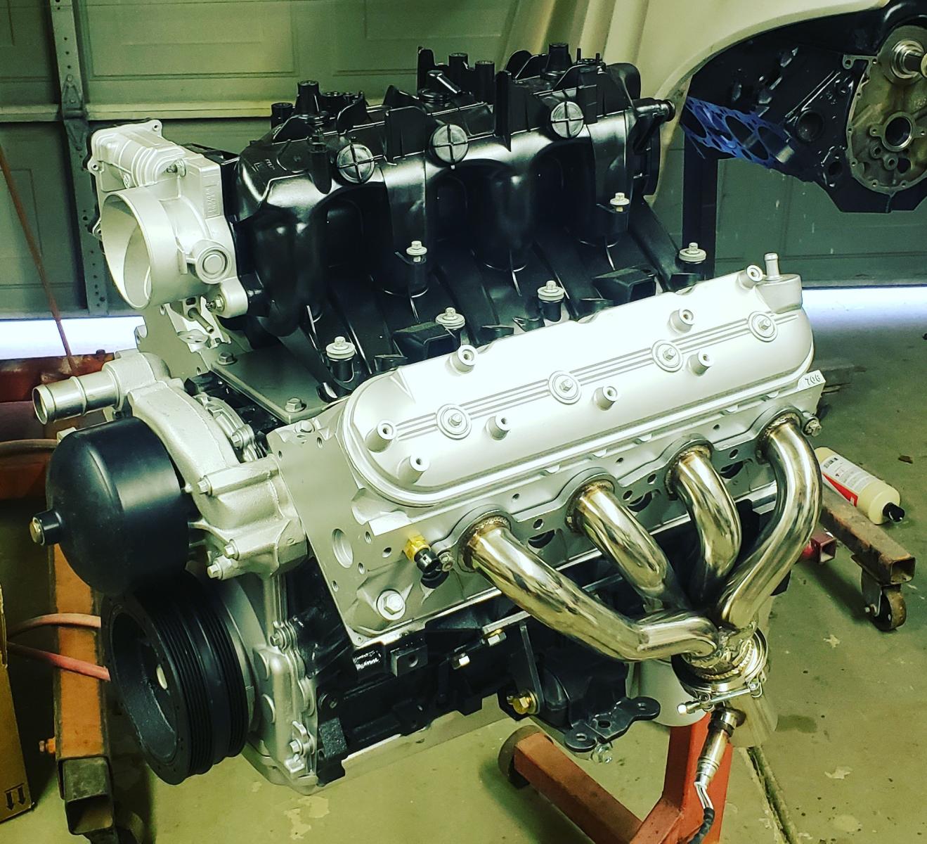

      Knowing I had a few 5.3 truck based “LS” motors in the shop, it was a no brainer, this Hombre was getting one. I needed a transmission asap. A few calls and a buddy had a 4l60 laying under a bench with unknown miles or issues. Not a big deal, I knew it needed getting built to handle some power, so a few hours later I picked it up and dropped it off to a buddy to get opened up. He ripped it’s guts out and replaced it with some good internals, and a used convertor he had from his own truck. It was a 2800 stall and was “clean, no issues, good to go..”
      I got out the hoist and grabbed one of the truck motors from the lot, and sent it over to my machine shop buddy to get some new pistons, and valve job/springs etc, all the makings of a mild 5.3 build. Once I got the motor back, I slapped it back together with new GM bolts/gaskets and I think a TS stage 3 cam. The new pistons were flat tops, and I had the block and heads shaved some to get some cheap compression.
      A set of Ebay S10 swap headers and a drive over to dirty dingo, I was nearing ready to drop in the new combo.
      Here is what some parts store 'chrome' paint can do for some clean parts..

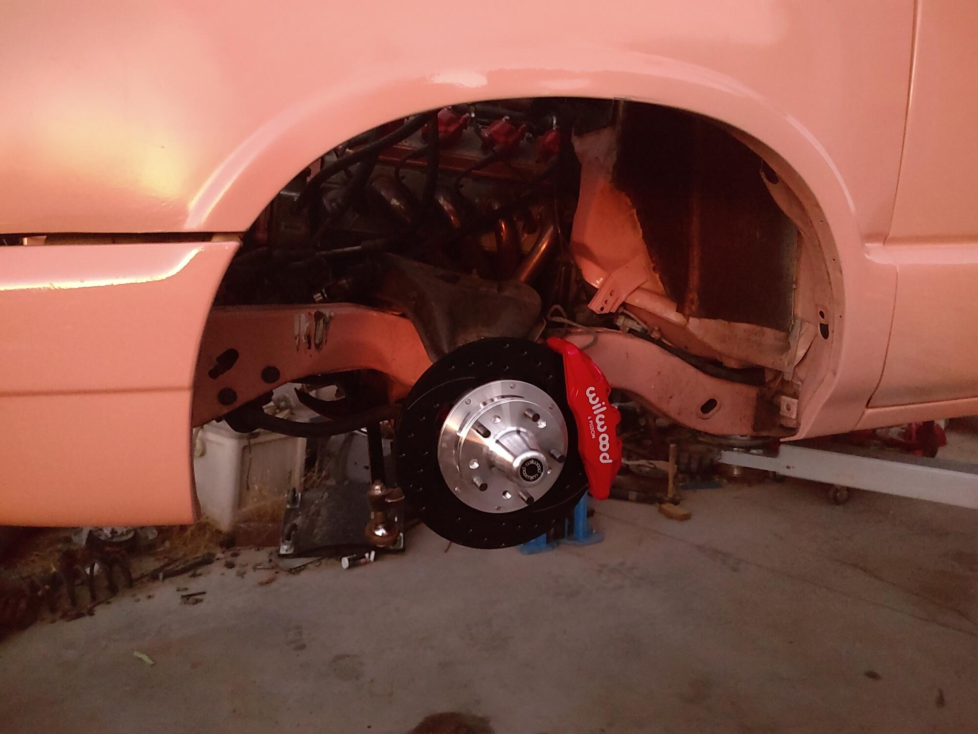

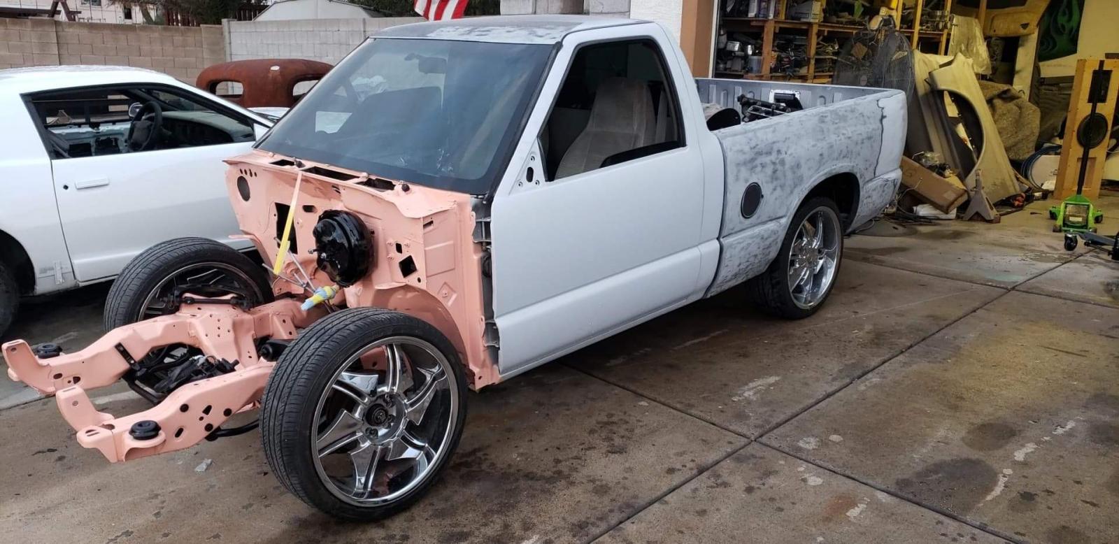

      Fast forward through a few months, and got the engine in, swapped out the booster to a hydroboost system from a mid 2000s tahoe, and put a few miles on the combo.
      At this point, it’s got a welded spider gear rear 4 cyl axle (the weakest of the weak) and with future plans of possibly doing a body drop I started thinking of the current place the engine is sitting, and how far the tires will go into the firewall, which requires mini tubs.
      Remember, this was not planned, but during construction, plans get realigned to the current shiny thing at hand. Lol.
      Also you can see I have removed the entire factory wiring harness and replaced everything with an aftermarket wiring harness. In this picture I am still playing with the harness and a few other things.

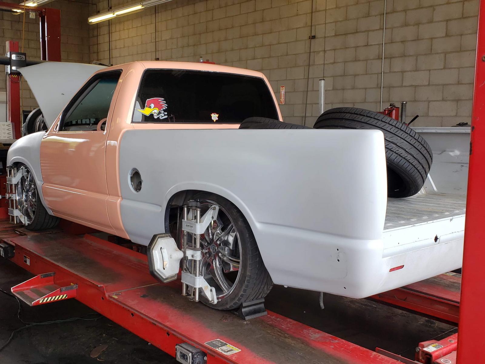

      Picture from getting an alignment and another once I got the cab painted.
      I have several same age buddies that are starting to drool over this color. We all grew up together, and lived the early 90s, pastel colors minitruck era..Name:  gggg.jpg

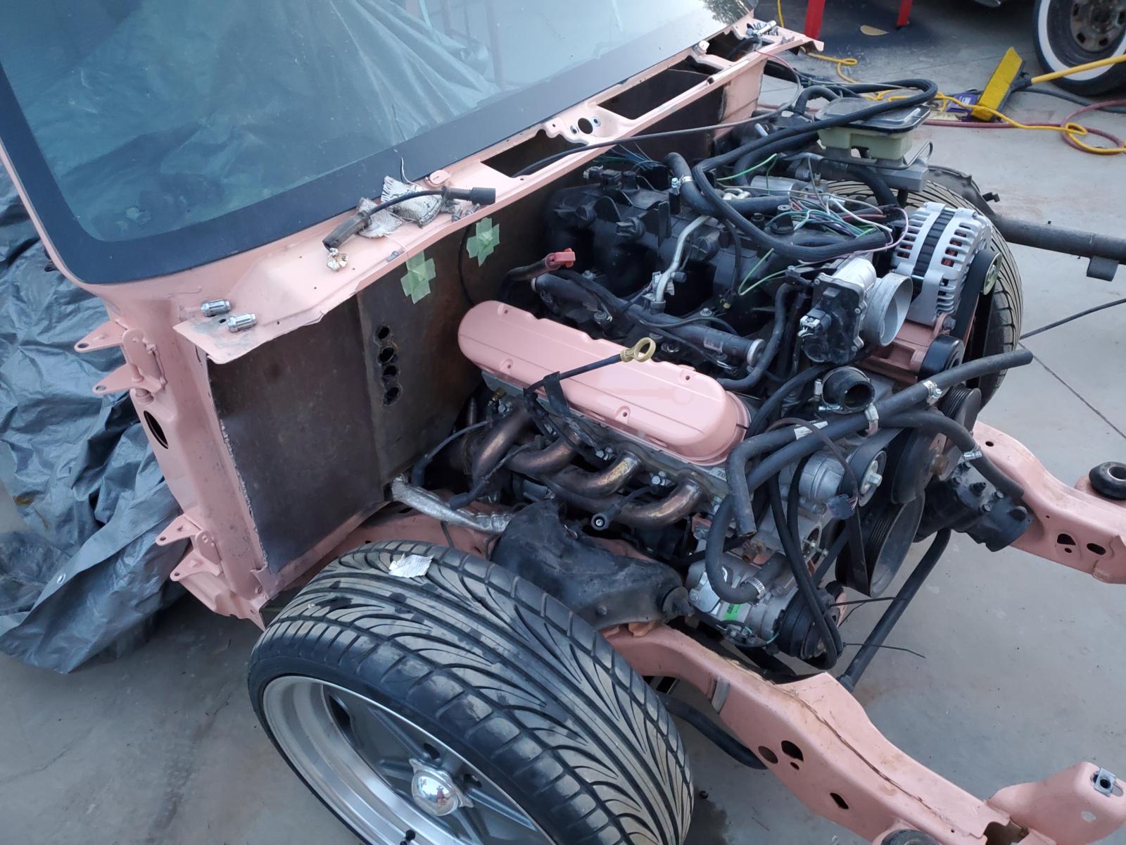

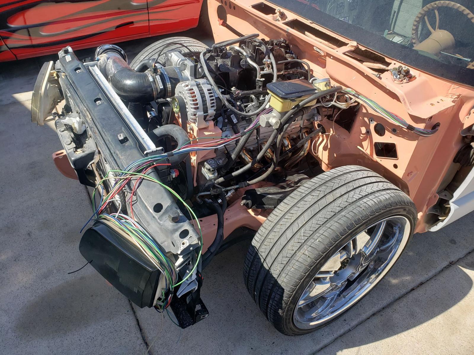

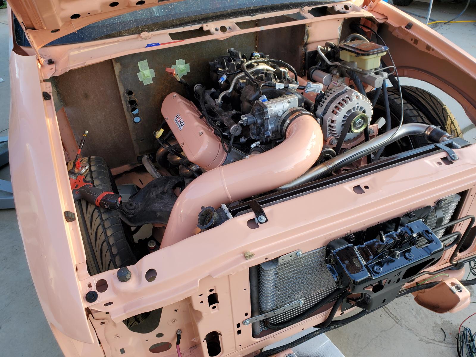

      Here is a “current” picture of the engine compartment. You can see in these pictures I decided the fabrication needed for the minitubs and the exhaust collectors were going to need modification of the firewall, so I decided to remove almost all of it, and push it back 2 inches and use flat sheet to ‘shave’ the firewall.
      This works well, for clearance along the engine to fan to radiator clearances, and moves the engine back a bit for a bit of weight transfer off the front end.
      You can see my firewall still needs body worked and painting. I’m planning to pull the engine and getting all this taken care of once I am back home. I also have a new intake and planning on building a turbo set up for the truck.Name:  20200509_193542.jpg

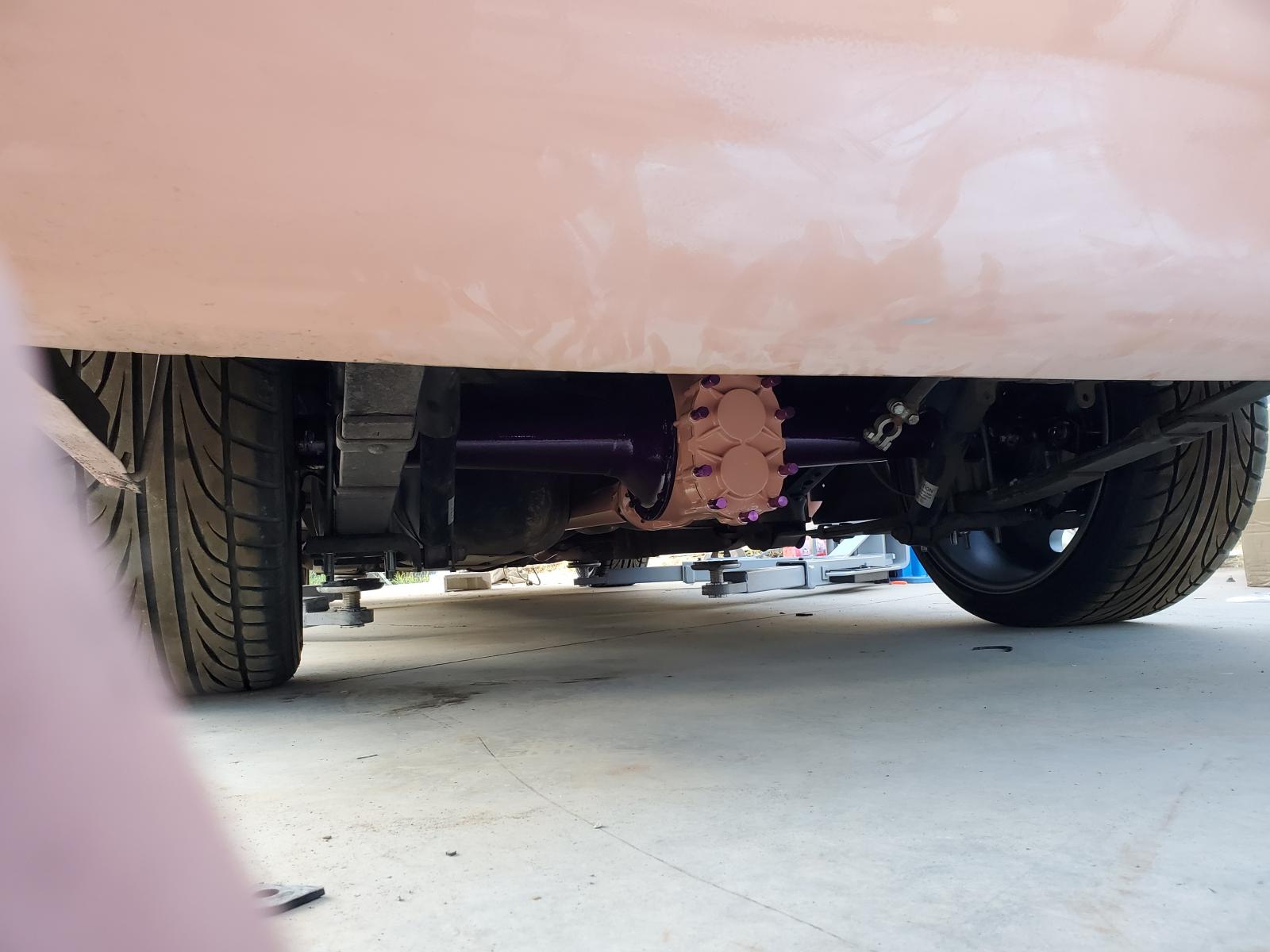

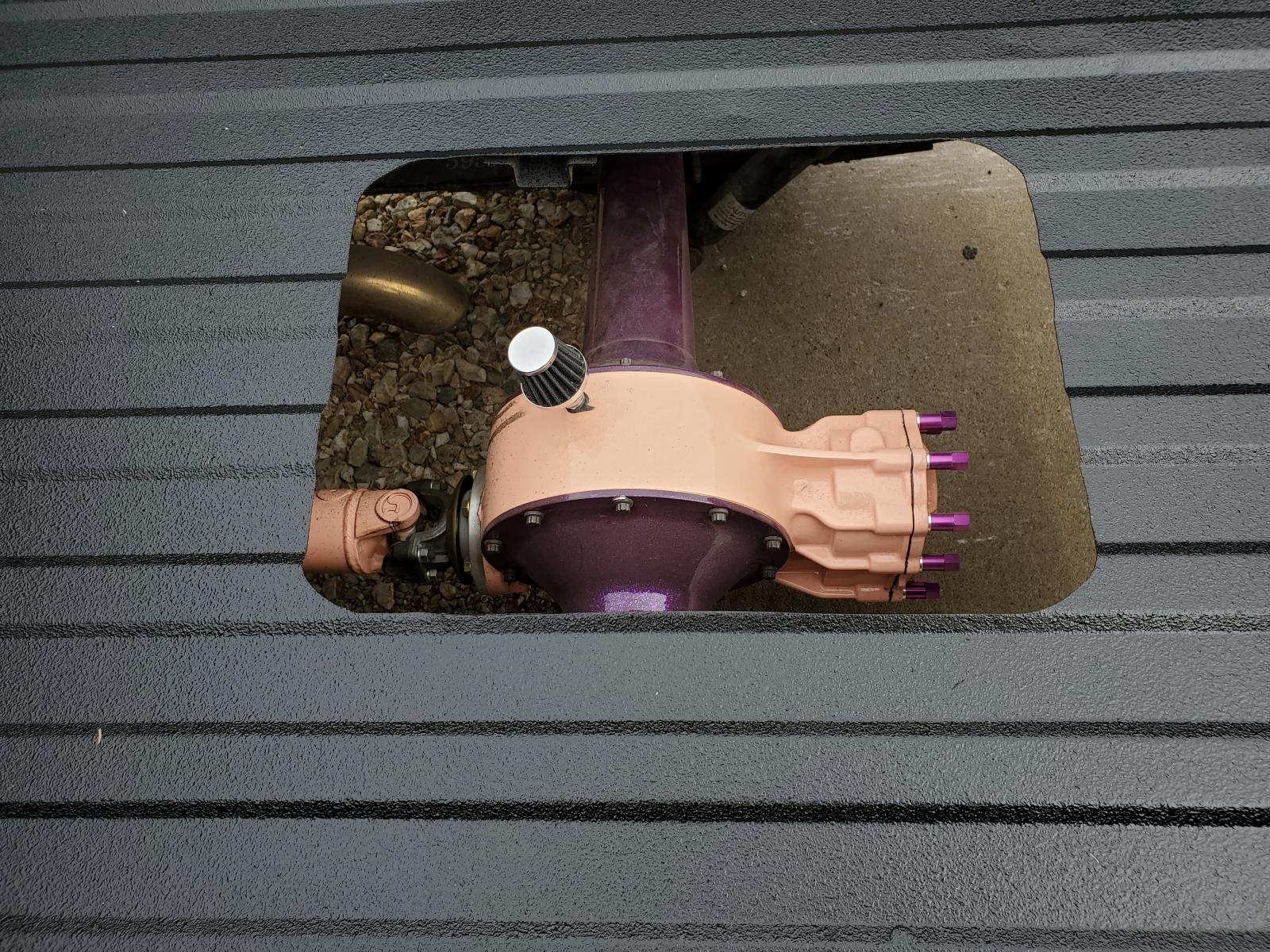

      I like the dare to be different concept, so a few phone calls and a brand new quick-change rear axle was being sent to me. I know of a red under construction extra-cab bodied full-size chevy truck with a similar axle, but I think I'm the only minitruck to have a quick change rear axle. I installed some 12 inch rotors on the rear, and am planning on doing the C6 corvette front calipers and rotors. I looked into brembo/baer/wilwood and they all just want to much for a seat of brakes. Now if I was a pro guy, I’d probably be sponsored, and well, cost wouldn’t matter, but, I'm an average joe, so I’ll use what I can get.
      The rear axle is painted body color, and a dark purple with purple metal flake. When it’s clean, not in this picture, it is a sparkle show!

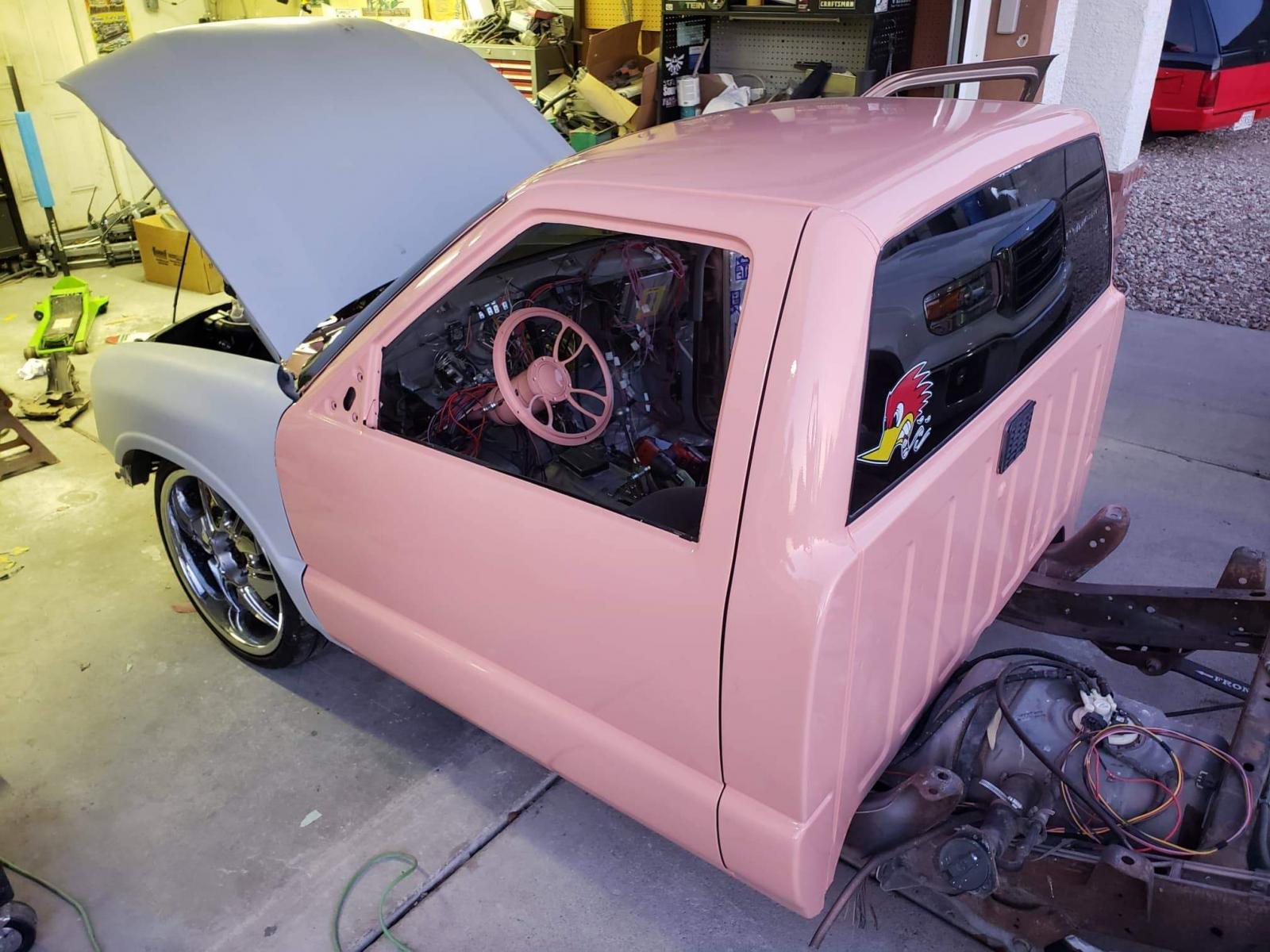

      With the truck all painted, I did a quick sand and buff on it, and called a local agency to get a girl to do a photoshoot. I was leaving in less than 2 weeks and wouldn’t see my truck for a year while I was in Iraq. Got everything lined up, and picked out a half dozen or so outfits for the girl, and went to one of my favorite spots for an auto photoshoot.
      I was a bit upset the girl didn’t show up at the correct time, and I had to deal with the sun coming up and got her squinting in many pictures. Things I can fix post shoot, but I really didn’t have the time to deal with it since time in usa was getting short for me.

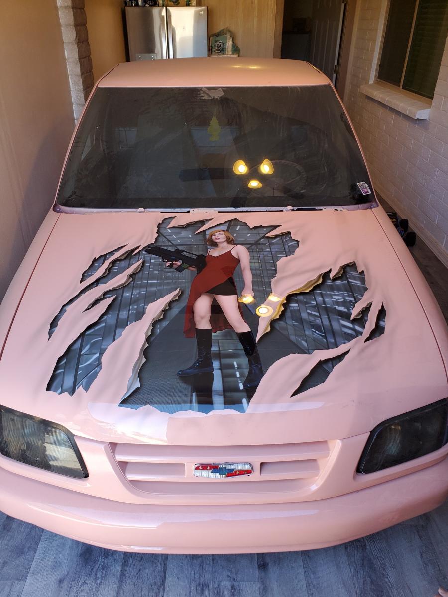

      Remember, the hood isn’t completed. There are still graphics, more colors, airbrush time, pin striping that still need to be done. So in this picture, it’s shiny and looks complete, but there is still 10-20 hours of labor still needed to be done before the hood artwork/paintjob is considered complete.

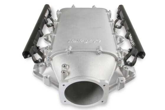

      These are the gauges I’ve picked, and the intake I’m going to use. I needed a super short intake, because the stock truck almost touches the hood, and once I do the body drop, it’ll never fit. I don’t like the look of the LS1 intake, so this is the next best thing.

      Alice was built to drive, not to sit..
