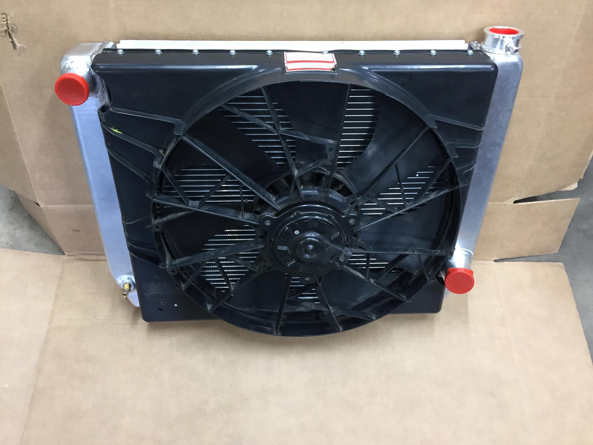

      Progress has been slow for a variety of reasons, but I have adapted a Lincoln/Taurus 2-speed radiator fan and shroud to the radiator. These fans flow a lot of air, even on low, and are relatively inexpensive in salvage yards.

      Quote Originally Posted by charliebob View Post
      Nice, but one point on those fans - they need a special controller that can flip between low and high speed. Otherwise they'll burn out quickly. Plenty of them for sale out there though, and the pricing isn't bad.
    19. #39
      Jan 2016
      Alabama
      72
      Quote Originally Posted by Vimes View Post
      Thanks Vimes. This is the third one I have done. Being a bottom feeder (pull-a-part), I use a 2-speed fan relay from a Volvo and a 2 level temp switch from either a BMW or Old Mercedes, all connected to a 75 amp continuous duty relay. So far, no problems going back over 5 years.
      I also use this wiring combo with a dual fan from a 2002 Windstar in an El Camino with LS engine.
      Some, maybe all, the Lincoln MK8s have variable speed fans, which do require a special controller. Variable and 2-speed fan motors look exactly the same and have the same 3-wire plug. Actually, the one shown is from a V8 T'Bird. You have to check the motor # to find out whether it is 2-speed or variable.
      Let me know if you would like part numbers for the Volvo relay, temp switches, or fans.
      Thanks for the warning about controllers.

      I wouldn't for myself, but it would be beneficial to others that want to follow. The last few efan conversions I've done have been in GM trucks using factory fans, and I used the ECM to control them. So far I've done two GMT800 trucks using a 2006-07 fan assembly, and one 1st gen Colorado using half a GMT800 fan assembly, but man is that one ugly.
