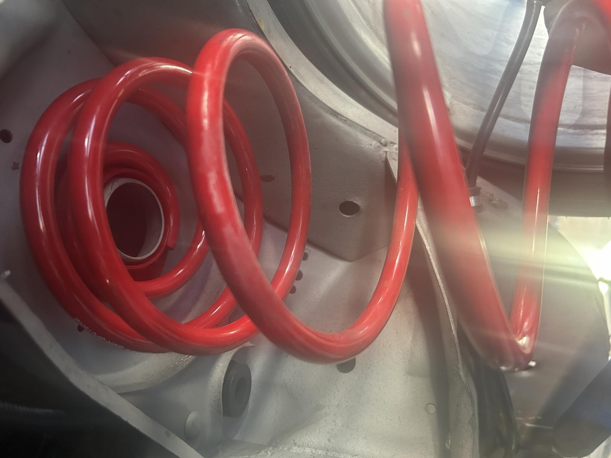

      Rear springs came today. BMR progressive rate springs (125lbs-200lbs). Got these as a scratch and dent item. Only issue i can see with them is in the pics below so I am more than happy. I think it saved me about 40$ USD compared to buying them new. I was originally going to go with UMI rear springs which are 130lbs (linear rate). So i figured these should ride like those when cruising and then when i get into corners (plan to do some cone course racing with this car and some very spirited street driving) they will end up being stiffer and perform better under load. I was playing around with them and putting my own weight on them the first inch is a plush and then they stiffen up real quick.
      Name:  BMR rear springs.jpg
      Name:  springs damage.jpg
