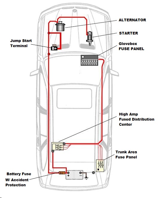

      A couple of thoughts-
      Why not use the cut-off on the negative terminal? No fuse needed- I realize some require pos side like NHRA- but the negative makes more sense on a street car.
      A fuse's job-to protect the wire- you rate the fuse for the size of the wire's current capacities. You want the fuse to blow before the wire melts.
      AND- the battery -if it shorts - the current keeps on going and going. The alternator shorts- a puff of smoke and it produces no more current.
      There are several article out there talking about "dirty" current- and how the electronics like to be powered by the battery- as it not only starts the car- but stabilizes the voltage and acts as a filter to the AC ripple not cleaned up by the alternator.
      I like how BMW does the wiring (and many new cars )- uses basically sub panels so to speak to distribute power to the locations you need it. I have done the same in my car's electrical layout.
      Notice how the high draw dirty stuff ( starter /alternator) are on one leg separately fused from the rest of the system.

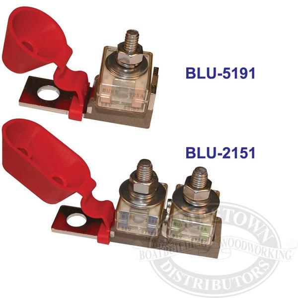

      Oh- these are the fuses I like-
      Marine Grade- Blue Sea
      https://www.bluesea.com/products/cat..._Type=Terminal

      Quote Originally Posted by anguilla1980 View Post
      Where should I put the fuses? Before or after the battery disconnect?
      As close to the battery as possible-for the main battery fuse.
      And any time down stream when you change to a smaller gauge wire should be another fuse.
