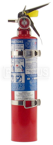

      I ordered a 5lb halon system (the RS). Two nozzles to the engine bay and one under the dash.
      I'm trying to decided on the standard pull activation or a push type deal. Going to mount the cable in dash where the cig-lighter use to be.
      Also bought a 2.5lb hand held halon bottle that I will build a bracket for. It will mount to the front of the passengers side seat.

      Good call on the 2.5lb handheld. That should be considered the bare minimum for all street driven vehicles in my opinion.
