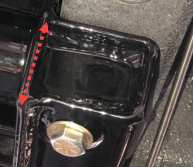

      Bump for an older thread. Trying to get a measurement to see if these would fit with the low profile Caltracs brackets. Some connectors interfere with the bolt from the front caltracs.
      Any help getting the measurement from front leaf spring bolt center to the lowest point of the tubing? Or just the tubing /flange dim would be really helpful.

      @Dlish, I just checked, the dimension is 1-1/2". I have to keep typing to get enough digits to post... sorry this was from Oct.
