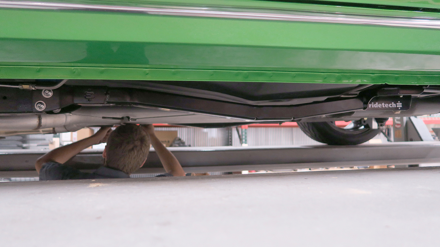

      good install pictures Joshy
      Haha, thanks sir! I hope you're doing well Rod .

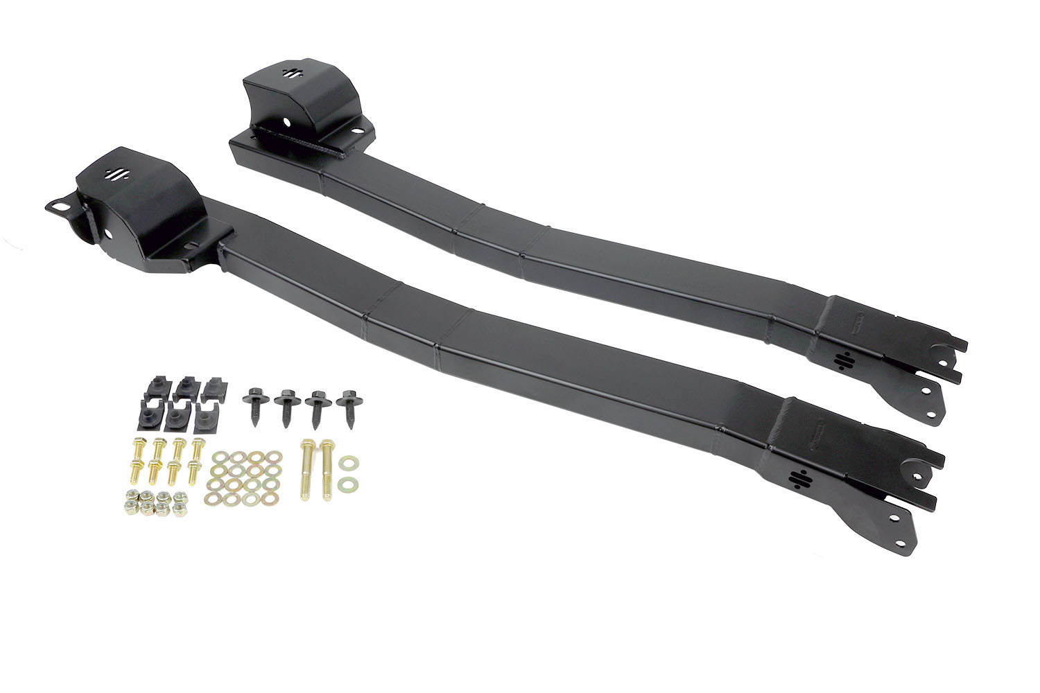

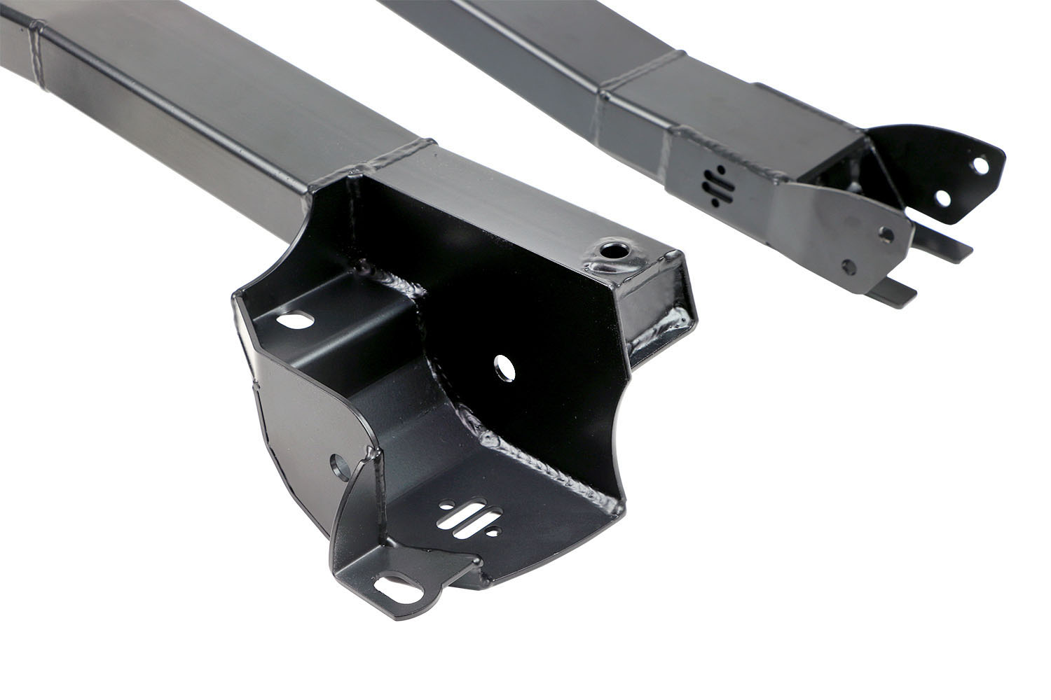

      Quote Originally Posted by Josh@ridetech View Post
      Hey everyone,
      We have been tossing around the idea of building some subframe connectors for quite some time and decided it was time to make it happen. We just finalized the design for the 1st gen F body (for coupe cars only) a couple of months ago and are now shipping them out the door! Instead of trying to find a way to make a set that works with the original leaf spring mounts, we designed a setup that has an integrated leaf spring mount for even more added strength (which is the coolest part about these in my mind). These are a super nice fitting piece that help eliminate the chassis flex that these uni-body cars have fought since day one.
      https://www.ridetech.com/product/cam...me-connectors/
      Key points:
      • Fabricated from 1.5 in. x 3 in. x .125 wall steel
      • Rear of the connector mounts solidly into three existing floor pan bolt locations for maximum strength and completely replaces the original leaf spring pocket
      • Front of the connector bolts through the original subframe and is captured by the body bushing as well to enhance rigidity
      • No fabrication, all bolt-in installation
      • Tightly fitting against the floor for ground clearance
      • Works with OE leaf springs, Ridetech Streetgrip leaf springs, and Ridetech 4-Link rear suspensions
      • Powdercoated satin black
      • Hardware included
      Attachment 179022
      Attachment 179023
      Attachment 179024
      Attachment 179025

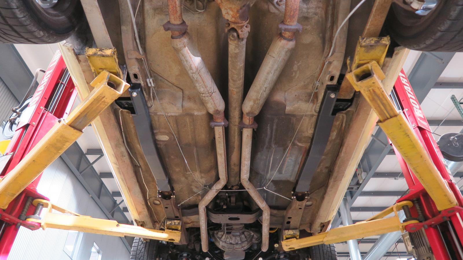

      Quote Originally Posted by hotrodgirl View Post
      REALLY, REALLY sad that I didn’t know these were coming. Now I have welded in DSE ones. Another cut the floor, weld, etc. thing that could have been avoided. If you guys come up with any more news things, let me know. I need to set up notifications for ridetech info...
      I'd say you're probably good with the DSE connectors. The front mount on these (and a lot of the bolt in options) doesn't seem to me to be that stout versus torsional forces in the body. Here's what I did with DSE SFC's. The ears are 1/4" steel, are welded to the subframe and engage the SFCs at two points with 1/2" hardware. I sleeved the SFC's so they wouldn't collapse under the clamping pressure of the hardware.
      Mike Kelcy - '68 Camaro with some stuff done to it.
    11. #31
      Feb 2013
      1,546
      Quote Originally Posted by 68conv455 View Post
      It's been 7 months since the last update on subframe connectors for 1st gen convertibles. Anything in process?
      Just got done with the R&D on them not too long ago, you should be seeing an update shortly!
      Quote Originally Posted by Mkelcy View Post
      With the connector being clamped on the sides and sandwiched between the body mount, they're extremely stout. You'd be surprised .

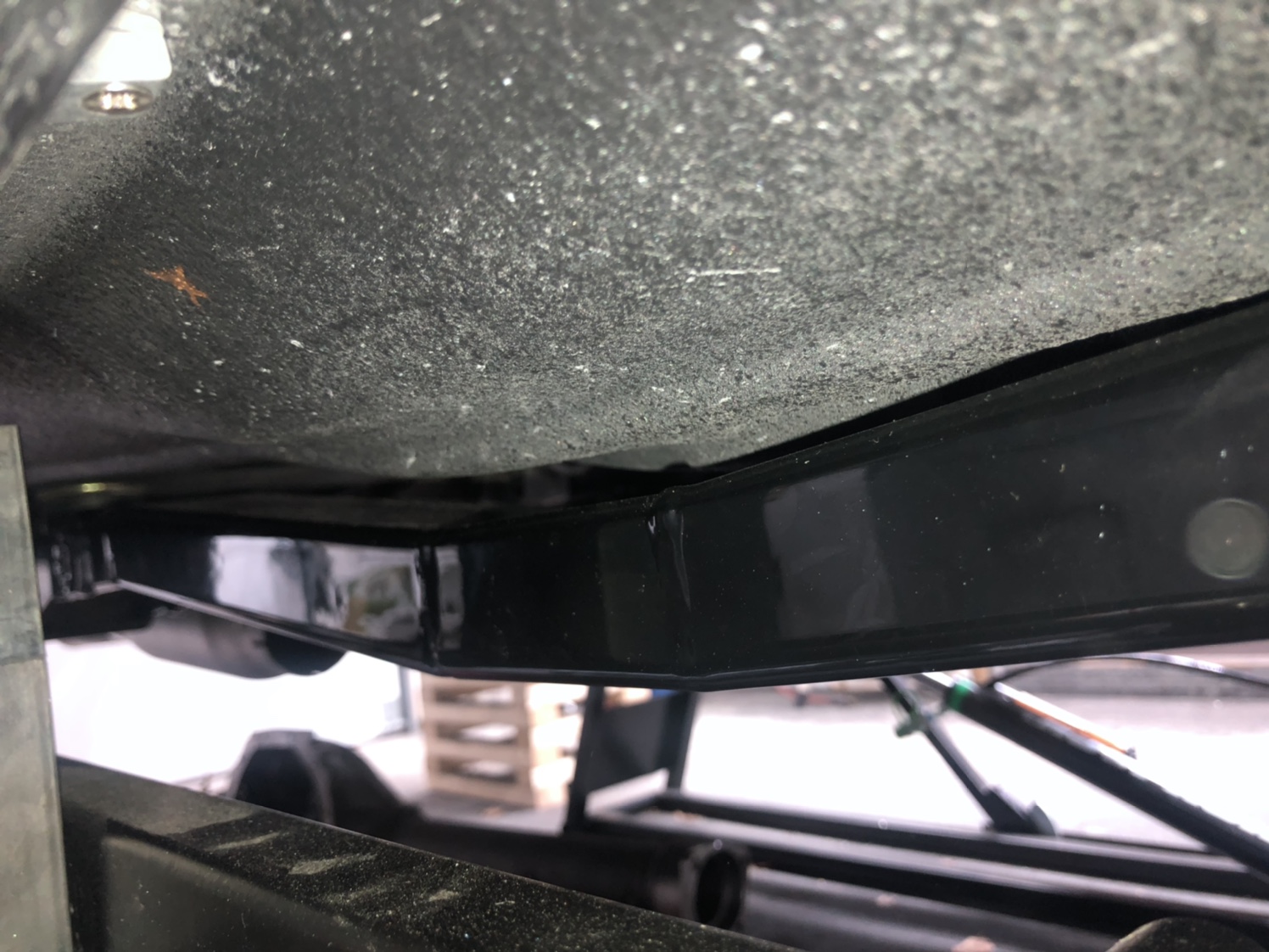

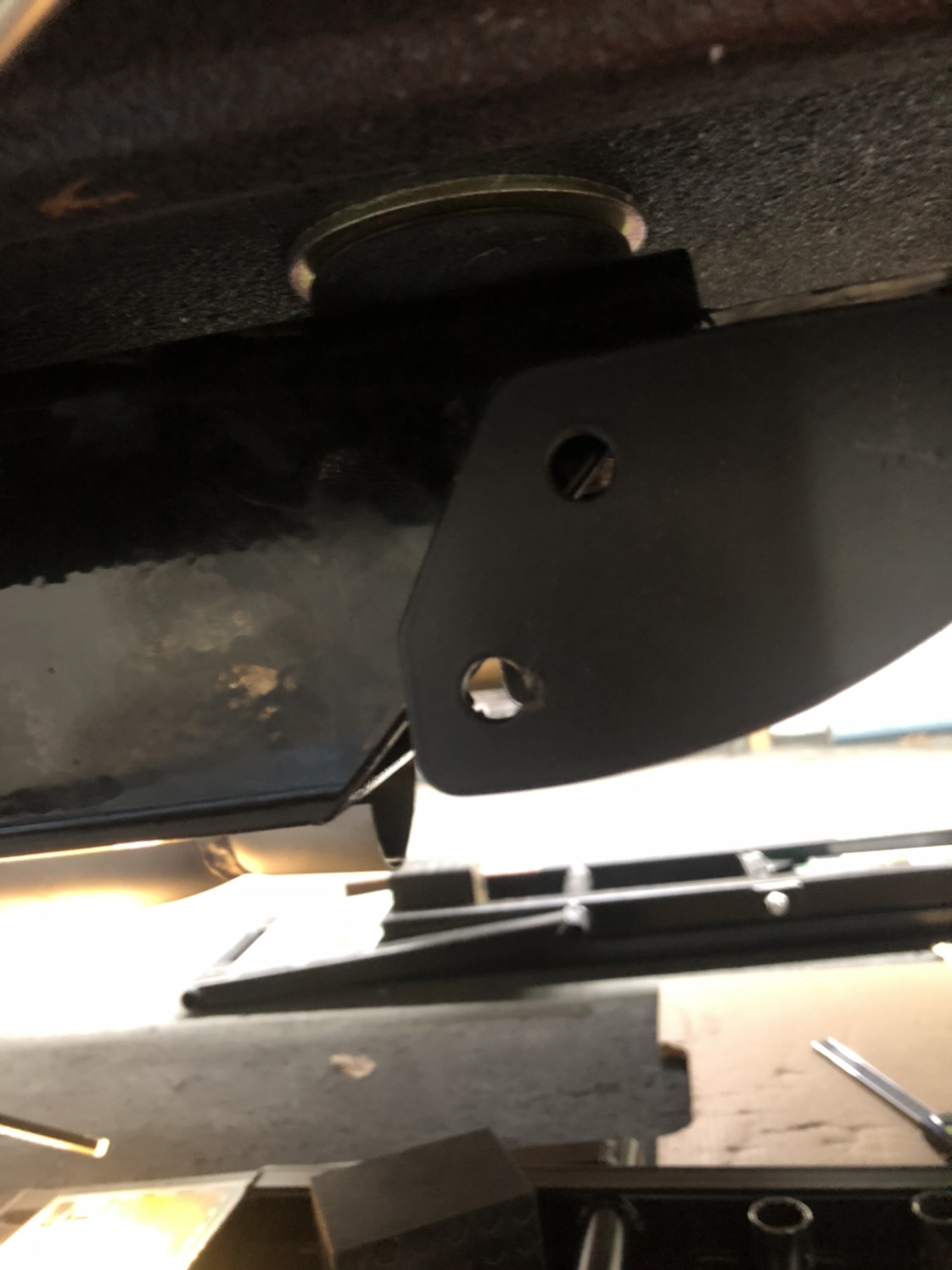

      I finished the drivers side sfc on my 69 camaro with speedtech protouring sub
      Back went in fine but the fronts barely reached into the subframe part due to the length of the speedtech frame is probably shorter than a stock one
      Im gonna have to fab up a plate to i can bolt it up
      And i had to trim the part that sandwhiches in the subframe
Size:  261.9 KBName:  IMG_7429.JPG

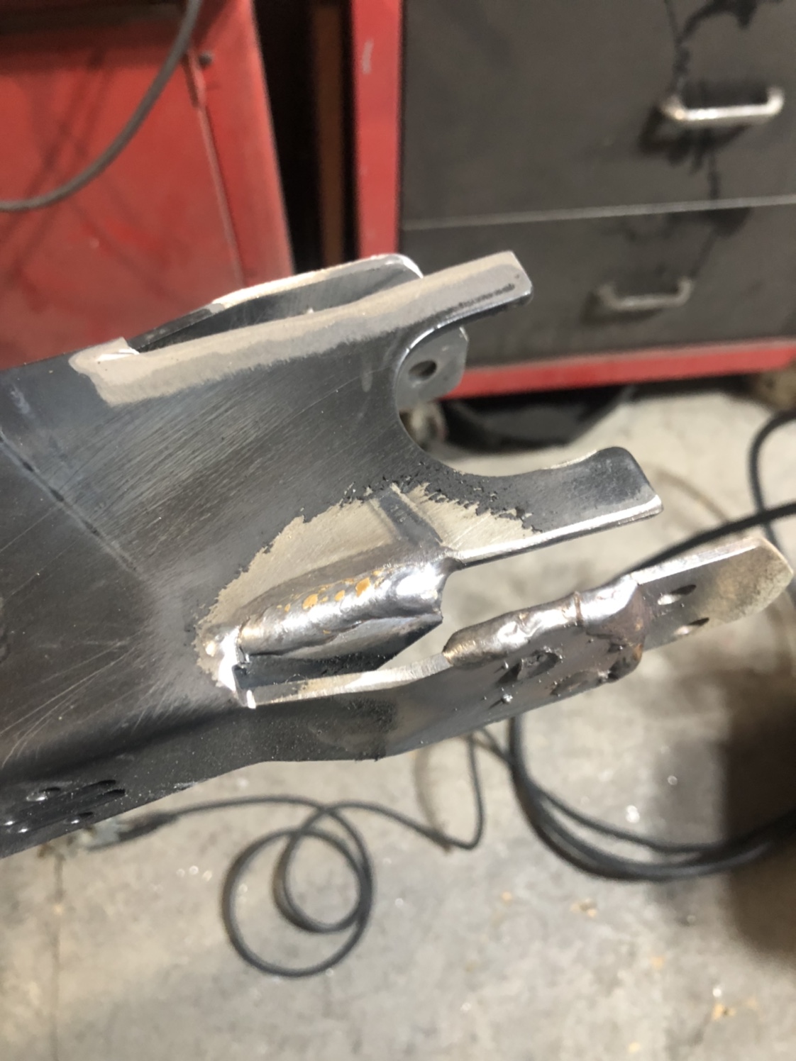

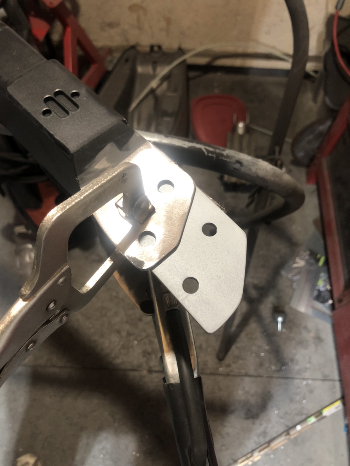

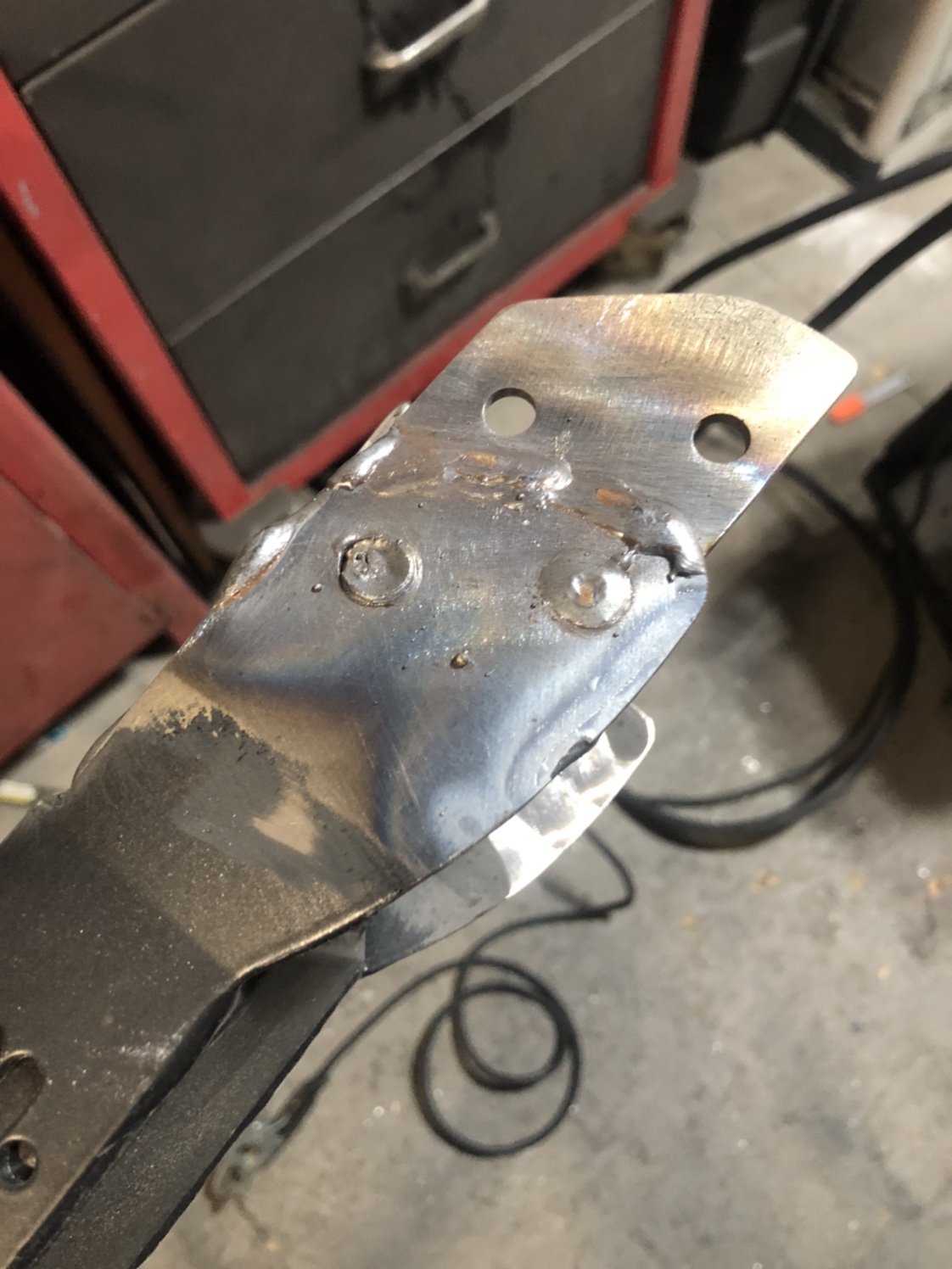

      Finally got around to making extensions and welding them on gonna take them to my friend to have them professionally powdercoated.
      After the blame game between ridetech and speedtech i decided to come up with my own solution
      Still need to clean up the welds
      But i feel the flex if the ends are eliminated
Size:  343.8 KBName:  IMG_7587.JPG
Size:  356.7 KBName:  IMG_7588.JPG

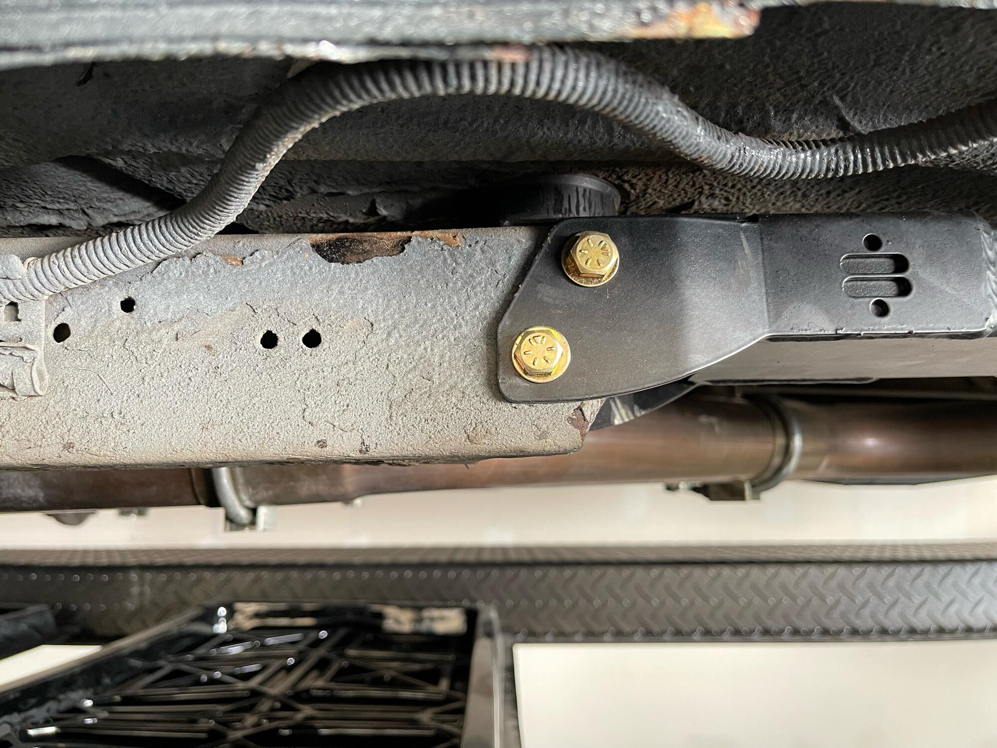

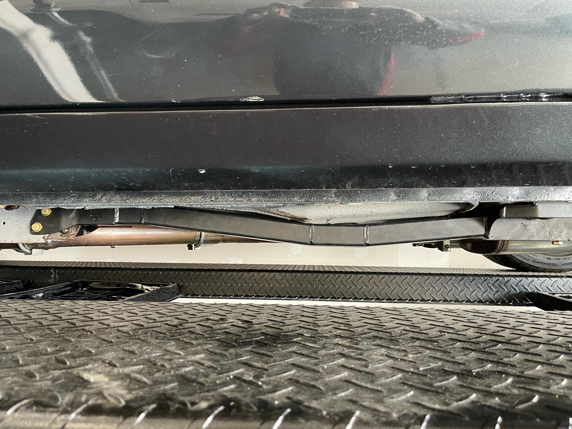

      I just had a set of these and ridetech's solid body mounts installed in my '69 Firebird. As you can see by the photos, my car still has the factory floors and a lot of "old carness" on it.
      The subframes fit well against the contours of the the factory floors and they've provided enough room to account for some sagging. The exhaust piping is still the lowest object at the breakover point of the car. My bird is low, the subframe at it's lowest point is 3.25" above the ground. The areas that I tend to have ground clearance issues are still the same areas and haven't changed with the addition of the subframes. I typically have issues at the X pipe connection, the header flange and the below floor mufflers.
      Granted, I removed some really bad original body mounts and had two of the subframe mounts repaired, but the ridetech bushings have actually decreased the NVH in the car. The addition of both of those items as well as the subframe connectors gives a nice "put together" feel. Having had SN chassis mustangs with the addition of subframe connectors, you would really notice a lack of flex in those cars with the change. I can't say that I notice this same thing with the addition hear, but instead the car feels like it's now forcing the suspension to do the work instead of the body doing the work. I would kind of describe it as the ability to feel what is happening up front, differentiated by what is happening in the rear. Before, I kind of felt everything through the car as a whole.
      For context, the car is a partial restoration (body and paint with newish drivetrain). Aluminum headed Pontiac engine with a th400, moser 12 bolt. Suspension is SPC front with Hotchkis BB springs and hotchkis 3" drop leafs in the rear.
      It weighs 3402 with 3/4 tank of fuel, so a pretty standard survivor type car. I'm not certain that going from a very well sorted car with new or newish body mounts and these subframes would create as dramatic of a difference, but for the guys freshening up a budget F-body, I'd say this is money well spent.

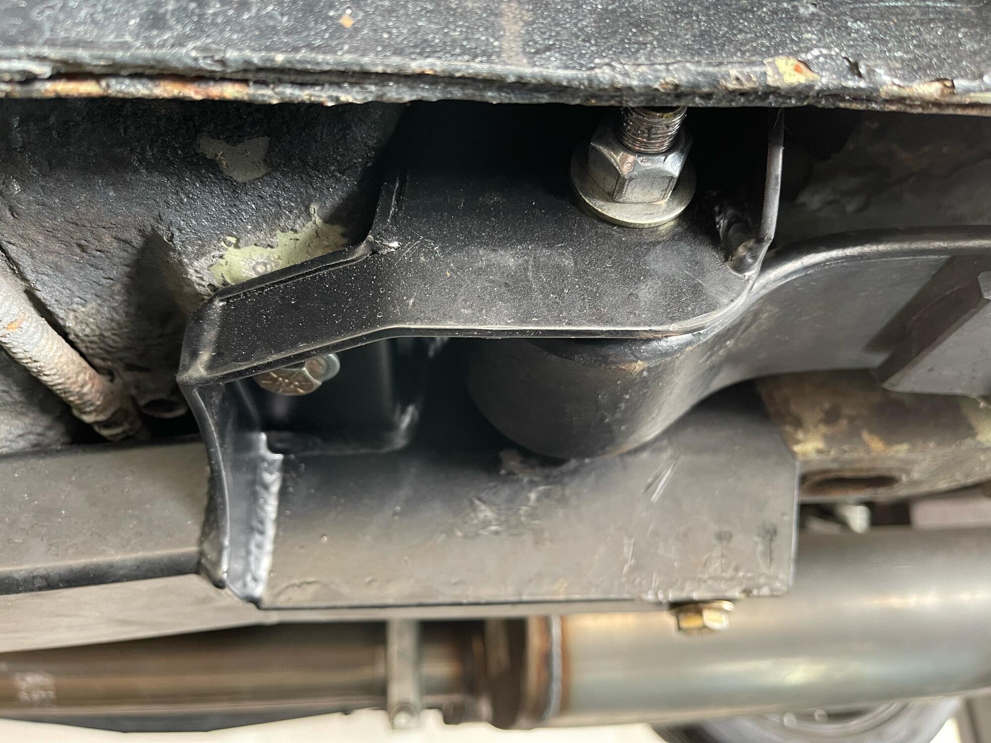

      They are finally up after having them repowdercoated after welding extensions on
      The long bolt hole is a little off. The sleeve is at a slight angle and wont go into the spring clip
      Si i reamed it out with a slightly larger bit so now it has just enough play to get into the clip
      I still need to drill the 4 holes but that has to wait until the new rear is in and on all 4’s
