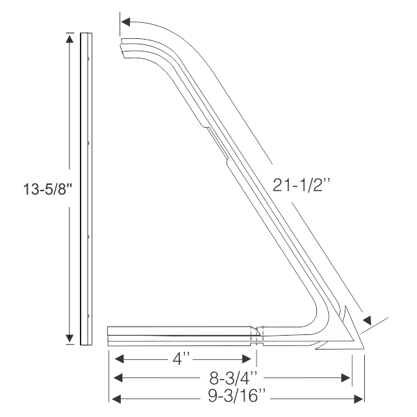

      I have an unusual Pro-Touring build, a 1974 Mazda REPU (Rotary Engine Pick-Up). But my issue lies with the fact that the Mazda REPU/ B1600/B1800/B2000 and Ford Courier, from 1972-1983 are totally underserved with regard to the availability of Sealing Rubber; ie, door seals, window seals, VENT window seals, etc.
      There is one company that makes the door, window and f/r windshield seals, but the VENT window seal is nonexistent and parts are long since discontinued. Since they are not available, I'm trying to find a vehicle with a vent window that is as close to the REPU/B-Series/Courier as possible to modify to make work.
      I am needing help from anyone willing, to measure the vent window on your car and post up the measurements similar to the one in the picture. The more accurate, the better.
      All help on this is GREATLY APPRECIATED.
      Thanks everyone for reading or helping.
      -Mr. SmithName:  c591604eb008c77791fa7b755cff.jpg

      Vimes, thank you. I had looked at Steele, but I must have missed the Courier catalog. I'm awaiting catalogs from them. Thanks for the help. If anyone else has a line on anything else that might help, I'll gladly take it.
      I have reached out to SoffSeal to no avail, so anything but them.
      -Mr.Smith

      I received the catalogs about a month ago. The Courier catalog was a staggering 1 page, which consisted of flat rubber for "trim edge".
      So, I'm still at the same point of attempting to recondition an old part as much as possible, as I haven't been able to find measurements on any other seals.
      At this point ANYTHING more than what I have will be a starting point.
      If anyone has measurements, of any kind, I'll gladly take them.
      Thanks again.
