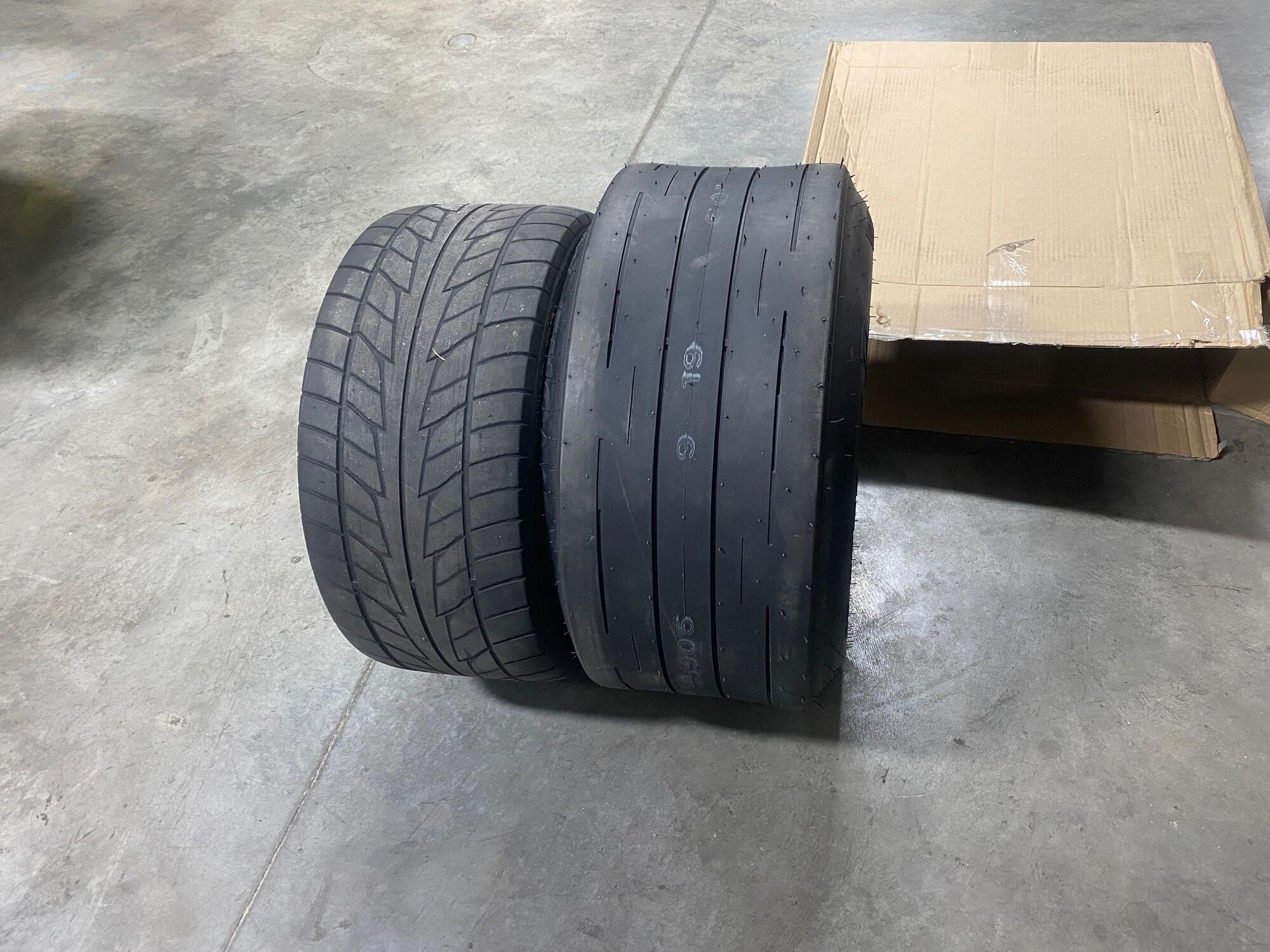

      As for the wheels...
      They are ultra light, billet 6061 & due to the manual trans, I chose a bias ply rear tire.
      They are MT ET Street R bias in a 28x12.50-15 rear & MT 26x6-17 in the front.
      The ABS does not have any issues either.
      Here is a picture next to a 275/40-17.
