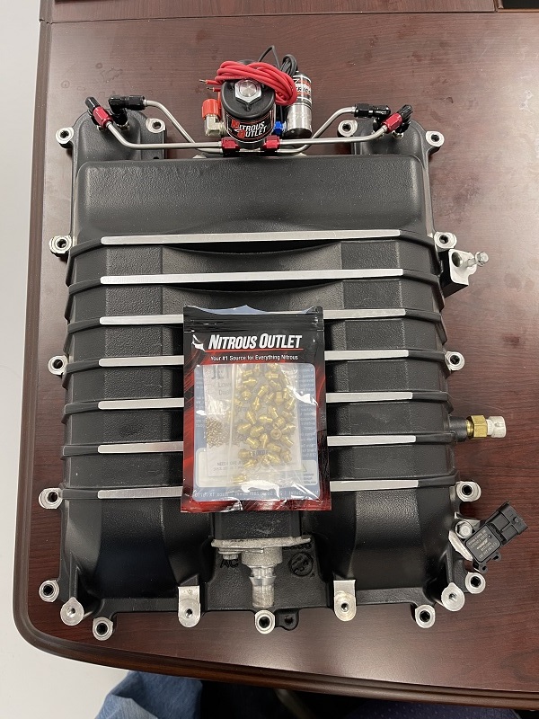

      The performance is good as well as the mileage, but I cannot leave well enough alone.

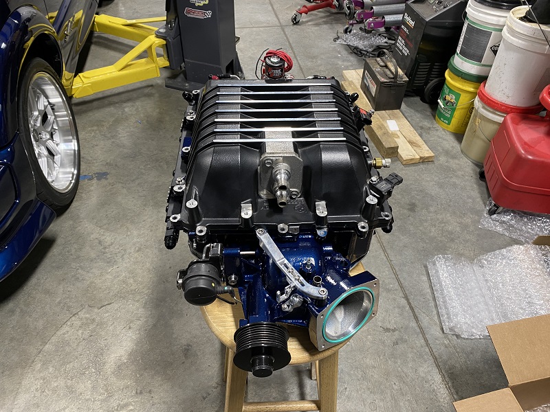

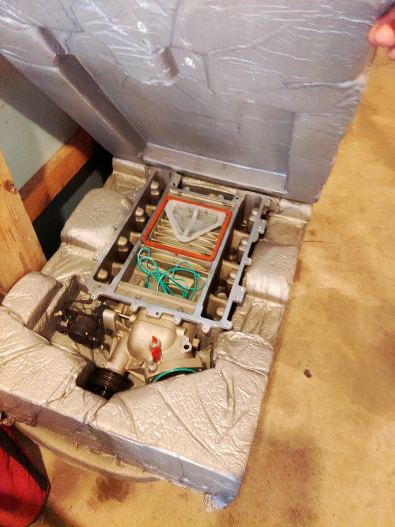

      I found an LSA supercharger so why not try to add another 200hp.
      It is proving to be rather crowded getting everything to fit under the hood.
      Saty tuned for more updates on engine mods, fuel system updates & overall fitment issues.

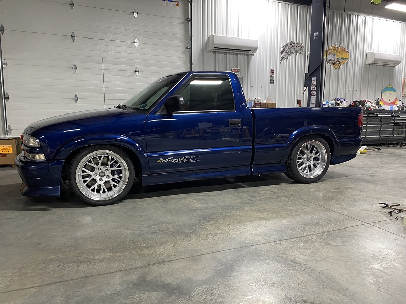

      Quote Originally Posted by Lonnies Performance View Post
      It took a lot of fitting to get a tire with 12.4" section width under the front.
      The 2" drop spindles allowed me to run a 1" tall ball joint for better camber gain, but still clear a wheel with over 6 backspace.
      Blazer unit bearings open up wheel choices as there is no longer a hub/dust cover protruding through the wheel.
      I also had to machine custom spacers to get the offset where it would work, even though the brakes complicated things a lot...
      Getting a wheel with a nice lip that had almost 2" of caliper clearance plus over 6" backspace was tough to find for a reasonable price.
      I would like more backspace at this point, but I only have .100" caliper to wheel clearance & was not inclined to buy a $5000 set of custom wheels.

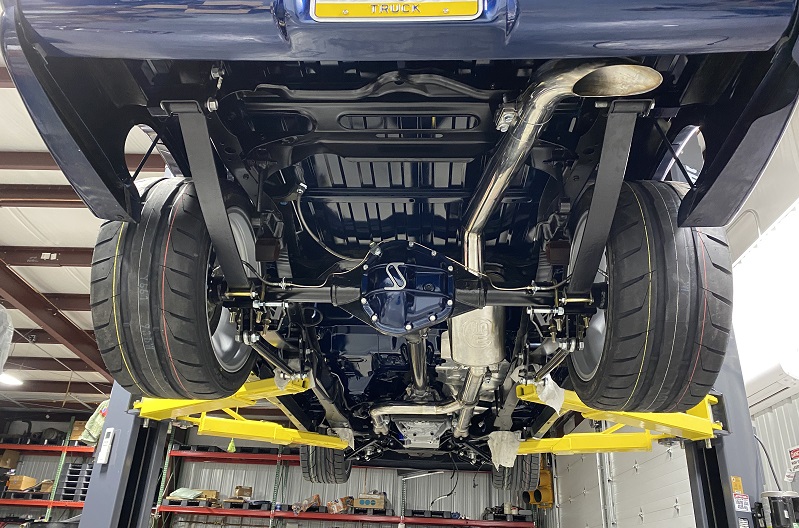

      Currently fitting a battery box under the rear of the truck to gain room for an air box under the hood. Also moving 40lb to the rear helps an already front heavy vehicle.
      I also got my exhaust finished.... dual 3" into a single 3.5" to the rear, all hidden behind the frame so none is visible from the side or rear.

      It took a lot of mods to fit everything.

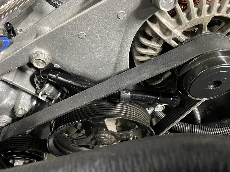

      The coils had to be lowered to clear the fuel rails, but it then put them closer to the heater box, where room was non-existent.

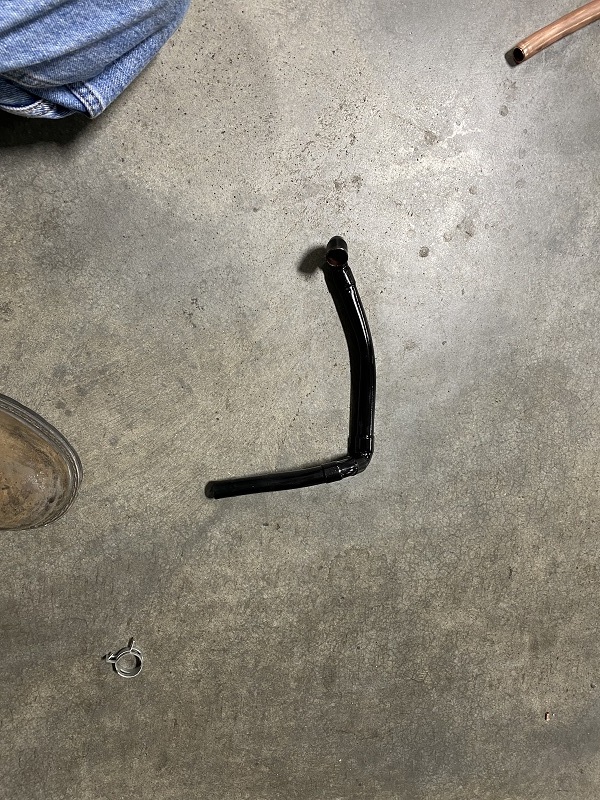

      The reservoir for the PS had to be moved & a custom tube made to reroute the fluid return.
      It clears the pulley/belt by about 3/16"

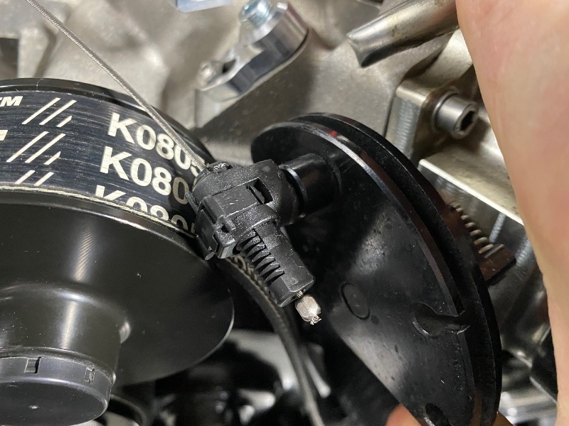

      Because of the cable throttle body, there were some fitment issues here also.

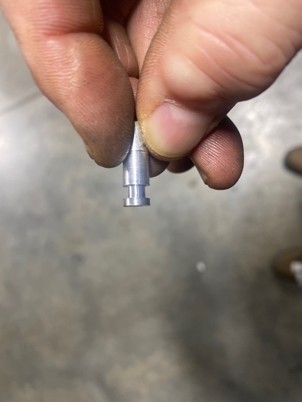

      After making a new cable pin, it clears.

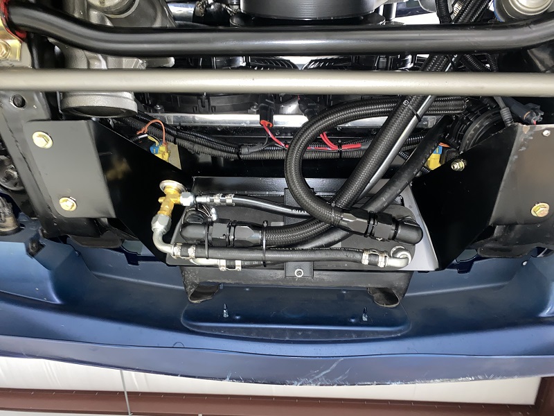

      The intercooler was another issue as the radiator is now inside the rad support to clear the engine & the AC condenser is in front against the grille.

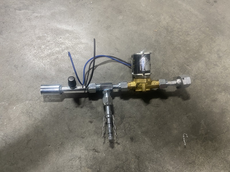

      This made me look into a refrigerated intercooler similar to that on the Dodge Demons.
      What made it more interesting was the truck has metric AC lines & the aftermarket parts are US dimensions, making adapter fittings unavailable.
      I chose to install an isolation valve to turn off the cab AC for max cooling during race use.
      Here is the heat exchanger located under the front bumper.
      It cools very well & I can get 40 deg air temps entering the engine on a 70 degree day.
      The water contains glycol to keep it from freezing.
      The unexpected benefit is the cool air temps condense the mixture & reduce the boost level.
      Boost dropped over 2lb while increasing HP... a good excuse to add a 22% overdrive lower pulley.

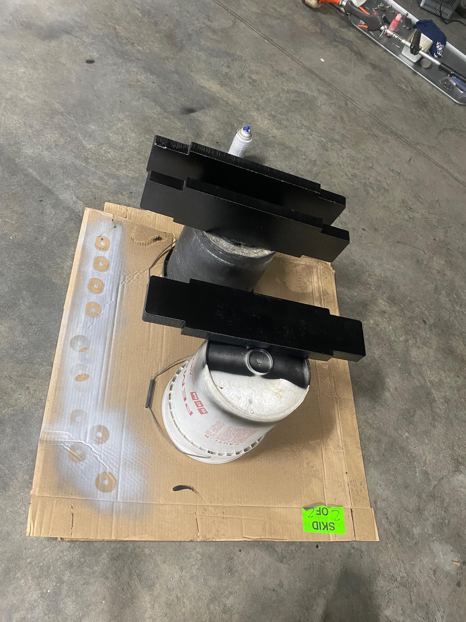

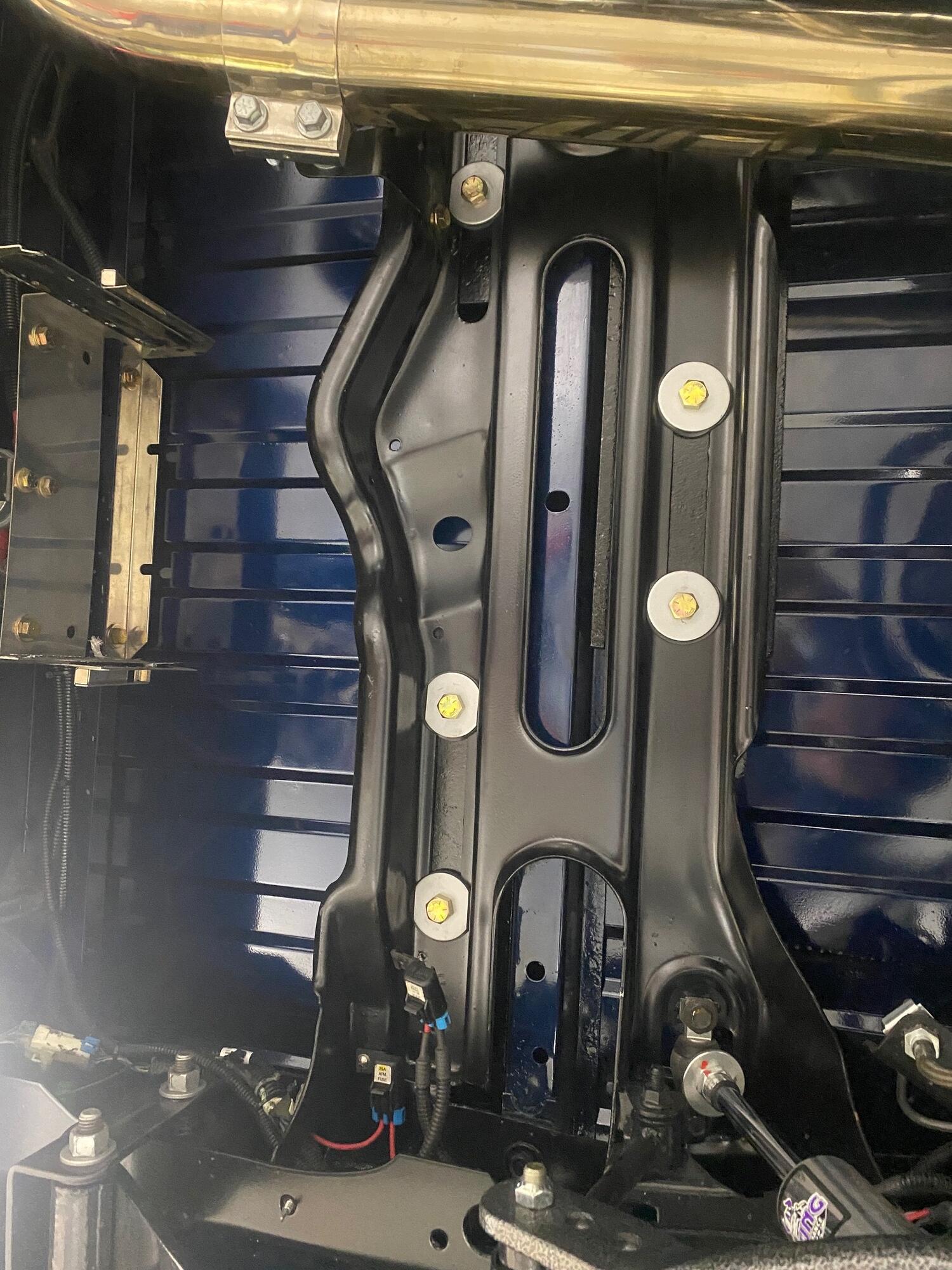

      I was still suffering with the rear axle being too light.
      I did some testing & adding weight at the rear helped both straight line traction & cornering.
      I got some elevator weights from a friend & installed them in the crossmember over the rear axle.
      This made a world of difference, taking a second off of my 0-60 times.

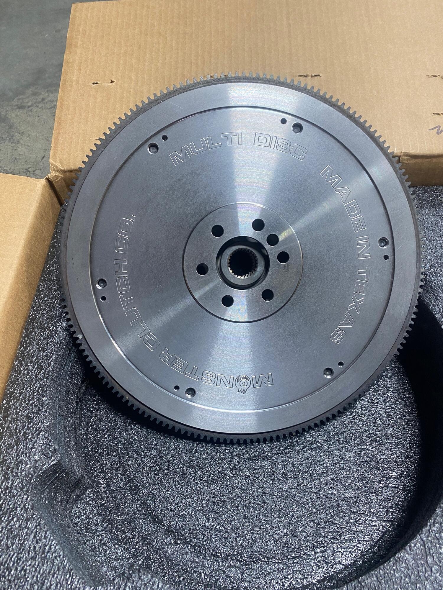

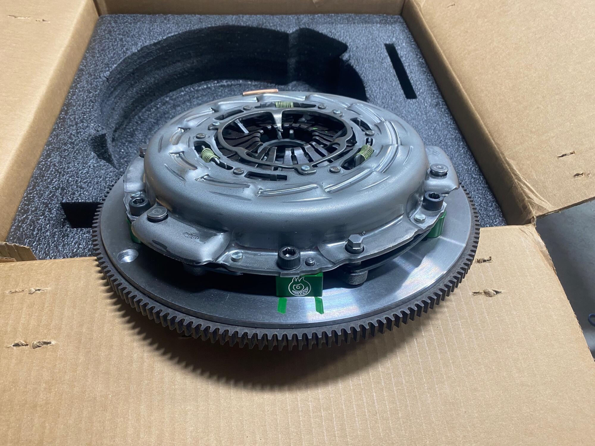

      Unfortunately, now that I found more traction, I found the limitations of the clutch when I put a set of slicks under it.
      You can hardly tell they are on the truck.
      Next was a Monster twin disc which I installed late last fall.

      I too need a PS tube like this. What did you use to make it? Thanks

      That is household 1/2" flexible copper pipe.
      It's easy to bend & solder.

      Hmmmm. I'd be concerned with the vibration it will cause the solder joints to crack & leak.....?
