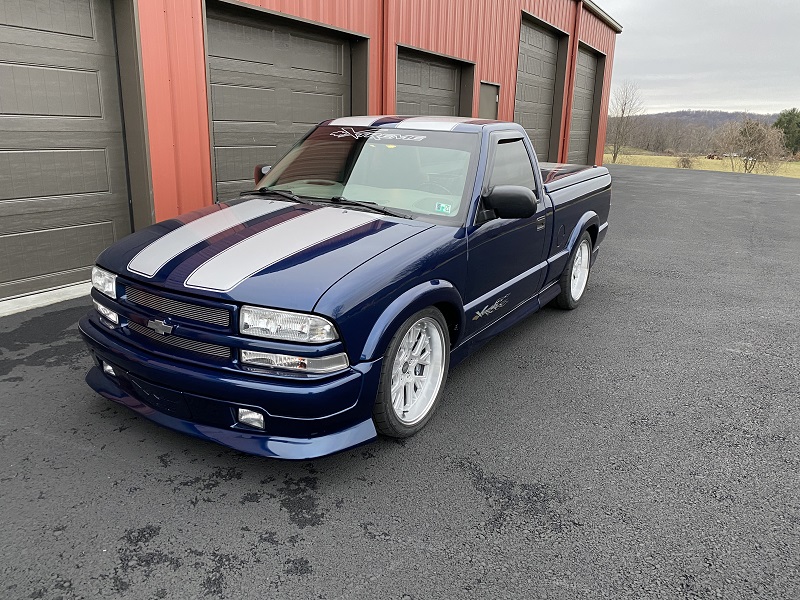

      Still cleaning it up under the hood by relocating some wires etc.
      I got to drive it for 1 day in late November, just before the weather turned bad.
      It rides, handles & stops excellent. Traction with the NT05's were better than I expected & actually stick in 1st gear if you are careful.

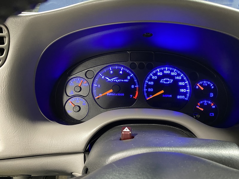

      It goes over 100 in 3rd gear, so I just finished this modified cluster in order to have usable speedometer & a tach with enough range.

      I used a Lingenfelter box to convert the 58x to the 24x. It worked well & allowed me to keep a cable throttle.
      I hate drive by wire, the lag & the unnecessary complexity.
      I'm using the stock 411 computer with a V8 segment swap.
      As for the custom cluster, I built it. I've been working on perfecting this for a while.
      I ran into an issue using a factory 4 cyl 7K tach as the tune would not allow me to get the scaling correct.
      I'm trying to source more of the air core motors with the correct specs to build more.
      I could not find a speedometer place that was willing to work with me so I figured it out on my own.
      I invested a lot of time & money in this, not sure I could afford to sell one for $600.
