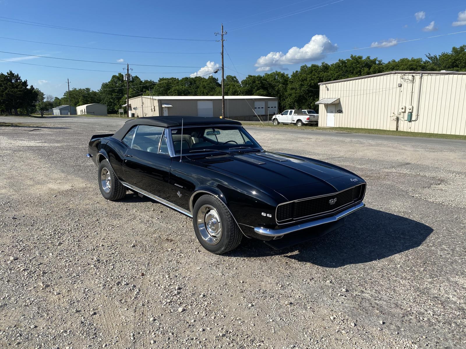

      The car as it stands today:
      67 True RS/SS Camaro Convertible (Black w/ White Interior)
      Built 350 paired with a Tremec 5 speed | MSD Ignition | Edelbrock Avis2 Carb | Longtube headers etc
      Subframe connectors/ Sway bar
      Interior is pretty clean and everything works!
