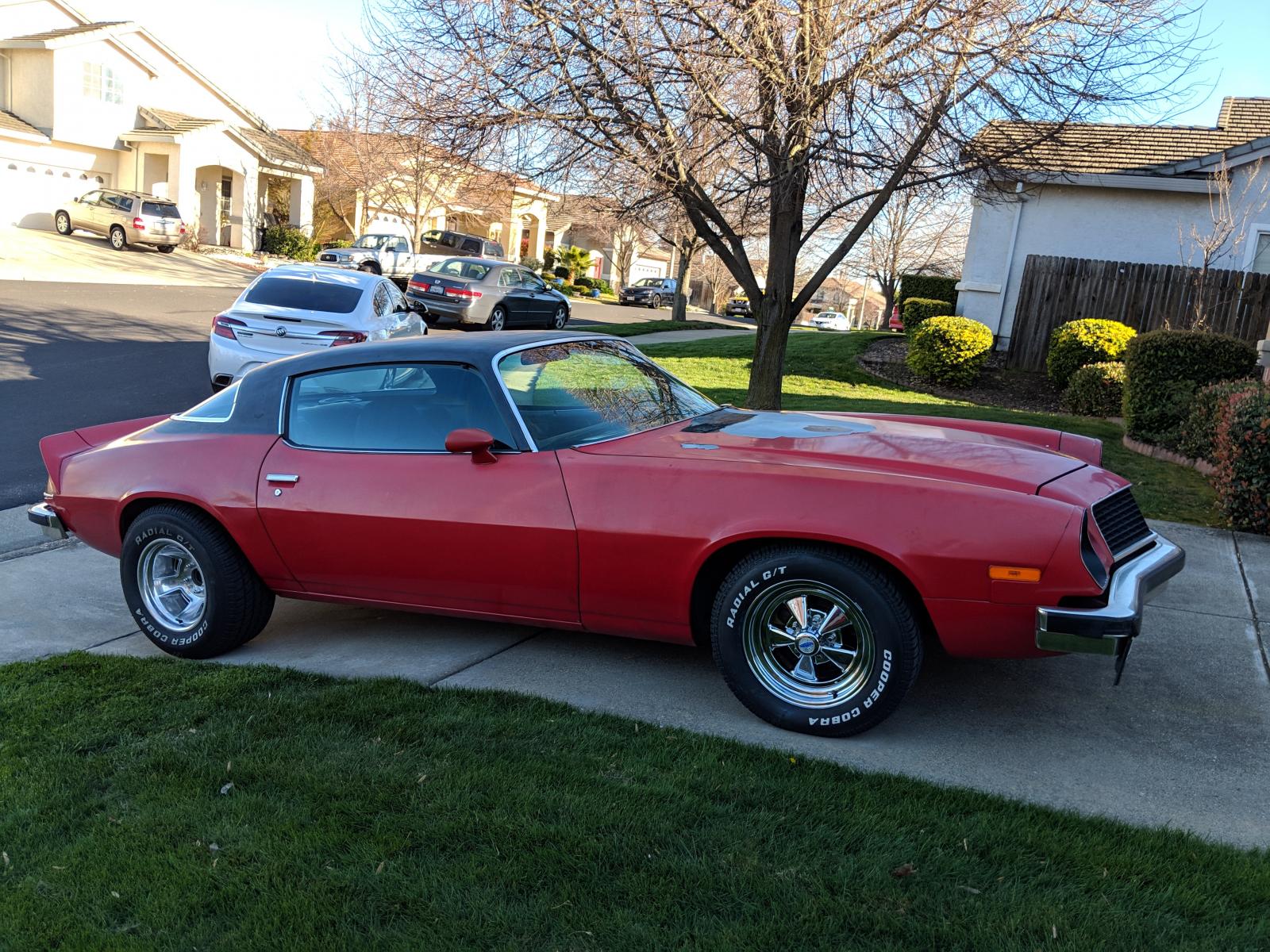

      I've posted on this forum for a few months asking some general suspension questions and I feel as though it's a good time to show others here what I've been working on.
      In October of 2018 I bought a 1975 Camaro in the hopes of making a near perfect replica of bumblebee from the transformers movie. And I plan on sticking to that for the most part....but plans changed and so did my goals.
      So I'm staying true to the cosmetics of my car while also making this car capable of autocross. This in turn has caused me to make some questionable decisions that hurt the capabilities of my car....but I will march ahead haters be damned.

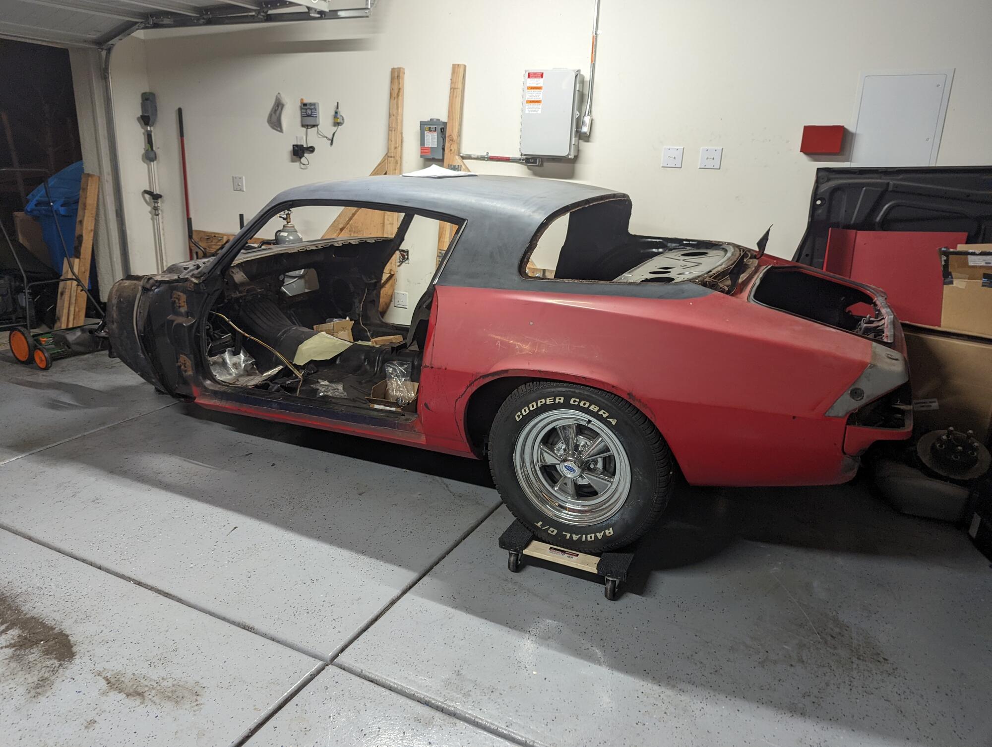

      Thats what my car looked like before I gutted it (and about a year of owning it) Was in alright shape, rust around the rear window, terrible rattle can red. Other than that, it was pretty solid. I intended on enjoying the car and slowly making it better, but the engine started to have problems and I didn't want to dump money into something I knew I was going to get rid of.
      So at the start of the year, I tore it apart, tagged and bagged everything, and now the car sits on it's side ready for the next steps in the process

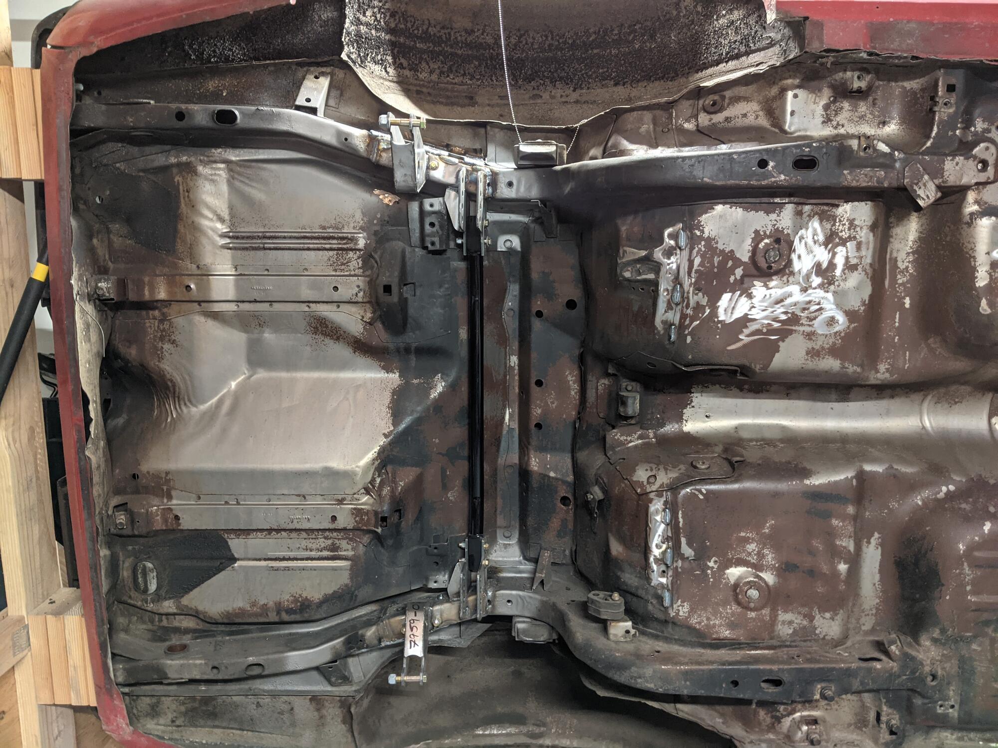

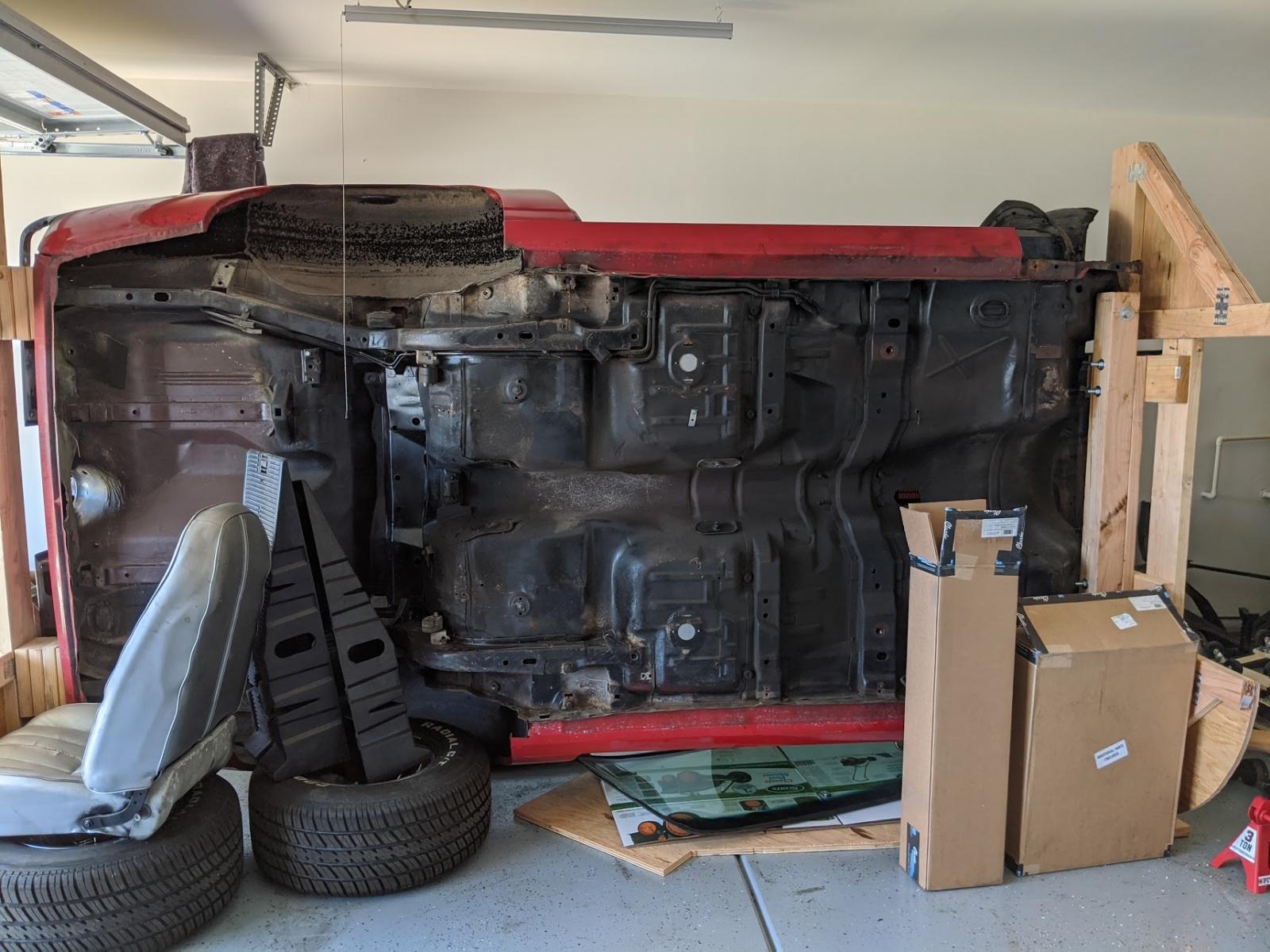

      Anyways, none of that is particularly special, what makes this stupid is that I'm putting in a gen V lt4 into the car with 4l75e, ford 9" and torque arm. Along with global west front suspension and proper coilover modifications to the front subframe. The biggest challenge I have faced is getting good brakes on 15" rims with how much power I'm putting in the car. And good solutions for making the tires rub in the rear because the offset on the rim is dumb.
      As of posting this, the car is on it's side as shown, I'm going to strip off the undercoating, weld on the torque arm suspension points, spray SPI epoxy, upol bedliner, and then go from there.
      I have an entire spreadsheet detailing out my plans and what I'm going to buy along with supplies, listed below is also a flow chart on the order I plan on accomplishing everything. You can view it by clicking here

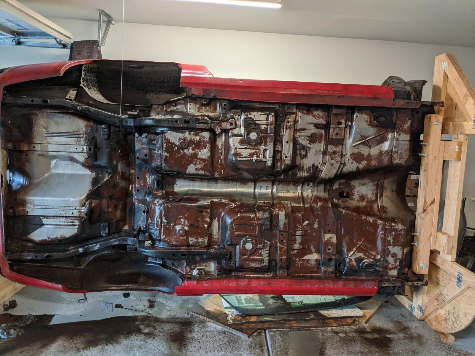

      I started to clean the car with easy off so I didn't gum up my grinding discs.
      Oven cleaner is magic, it ate through a good portion of the undercoating of the car and went to bare metal which was fantastic. I'm obviously not done, but here's what it looks like after just some light scrubbing with a dish sponge, nothing crazy.

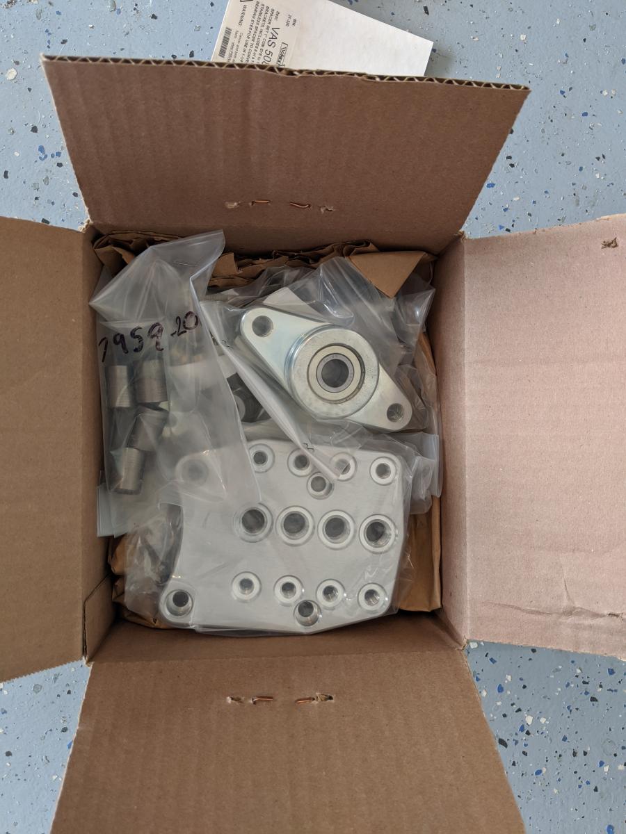

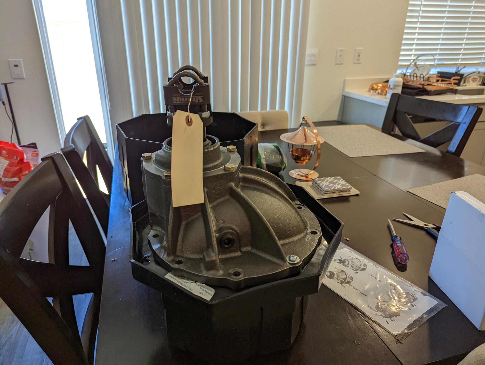

      Not much has been happening since it's too dang hot to paint the epoxy, and I have been waiting on my torque arm to be finished (If I knew it was going to take 3 months I would have ordered sooner)

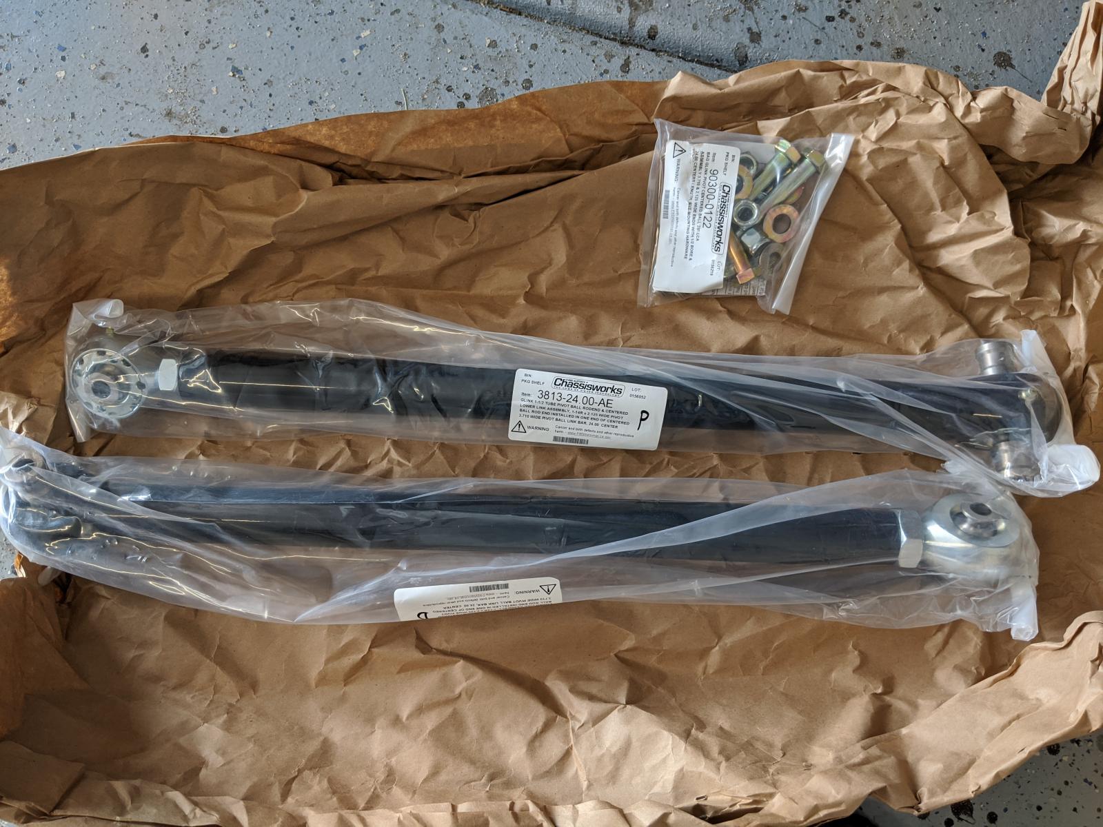

      Anyways, here it is in boxes, I'm not going to take them out yet because I need to move all the things in my garage for the solar inspection so they can turn my system on.
      Someone tried to get me a good deal on a torque arm, was very close to going with speedtech but the chassisworks option ended up just being much better overall I think
      This unit costs more than I actually paid for the car itself, so there is no going back now......
      For those interested, I got the following options
      splined antiroll bar
      viking double adjustable shocks (not sure what spring rate I'll get yet, maybe 225)
      Watts Link
      Everything else you select just asks what type of rear end you plan on using

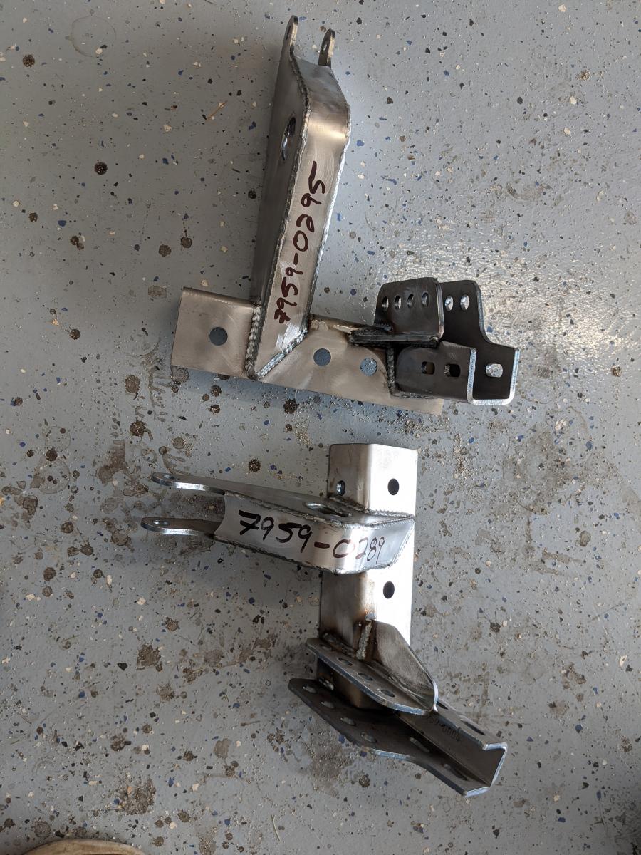

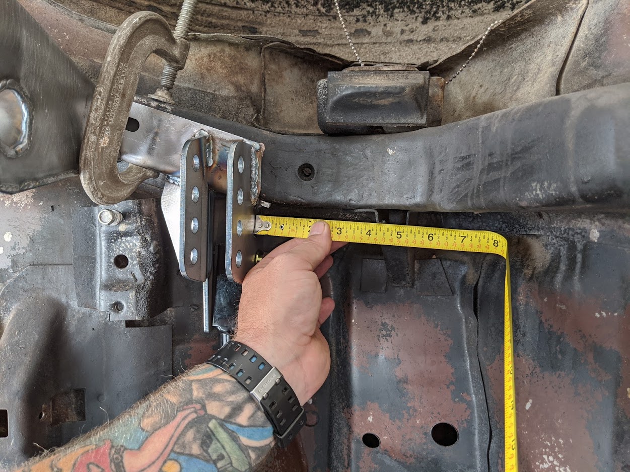

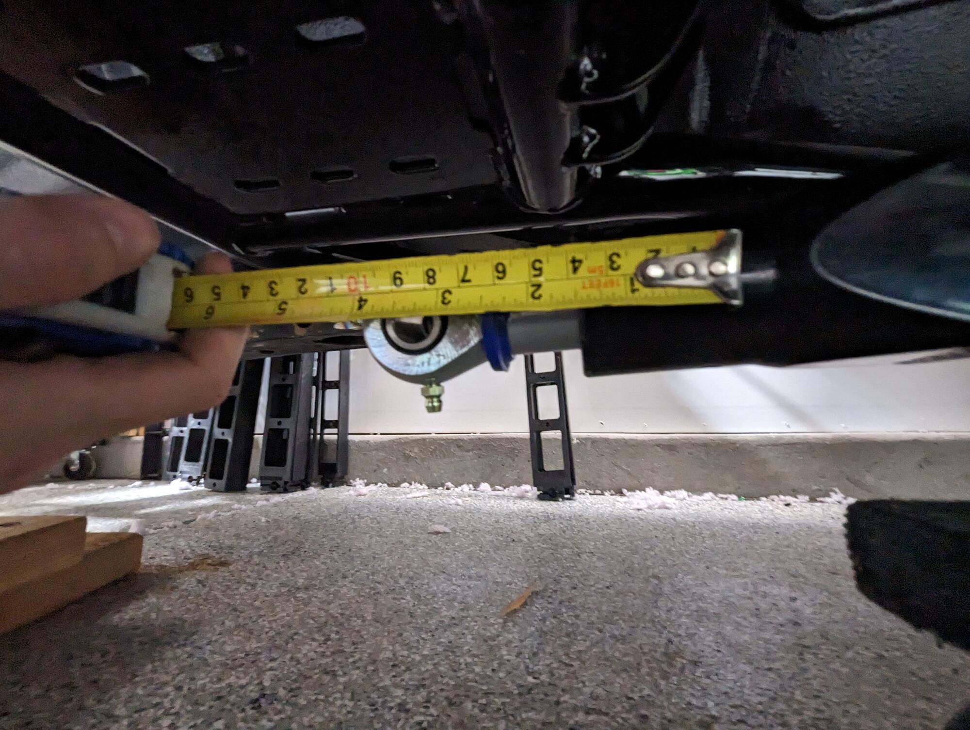

      Anyways, I attempted to install the rear suspension in my car this weekend and came to a hault really quick. The instructions say I need to be 4.5" away from where the measurement is. As you can see I have 8" and there is no way it can be closer....so I'm pretty sure the instructions are completely wrong.
      I have been trying to contact Chassisworks, but everyone I have gotten on the phone has not been helpful at all. and it's really disappointing being how this cost more than 4k and there is no help what so ever
Size:  313.6 KBName:  IMG_20200919_141910.jpg

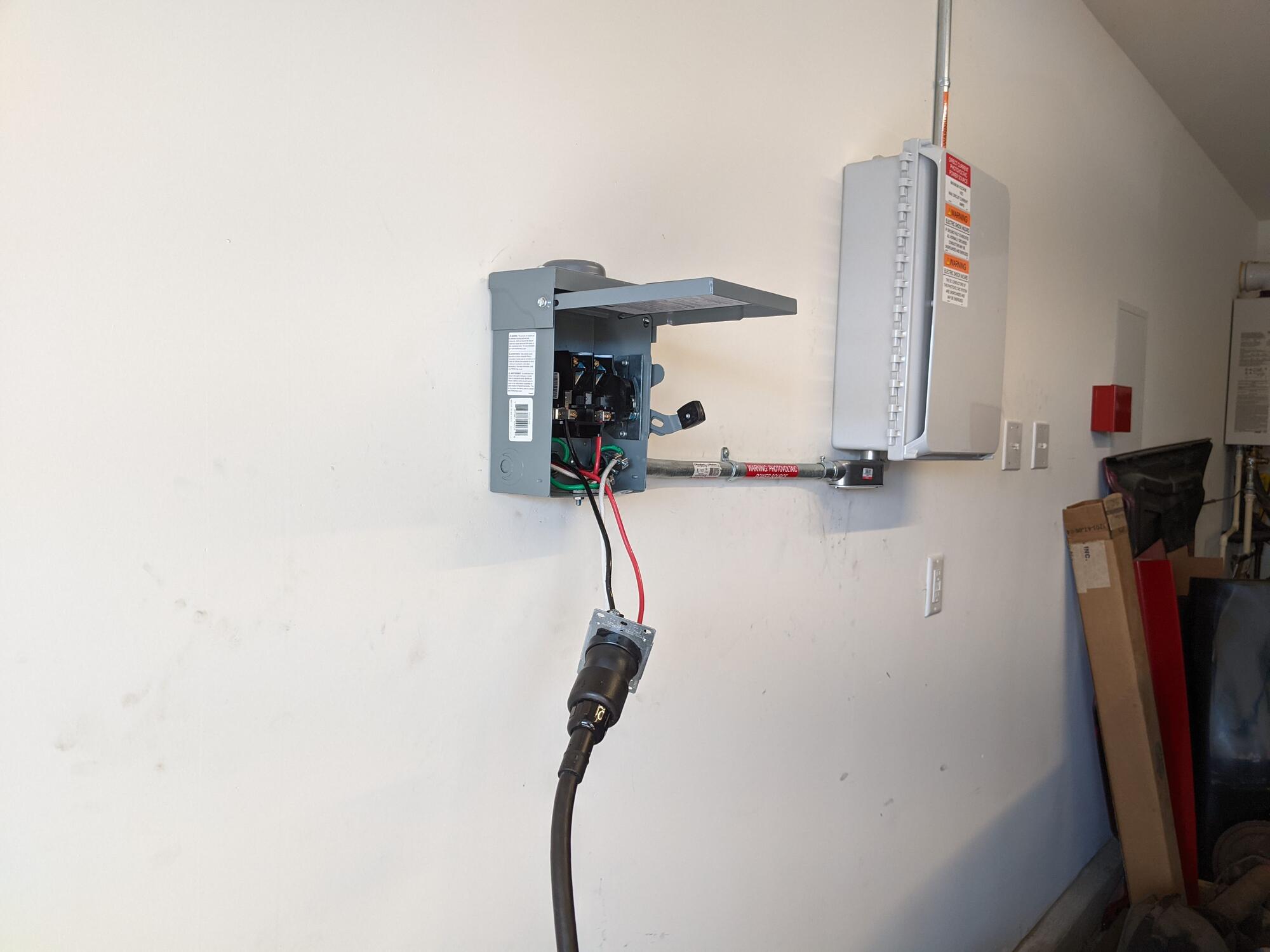

      Anyways, pictures. I wired up an outlet to use, as my house had been pre-wired for an outlet for an electric car....well I couldn't find the other ends of wire in the breaker box, no idea where it terminates too. I turned off my solar panels for a moment and high jacked the connectors for the plug to use on the welder.

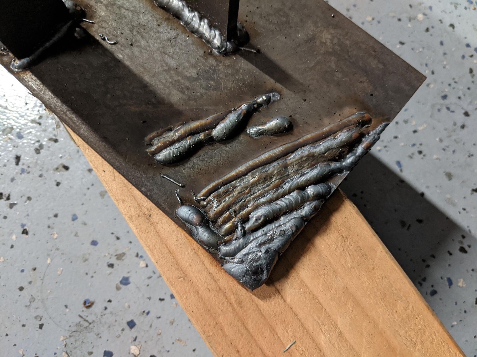

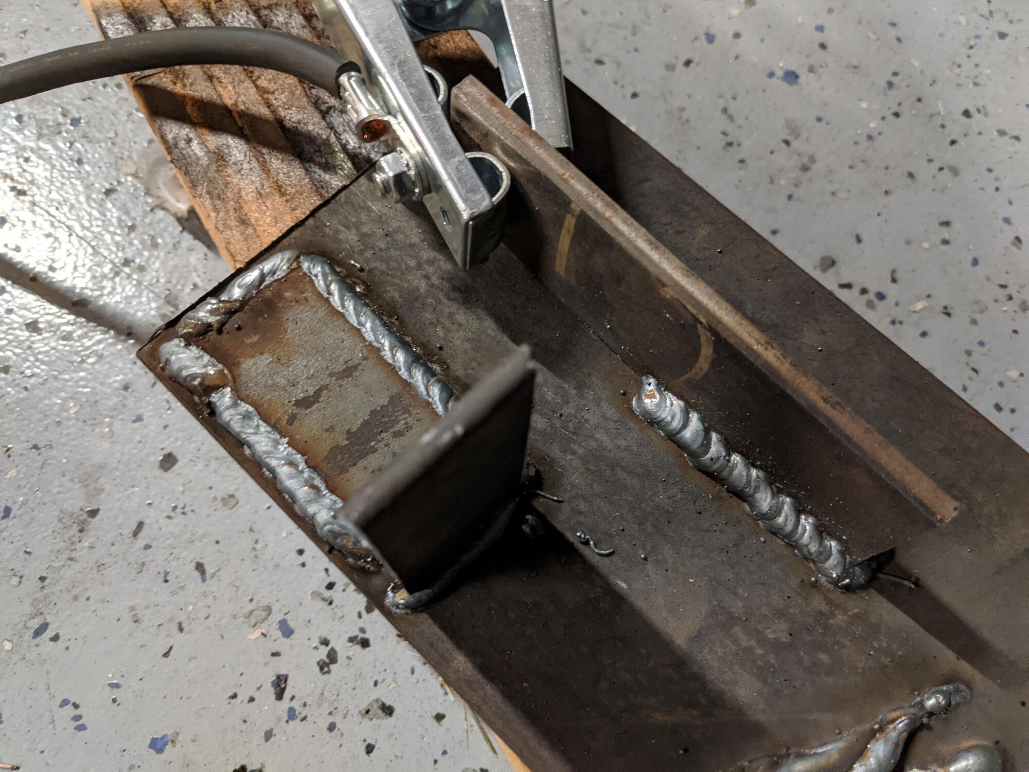

      Here are the practice welds to dial in the settings (this was done on 110v instead of the 220v that we ended up with)

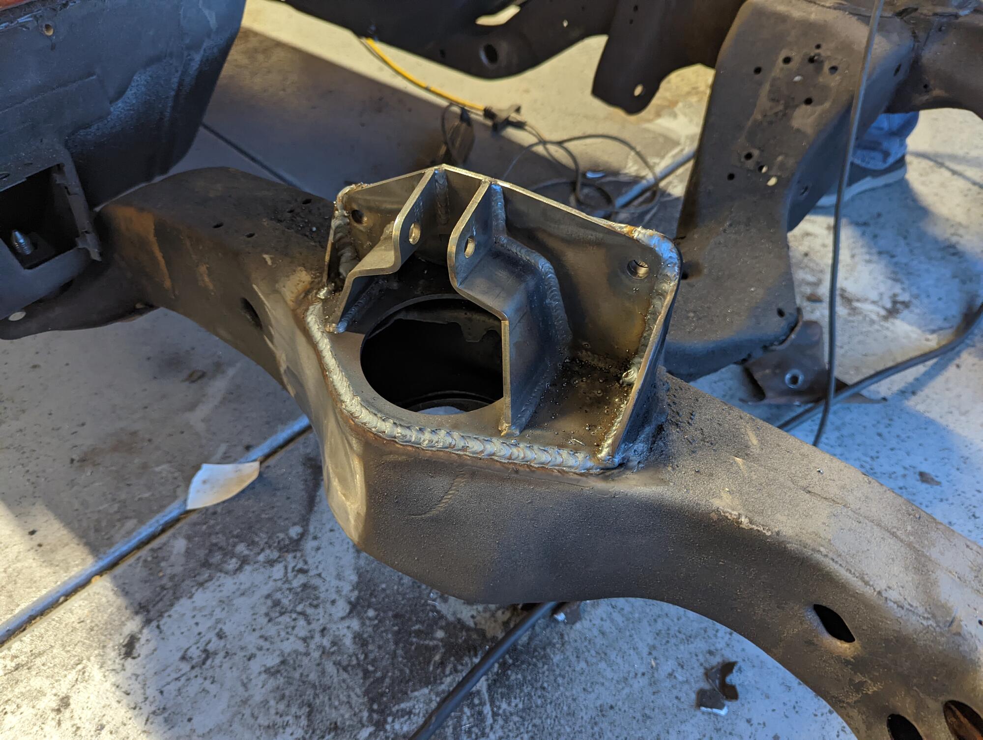

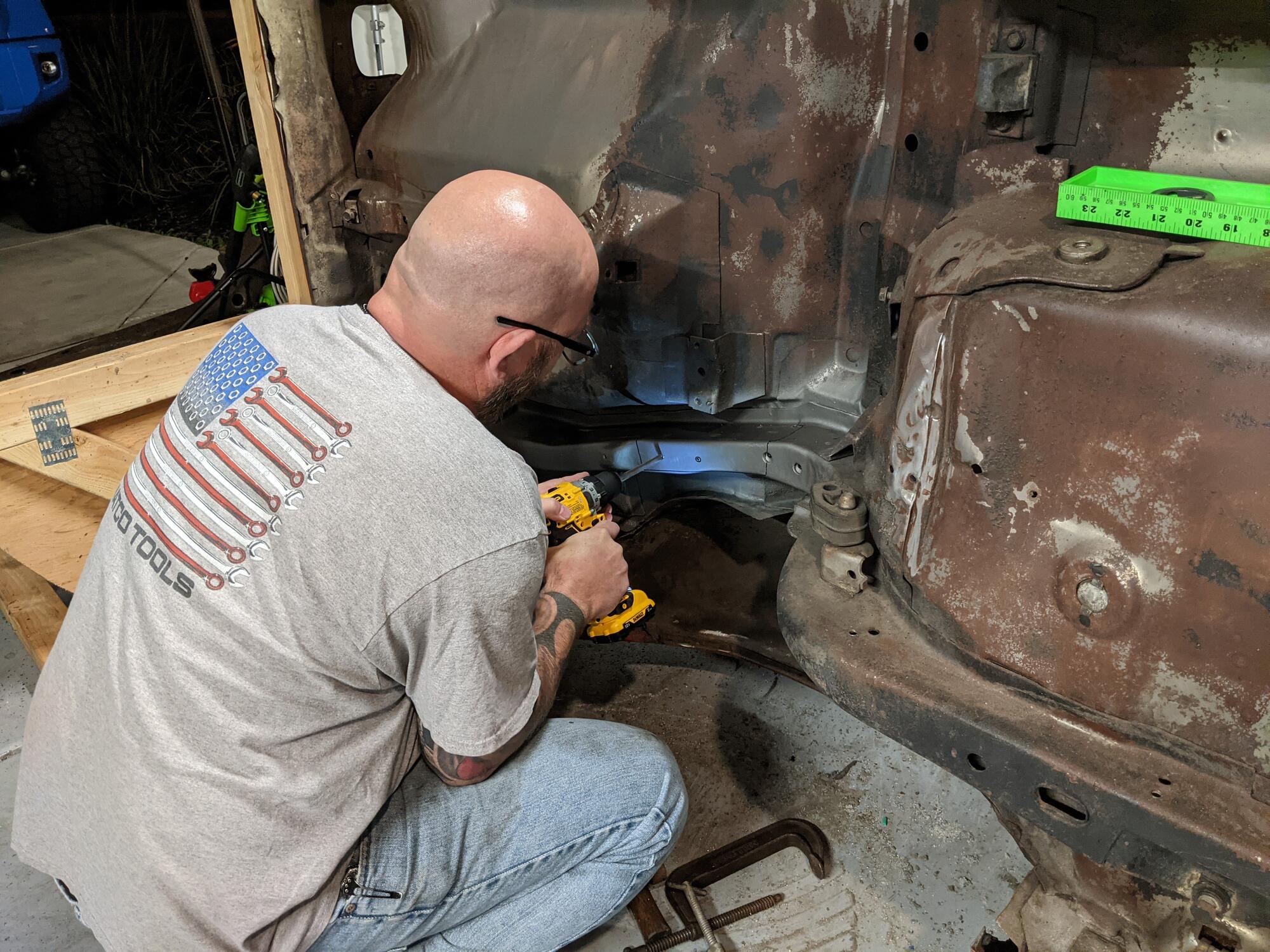

      Drilling out a section in the frame for the u bolts

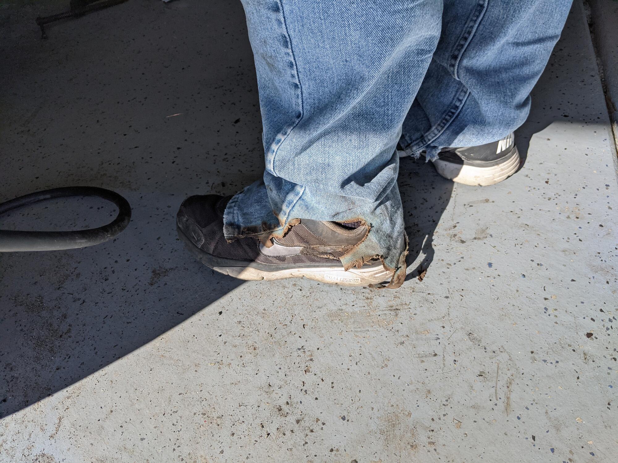

      Pants caught on fire while welding, we didn't notice because I was focused on our jank wiring set up didn't catch on fire

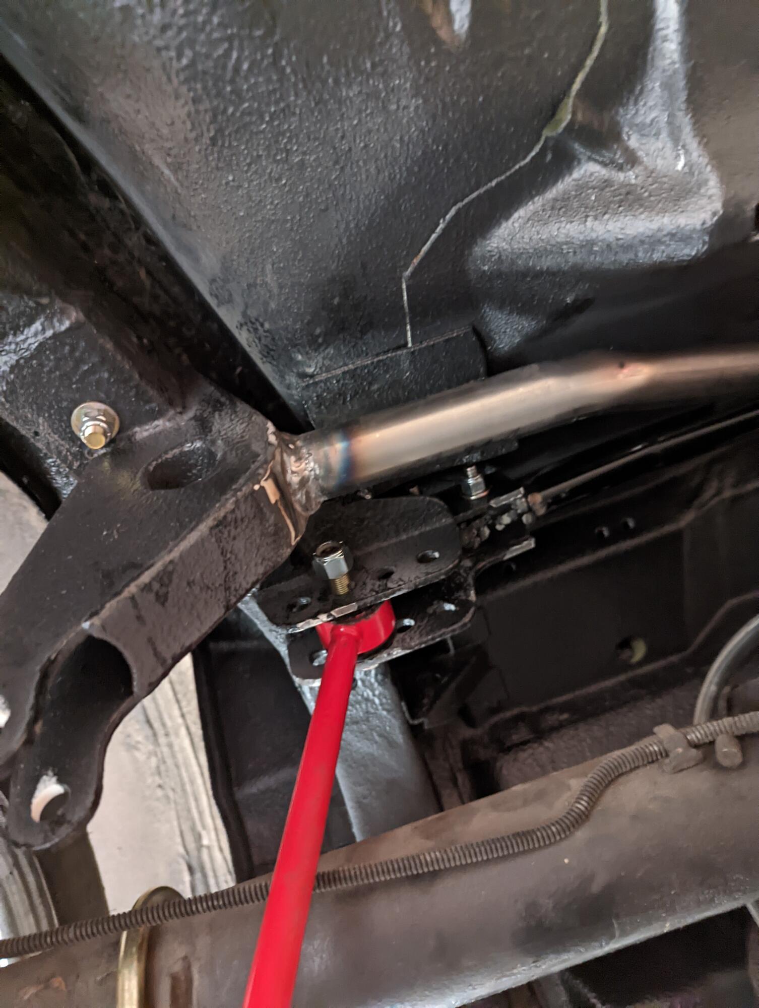

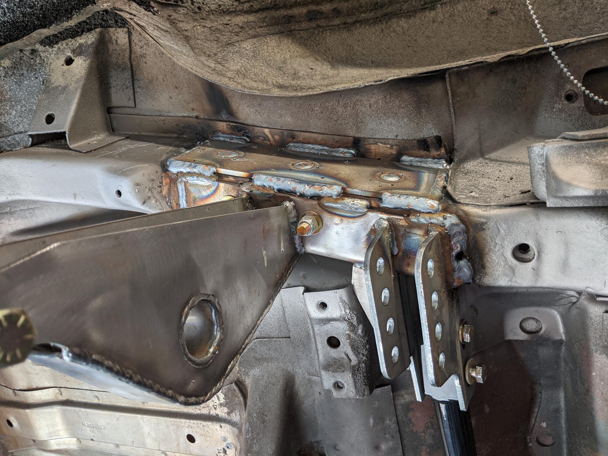

      Finished welds on top bracket, angle of the picture makes it look like it's crooked, it's not, I swear, we checked at least 10 times. (I will clean up the slag, don't worry)

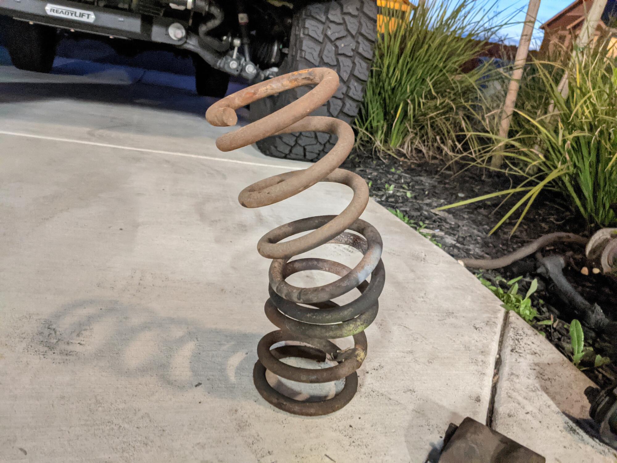

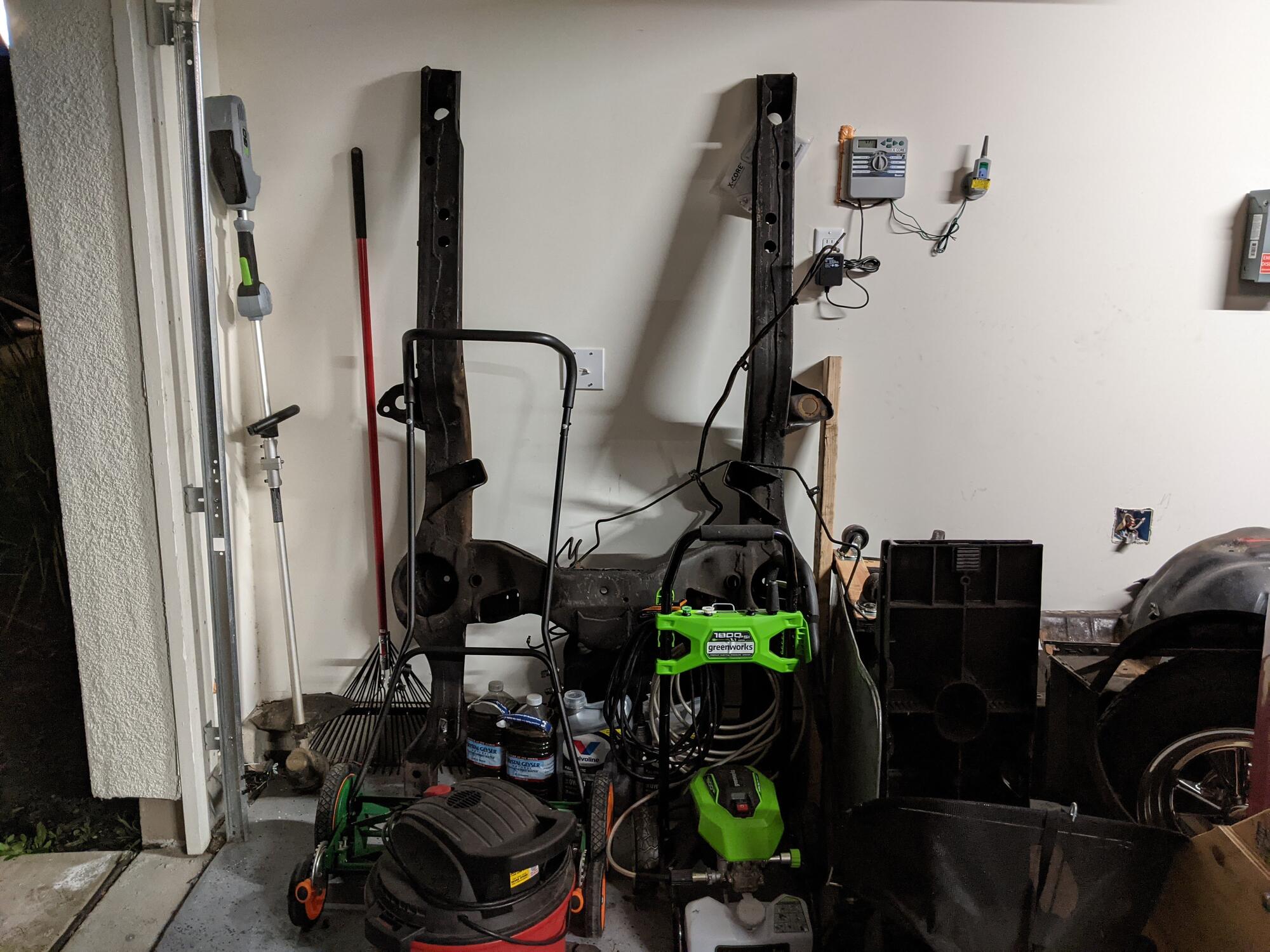

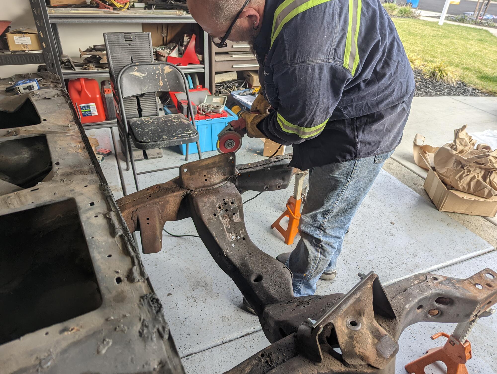

      We also took apart the rest of the front subframe, because taking out the springs are terrifying we heated them up with a propane torch to weaken them. Worked great
      I need a shed...

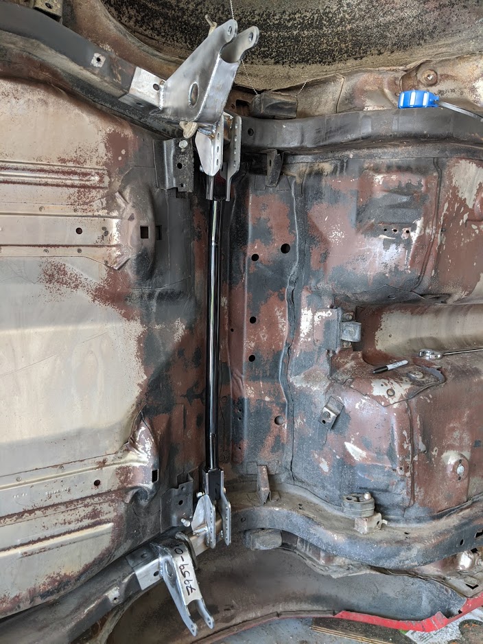

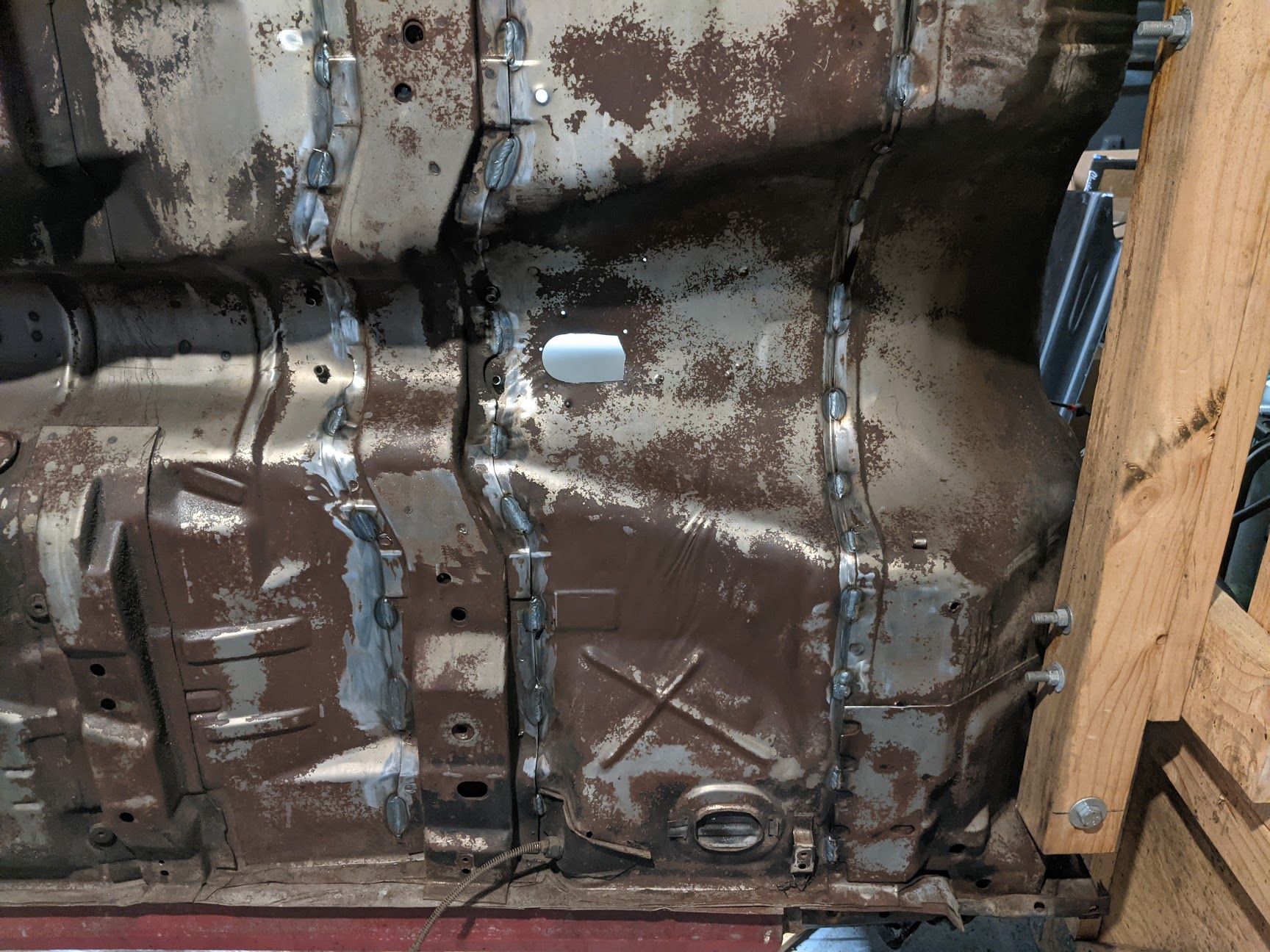

      I also stitch welded the floor pans as suggested by others.

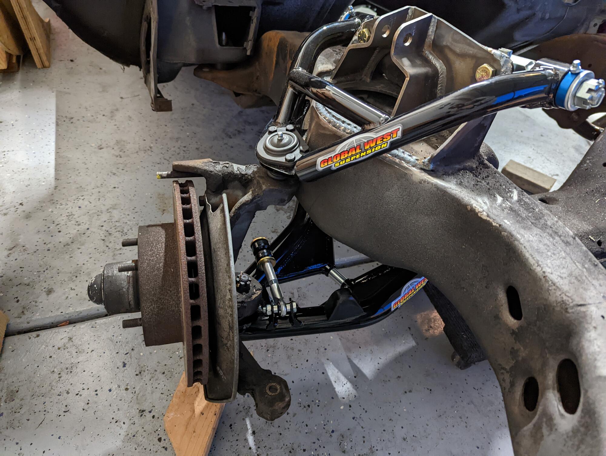

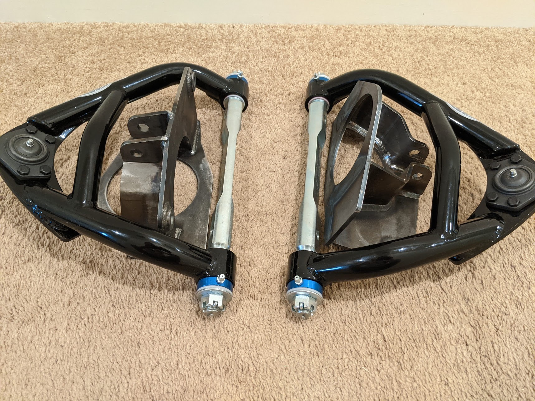

      Not much to update, lots of things delayed due to shipping, was also waiting for the weather to get a bit warmer to paint which I will do next week or two.

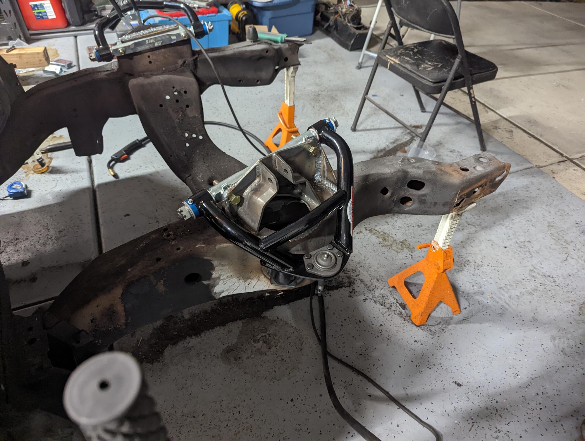

      I will say this though, I got my global west control arms in the mail. Those brackets will weld to the subframe and will allow more shock travel.

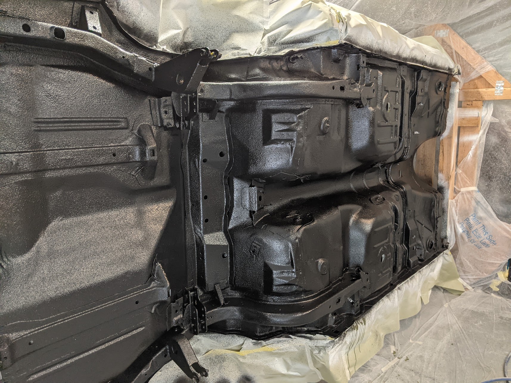

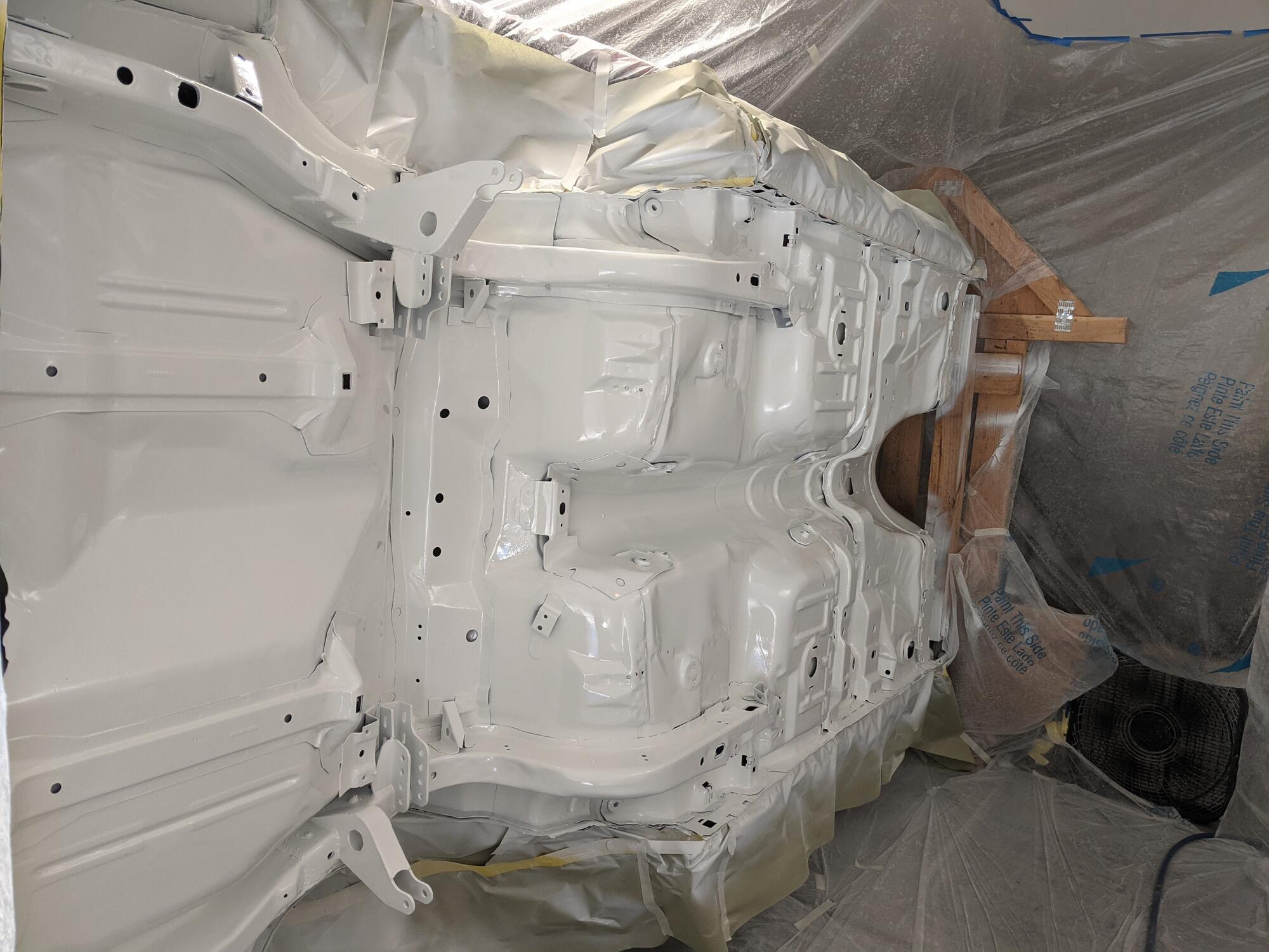

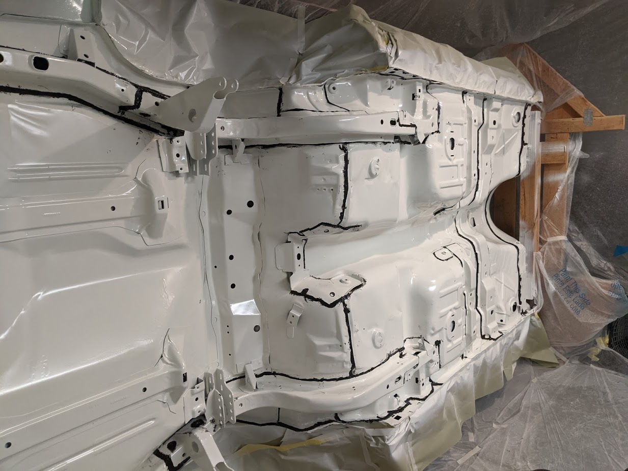

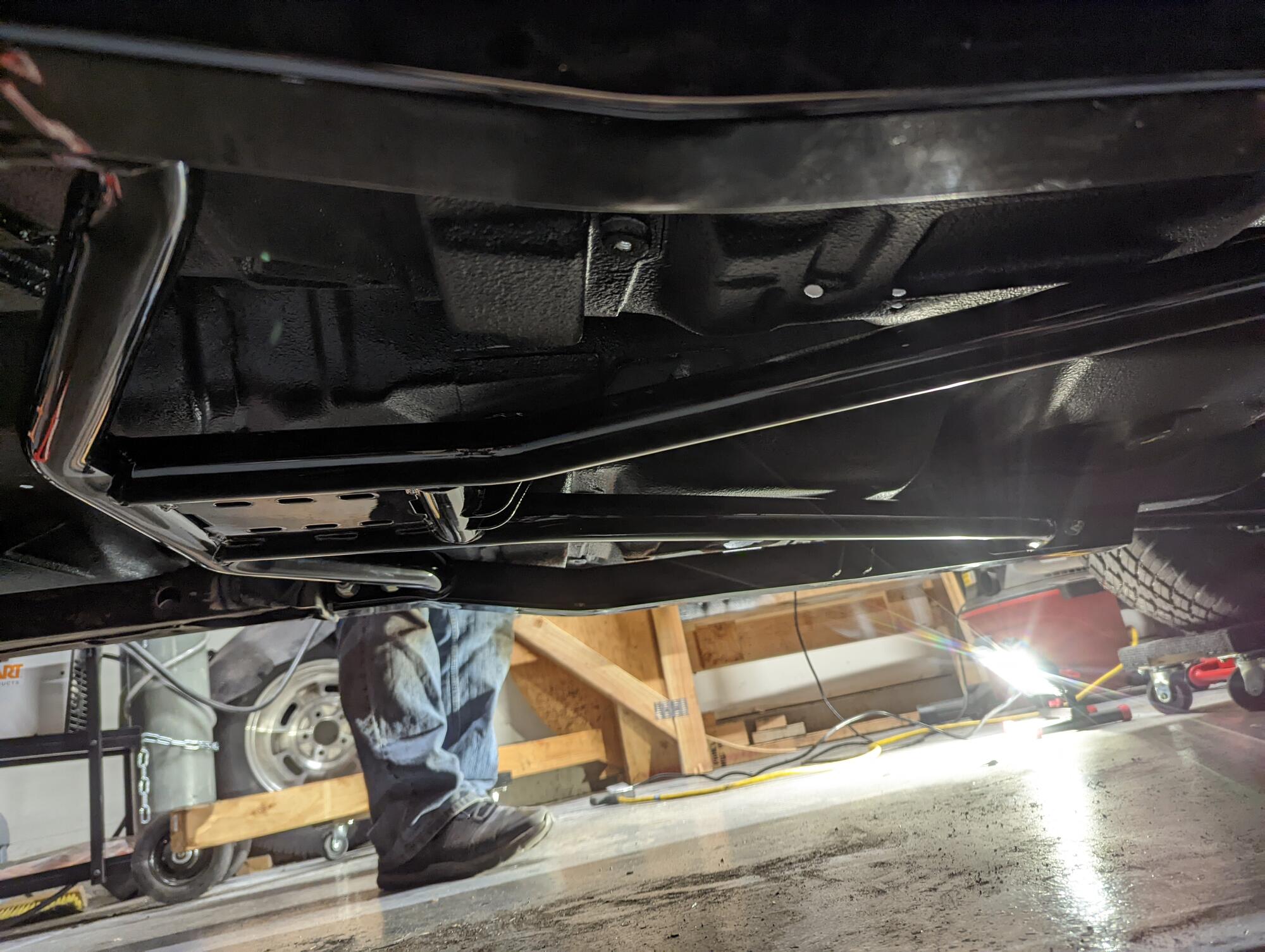

      A lot has changed since the last post. Stripped the entire bottom of the car, coated it with SPI epoxy, seam sealer, then upol raptor black

      After that We had to weld the support braces to the new shock mounts. I dind't do this before painting because the bar was bolt in and already panted from factory, and would have gotten in the way of full coverage.

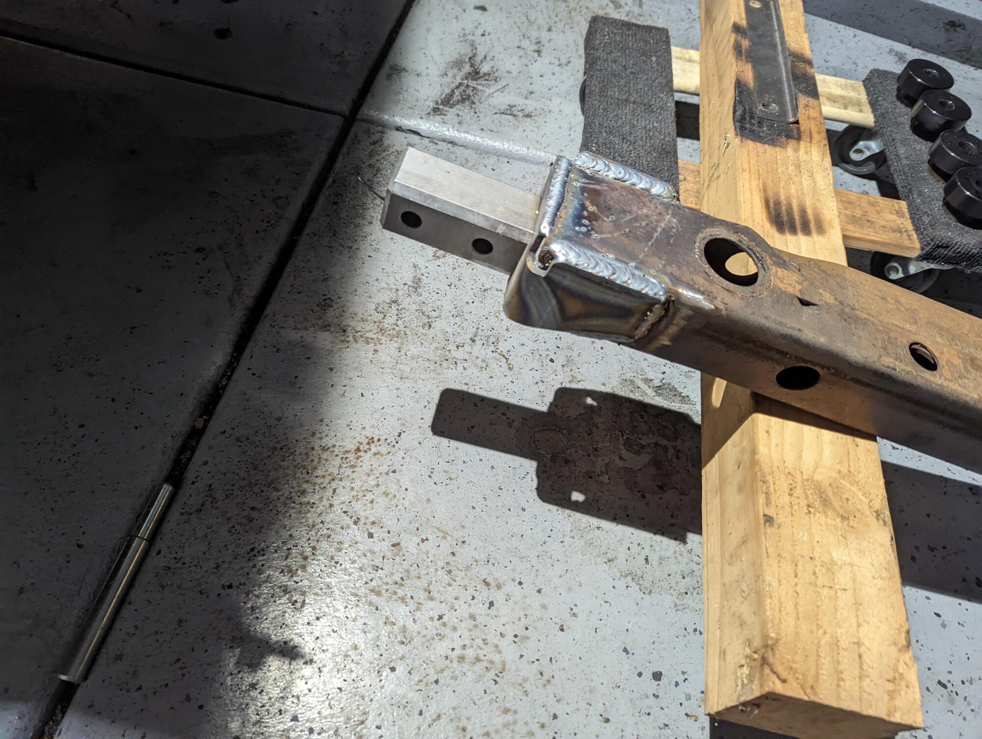

      After that we welded up a bracket to the end of the subframe for the Chassisworks subframe connectors/torque arm

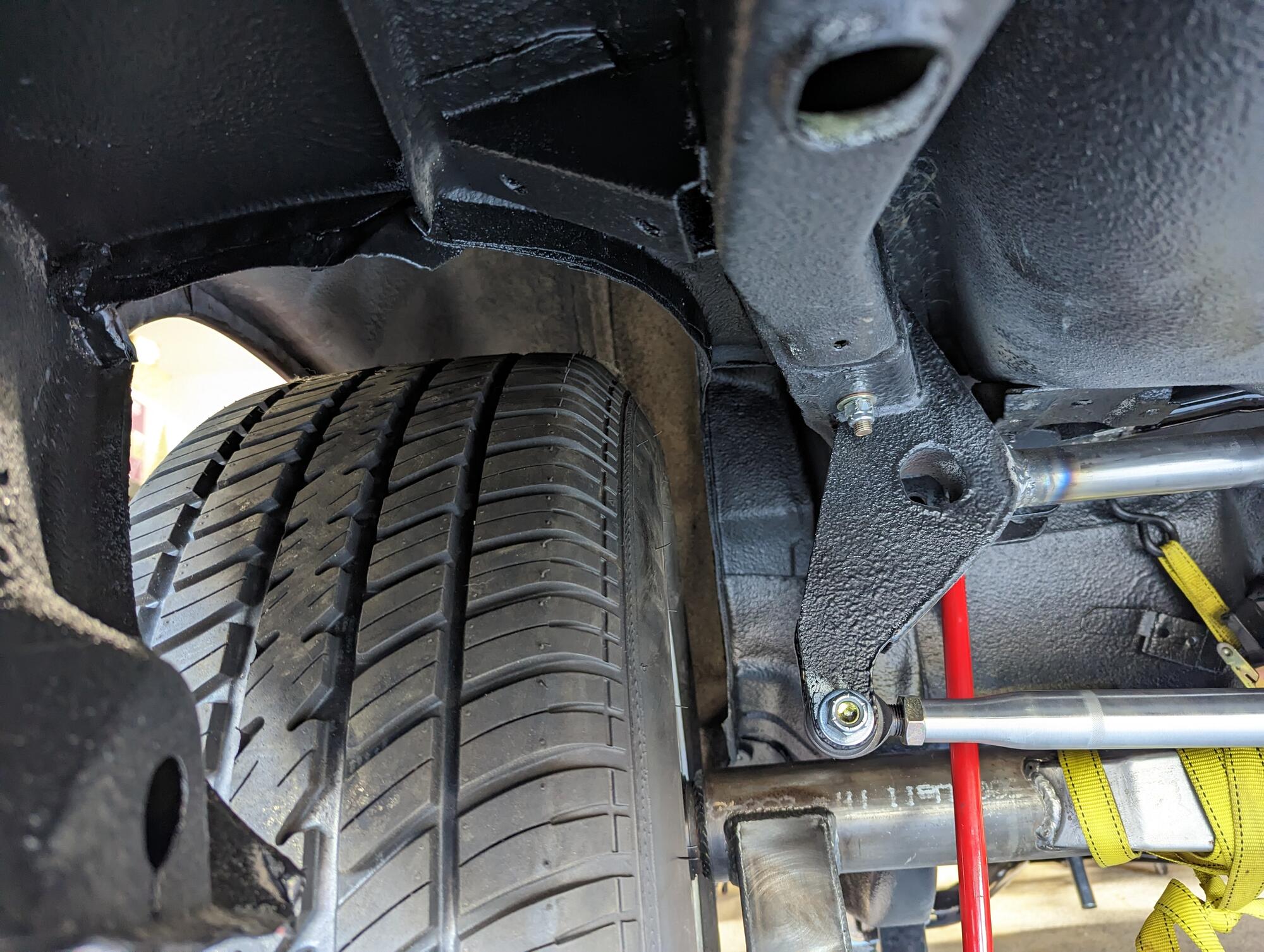

      and as of right now I am waiting on the lower control arms to come in the mail to bolt in temporary shocks to roll around, and I need to make a temporary panhard rod for the rear as it is not centered and sitting back too far.
      The rear end I have in is the old 10 bolt, I'm in the middle of a move, after I'm settled I will put in the order for the ford 9" and strange 3rd member with s-trac diff which will make the rear sit correctly.

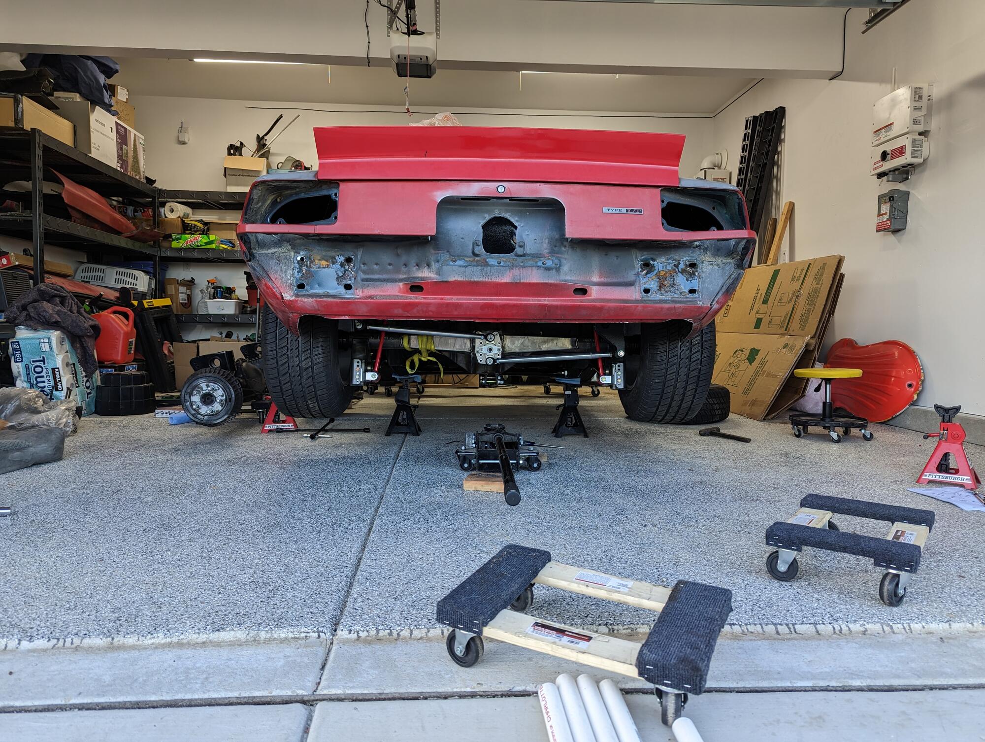

      My rear end still wasn't purchased at this time, so I had to ratchet strap everything together to get it on the trailer, I eventually bought a strange s trac and new spindles.

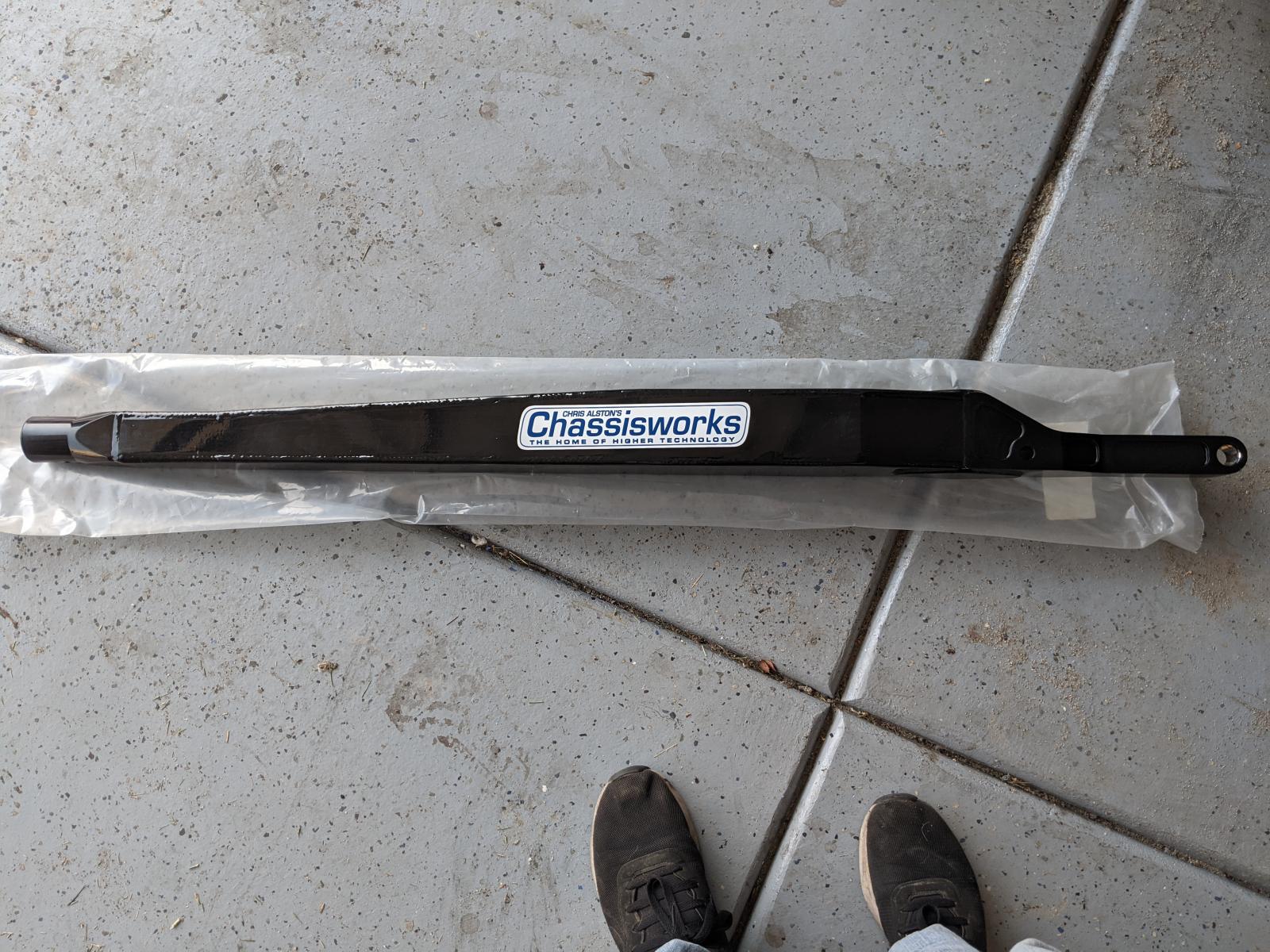

      From there I had massive problems with my torque arm from chassisworks. Long story short, the subframe connectors they gave me were for a 70-74 even though I needed 75-81 connectors (these are longer) This in turn meant the torque arm they gave me (which was correct) was too long.
      They fought me every step of the way to get this resolved, they eventually agreed to shorten the torque arm, but they should have just swapped out the subframe connectors for the correct part number.
      They treated me like I was an idiot and I didn't know what I was talking about even though I had multiple pictures and measurements to prove otherwise. I never want to deal with them again.

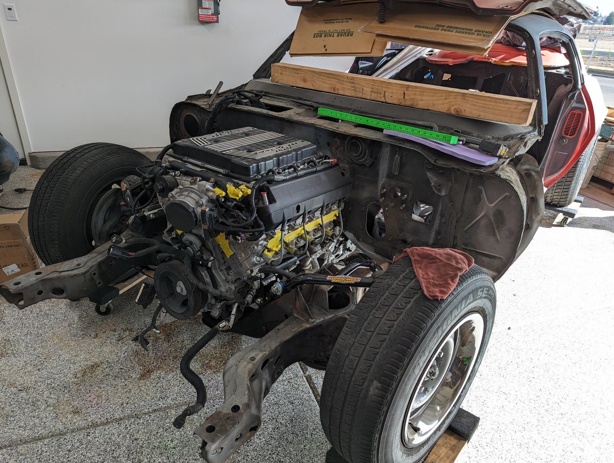

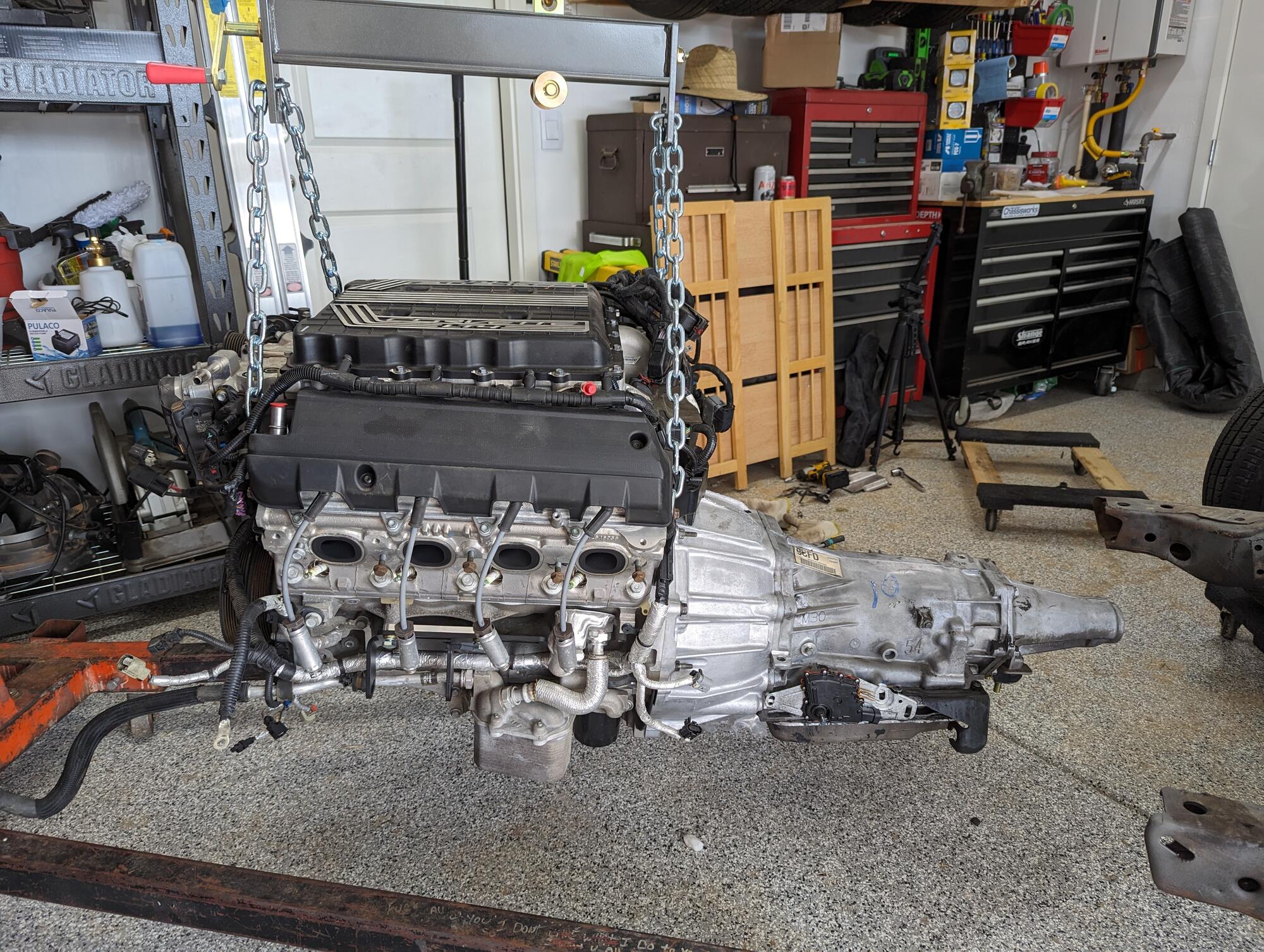

      That aside, I got my LT4 and paired it with a 4l60e and got it in the car this weekend. This will come back apart and I will have a proper 4l60e built for my car, but this is for mock up purposes.
Size:  616.3 KBName:  PXL_20231104_211058961.jpg

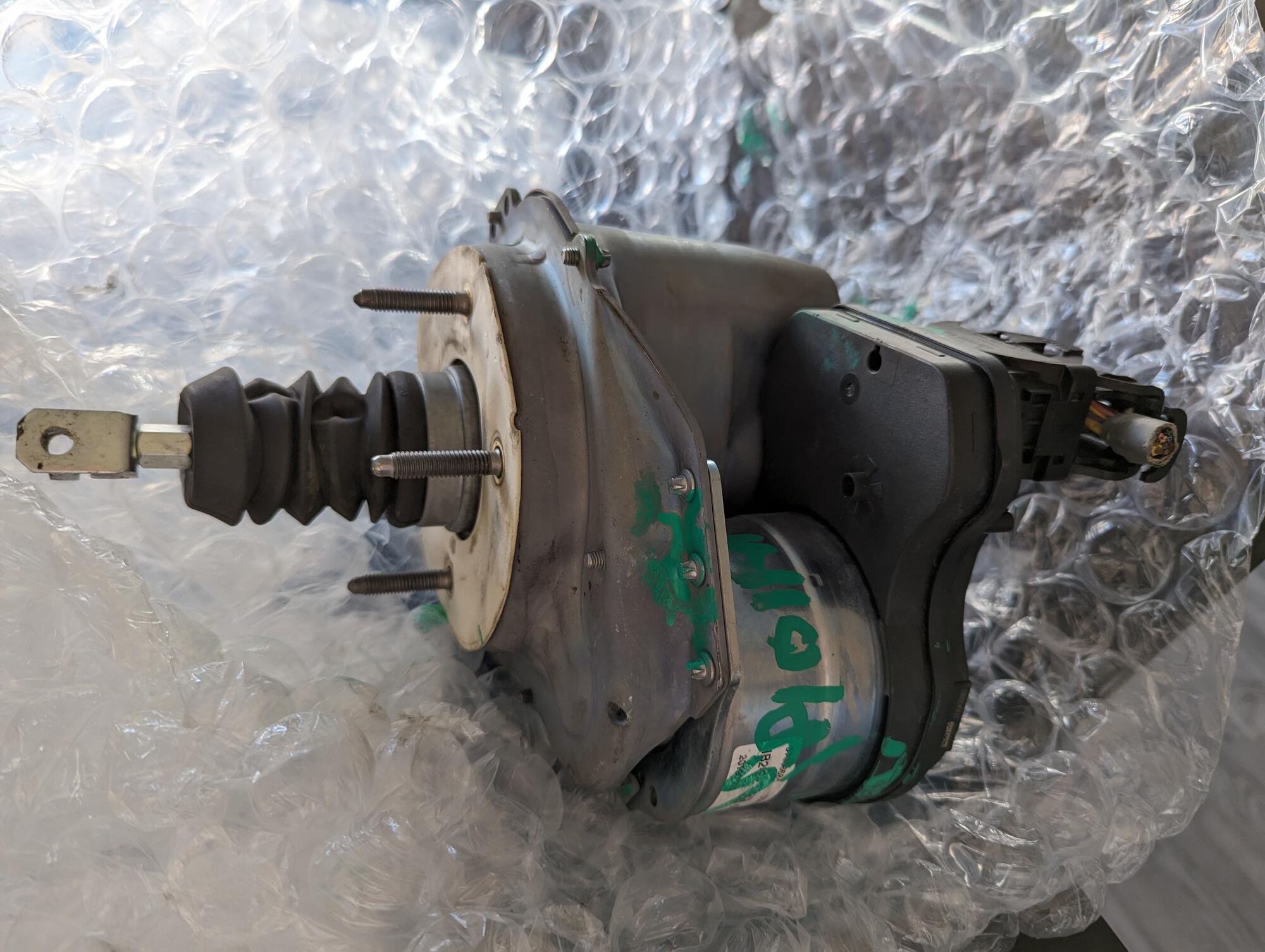

      I got a special bracket to bolt up a bosch ibooster to my firewall so I have electric assisted brakes instead of vacuum as the LT4 does not produce a lot of it. I do have a vacuum pump from the corvette the motor came from, but I plan on selling it as I don't actually want to use it.
      Attachment 211447

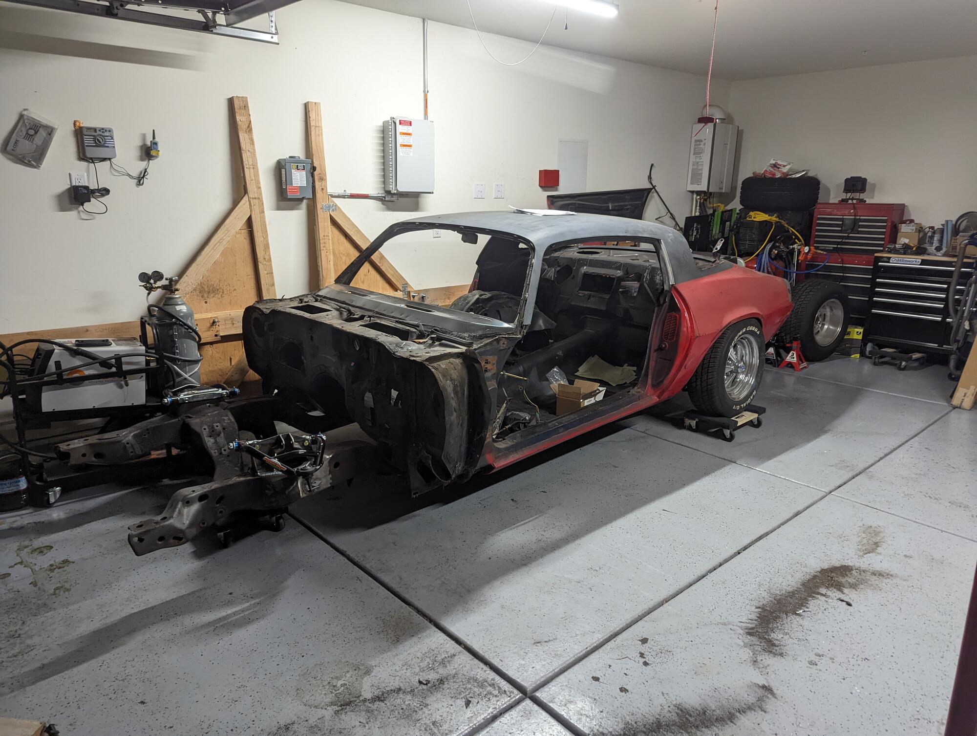

      I put the fenders back on in a pretty lazy way to see if I had any potential problems with fitment. It's just held together with zipties and stuff, it sort of looks like a car again though, which is nice.
