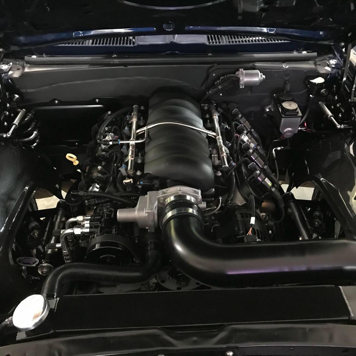

      It’s not thru the blower motor hole, however, this is how I ran mine. The lines exit behind the VA evap unit which is pain for making lines but keeps the fittings/lines on the firewall side very inconspicuous yet still serviceable. If you were to drill a hole and run the lines thru the kick panel area above the vent/speaker, the lines could be routed thru the blower motor hole but you’d need to use care to be sure the area was properly sealed against leaks.
