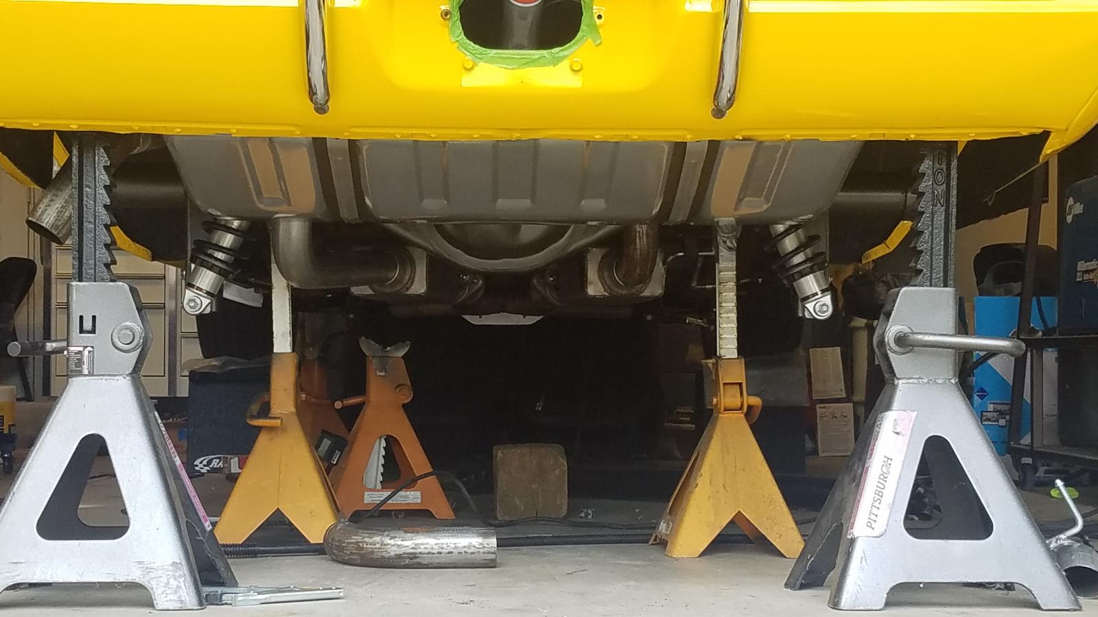

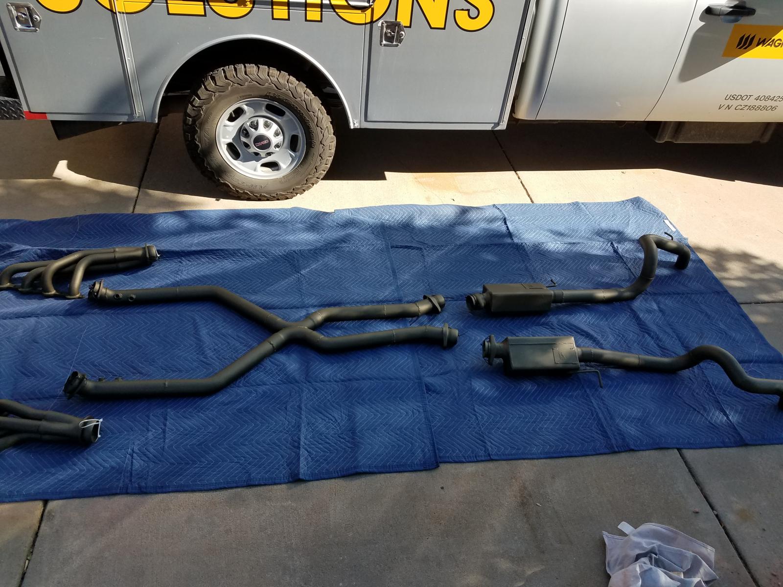

      I don't think there is anything specific. I built my own and went under the rear axle. I like it and there is tons of clearance. First pic shows over the axle bends in place. Second and third pictures show test fitting the drivers side under the axle. Hard to tell but there is a lot of room. Fourth picture shows the completed system. Last picture is just me showing off the coating I had done!
      I hope this helps the idea train.

      Coating?
      What coating is that ???

      Thanks yellow for posting your exhaust. It helps seeing how you did it. I will most likely end up doing this to my car as I have a ridetech 4-link and muscle bar and that pretty much eliminates routing pipes over the axle.
      I have a few of questions:
      1) What is you ground clearance at ride height to the pipe at the axle? Where is your lowest point in the exhaust system?
      2) When you jack up the car, what is the clearance to the exhaust pipe when the rear suspension is fully extended?
      Cheers, Steve

      The car is in a friends garage until I get my daughters Nova done but I can tell you what I remember. I should have the Nova done by May 1st. My fingers are crossed.
      To answer question one: the lowest part of the exhaust is a tie between the bottom of the muffler and the 90* bend going up after the axle. You can see in the picture of the uncoated exhaust that it lays very flat all the way back.
      Question two: I took the springs off the coil overs and moved the suspension at all angles between full droop and full compression. There was just under a full inch of clearance between the axle tube and the exhaust at full droop.
      With the mid-length headers and a stock subframe the front half of the exhaust was even with the bottom of the subframe using Speedtech engine plates and frame stands. I now have the Speedtech Pro Touring subframe and the same exhaust is about 3/4 inch lower than the subframe. I think the engine sits lower now.

      sorry, I'm not on the forum very often anymore and didn't see your question. I will have to look at the receipt this weekend to find the name of the coating. It works very well to keep the heat down. I have a '17 Chevy SS sedan that I did the coating on the headers also. I did a gold color that really stands out. When the car was on the dyno everyone there was impressed how little heat was coming off the headers after multiple pulls. A company here in town did all the coatings for me. I think the Camaros full exhaust was $625 a few years ago. The long tube headers for my SS were about $325.
