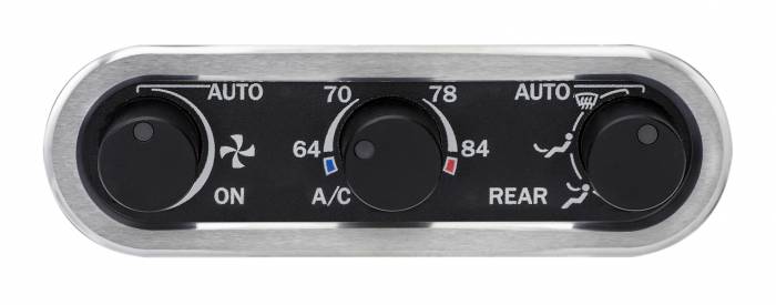

      Maybe use this Dakota Digital controller for VAName:  va_controller.jpg
      That should be easy enough to mould in somewhere, perhaps into the centre console where the traction control button is. Fitting the dash is a much harder task than grafting the controls however. It required (for me) installing the entire 5th gen trans tunnel, and I still haven't figured out 100% how I will do the door panels and whether I'll use the 5th gen steering column or use ididit etc. I've also gone away from the stock center console gauges and am currently working on locations for other 2" gauges.
