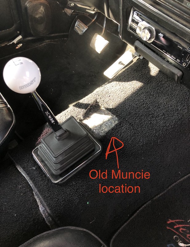

      I have a 6 speed T56 with a Hurst Shifter, relocated, a little further away from the A/C dash panel (previously had a 4speed Muncie) - photo below.

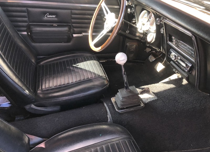

      I just measured the length from Rear middle seats to the center of the shifter. It's 32.7". (not sure I did it correctly)
      Below are some photos, the square cut up area in the rug was where the 4 Speed Muncie was. What consoles can be used with this, trying to find something simple without much modifications needed.

      Hey guys, so I was looking at the American Powertrain White Lightning shifter & the Hurst Blackjack shifter, in order to get a console.
      I didn't install my T56, a shop did that. All i know is that the shifter has moved back, from where it was when I had the 4speed Muncie.
      My question is, how can I really find out if my shifter is relocated somewhere not fitting a classic console? In order to know exactly what I need, before buying the wrong parts.
      Thanks again
