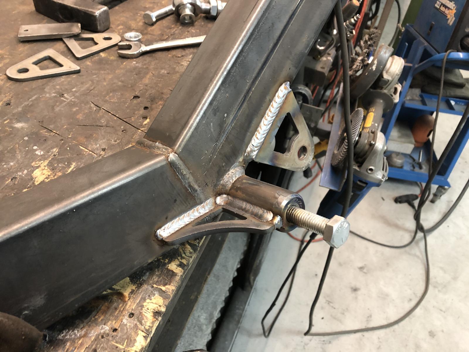

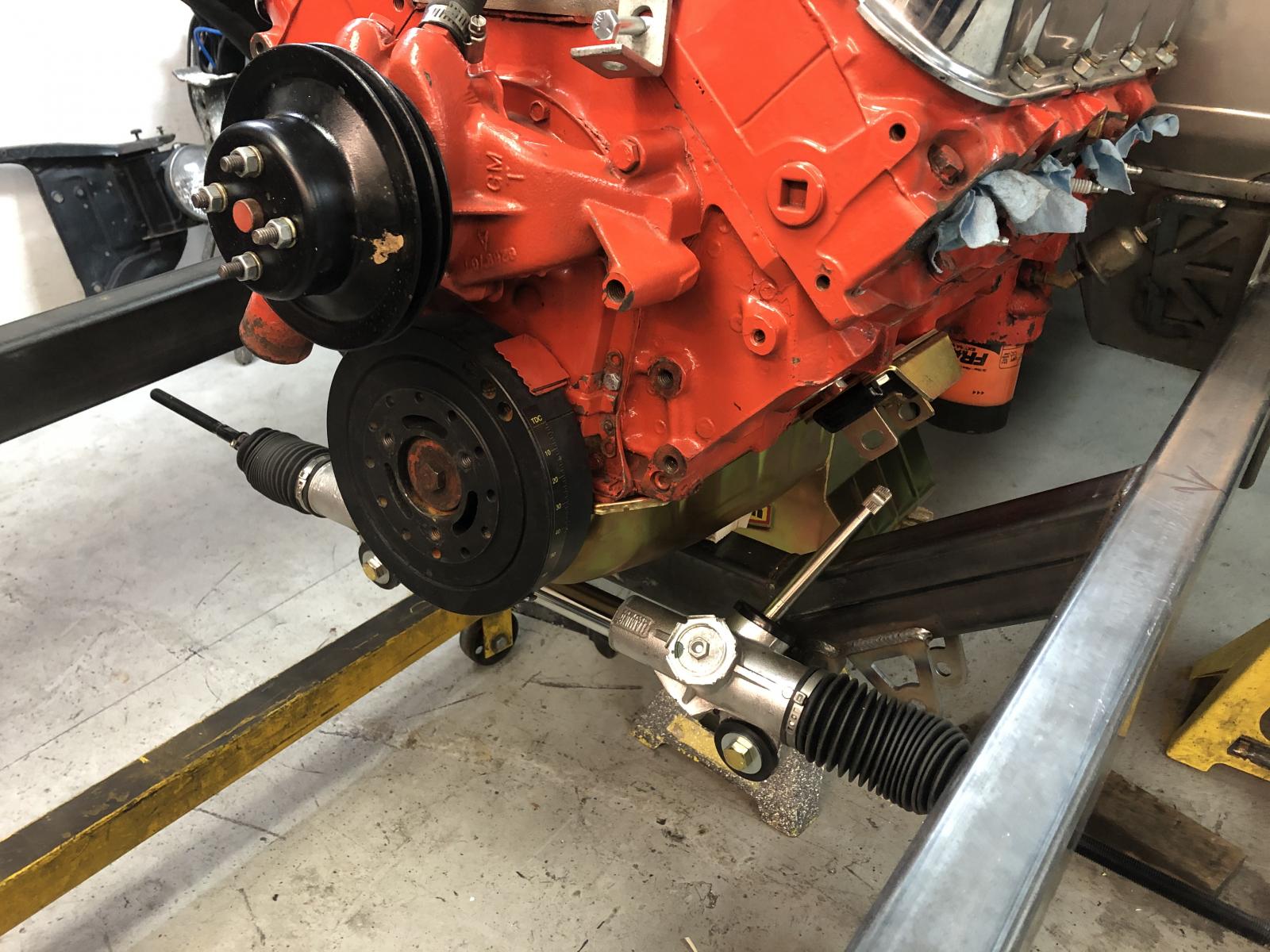

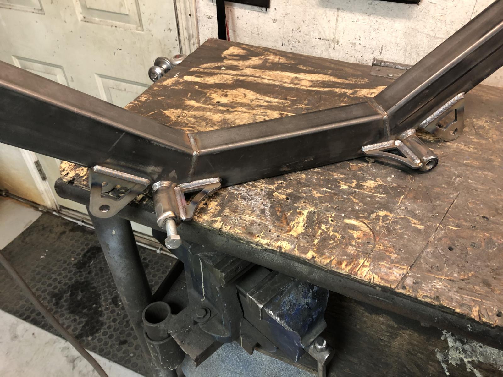

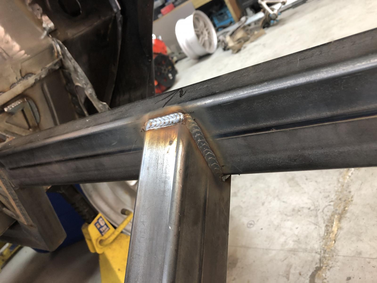

      Some progress on the front cross member. I don't know what happened but my welding was exceptional last night.

      Quote Originally Posted by croooksie View Post
      We all make a mistake now and again
