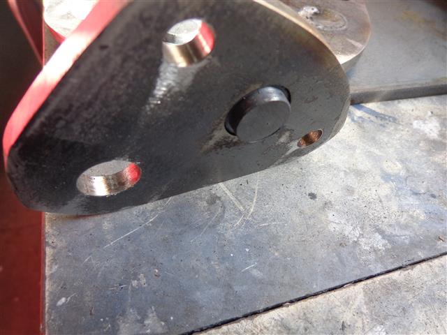

      I had a few things that I didn't like so I've been working while driving. I looked at dropping the front coil overs while I was almost finished but didn't like what I saw. My son sent me an email with a pic of a 72 that had been lowered with a combination of items. Lowering links were listed. After googling, I found a set for $30. That's very reasonable but I build most things. I do a little more research and find that those only clear stock crown vic wheels. If you have deeper back space, you're in trouble. I found a guy who builds everything like me who had made a set with a 3/4" offset for clearance. I bought some metal and went to work. The right side went well. The left side wouldn't clear the a-arm with the spring cup on the coil over. I solved this by cutting the links in half and changing the offset by 3/8" . Mission accomplished. The pics show the links , the clearance and the end result.
