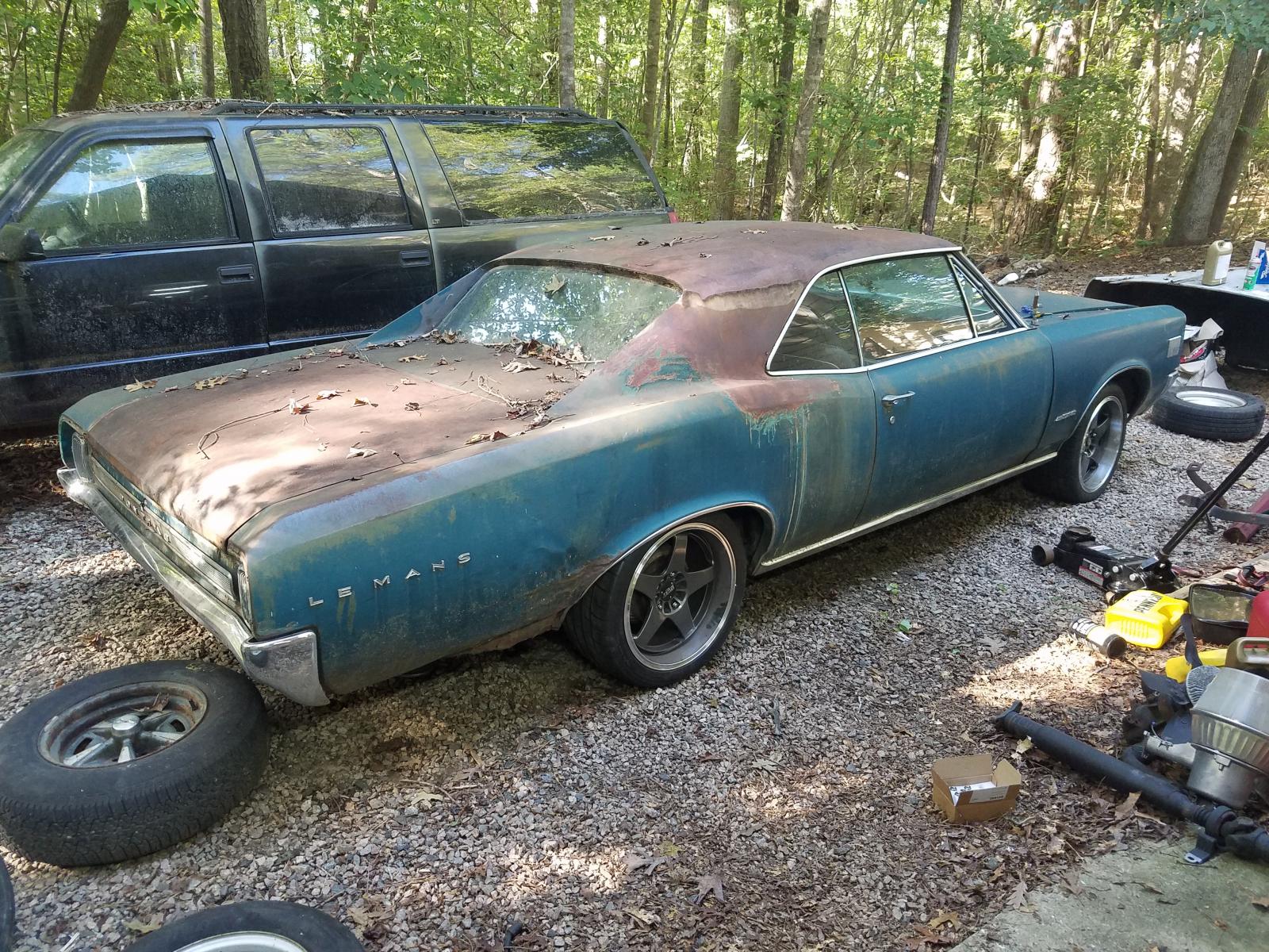

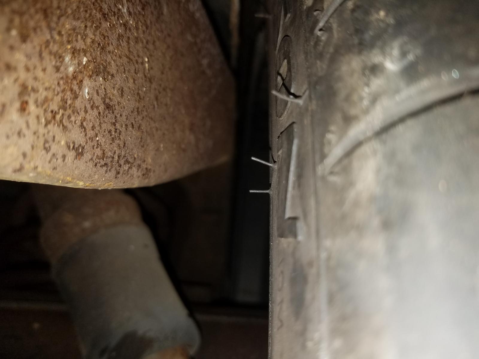

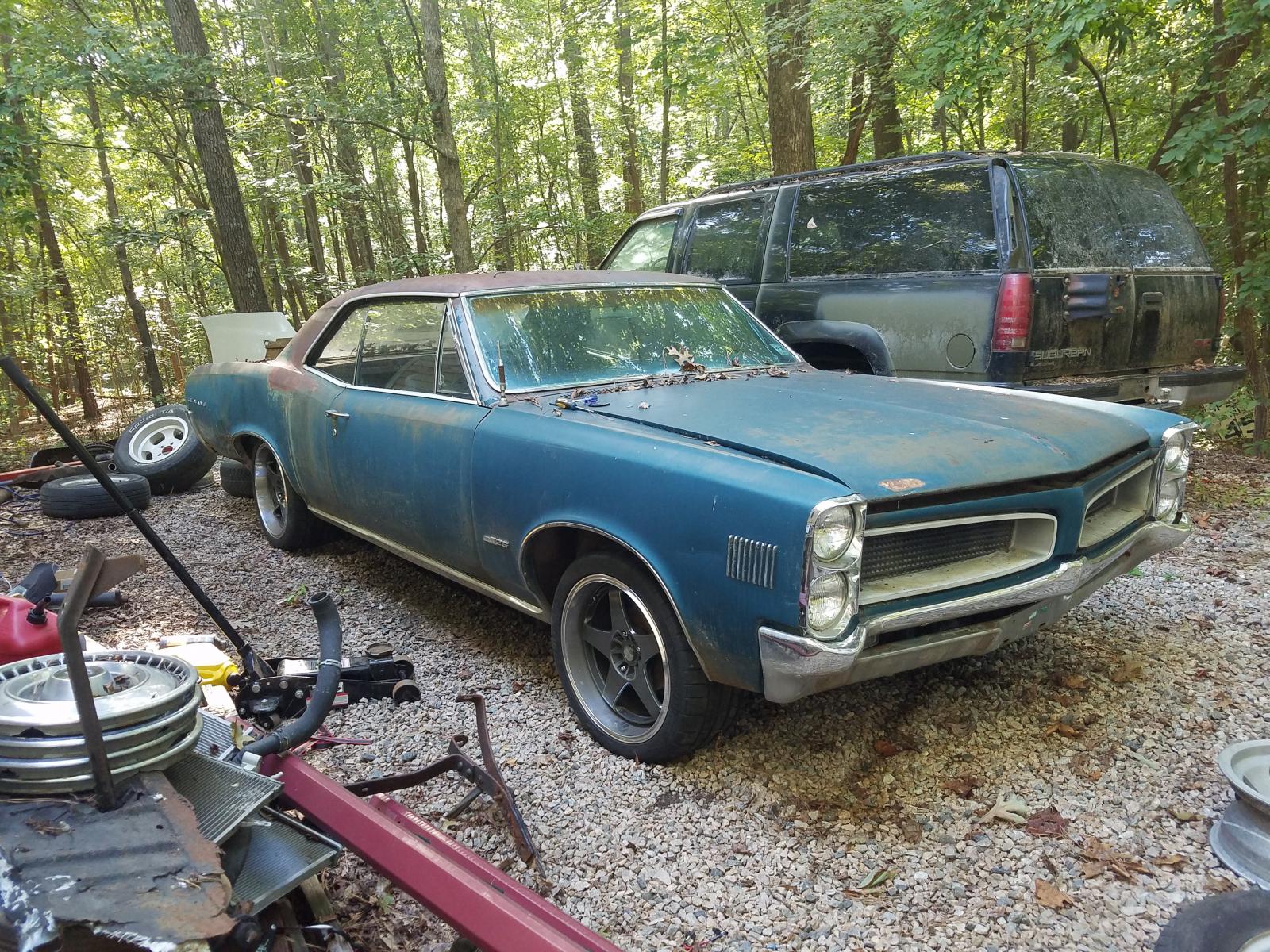

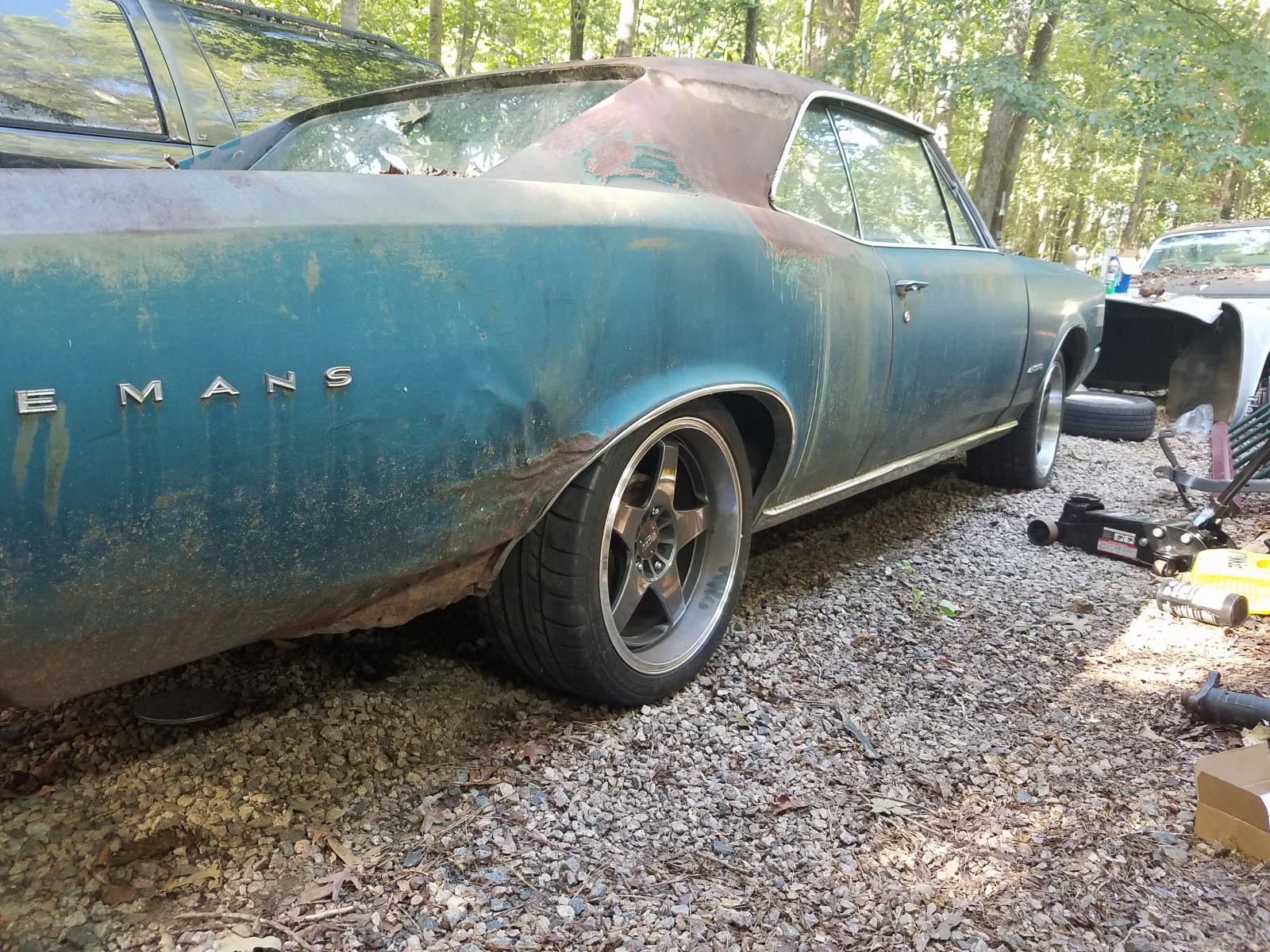

      So I test fit the wheels off of my 98 Trans Am on the car. They are 18x9.5 with 35mm offset and 275/35/18 MT Street Comps. The back fit with about a half inch clearance and the fronts did too with a 1/2" spacer. I have plenty of space to run a 10.5" wide wheel and hopefully a 315.
